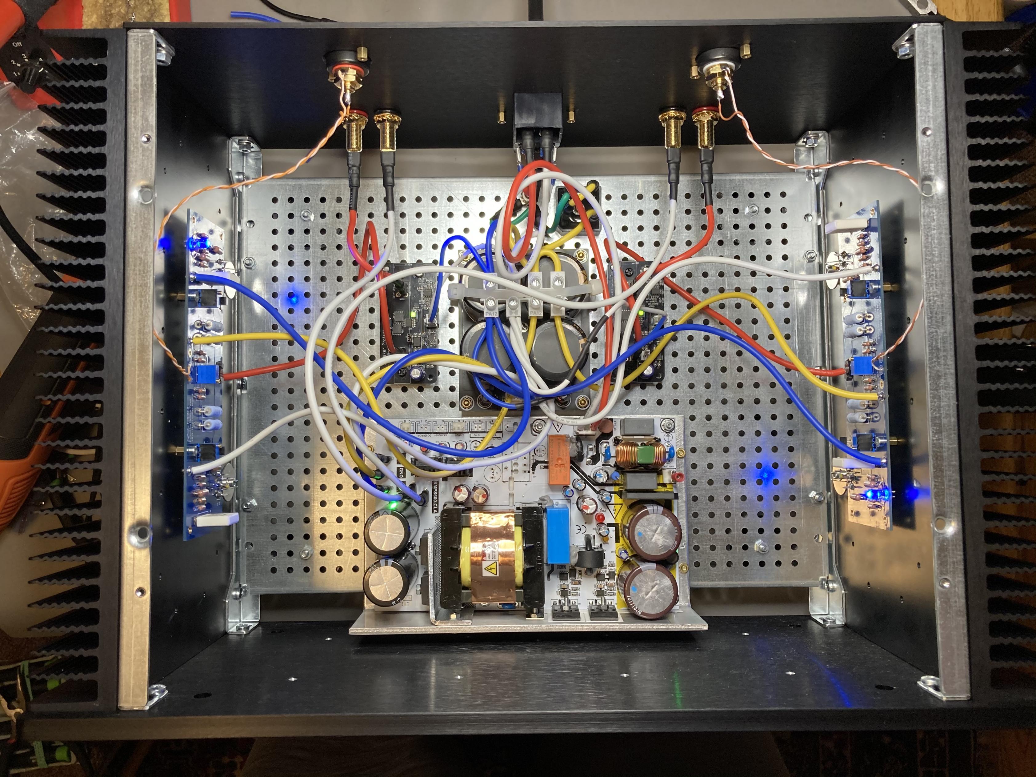

Test fit
First placement of major components for an F5 build. F5 v3 boards, SMPS600-CLA, and extra power supply caps. This is exciting.
The Deluxe 4U chassis is wonderful. But LARGE! 😀 So much extra real estate. I may reconsider the full chassis width and spring for custom front and back panels closer the the Sony VFET SE dimensions... After I have this together and playing music.
I plan to pair it with a new ACP+ yet to be built (received the F5 chassis and ACP kit all today!).

Glad you are having fun! I like keeping both input and output wires the same length and as short as possible, esp the input ones. Full disclosure, I don't know much, but my amps sound good and have low noise. 🙂 My thought is that is would be cool if all amp boards where mirrored.If my intended thought isn't right, what I mean is the boards can be mounted in the same orientation on the right and left sink and have the inputs and outputs symmetrical to one another.
When you have these long skinny boards or any board for that matter, why would I want an input one 10-12 inches longer than the other? Likewise with the outputs....
JT

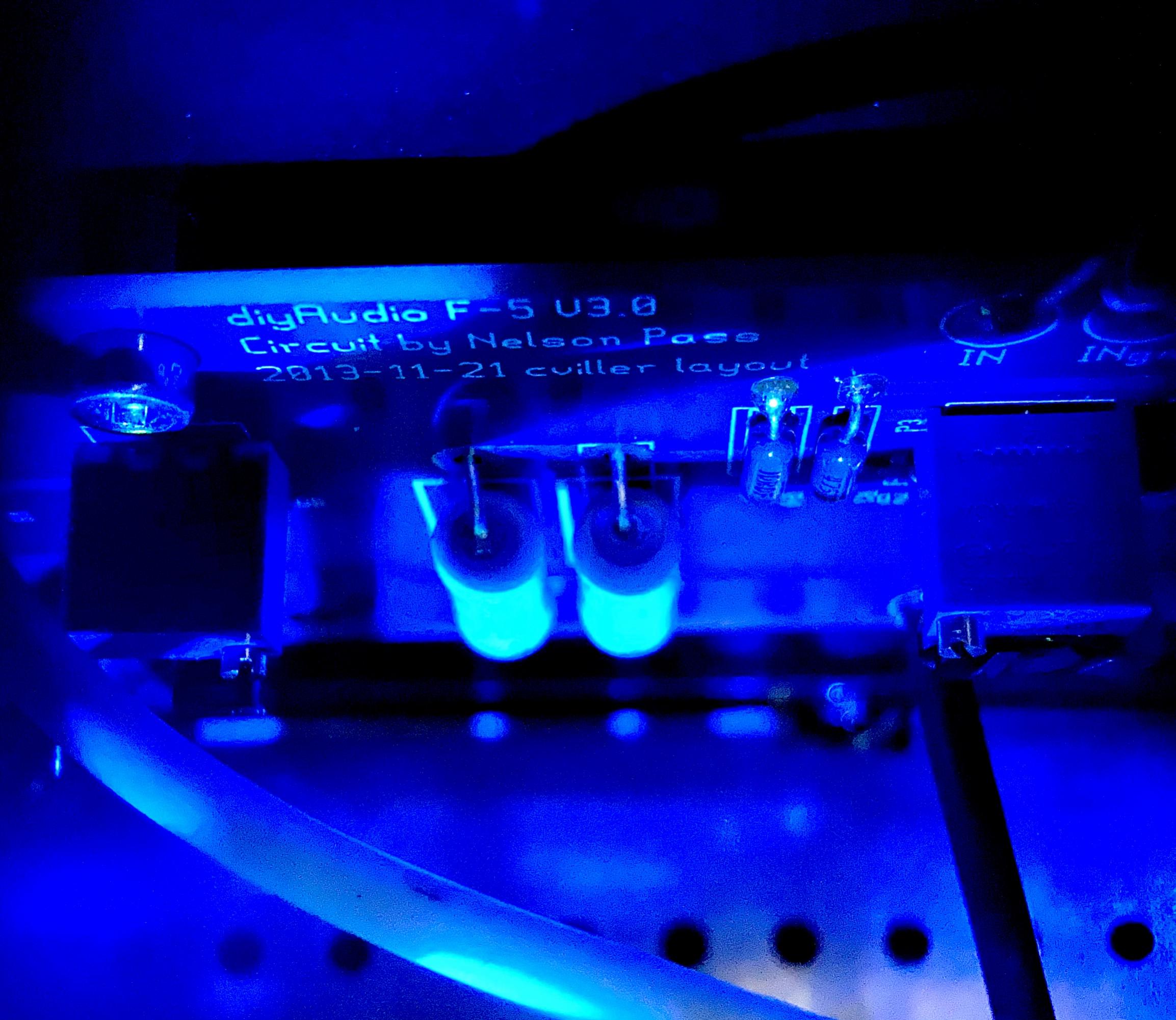

Partial success!!
Completed building the F5. It’s a rat’s nest in there now, but it powered up fine.
I started the bias and offset procedure, but it’s way too late... 😴
I’ll see if I can complete the bias setup after the sun comes up.

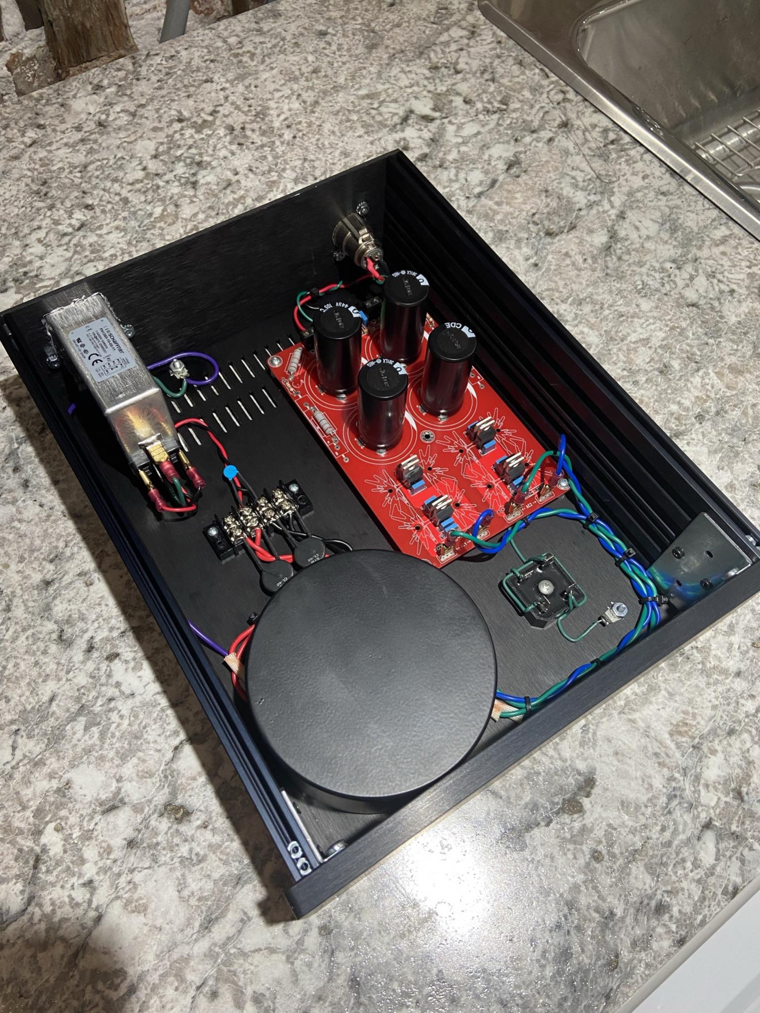

@ChrisM91 That looks great. Really neat. My Pearl II has been dragging along for months now, but hopefully will get it done soon. Then I guess I need to get a turntable. Although I have been toying with the idea of having a go at building my own. This hobby is so addictive, and getting out of control!!!
Thanks, stablgr!
My F5 is up and running well. The VFET SE is taking a breather while I get familiar with the new workhorse in the stable.
The amp is VERY quiet and sounds exceptional! Not exactly as quiet as the VFET SE, but that one is silent.
The SMPS600-CLA (from Products – MicroAudio) works flawlessly. No lack of oomph with the added 40,000uf to its output. Ease of build and implementation here is amazing.
The Deluxe 4U chassis heatsinks are warm but not hot. ~50C on both sinks.
The sound is exquisite. There is less spookiness in the sense of space than the VFET SE, but the quality of the experience is on par with that amp. Slightly different characters. The F5 has discernibly more power, but maybe that’s just because I know it has more available. Nevertheless, wow. As anyone may guess, I am now hooked by these Class A amps. 😀
