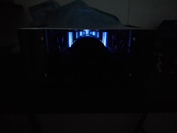

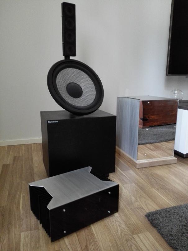

ACA finally ready, what a nice sounding piece of amp!
Nice. And fun looking speaker's

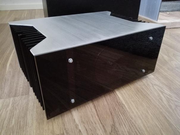

Nice Idea with the smoked perspex front, I'll keep that in mind for the next build
Thanks for your compliments guys 🙂
There's also light inside 😉

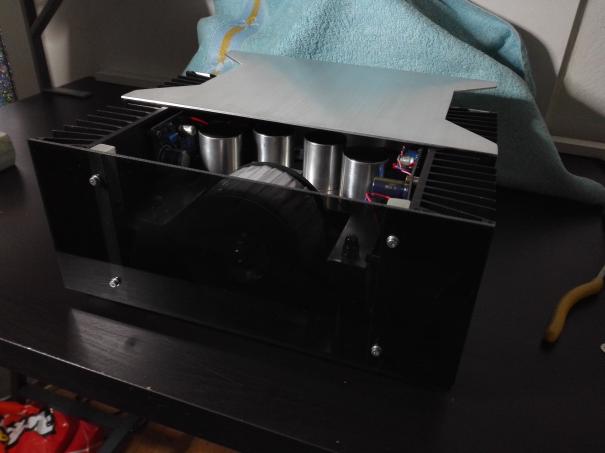

Very nice!
How is the alu top cover bolted to the chassis?
What heatsinks are they? More pictures of the inside available?

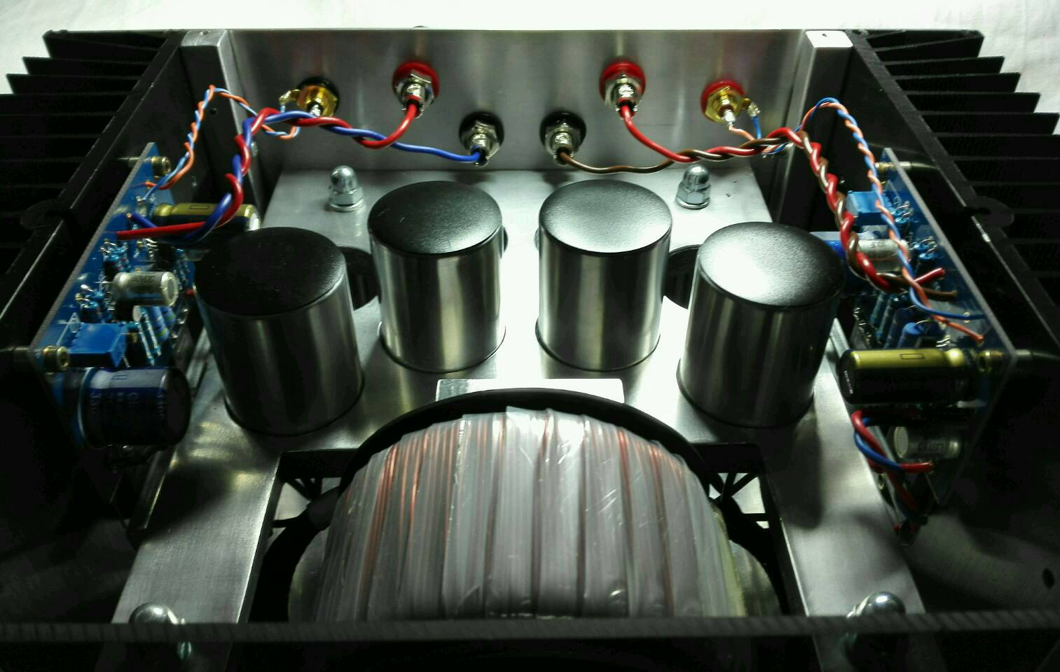

It wasn't when i took the photos, there is four m3 bolts holdin roof now. There's still kinda work going on with this one, I'm going to modify power supply by adding 4 more caps, just for the looks. And then there's cooling, is there need for holes on the roof in a long run. It seems to run cool enough, but i want to make some more measurements. Heatsinks are from broken Nad 216. I have bad habit of modifying these more and more even when ready.. :/ have rebuilt my Aleph monos three times now..
Here´s one picture from insides. Still waiting for those 4 missing capacitors and new CMC RCA-connectors. It´s not nearly as clean as I would like it to be, so may do some modifications when I add those missing capacitors 🙁. Just listened this couple of hours, I really like it.

Are those extra cans over the caps, or did you just spray-paint them? If extra cans, is there any issue with heat buildup?
I think it's lovely, Juntuin.
Thank you 😱
I stripped the shrink around caps, then carefully sanded them with a little water, and glued those black plastic hats over them. Quite fast and easy modification, but they do get scratches very easily when assembling amp together.

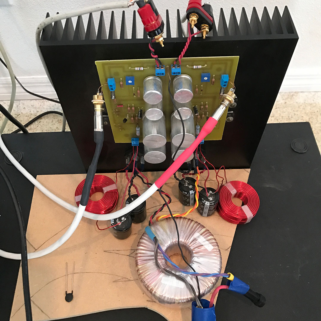

i dug the original Zen amp out of storage and set it up. I never ran it much because i
was getting a measurement of 1 volt across R1 instead of 0.66 I did add Return of Zen
power supply upgrade to quiet things down a bit. The big 2mH inductor and added caps
helped that a lot. Anyway i hooked it up to the X2.5 so a proper Pre amp could run it
for once and to the Bottlehead Straight 8s, designed for low powered tube amps.
I must say Tori Amos sounded her gorgeous self (little earthquakes) on them.
hmmmm now to put it in a proper box? 🙂 16 year old projects 🙂
