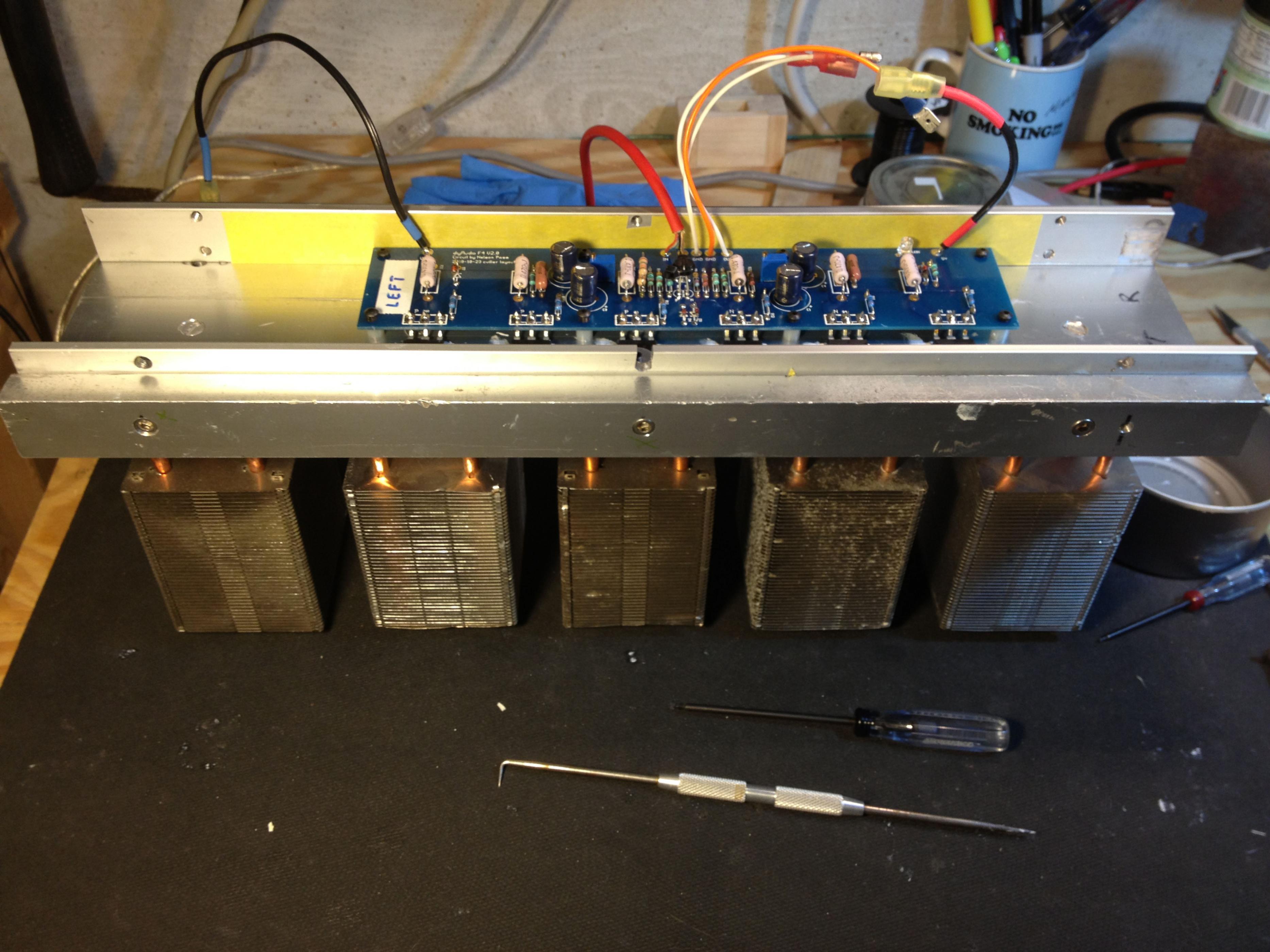

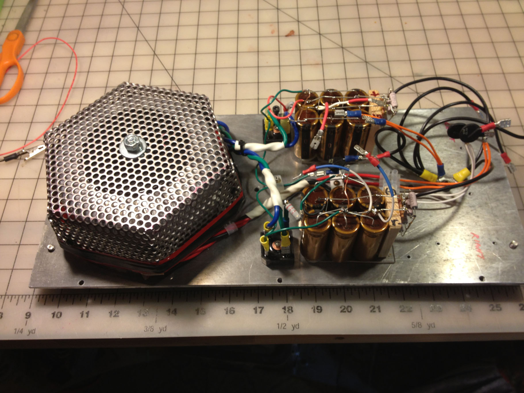

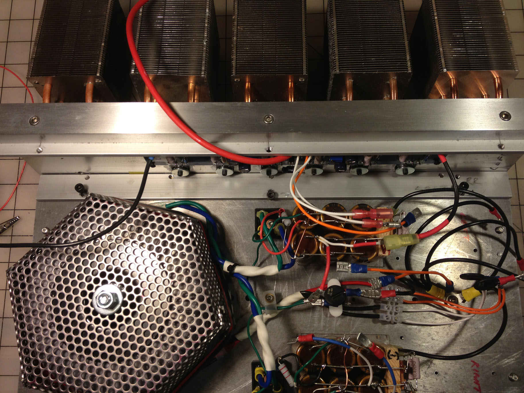

Blue Impala
Hello All!

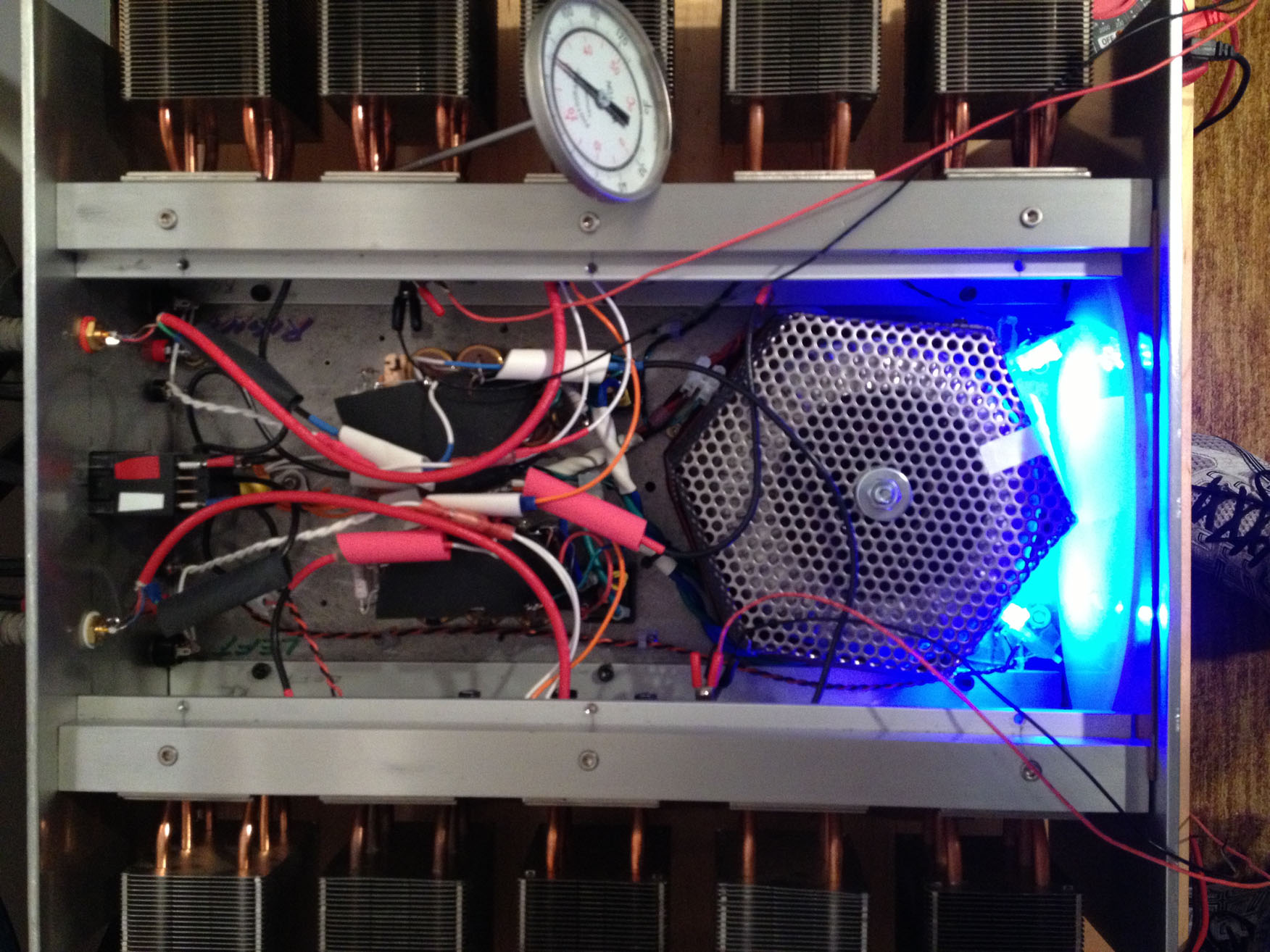

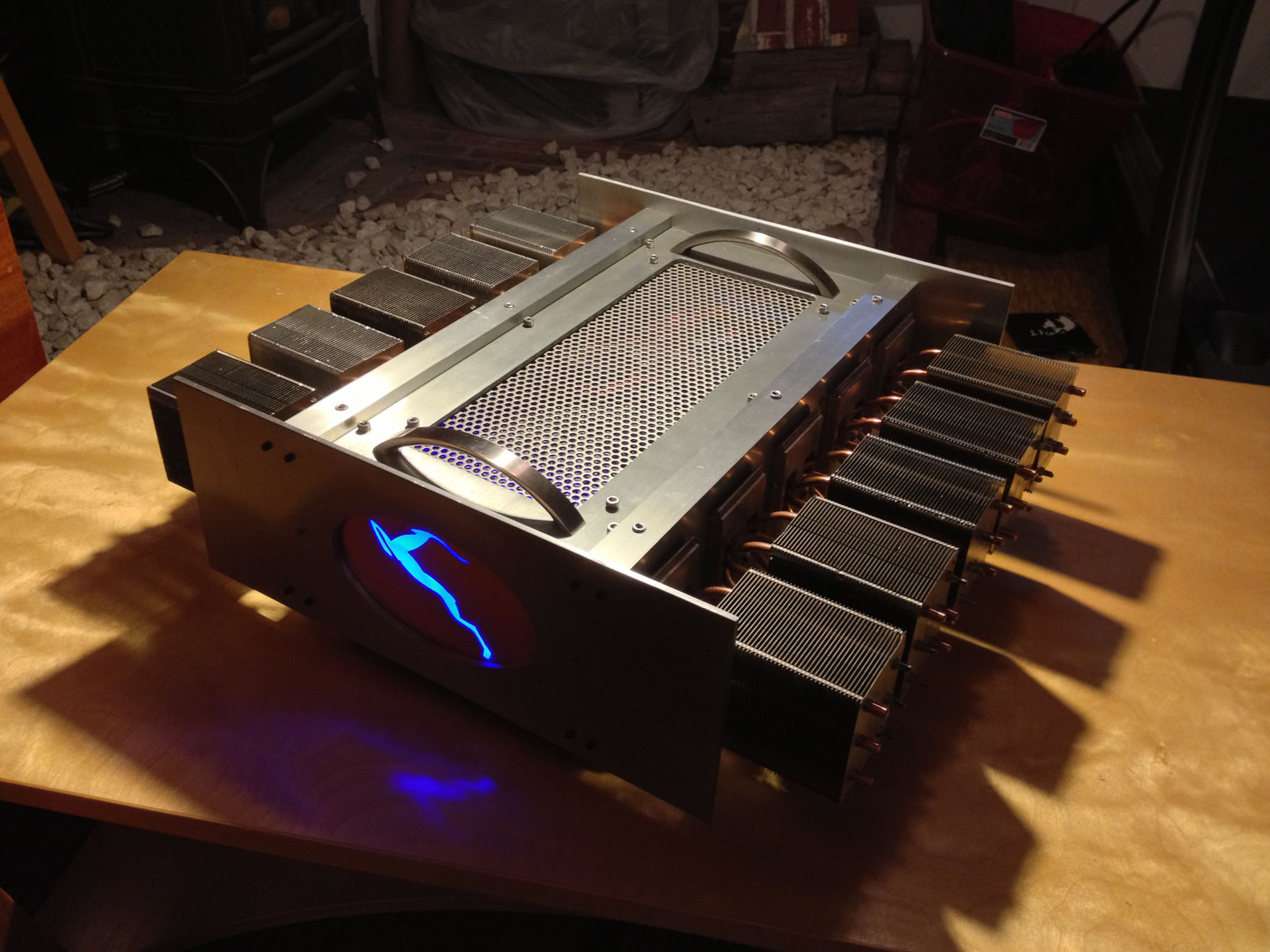

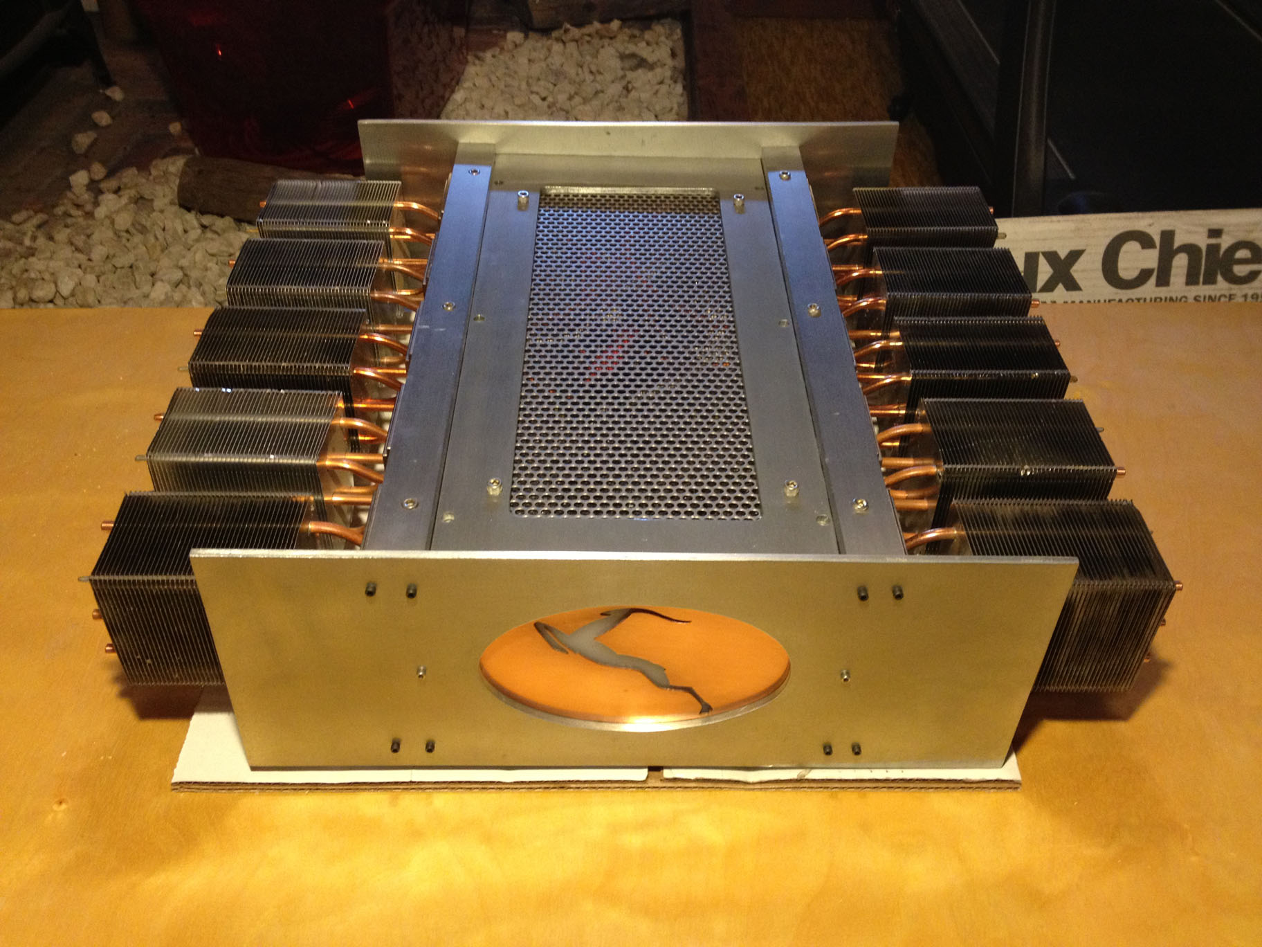

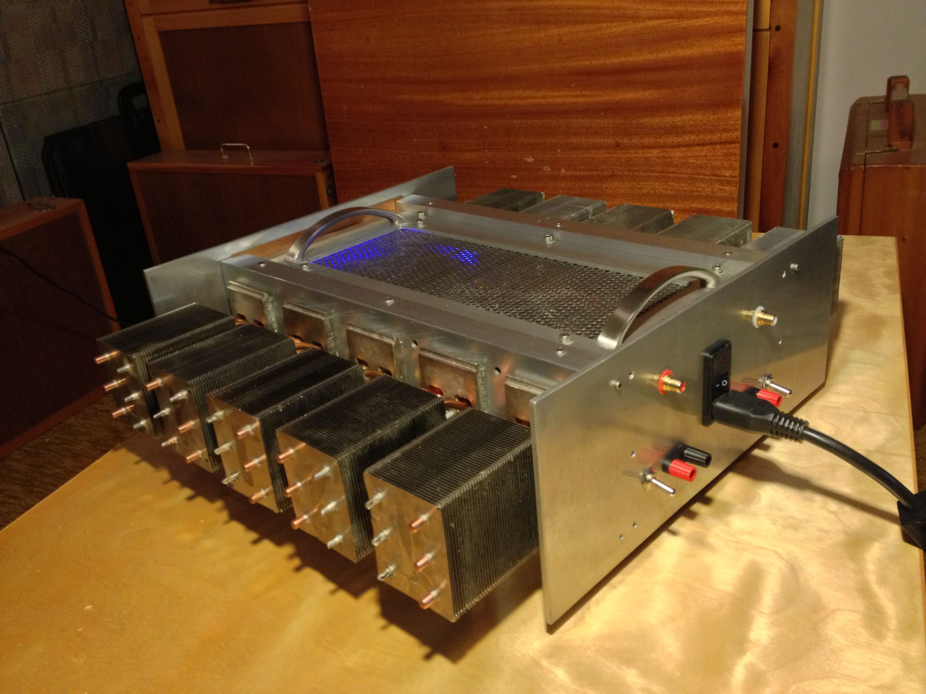

I offer up my scrapyard chic Blue Impala, an F4 just completed.
I am very grateful to so many for their help and especially Nelson Pass for letting loose on the world his John Galt like brilliance, helping folks find their feet. Thanks Nelson, I'm kinda proud of this one 😀
Hello All!

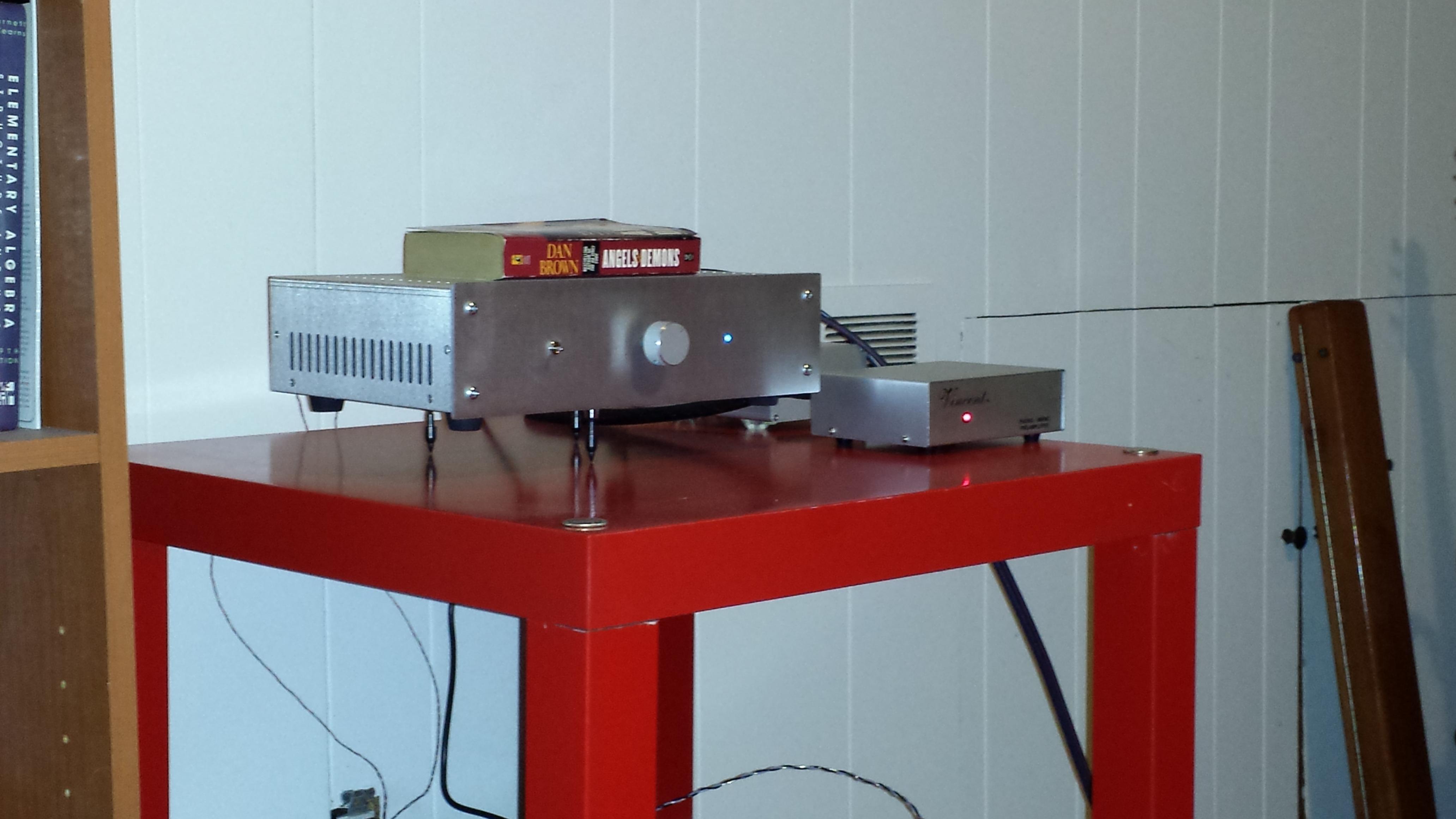

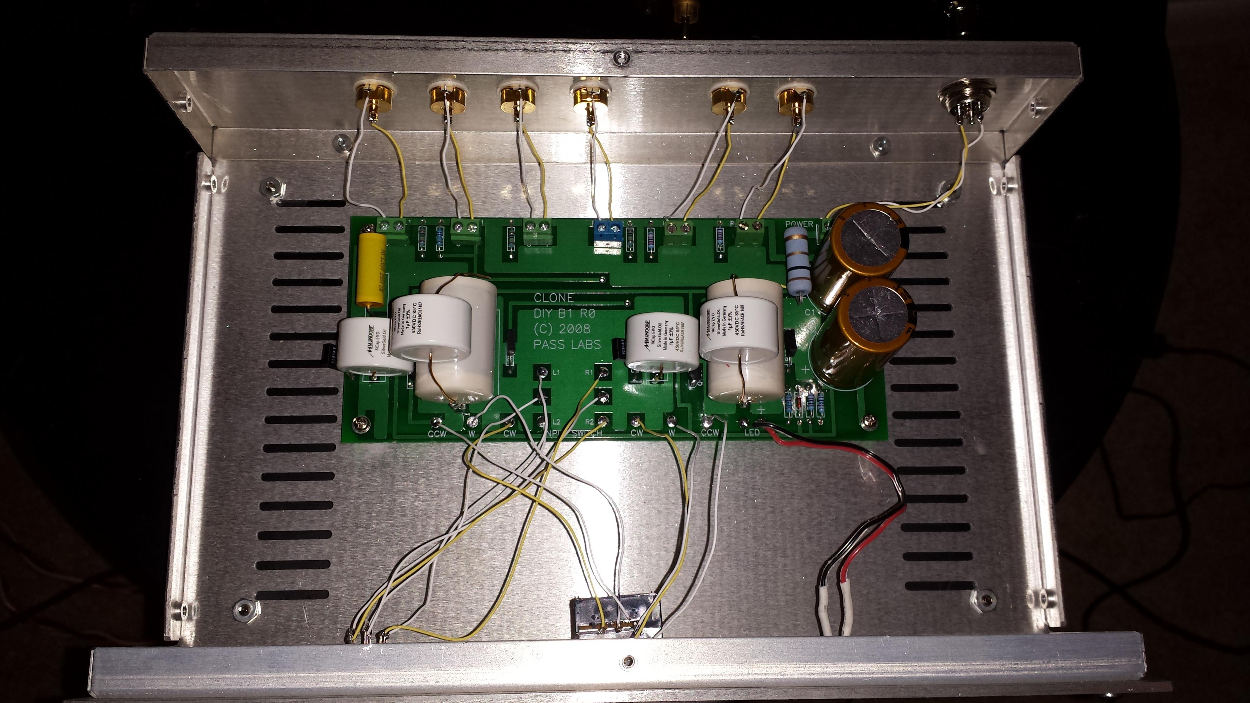

Here's my rebuilt B1. Waiting for stepped pot to arrive. Installed Alps for now.
Other particulars are Mundorf silver/gold/oil and Mundorf MKP caps. Vishay s102k in path. Silver/gold wire. 24v laptop power supply. Building superreg from Jan's boards.

WOW, Never seen an air cooled flat ten before.
It looks wonderful
That's crazy. Nice work! Truly a modern engine.

Thanks vdi_nenna and nice work yourself!
esprit: thanks for the nod!
I guess growing up in the Motor City had more of an effect on me than I thought. 🙄

Nicely done that faraday cage is floating is it not ? RegardsHello All!

Scrapyard? 😱 I think I'm officially giving up DIY.
F4 just completed.
Man. I just love diy. 🙂
Kill me if you can see something like this in some factory amp...?
So original. So cool!
Wow guys, thanks! I am lucky enough to live by a good scrap yard. Even luckier to have the free assistance of the leading members of this forum!
On the homemade Faraday cage I did not isolate it from the main bolt, should I have? It floats above the torroid.
if it floats (no electrical connection to anything but central screw ) , there is no short , so leave it as is
though , you'll have better screening if you make deeper one , connected/based to bottom plate if case , while central donut screw mustn't have connection to it

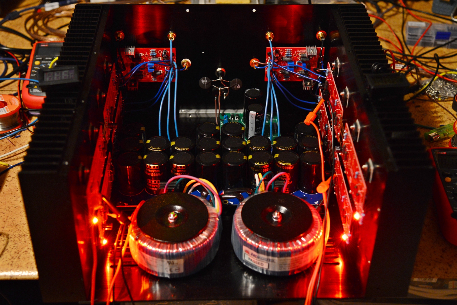

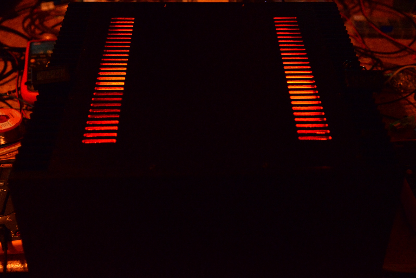

F5 Turbo V3 - diyAudio-PCB's, Toecutter Layout v2.2/v3.0 - DualMono

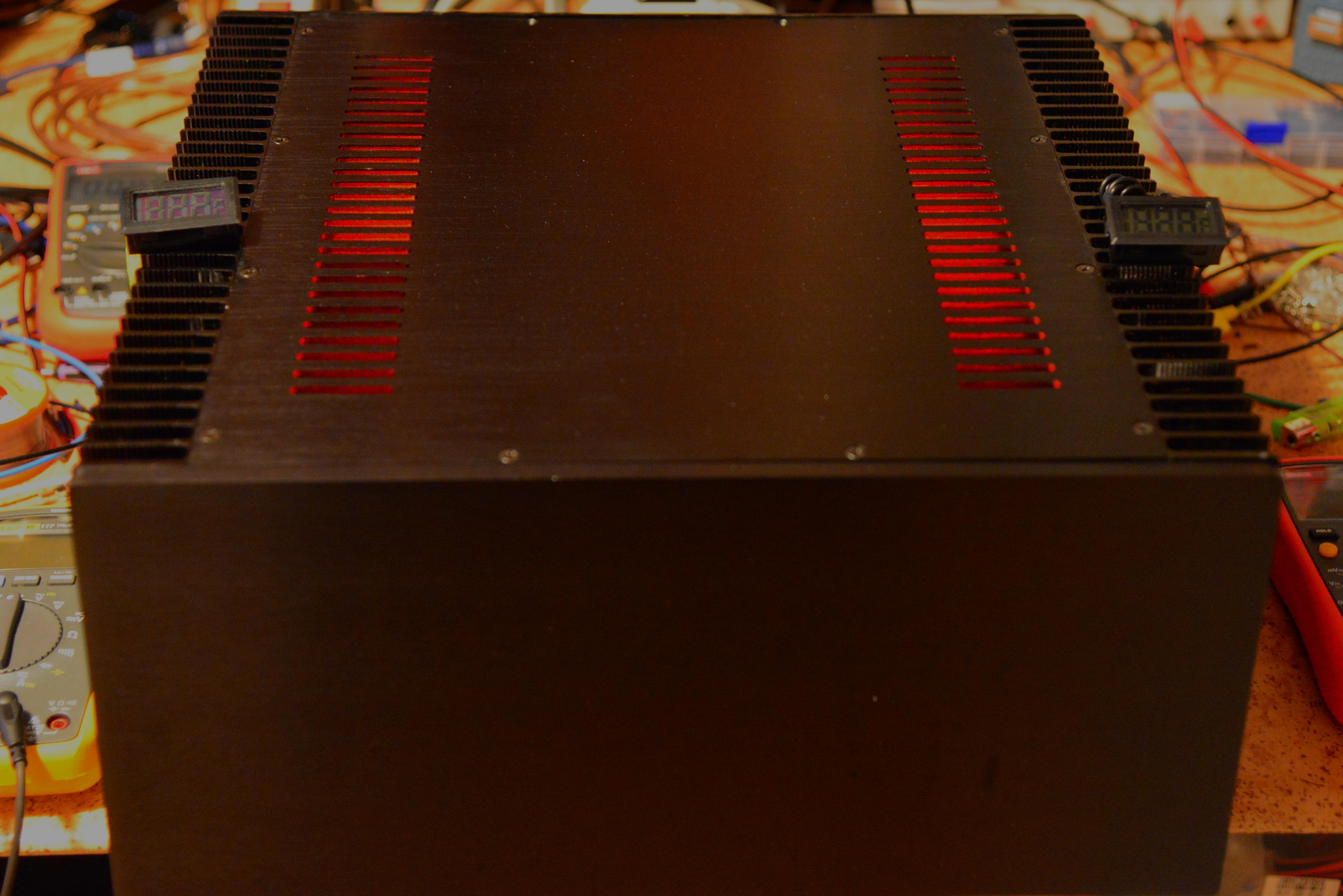

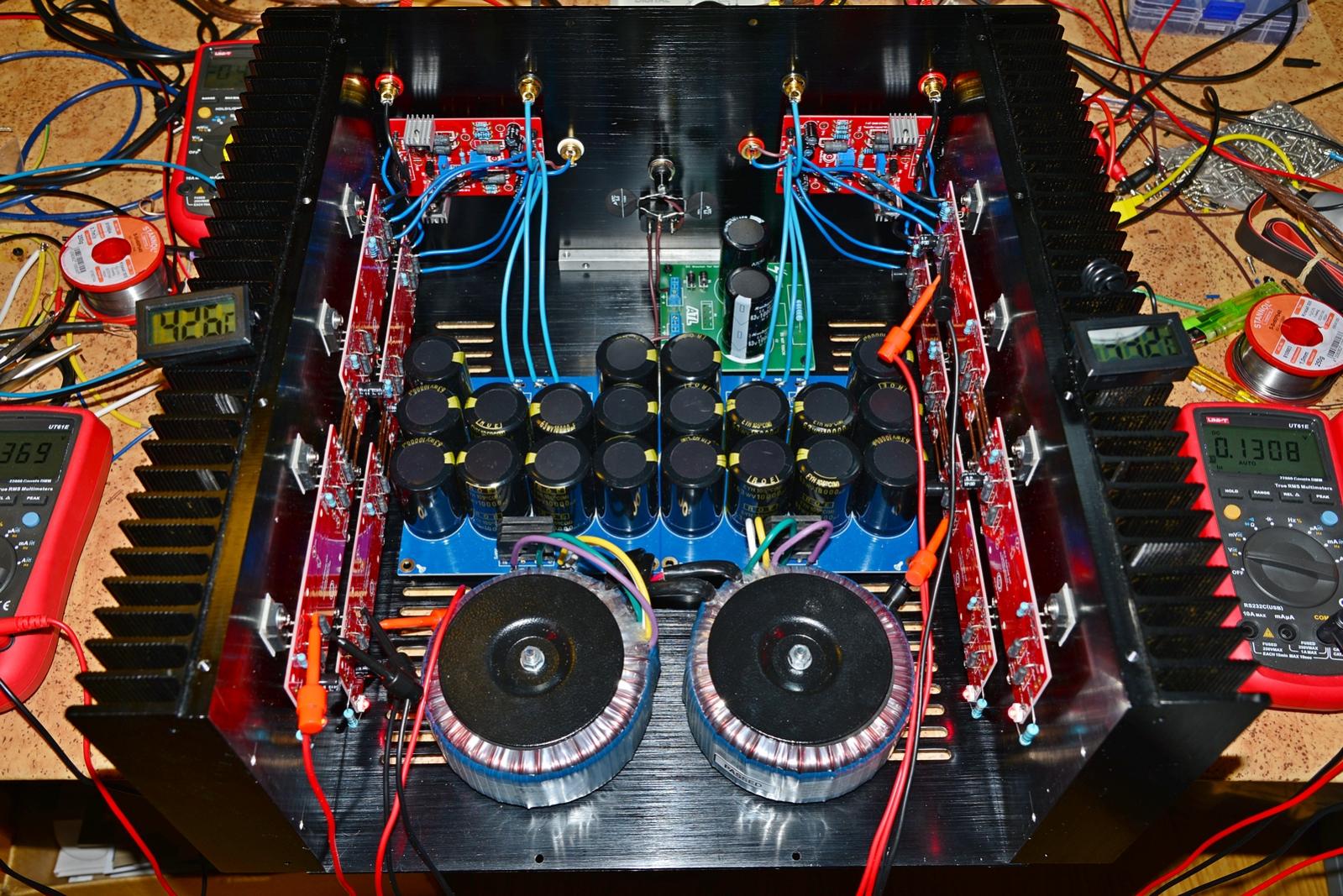

My last project. And I have to say, this amp sounds and measures just insane. Thanks!
