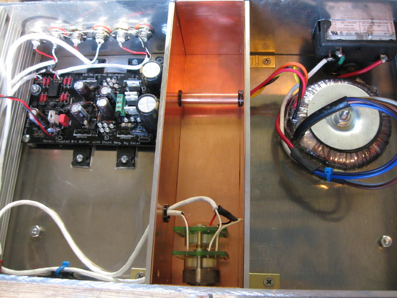

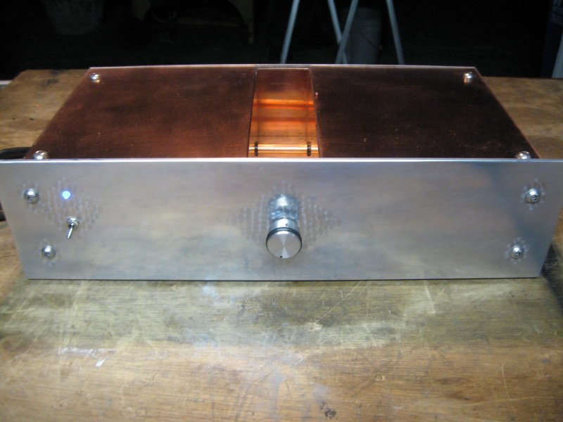

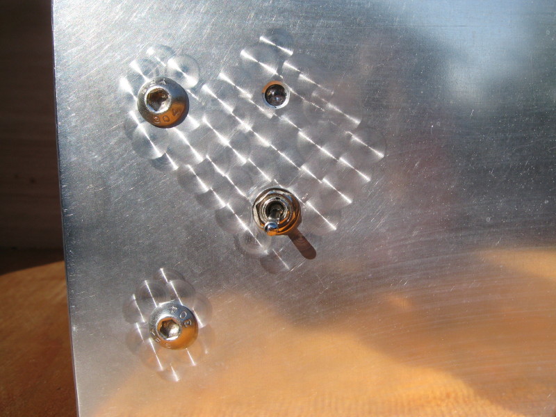

How about a Pass B1, the Hypnotize version, Salas's shunt regulated, direct coupled style.
To answer the most common questions:Why all the copper? A:I wanted to shield the attenuator and circuit board from the transformer and show off the Goldpoint attenuator.
What's with the little circles? A:My DIY attempt at engine turning, I am getting tired of plain face plates. How does it sound? A: I dunno, it is not my gear but I may get to hear it. I built the case and wired it up for a friend. What kind of material is that? A: For the most part, 6061 Aluminum .125 plate. The sides are extruded T-track. The copper is 14 ga., I believe. The top is Lexan over copper. What kind of attenuator is that? A: Goldpoint 20k.
Props to Nelson and Salas for their efforts, I have the simple version of the B1, Pass labs board with matched fets.

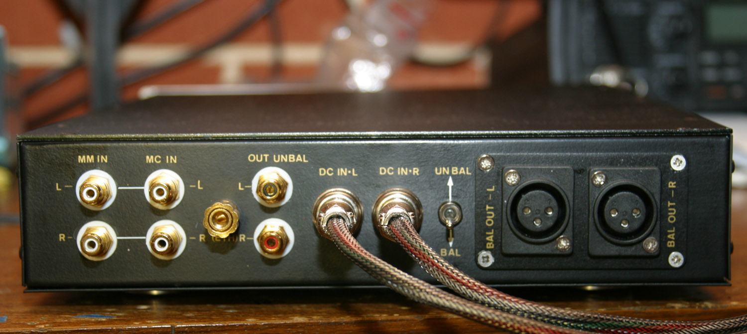

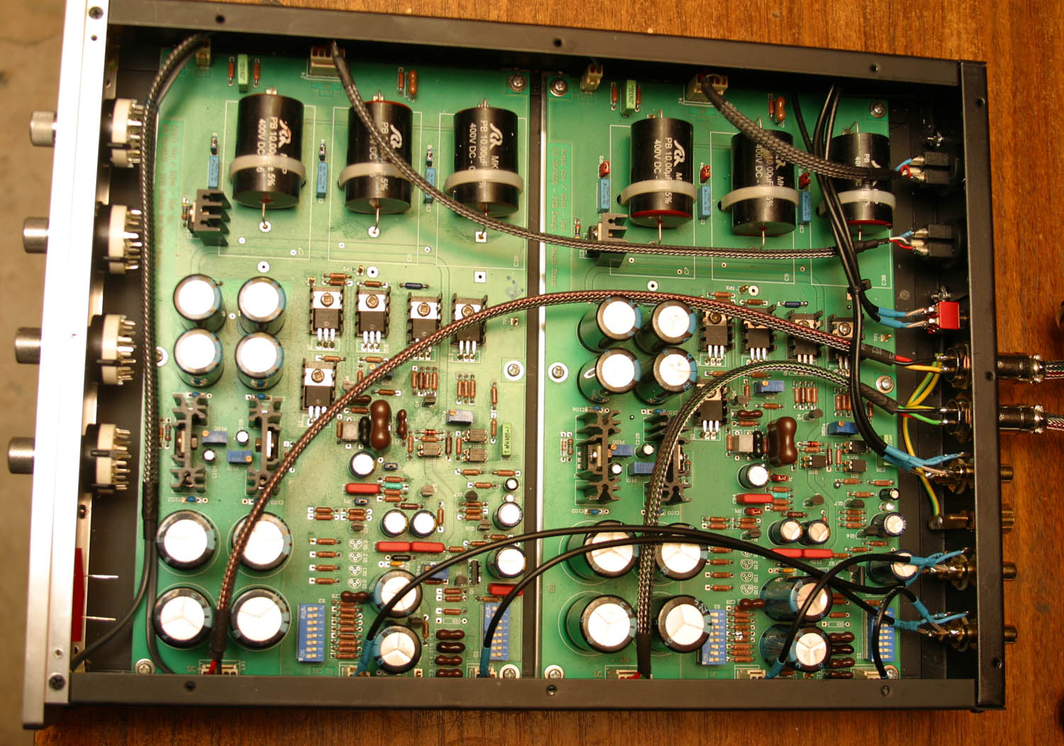

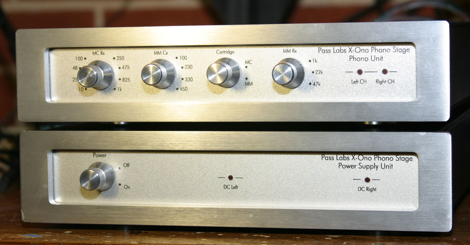

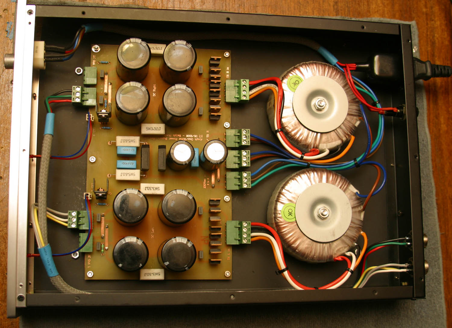

Pass X-Ono Phono Stage

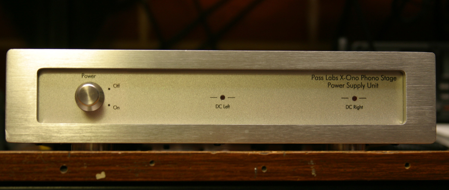

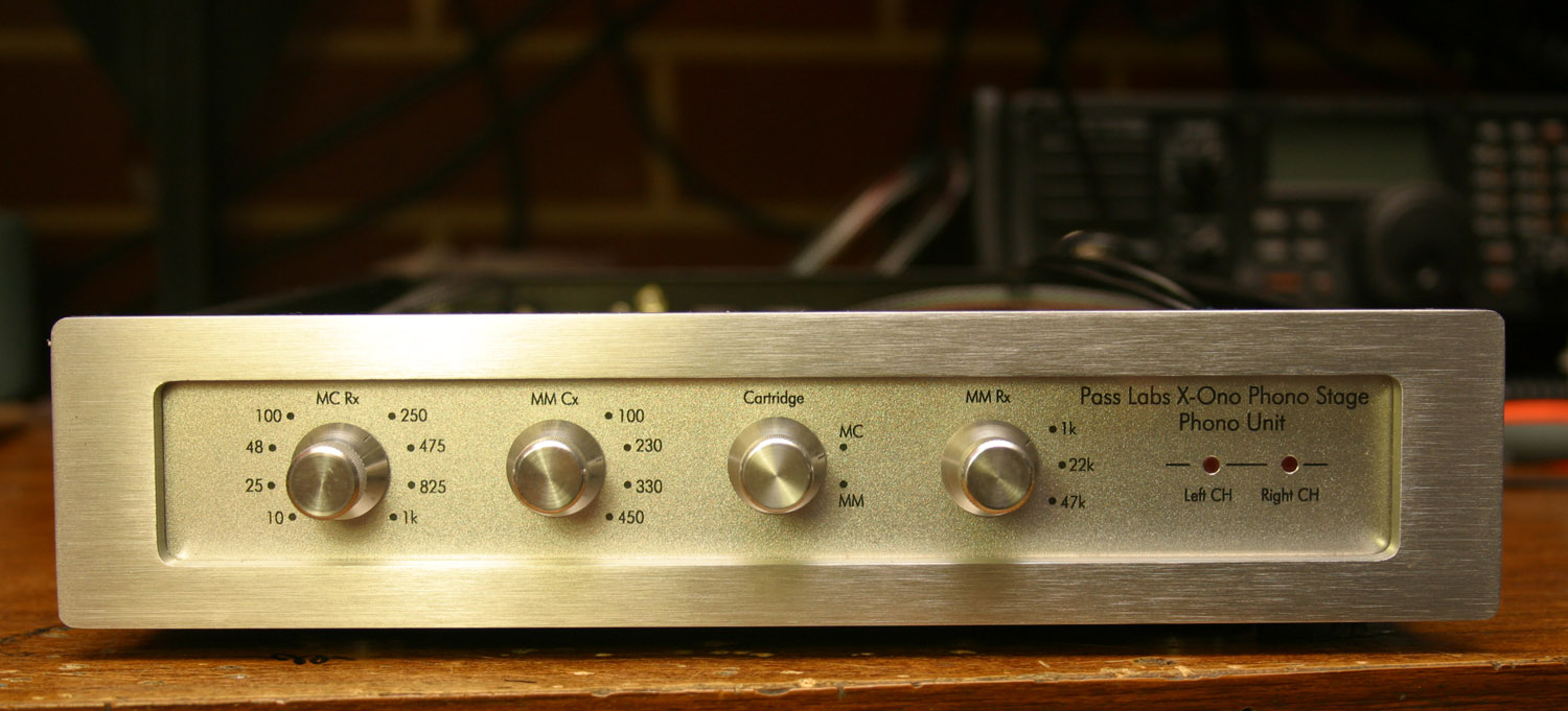

Hi All
Here is my contribution, the Pass X-Ono phono stage.
I started work on this approximately 1 ½ years ago, and I thought I would never finish. Too many other hobbies competing for my available funds.
Anyway, I only have a bit more wiring to go, and the installation of the some components.
I am also making a selector board, based on micro relays, to replace the DIP switches, so I can select appropriate cartridge loading from the front panel.
Hence the rotary switches are not connected to anything yet.
Whilst it will not have the fine control of using the internal DIP switches, it will at least allow some front panel control.
All going well, I should be able to complete it and give it its first test this weekend.

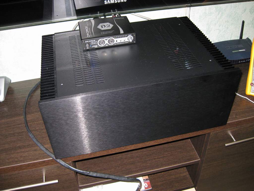

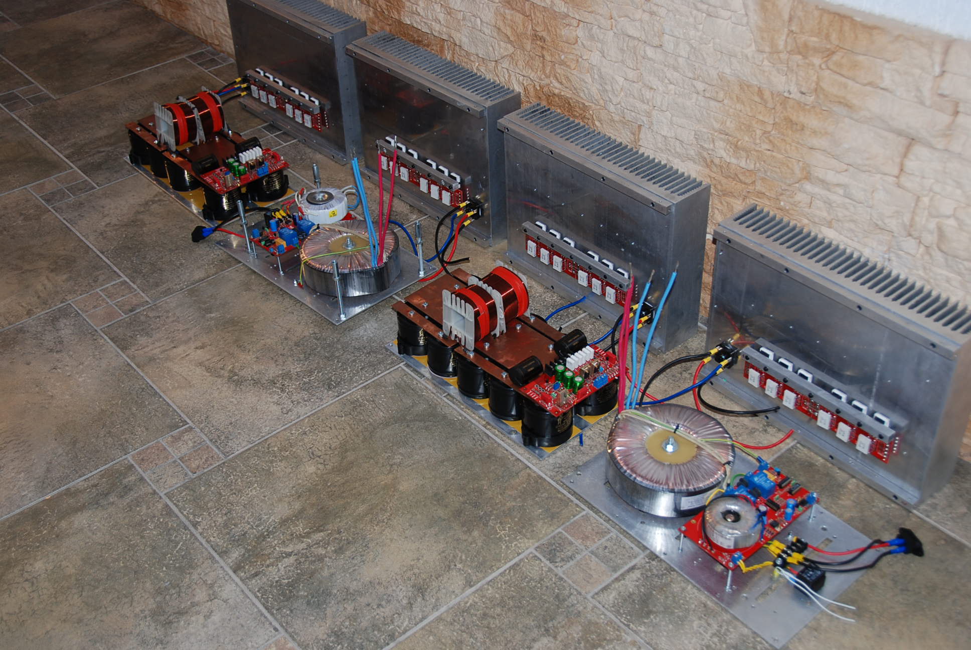

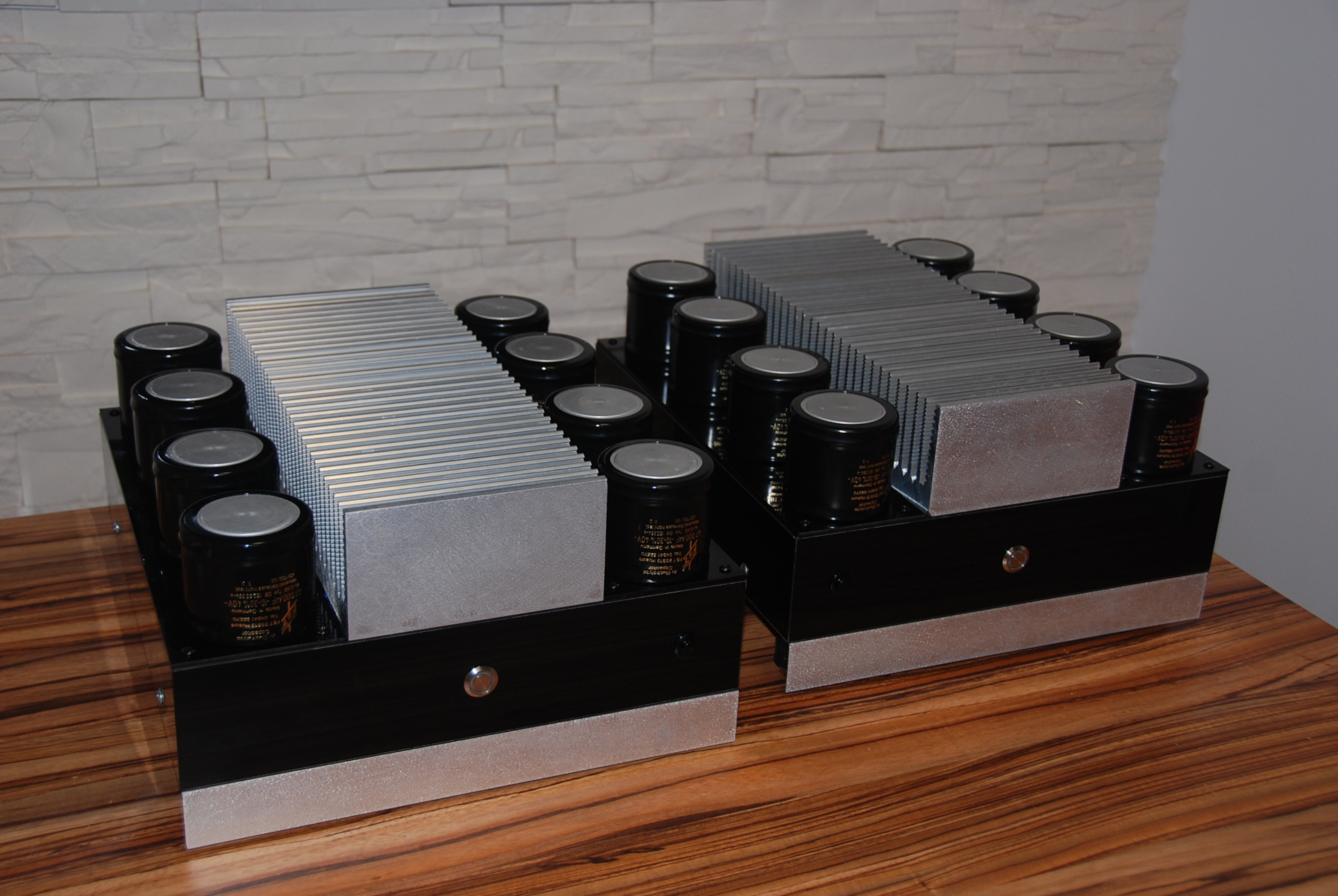

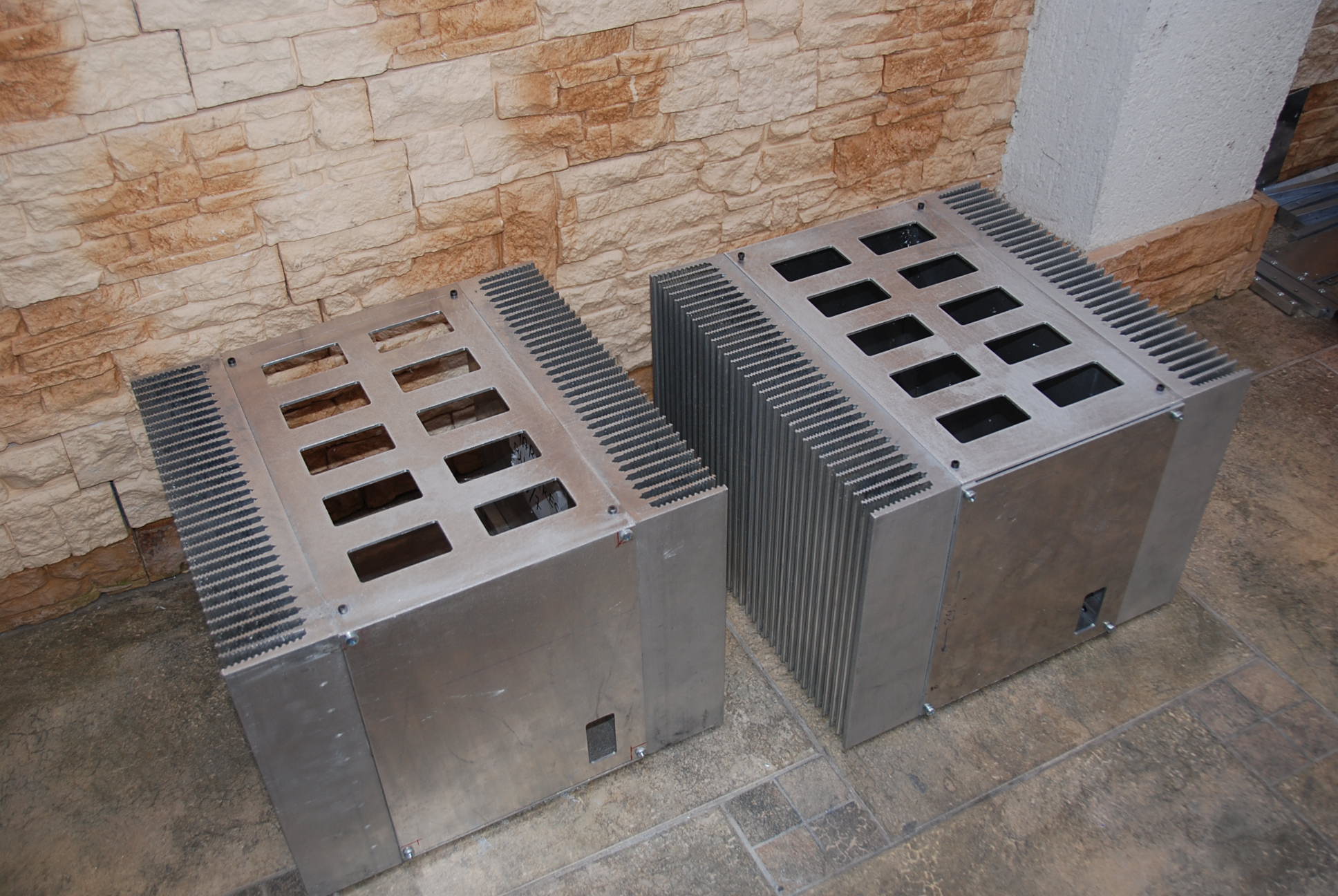

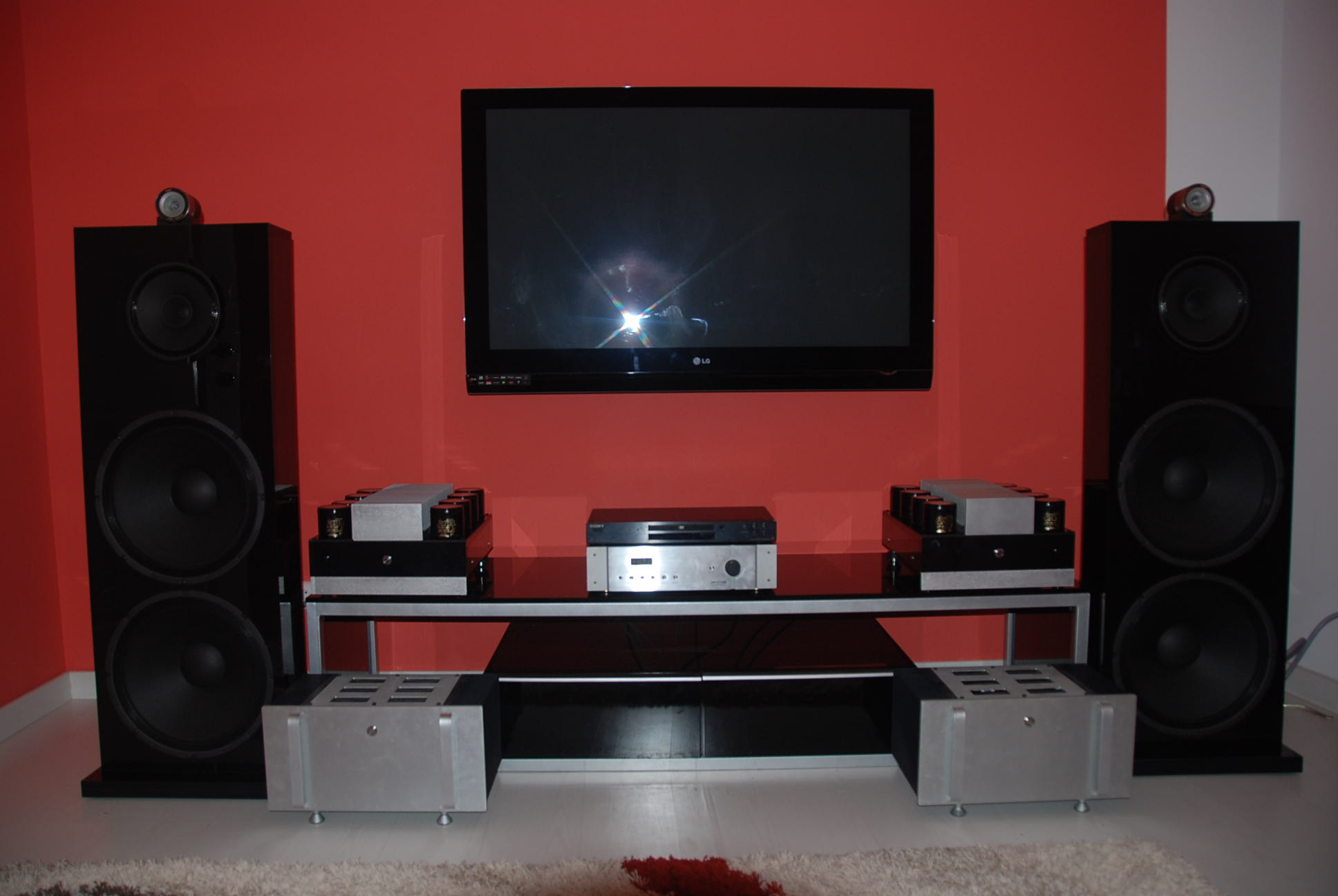

I am a big fan of Nelson Pass!
The Projects I discovered his true sound🙂🙂 ( FX5 ; Aleph 5; AlephP1,7)
I thank You very much!!
Thanks to everyone who supported me with my beginner questions🙂
Best Regards!
Vitaly

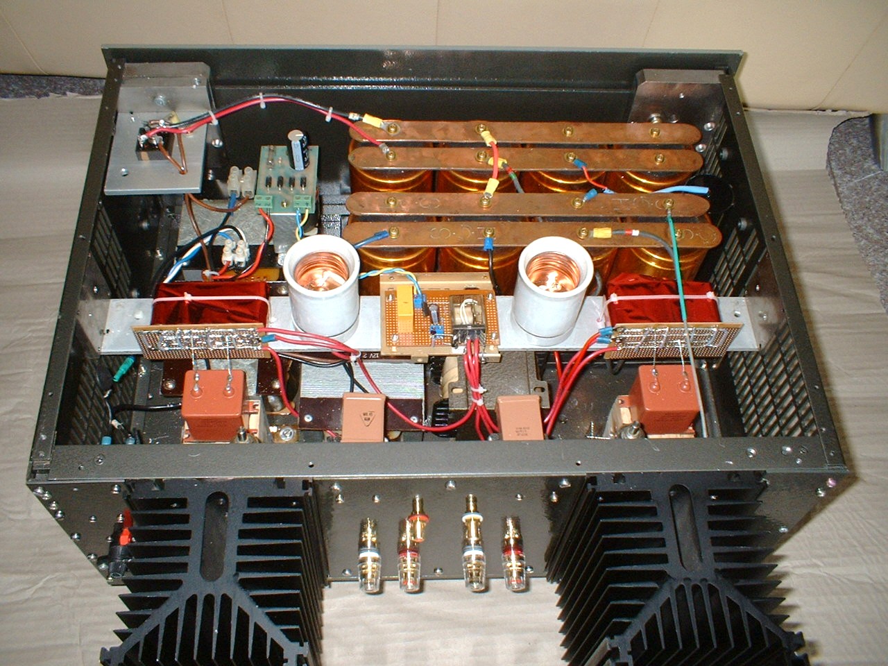

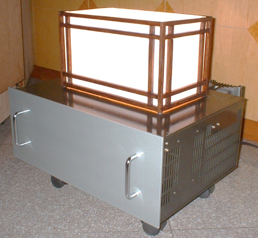

Hi everybody,
this is a special request, as the gallery section of the passdiy is no longer available for the moment....
Hello,
Long time no see..

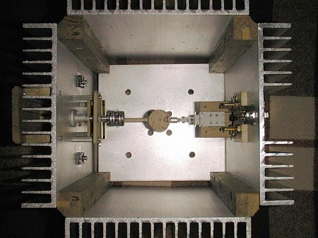

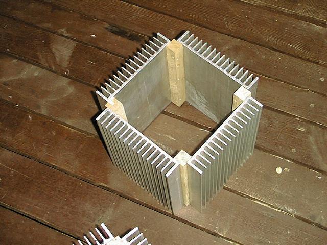

Here are some photos of my first Nelson Pass: Son of Zen (1999), modiffied to f-4 (2008).

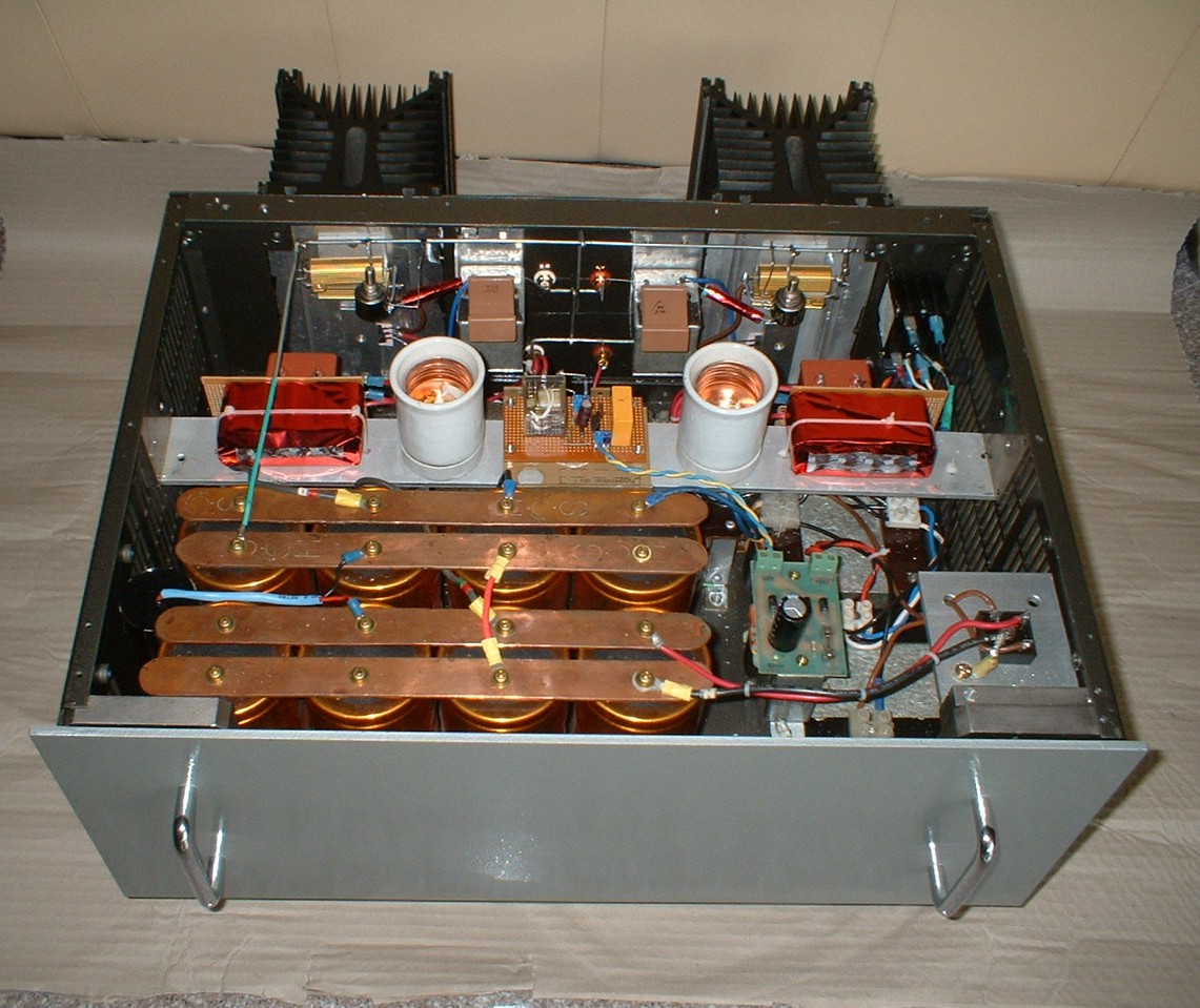

Finally F3 Re-Boxed
After getting my F5 built, my F3 had to go into the shop for some new, larger heatsinks to better handle the heat loads... Here is the result (yes, another Peter Daniel copy!!):
