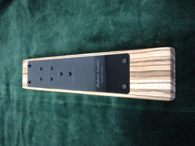

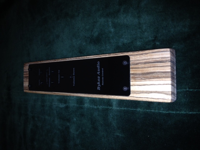

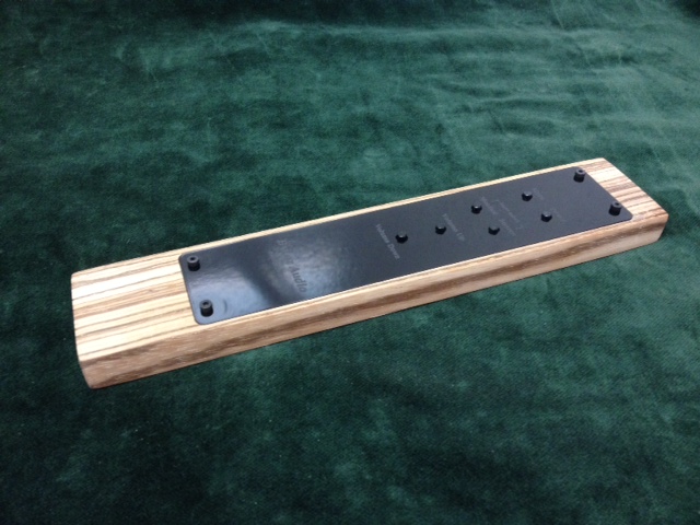

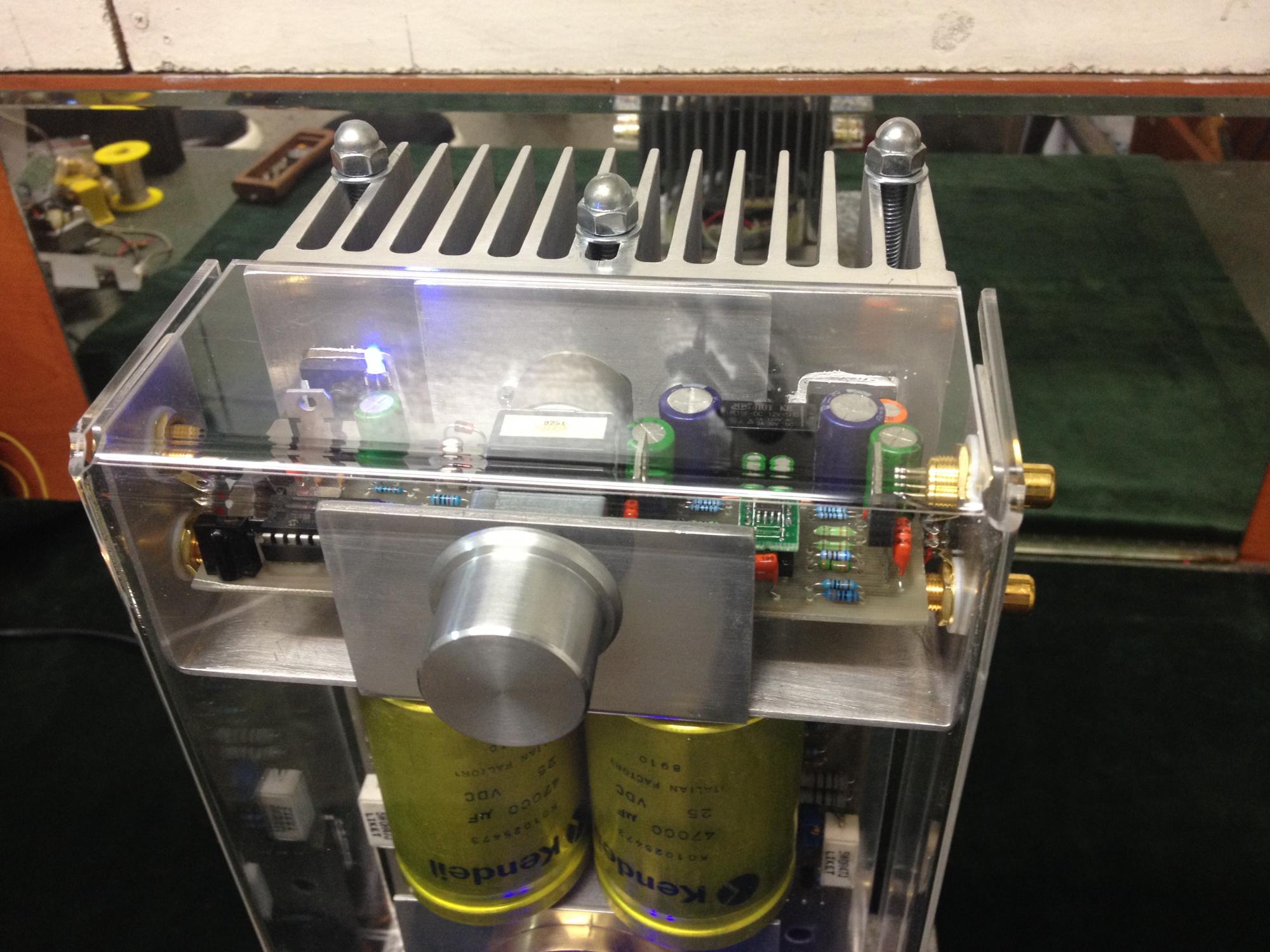

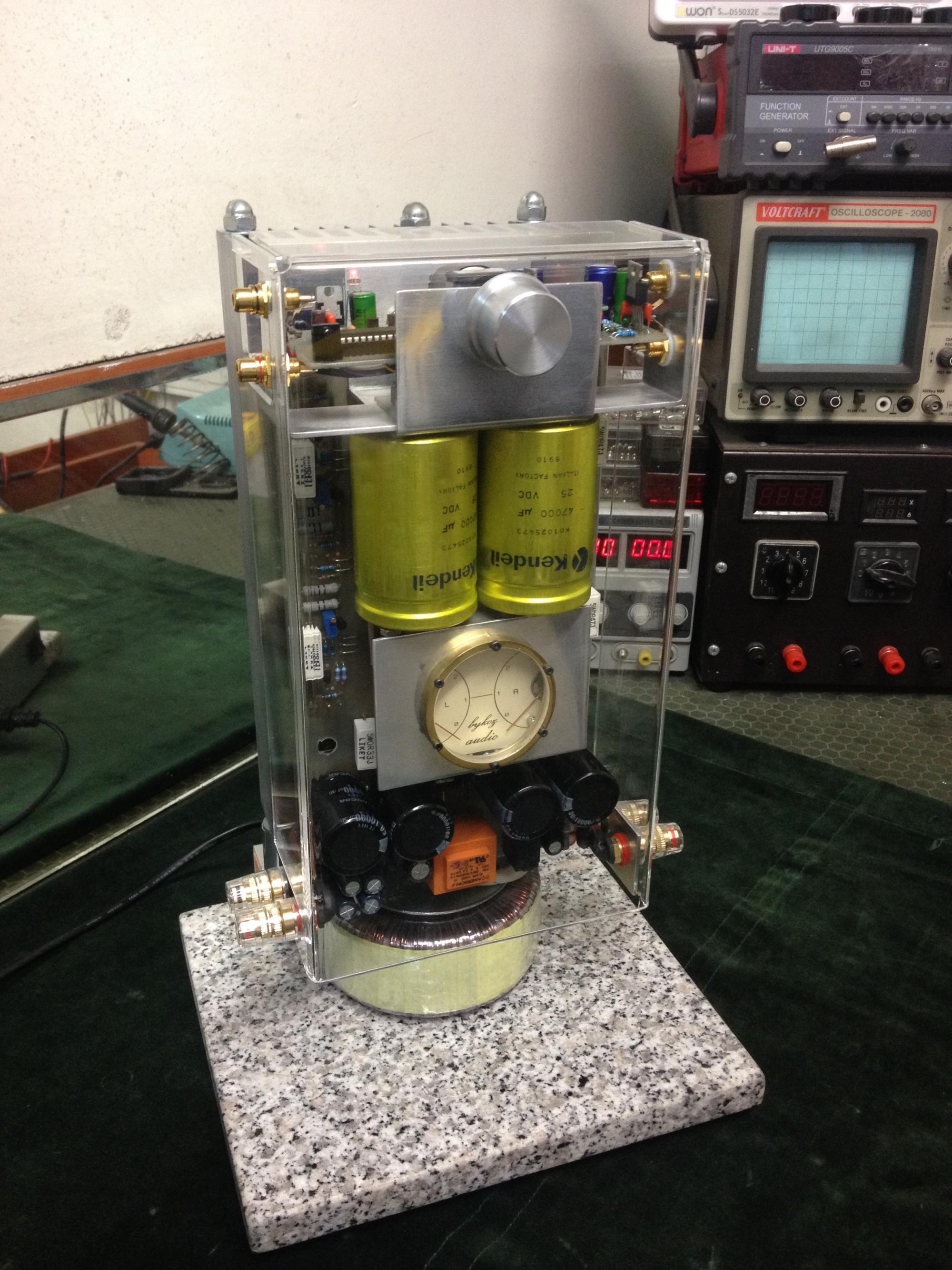

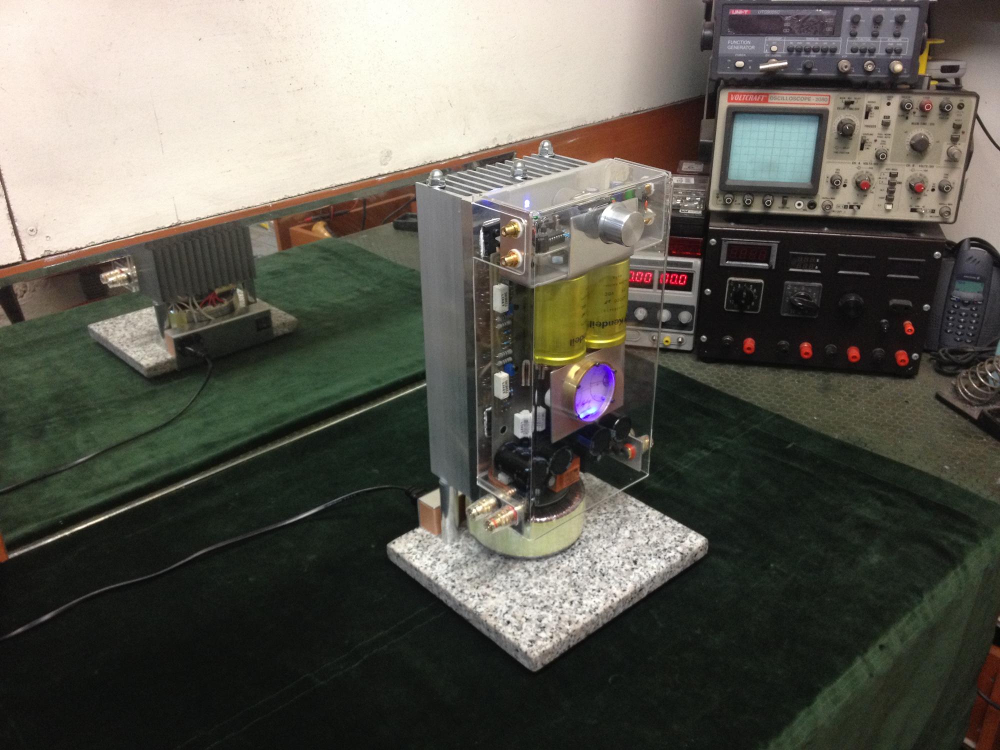

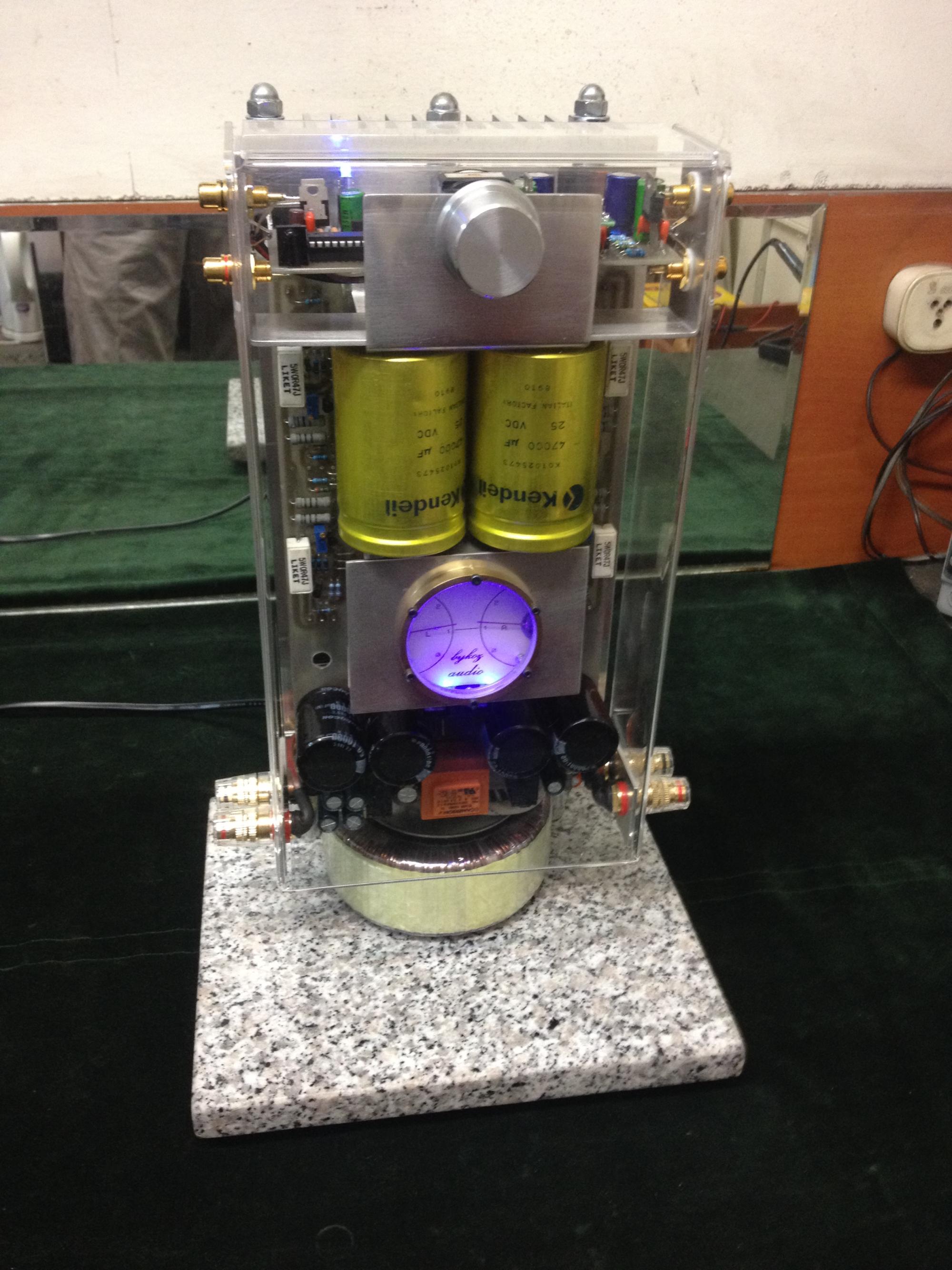

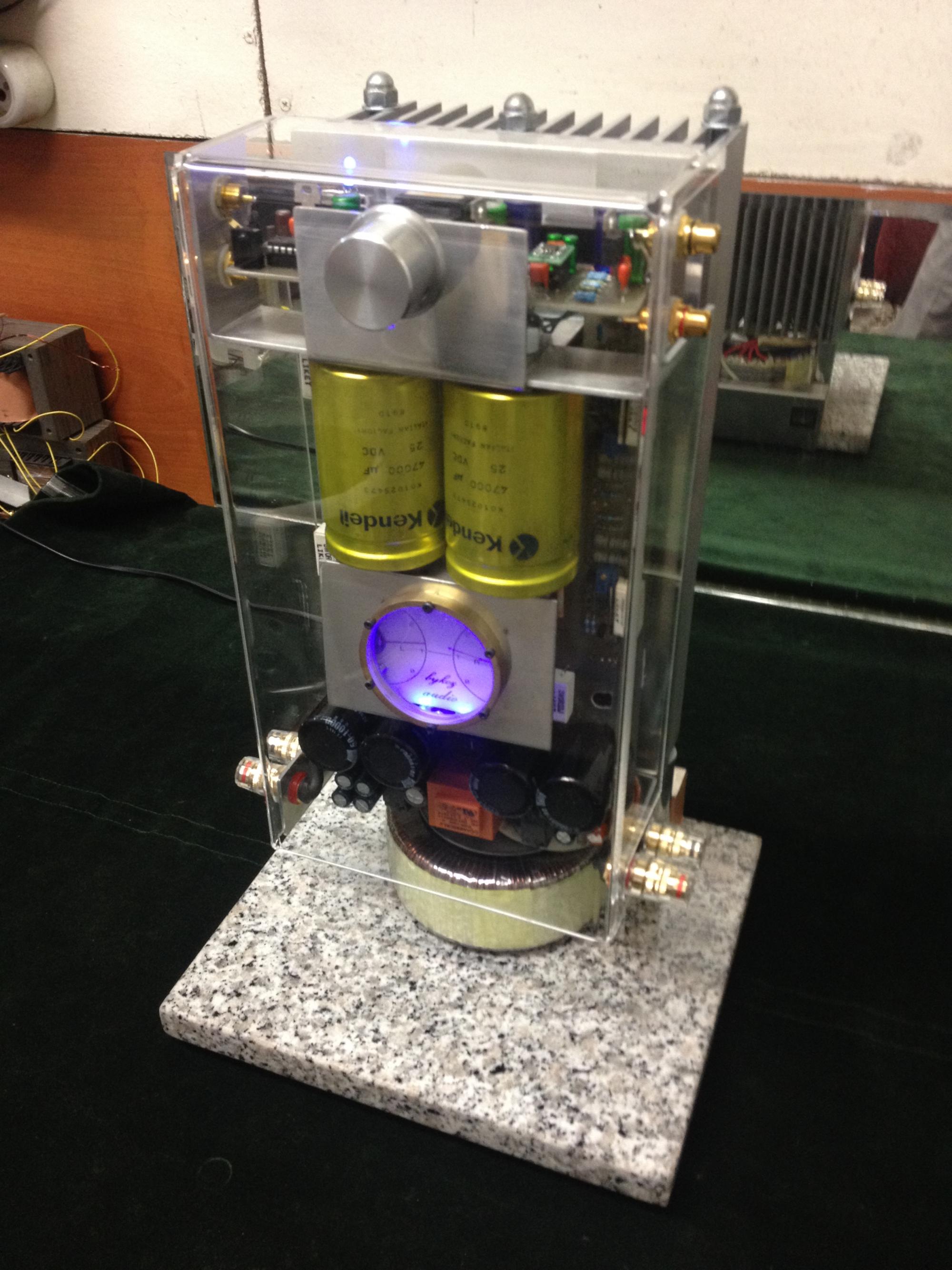

This is my latest F5 amplifier build.

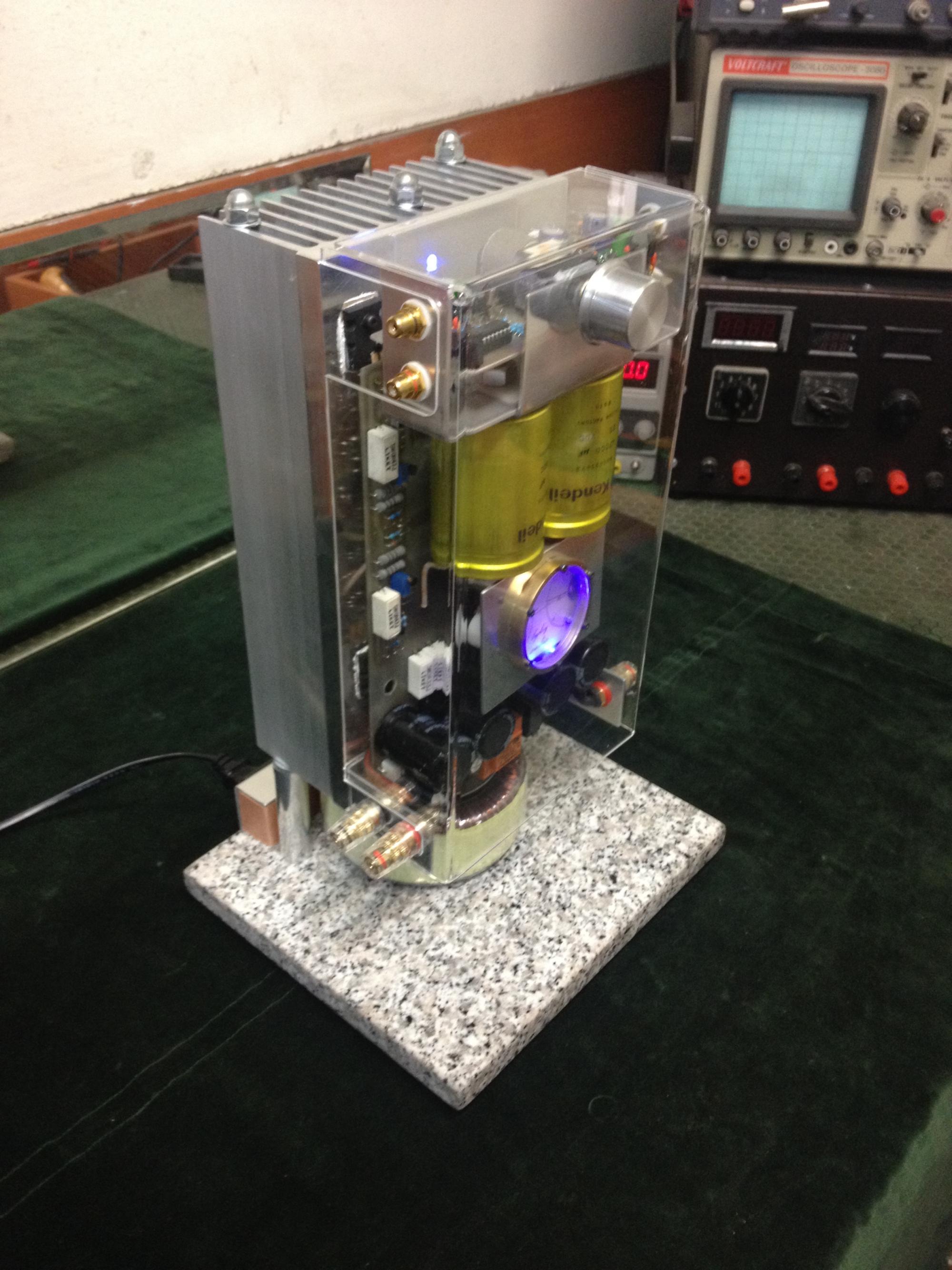

Its my traditional Tower F5 amplifier so far i have built 3 of them the last one with bias indicator of each channel.
As usual it hase two big can 47 000uf Italian Kendeil capacitors plus 4pcs 10 000uf Rubycon capacitors to boost bass performance.
I powered it with 300va transformers , i use 300va transformers in all my F5 amplifier and up to now i find 300va sufficient for F5 . The amp chassis meanwhile it is the only heatsink on the amp roated on the granite bottom with 2cm tick.
It has integrated pre amplifier with two opa627 op-amp with 10dB also remote control of Sony protocol with Alps motorized potentiometer.Tower has 2 independent input you can sellect them fom remote.
the output mosfets are Toshiba 2sj201 and 2sk1530 and i find them more colorfull over irfp series.
For those who want to control his systeam with remote i offer control board or remote on eBay
here it is

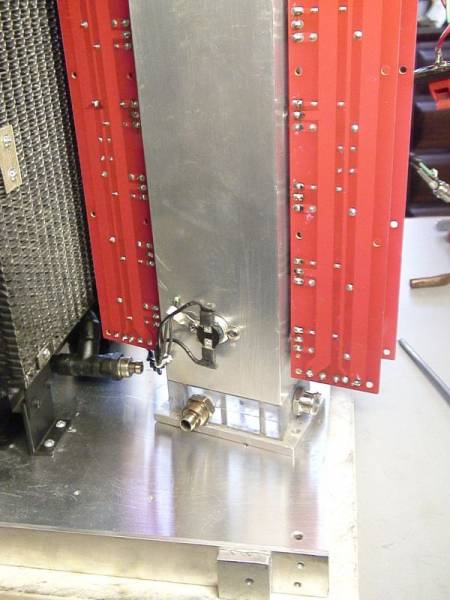

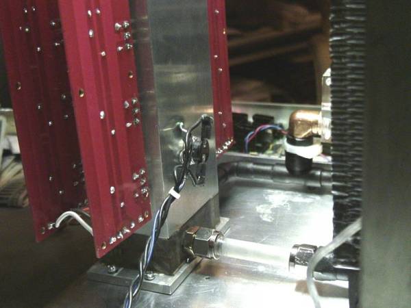

This is an example of what Andrew describes. It's on a water block but the function is the same. This unit opens ~ 78 C and has tripped only once when the fan power (small DC transformer) was separated from mains circuit - and I forgot to turn it on 😱
