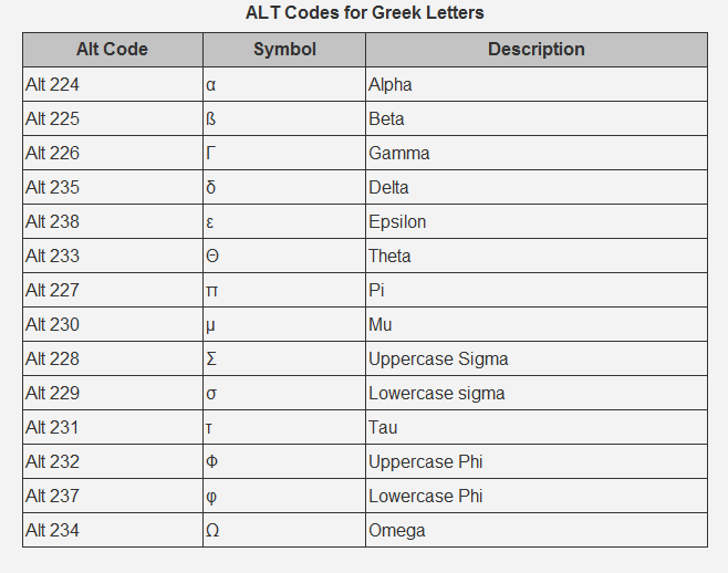

In windows computers <ALT>230 will generate the character µ and avoid all confusion.
Press and hold <ALT> key while typing 230 on the numeric keypad. It does something else if you use the numbers on the main keypad.
Cool - remember seeing that often but never really had a practical application for their use. Now I'm gonna study hard and become an ASCII ACE. 😉
