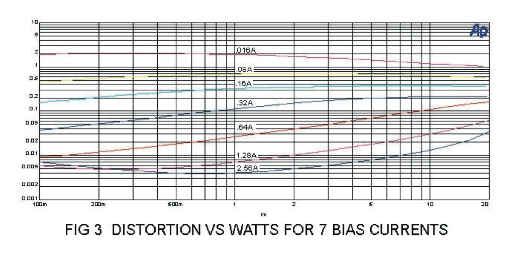

McBob,
that quote says nothing about an optimum minimum temperature.
Pass is generalising about the reliability of output stages.

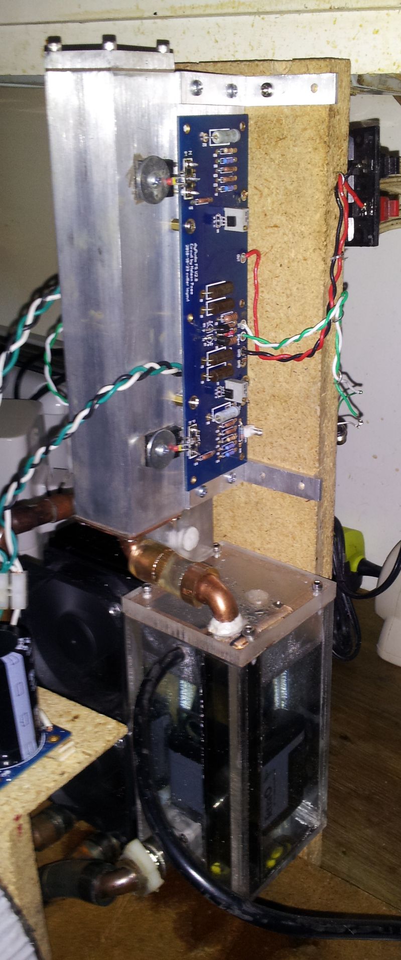

That's when I considered low operating temps. Now whether it is the power transistor itself or the output stage as a unit, I had never experienced any amp measuring that low.
The new system is already disassembled for improvements, but today I was able to attach one board to the aluminum tube with no water flow, simple metal mass heatsink. There is none of the distortion that was present at the initial full flow test. I'll know if Mustang Sally is the cause of the problem once I get the smaller 120 mm fan and radiator installed. The F5s sounded great using the dual 80 mm liquid system I mentioned, but the heat removal factor was less than air/convection without increasing the fan speed to an annoying level. Certainly not adequate if I eventually want to take on a BA. 😉

Comparing your water cooled setup to a conventional heat sink, I can't imagine that the distortion should be that noticeable with low operating temps.........it should be the same as a conventional heat sink for the first five minutes or so of operation, since the heat sink will stay relatively cool until the FET transfers lots of heat into it.
In both cases, nothing is ever cooler than room temp.
Consider a conventional setup on startup, the heatsink has lots more thermal mass than the output FETs, and they both start out at room temperature. The FET transfers it's heat to the sink via conduction, and slowly over time the sink warms up to an equilibrium point where it can lose the heat to the surroundings via natural convection at the same rate that it's receiving heat from the FET. From the FETs standpoint, several pounds of aluminum will stay relatively cool/cold for the first few minutes of operation.
I understand that a typical amp's distortion can measure better after reaching thermal equilibrium, but in your case the amp reaches thermal equilibrium relatively quickly, as you don't have much temperature rise with water cooling.
I suppose one way to test this would be to bolt a few output FETs to a block of ice, or better yet, a block of dry ice......
Hopefully adding the constrictor valve will also help verify the effects of temps on distortion.

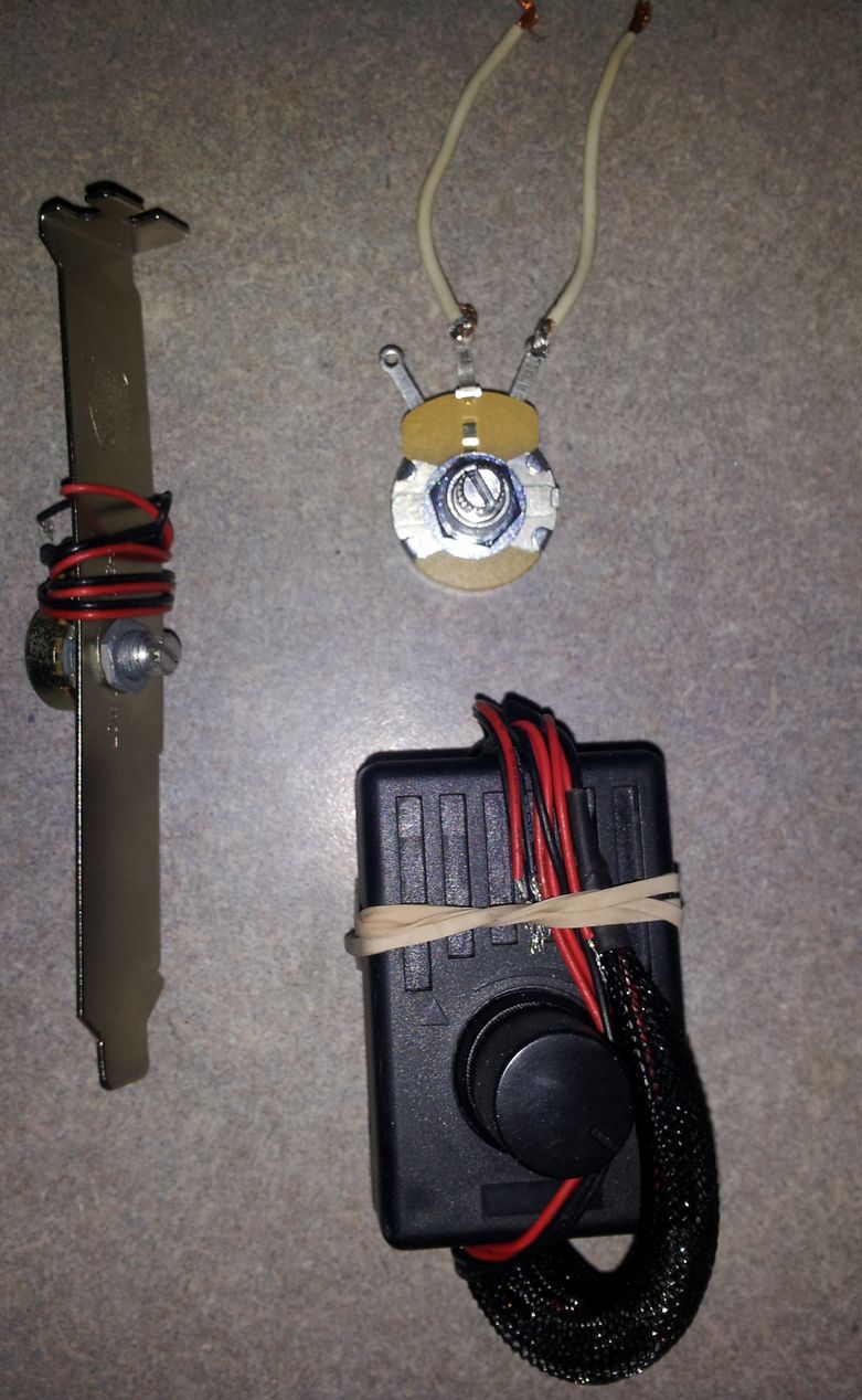

Andrew - Just did a Google search for "air flow mixer" but couldn't find any design info. Can you elaborate?
BW -I'm soldering the plug to use the 5 volt PS for both fan and pump as we speak. I bought a speed controller for the project but it is defective. I have two rheostats to try but not sure about the correct resistance value to use. The pump specs are 12V 10w and the fan is designed for speed variations so there shouldn't be a problem.. I'll have something hooked up later today.
xrk971 also suggested and I believe is working on a siphon cooler but for much smaller amps.
I'll have more to report in a couple hours.

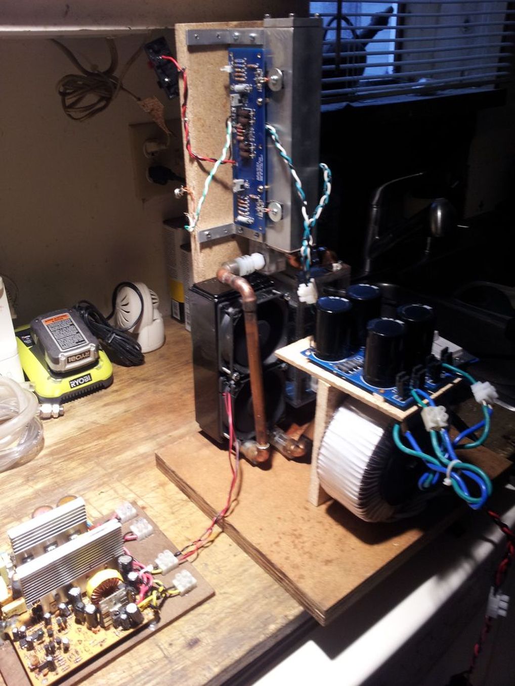

A busy afternoon. Everything is modified as I had a pump failure, probably due to trying too many different voltages carelessly. Fortunately I had a backup, but it was the louder of the two and has a higher flow rate. So I couldn't duplicate the initial tests exactly.
What I did find was encouraging and productive. With the fan on 5 V and pump using the 7.5 volt wall wart, temps reached 63 C on the bolt and 51 on the cooler. The pump has a 25 ohm pot and was set to highest speed.
Running both pump and fan on the 7.5 PS, and the pump at it's lowest speed a good operating range was achieved. The bolt settled at 47 C and the cooler at 38. A measure of the heat removal rate involved powering off the amp at 54 C and it took 30 minutes to bring everything back to 27 C ambient. In short, it's logically more effective to make sure the cooling system is avtive at power-on - as compared to trying to bring temps down.
One new problem appeared with the pump. There isn't enough power to start rotation at the low setting. It's necessary to initialize at the high current and dial back manually. I need to work on that.
Even with the louder pump and the higher fan speed the noise level is completely acceptable. I did a few recordings to illustrate. Remember the fan draws in so what noise there is will be dampened by the chassis.
