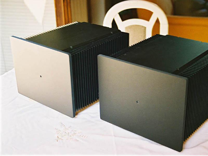

Hi everibody!
I`m hapy today. Finished my aleph 2 monos. Thanks N.P. MarkFinis, Wayn S. and GRollins. Specialy Mark for beeng ease on me and my never ending questions. Amps works exelent. All values in limits. Bias 2.7 - 2.8A. Hot but not criticaly to 65°C. (BTW - my input fets (to-220 heatsiks) including Q1A5 are extremly hot - cant touch - Voltage over Zener folow.Q3 is 9,5 (9V nominal) voltage on the source of dif.input pair litle low(3.5V) -NORMAL?).Picture of front: Sory about pour quality!
rgds Marjan

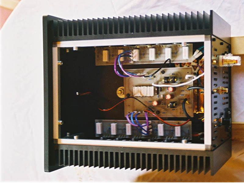

I`m glad you like it. General data about chasis.
Front plate 10mm balck anodized AL, cover plate same as front, heat sinks 200x300mm per side 40mm fins on 10mm base plate from MALI ELEKTRONIKA in Slovenija, bothom and back - 2mm cooper plate painted black, toroid coverd front and top sided with cooper plate. Dim. 300x300x220mm weight 25kg/piec.

Milan Hi!
132 000uF per chanal. Samxon from China. Standard quality low price. I`m aware that I`ll have to change them in a fev years, but I wanted to be shure first that I`ll be able to implement N.P. desigen properly. Allways time for tuning.

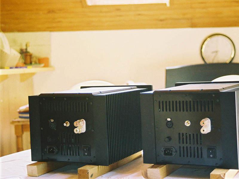

feet
Since nobody has made a comment about the feet, I would like to make a suggestion. I learn this from HPotter/Peter Daniel. Cut eight 1" length from a 1" diameter broom handle (or aluminium, since yours looks so good) and attach it to the bottom plate of the 2 amps. It works very well.
I'm assuming you're still waiting for the feet to arrive.
