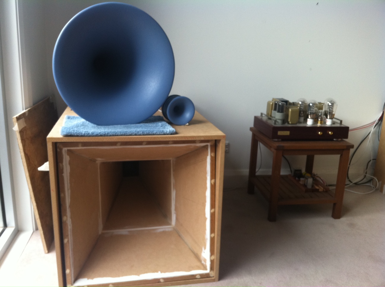

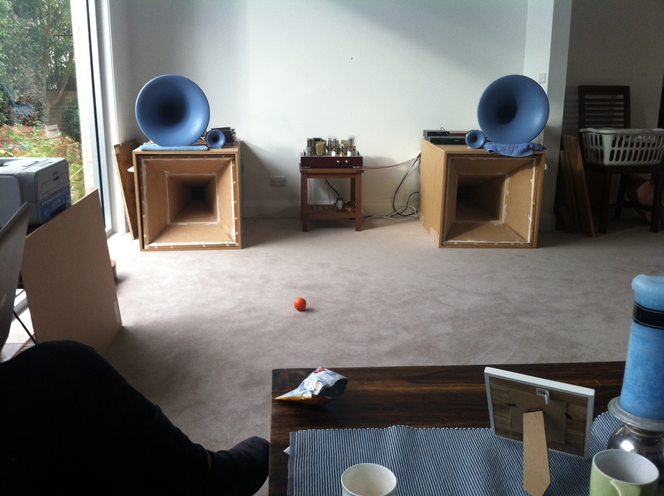

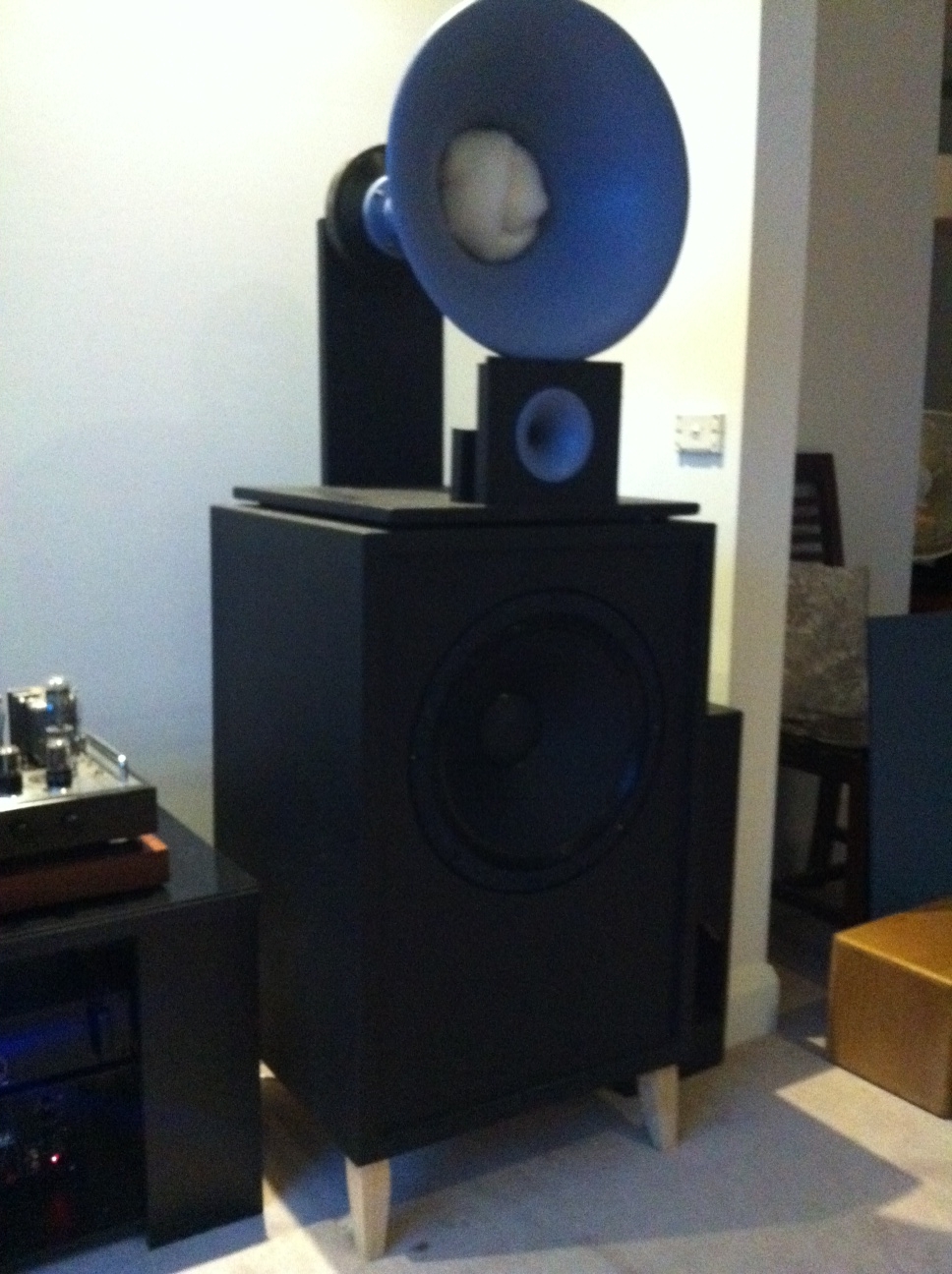

Pics of new 4-way horn rig underway

I don't disagree with you....just trying something 'simple' for a change.
With the Stereolabs, I'll probably build another down the track featuring:
Tweeter horn (3,000Hz up),
Mid (700 to 3000Hz)
Upper bass (300 to 700), I'll try the 140Hz horn suitable for 4 or 5 inch driver. I', thinking this model because the 100Hz horn is $3500 each vs $900 for the 140Hz.
Mid bass - probably one of my GOTO designs or an Altec front-loaded horn, from 90Hz to 350.
Subs - whatever. Either small tapped horns or something more exotic/bigger...eg Inlow design.
Also, I like the look of the Decware multi-way SET amps you can buy as kits. I could run six channels of SET to drive the top three horns...then separate Solid State amps for the bass units. Easy.
ZKIT2 / Zen Triode SET multi channel tube amplifier kit
Cheers

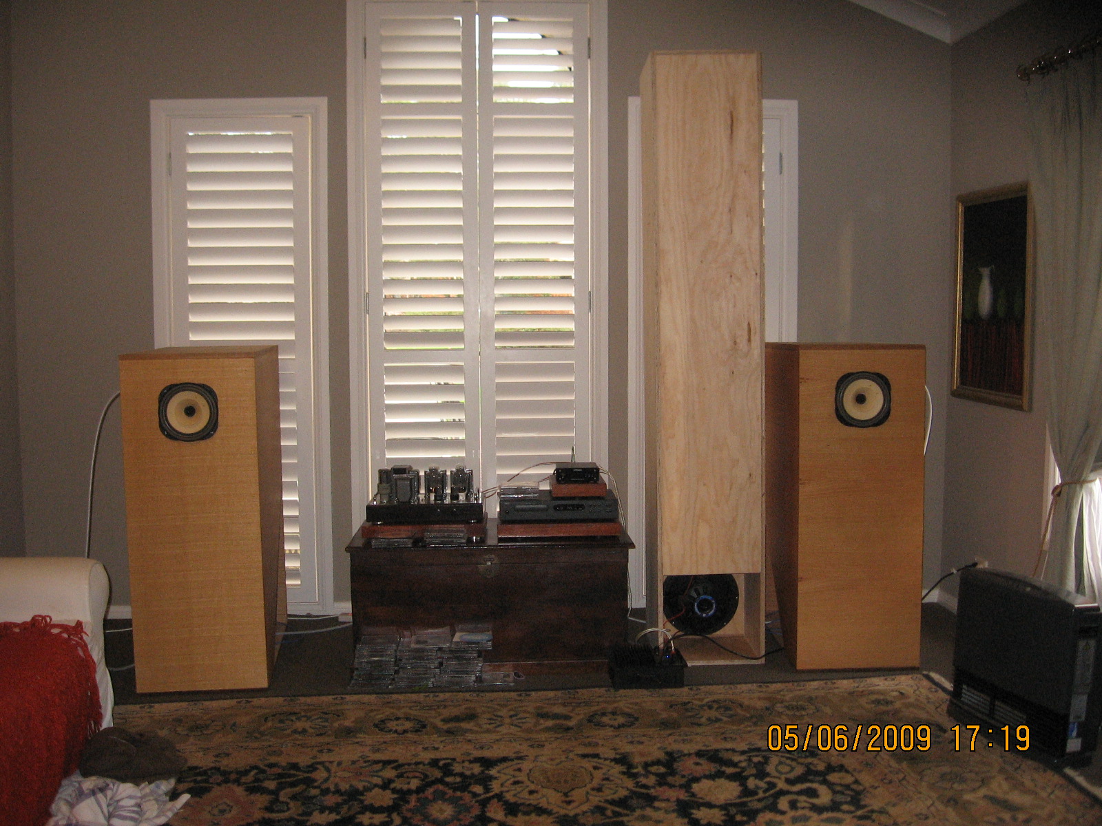

What are you running for your horns?
Andrew

Yes, but there are solutions by building down firing (wall or corner placed) horns. Take a look for example at the Edgar "refrigerator" horn that is a good example of low compromise compact horn. I have built several of similar bottom octave horns for myself and others and with the correct placement and tuning they are stunning in the low bass and have no problem integrating with a no compromise bass horn.
I use down firing wall and corner placed sub horns with 18's, corner firing 40 hz horns 1/8 size up to 50 -60 cycles, then to to 90 cycles loaded with twin 15's in 50 hz quarter sized, then 80 hz straight hypex horn loaded 8" to 600 cycles (sometimes to 900 can't decide what I like better) to 350 hz tractrix to 1500 hz tractrix at 3k with 1 inch driver
YES....!!! Finally got the 416's today from Great Plains Audio.
Wonderfulyl packed...very professional.
They look absolutely fantastic....heavy, very well machined...just a piece of art.
I was keen to get them into their custom boxes...so, after only 15 minutes, I had them playing. What a relief.
Without run-in, they are sounding very good. The cabinets are around 160 liters, so bass extension is good, most likely getting a flat response to 40Hz, then gradual roll off. I'll check this on the weekend with my signal Hz CD.
Running the separate 100-watt pro amp to drive the woofers, with a 500Hz passive xover.
On the weekend, I'll disconnect this amp and run the drivers through the Bob Crites 500/5000 xover from the 300B SET...but I suspect I'll have to attenuate the horns down somewhat. L-pad journey here I come.
The tapped horn subs were hardly needed...but if I run the drivers with the 300B, I'll probably retain the subs.

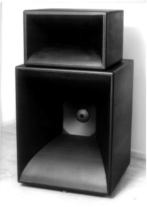

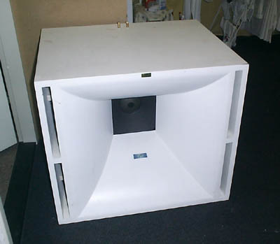

http://www.lansingheritage.org/images/jbl/catalogs/1976-pro/page08.jpg
The JBL 4560 cab is good size and would operate very nice from 80Hz to 1000.
http://www.jblpro.com/pub/obsolete/low_frequency_enclosures2.pdf

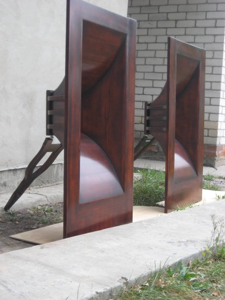

The Rullit bass horn looks fantastic - see pic attached.
And this -
Wizard High-End Audio Blog: Blumenhofer Gran Gioia
The one I really love is the Volvotreter model -

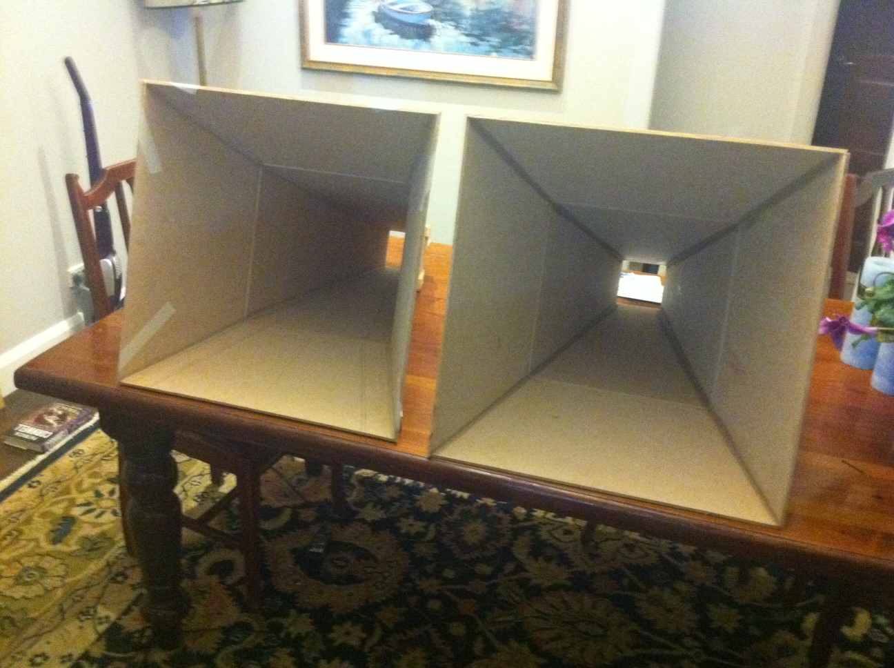

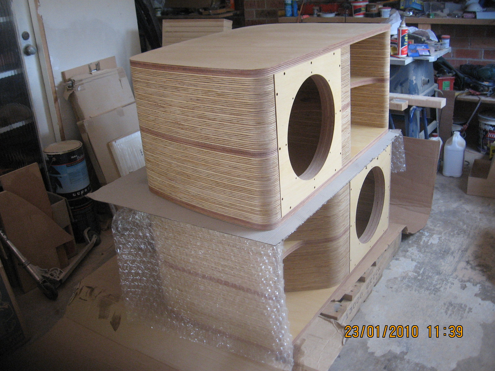

Oh, this is the earlier set of front loaded 100Hz mid-bass horns I built....60cm square mouth...90cm deep...used B&C PE32 12-inch drivers. See Inlow Sound.
Good bass, but too long for the room...hence the look out for a shorter, stubbier horn.

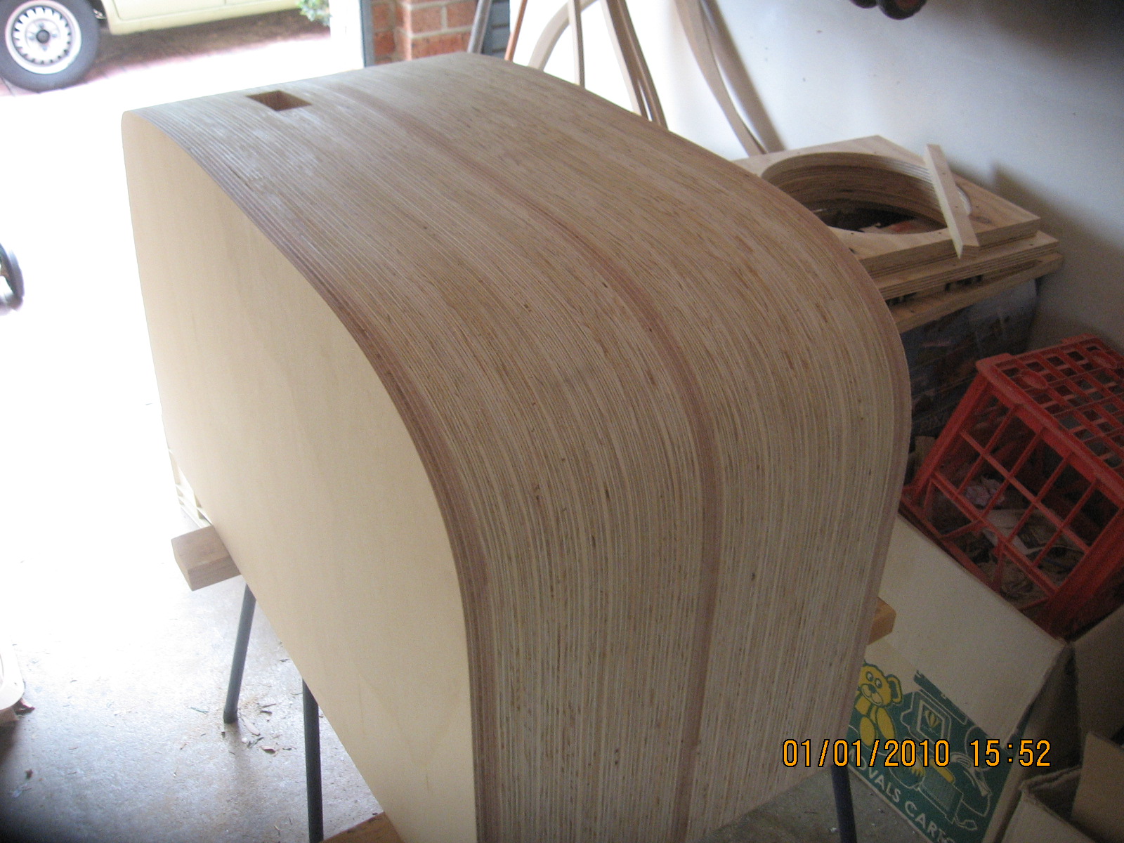

The concrete horn will be of the stand type, Jean Michel LeCleach has designed a few in France similar, however mine will be built with only the last meter in the listening room, the rest will be outside the rear of the room. Above that will be fane8m in a 160 hz LeCleach horn, yahaha 6681b in a 320 hz LeCleach horn, yahaha 4281b, and a Raal ribbon to finish off. All active with alephj amps. 90% finished after 3 years.
