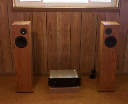

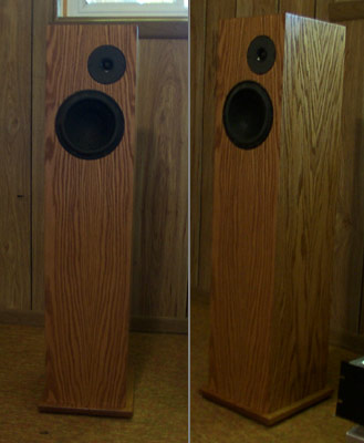

Here are some pics of my clones. Still working on active xovers.
The woodworker really did a great job on the boxes after some headscratching when he saw the requirements. ^_^ The pictures don't do it justice--the finish is certainly furniture quality. If you are in the Pgh area I can certainly pass on the info.
