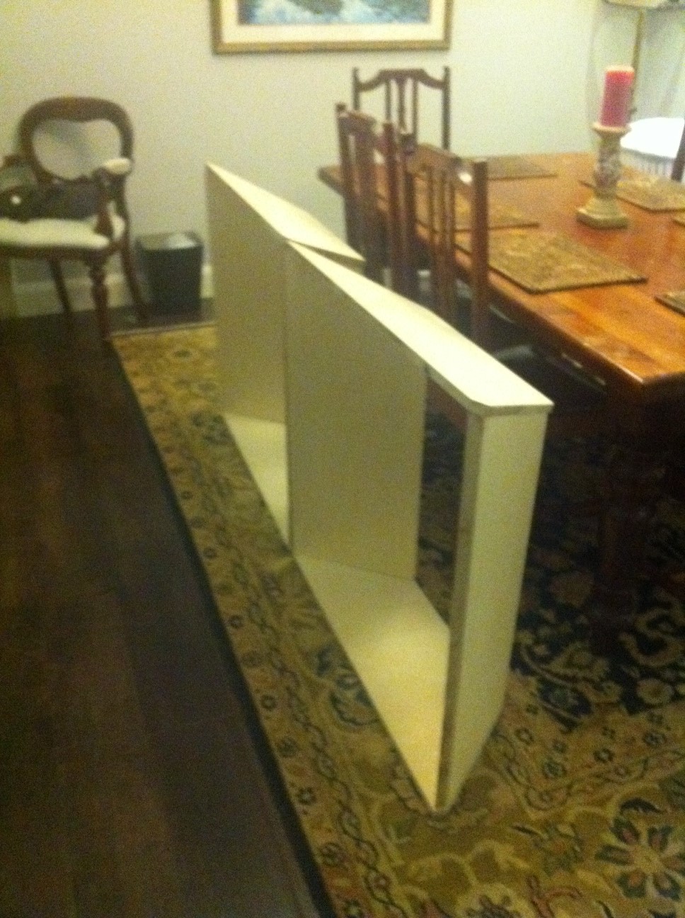

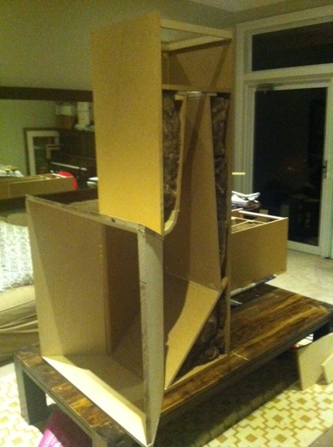

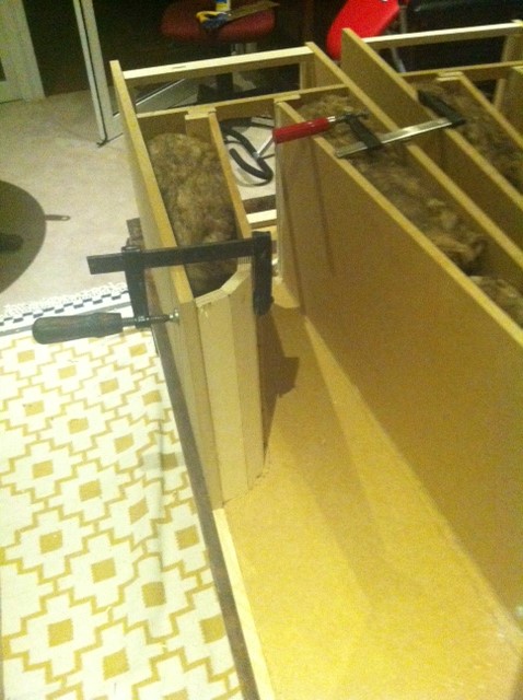

Added 19mm hardwood trim to horn mouth. I did this to even out the opening...as the front of the horn was positioned forward by 19mm.
This will now be easier to fit the horn mouth extension piece.

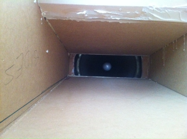

A friend has AE TD15M's...so I may try them on the weekend, all things going well to finish the horns.

I've built Carfrae, Big Fun Lowther, GOTO bass horns, Tannoys, Cornscala, Altec 620, Altec Stonehenge with 604...just love playing around...and the sound of a big cab is great.
With this bass horn, it's certainly a more ambitious project....

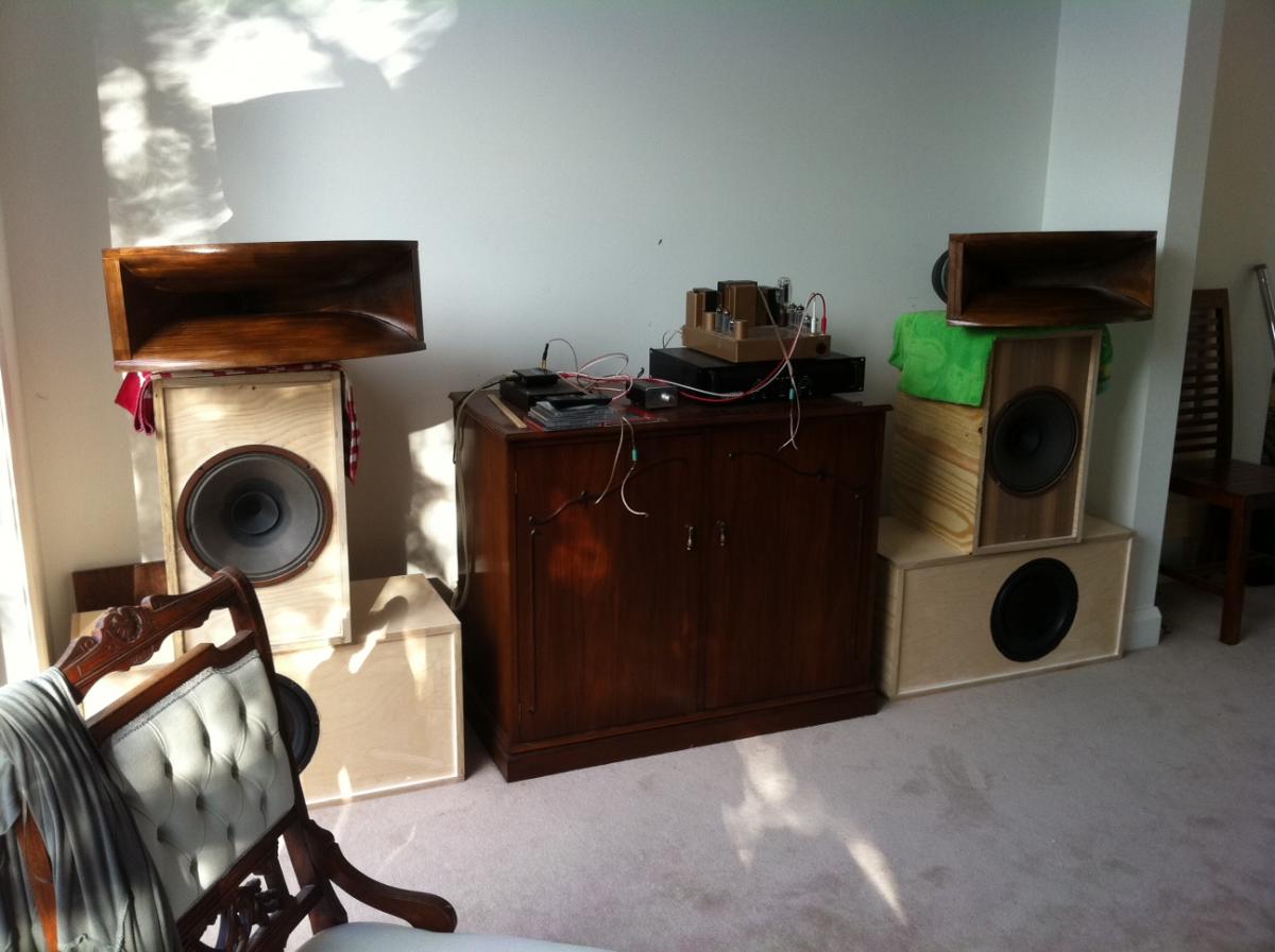

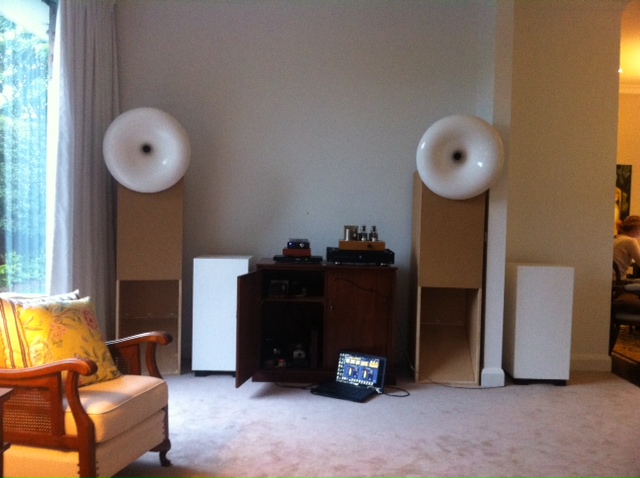

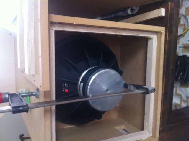

OK, after quite some work, I have the horns playing.
Using temporary AE TD15M's (thanks Henry!)....while I sort out my own drivers, hopefully the 515 Altecs.
I've not mounted the horn mouth section yet....as I need to trim and sand.

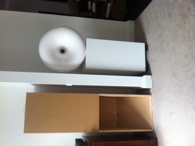

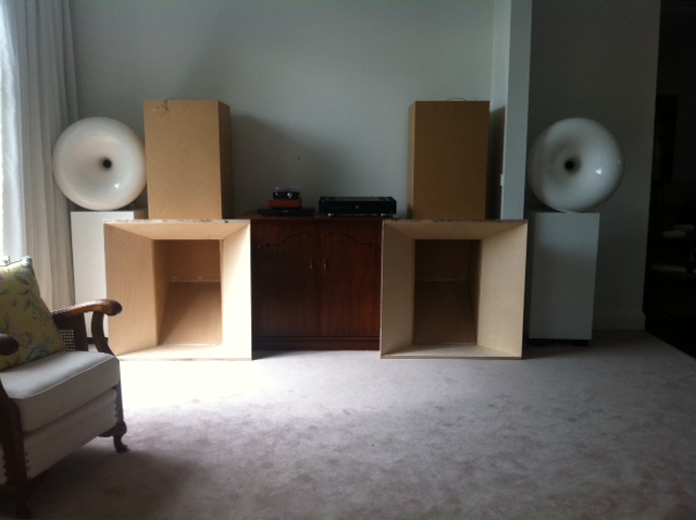

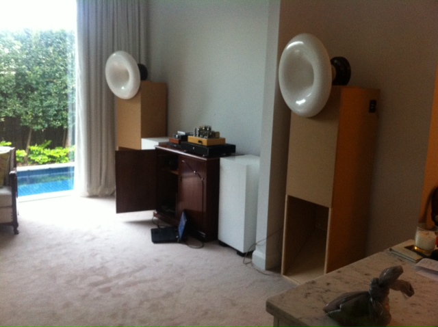

I've played around with different room placement...and the Azura horns are currently sitting on top of the mid bass horns...probably too hight...but the sound stage is fantastic. Horns are angled down to meet listening position.
Playing with Minidsp....at present, I have the subs 20-70...with 48dB steep roll off at 20, and a 24dB roll off at 70.
The mid bass is running from 70Hz (24dB roll off) up to 400Hz (also 24dB).
The 340 Azura is running from 400Hz, with no tweeter.
The mid bass is very rich and fills the room. I needed to bring back the input volume setting for the horn...as its output is very high...it's about 10dB lower than the Lab12 subs.
I've not had much listening time...but I'm enjoying the sound.
One interesting thing....I've noticed little difference in bass depth when the horn mouth extension is removed...! It will be interesting to measure this.
Hopefully some recordings/measures to follow shortly.

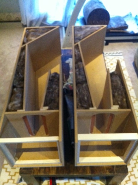

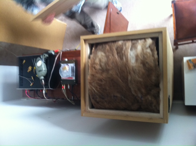

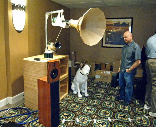

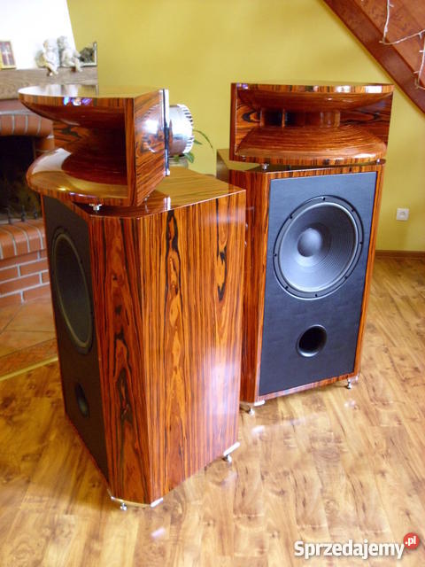

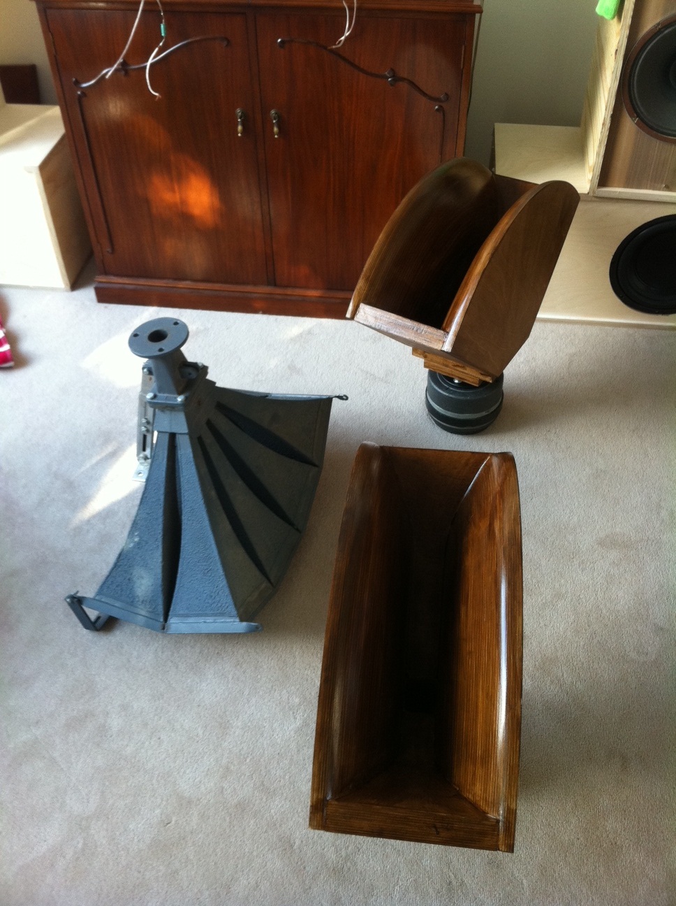

Don'ttell me you wouldn't want one of the Yuichi's per the attached pics (not mine)..?!
Andrew
- Pics new 4-way Azura horn system, plus BIG bass horn
