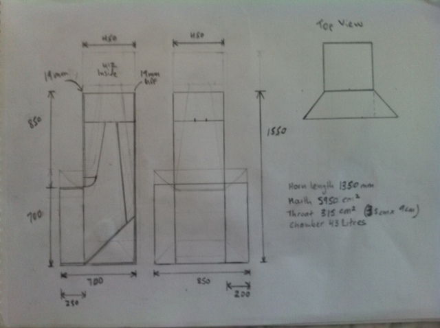

Lynn, I'm one of those lucky people with a good size, essentially symmetrical, room with two very usable corners. I currently use Lowther All Fun horns, the smaller brother of the BigFuns, driven by flea-power SET amps.

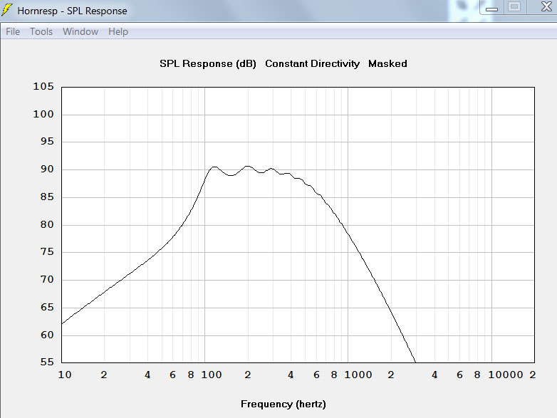

I like what Andrew has done with the Bass/Mid horn and, as I alluded to before, I've been wondering about possibilities around a corner firing derivative; it would seem possible that by exploiting the corners the bass cutoff point could be lowered a bit, than Andrew's 70Hz, without physically taking over the room. I have little knowledge or experience of speaker design and I'm looking for a steer on how one might develop the initial concept 'on paper'? Would something like HornResp be the place to start?

That would require a higher crossover frequency so the mid/bass would need to be extended upwards a little too. Is that asking too much?
I appreciate that there's a bit of work (and learning) involved and it could all go nowhere.

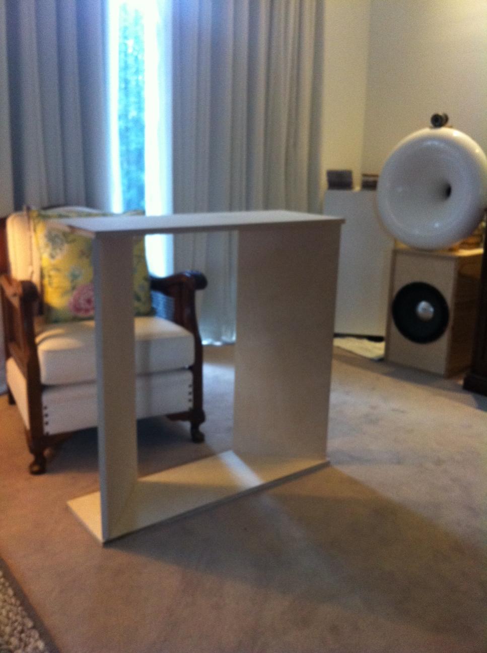

Ray, I tested my horns with 50Hz xover point (30db slope) today and no subs. The bass was still very good. You could almost have this as a great two-way system. I'll be running some recordings soon.
Oh,and this was without the large horn mouth extenion pieces added. The mouth, therefore, is 41cm x 70cm.
I've also moved the Azura's back on top of the subs...this gives a wider sound stage...and a more sensible look.
Certainly presents a massive wall of sound...very good.
