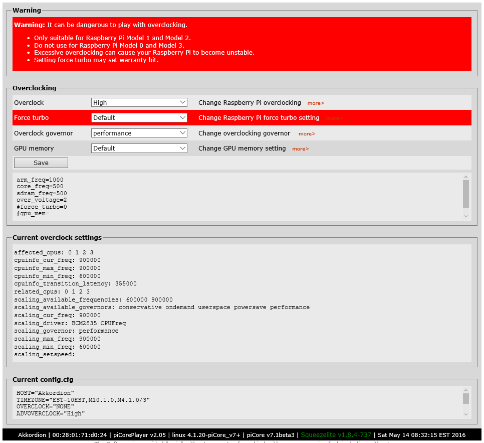

Just wrote a little script to fetch some IMO important actual system data:
Would be nice to have such a or similar "short" summary somewhere on the PCP web interface.
hi soundcheck,
Most of this info is available already (or will be).
In [Beta] mode, [Main Page] -> [Diagnostics] -> [Raspberry Pi]
Note [Logs] option as well. We usually write log files when people view Diagnostics pages.
[Tweaks] -> [Advanced Overclocking] should show relevant overclocking stuff. (Well it is on mine, I can't remember if all the features are activated in the current release). I have recently done a little more work of overclocking because of the release of the RPi0 and RPi3.
Thanks for keeping us on our toes.

Hi soundcheck,
We do not set the speed of the Raspberry Pi's in the default setup.
They should run at whatever speed is "normal" for the RPi board.
If you are playing around with the overclocking page, then yes it has the old overclocking settings. This has been updated but maybe not released yet?
The HMDI power on/off has been implemented, available next release. It downloads rpi-vc.tcz when required. This means it doesn't burden you unless you want the feature.
We try to keep the standard image as small as possible. Remember piCore is ram based, all this stuff is loading into memory on boot. Some of the "unusual" features download the appropriate extension when and if required.
regards
Greg.
