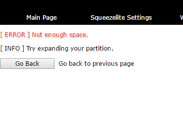

I could not wait...and tried it...it says I have to increase my partition..bummer...that is another learning curve...or do I need a bigger SD card? (Currently 8GB)
Hi Bas Horneman,
Hey, using piCore we talk about MB not GB!
Standard piCorePlayer image - 75MB (that includes nearly 50% free space)
With LMS it increases to about 110MB
On the piCorePlayer Main web page, at the bottom there are mode tabs, select [Beta] mode. You should see [ Resize FS ] click that and wait a couple of minutes. When it finishes you will have your file system expanded to 100% of your SD card. You should find disk usage to be around 1%.
BTW: I was testing this morning and found the LMS downloads to be very slow today. Not sure why?
regards

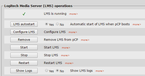

It worked! LMS is now installed.

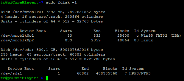

Since I have a usb harddisk for the music. How did you guys envisage mounting it and getting that visible on one's network. Since it is an NTFS formatted drive...I have to: " sudo apt-get install ntfs-3g" ....but that apparently does not work under picore?
So no samba share either?....
Sorry about all these questions...just doing stuff under picore is new to me. I suppose I have to go to look for picore packages?
But...
hi Bas Horneman,
As this is our first release of LMS on piCorePlayer it has limited hard drive/network support. In testing our USB devices just worked, so we thought it was worthwhile releasing it. Samba, NAS to come.
To load extensions in piCorePlayer from the [Main Page] click on [Extensions]
In this case the extension is called: ntfs-3g.tcz
BTW: USB devices sometimes needed a reboot to auto mount. I haven't tried NTFS formatted USB drives that I know of.
regards
Worked like a charm...looking forward the SMB thing...if that is done...I'm done...I'll have all the features I want 🙂In this case the extension is called: ntfs-3g.tcz
