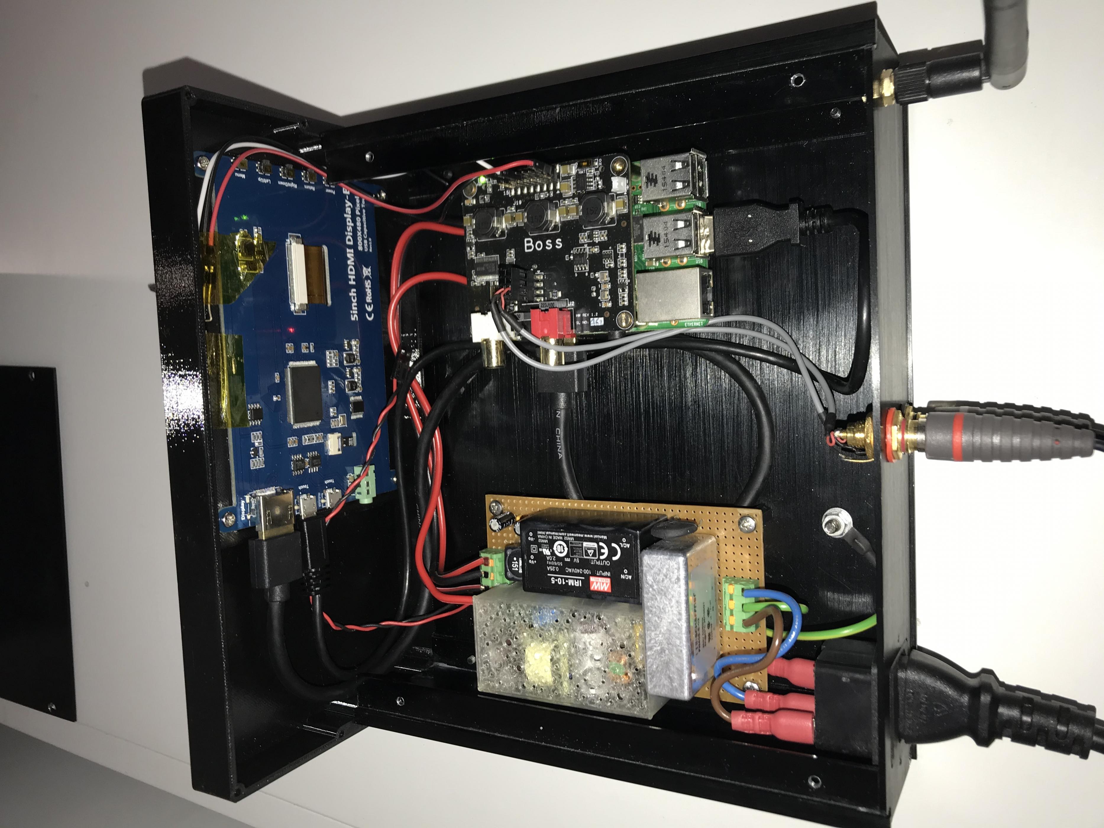

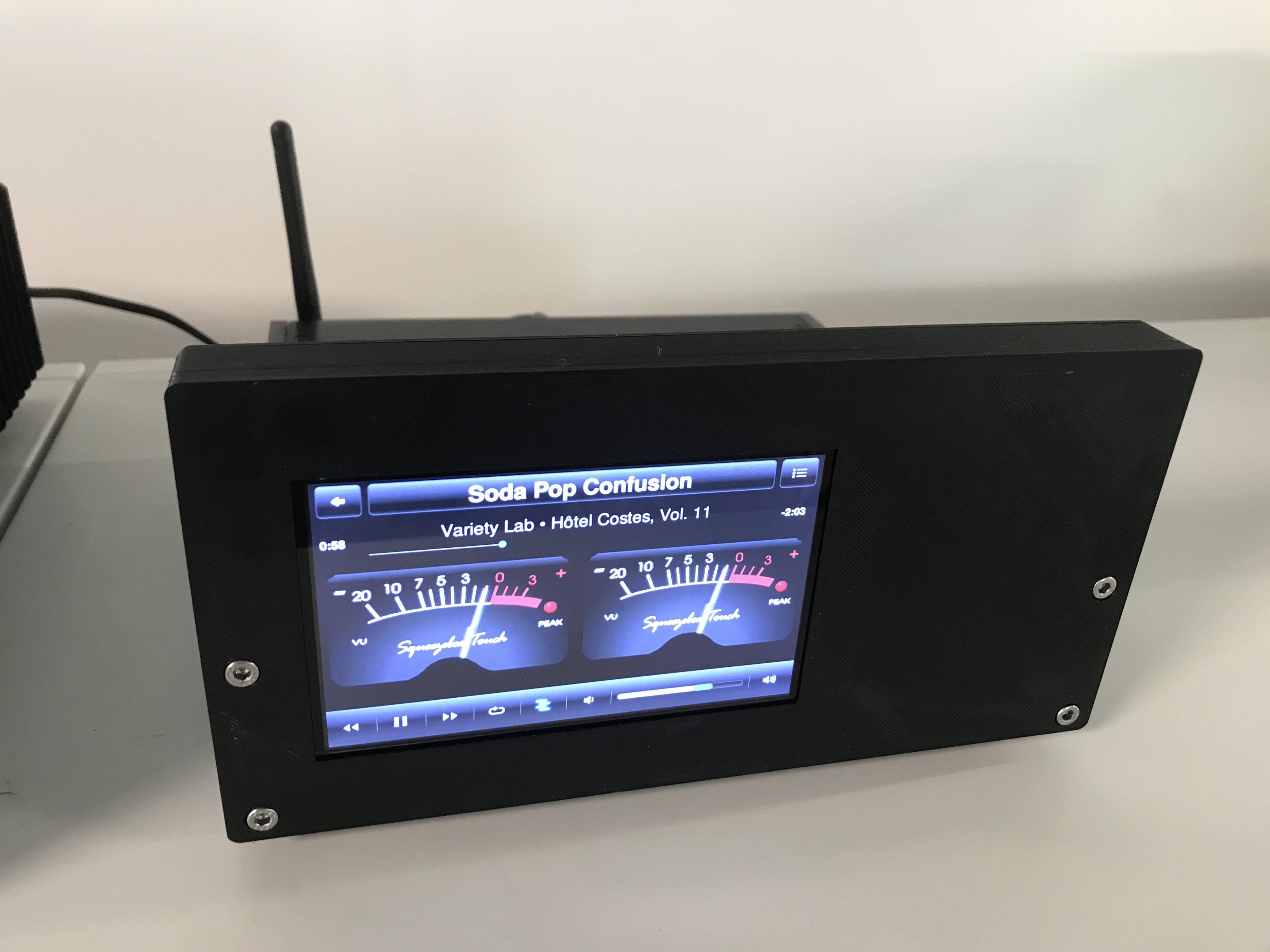

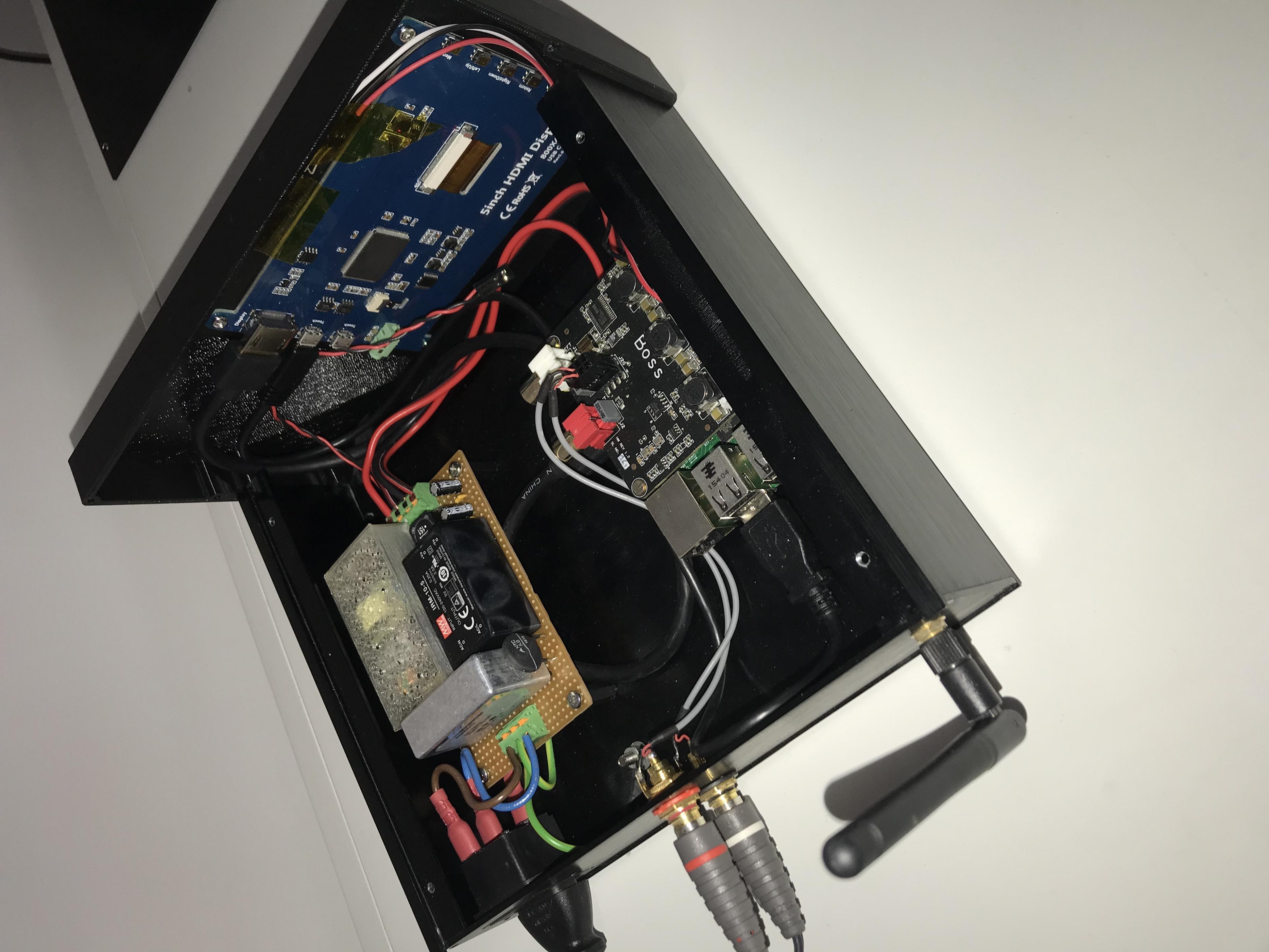

I have just finshed housing my setup for my hifi unit based on Raspberry Pi 3B, 5" HDMI capacitive touchscreen, PiCorePlayer, IR remote control receiver, Allo Boss DAC, Custom PSU with split supplies for Audio path and rPi.
I did play around with Volumio on this for a bit but being invested in the LMS architecture it didn't really make any sense.

Started out as screenless build using volumio using a Douk audio chassis. Then I decided to go back to PiCorePlayer and the screen was a very nice addition. But then I got PSU problems with the new rPi I dropped in so I had to upgrade the PSU (5.1v) to support it.
As the new PSU was open frame I 3D printed a protective cover for it and a new front panel.
It’s so good I’m wondering if I could adapt PiCore to include full preamp and source selection?
