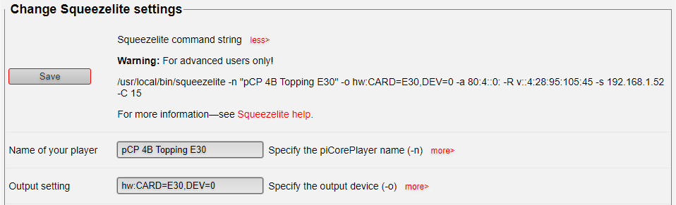

The screenshot shows the fields contain "values" only. The option is added automatically by pCP.

What is your "Squeezelite command string"?
Does it have 2 x -D ? Something like this?
Code:
/usr/local/bin/squeezelite -n "pCP 4B Topping E30" -o hw:CARD=E30,DEV=0 -a 80:4::0: -D -D -C 15
pCP adds the first -D, the second is your "value". So you end up with the -D option using default values twice. It works but it doesn't make sense.
I would *guess* a suitable default value would be "0:dop", "0:" or maybe "0".
If you really want to just add a -D option to the "Squeezelite command string" just add "-D" to the Various Options field. It will add it only once. 😱
