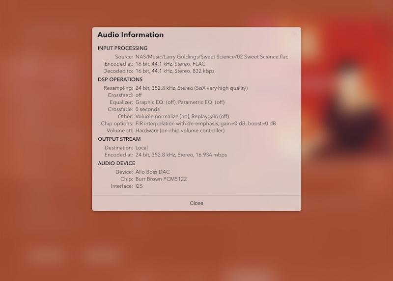

No problems at all with 24 or 32/352.8 on my Allo Boss w/mainline kernel 🙂
Code:
pi@rp3:~ $ uname -a
Linux rp3 4.14.73-v7+ #1148 SMP Mon Oct 1 16:57:50 BST 2018 armv7l GNU/Linux
pi@rp3:~ $ aplay -l
**** List of PLAYBACK Hardware Devices ****
card 0: BossDAC [BossDAC], device 0: Boss DAC HiFi [Master] pcm512x-hifi-0 []
Subdevices: 0/1
Subdevice #0: subdevice #0
pi@rp3:~ $ cat /proc/asound/card0/pcm0p/sub0/hw_params
access: RW_INTERLEAVED
format: S24_LE
subformat: STD
channels: 2
rate: 352800 (705600/2)
period_size: 16384
buffer_size: 65536

I can confirm. It also works with the standard kernel and the Allo Boss driver. I need to check if the Allo Boss driver overrides the PCM51xx codec driver somehow nowadays.
I still doubt that the PCM51xx codec driver supports it.

So again, I believe Allo BOS doesn't support DSD playing without conversion to PCM.
In order to send DSD output to pCP the -D option should be used but even if you not get any error. No sound in output. See logo below:
DSD native doesn't work on I2S-HATs.
It's got to be DOP - DSD over PCM.
The SW volume control must be locked at 100%!
A DOP stream can not be touched by any DSP functionality, which would corrupt the
stream.
A DOP stream requires double the bandwidth compared to DSD native.
That's why DSD128 -DoP (@352k8) is max for PI-HATs.
On USB DACS DSD256 native works fine.
I'll check later if the Boss works on DoP128.

OK. Stupid me.
Boss/PCM5122 doesn't support DoP at all. I checked the datasheet and
Allo also confirmed it.
What will work though is using the DSDplayer plugin and convert DSD to PCM.
Just tested it!
That'll generate a 352k8 PCM stream from DSD128 material.
Sorry for the confusion.
Enjoy.
