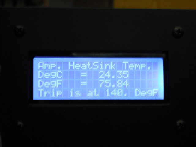

I'm assuming the farh formula converts to fahrenheit?Hi,
I used the LM35 to read the heat sink of my amplifier and shut down it if the temperature reached the set point. It is very accurate and simple to use. Your code for read the temp it is correct.

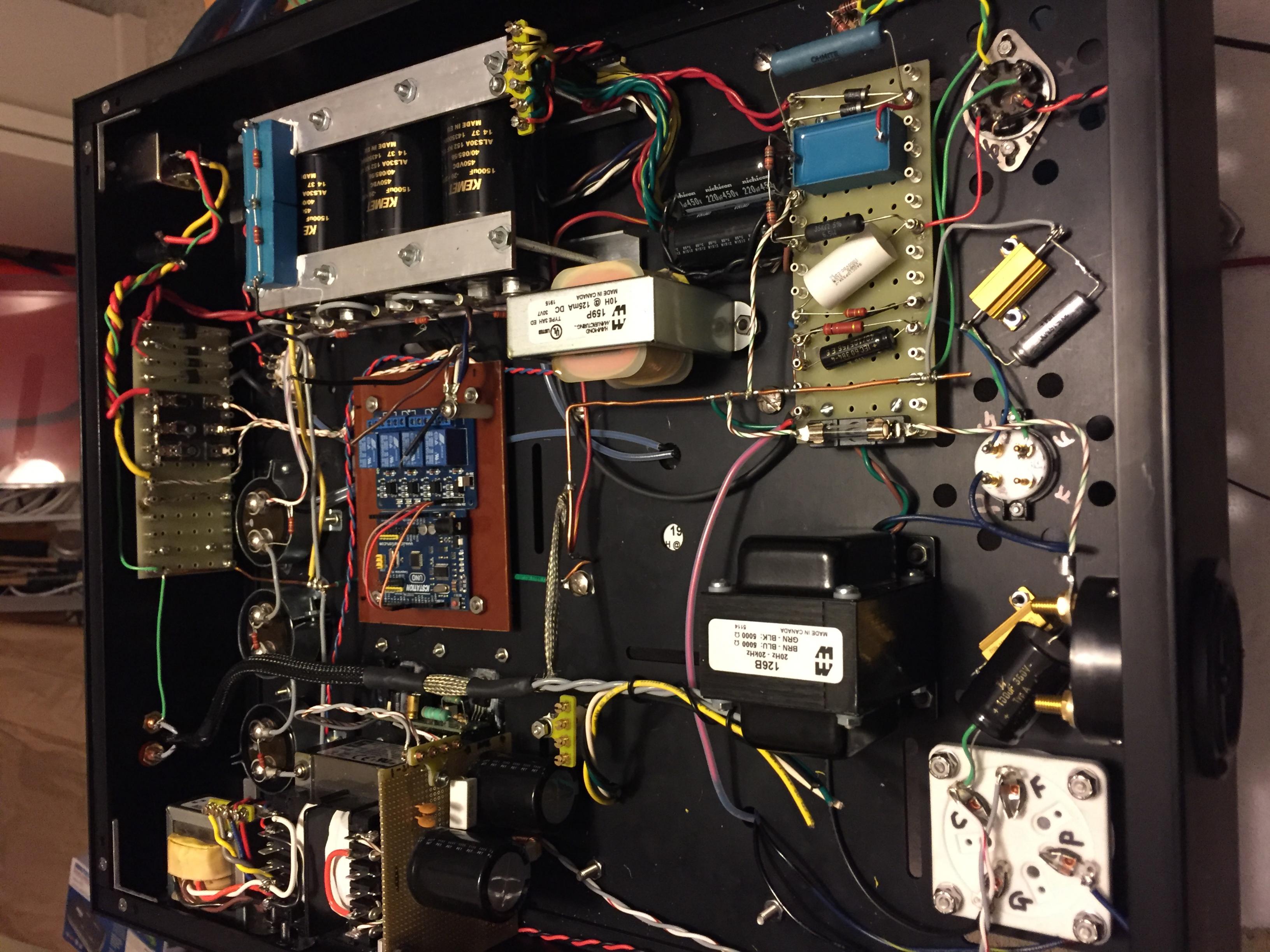

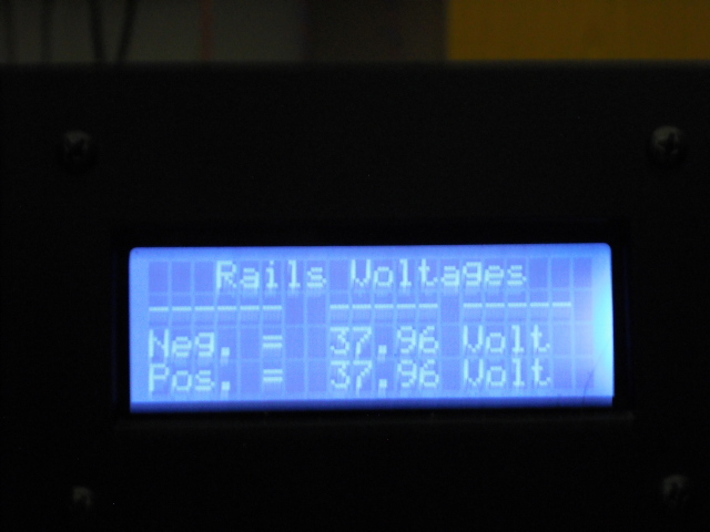

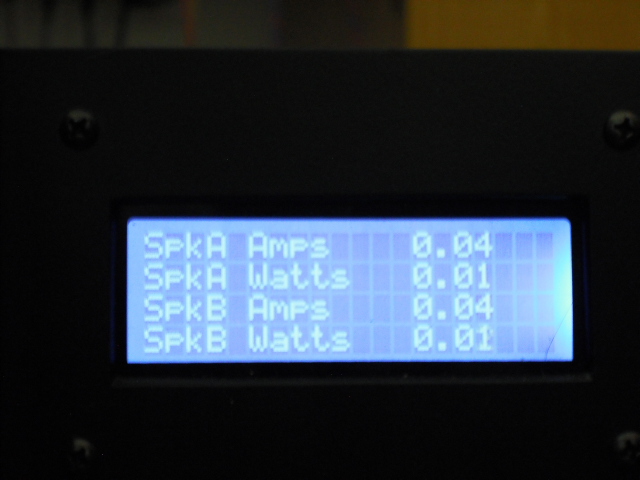

Attached are some pictures of my amplifier so you can have an idea what you can do with the micro and what do I do with the micro.
I control the following task of the amplifier:
1-Ramp the AC on power ON/OFF to prevent the inrush current.
2-Ramp/control/regulate the rails voltages.
3-Monitor the heat sink temp and shutdown
4-Display the watts/current/temperature
5-Monitor/shut the rails voltage to protect the speakers in case of high current.
Protect the speakers by shutting down the rails voltages. No SSR or
mechanical relays to protect the speakers..
6-Prevent the amplifier to power up itself in case of a power failure. It will
not restart when the power it is restore.

Very nice, did you do this at one time or did it evolve like I'm doing?
Would like to see your code when I get some time. Right now I'm getting the basics done and need to make a few tweaks to the power supply. My "rail" voltage is running a little high at about 460volts (1200v at the high side of GM70). Need to adjust my cap input and drop it down to about 400v.
Eventually I need to clean up the control side and make a circuit board with all the components.
Attached a picture of my progress so far.
WoW that it is huge, nice layout and neat. My advice to you that the most important when designing the control board it is to make sure you have all the hardware needed and all the I/o needed. Also make sure that you have some extra spare I/O in the board just in case you missed something. Once you have the board made then all the changes will be done in the software.
I did it from the beginning but troubleshoot the programming to works right and without bugs took sometimes. Now, I am working to add a digital VU using the existing display.
