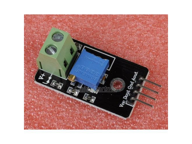

I purchased a Voltage Detection Module from Ebay last week, but not sure exactly how this module works(description is vague).
Edit:
After reading some more, the opto isolated input is not linear....

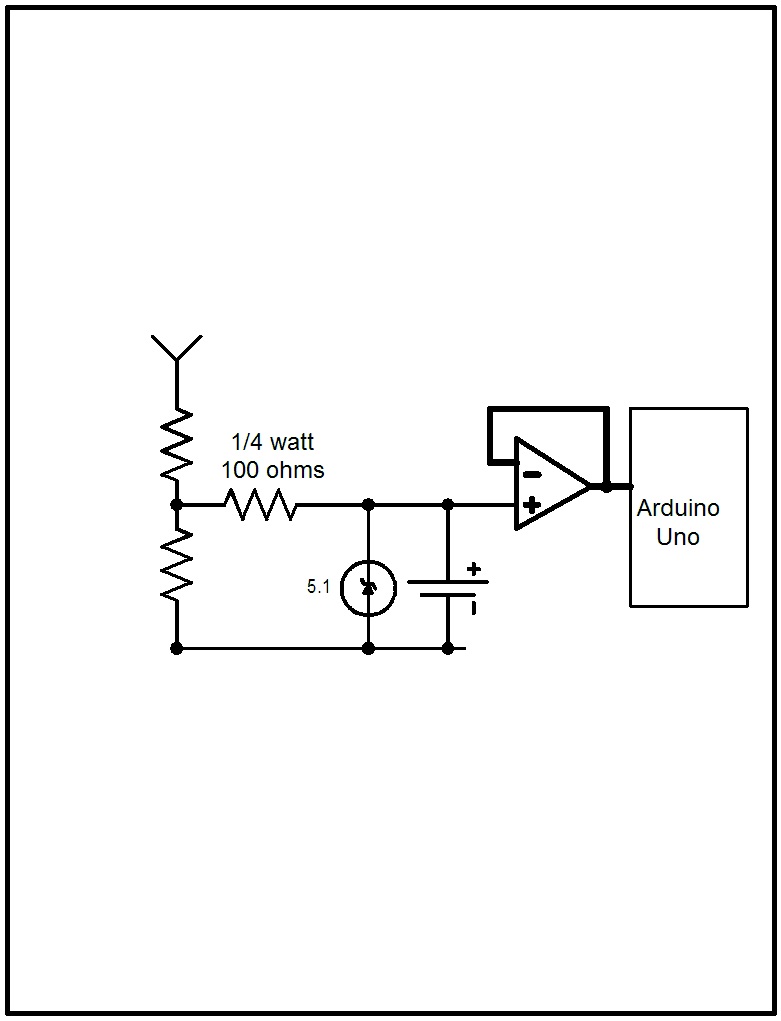

Normally what I do for reading high voltage it is the used of a unity gain op amp as interface between the high voltage and the micro. If something catastrophic happened the op amp will protect the micro. Also I used a 5.1 Zener diode a resistor at the input of the micro. Attached it is an schematic showing it.

Never thought about using a buffer for dc to protect the microprocessor. Should be simple to make with a couple resistors and an op amp

OK, "Grasshopper" decided to make some modifications.....
I don't have the boards yet so I can't test this. I think I'm progressing somewhat after 9 youtube lessons and your help of course.
I like it! The Zener is also isolated from the Arduino which I've read a zener connected directly to analog input skews the readings.
