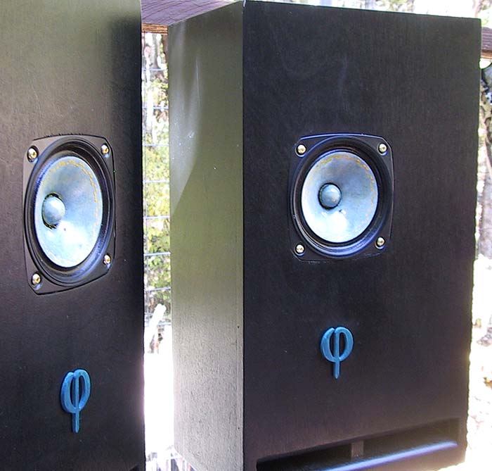

Bamboo's almost certainly a touch lighter, but don't quote me - measure. The bigger difference is probably the material quality, with bamboo being much harder, and anisotropic with its strength varying depending on the grain.
MDF, at least the grade and thickness I've used, is heavier. I make my test cabinets out of anything which comes to hand, for example, scrap MDF from a workshop up the road, or old bamboo or hardwood cutting boards. Bamboo is easily the best to work with for that purpose.
