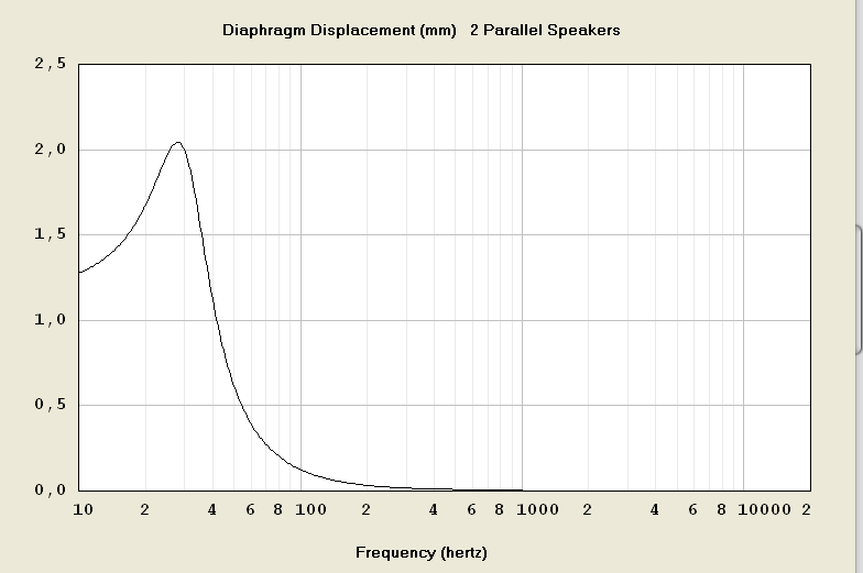

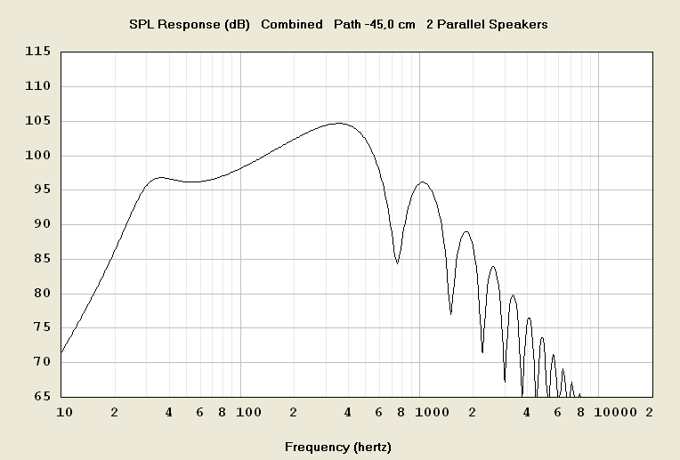

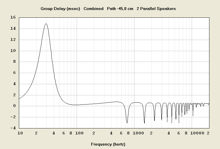

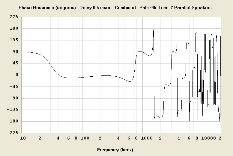

You could those to. Simulate it in hornresp.this 4 х "Eminence ALPHA-15A"?
Hi Janicol,
Here a simulation of the alpha 15A. With corner placement even 96dB 1wmtr 26Hz -3dB is possible. Simulation shows 1Phi placement .
