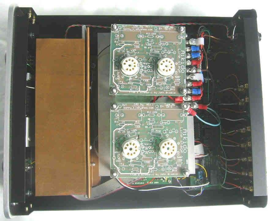

My attempt at an Aikido
I think it looks OK. My wife reckons that I should stain the pine a darker color? However, the camera has picked out scratches.
I am using diode rectified power. The rear tube is an Amperite 30 second delay. I have a separate 6.3VAC heater transformer, which is rectified and regulated using a Welborne Labs kit.
At some point, I'll upgrade to 12VDC and expermiment with 12V tubes.

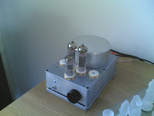

My First EL84 PP
This my very first self built Tube Amp (actually I have built two of these since they are monoblocks)
It is based on a design in Radio Electronica from 1962
I replaced the power and output transformer by a set of Amplimo toroids (one inside the case and the other outside, stacked on a single M6 thread)
The tubes are 2 x EL84(of course) and an ECF83 as input stage and phase splitter.
All built into a Hammond cast aluminium box (quite small... I had to use some surgical handyness to get it all in...) the box runs quite hot though when it runs for a few hours :-( No chance i can close it up the way it was meant to be 🙂 (that's why its floating above the lid)
I planned to put 4 EL84 on the box since the output transformer is only 4 k anode-anode but the amplifier gets unstable with 4 tubes. Might be that the power transformer can't keep up but all voltages read quite OK. I also had a problem with the ECF83 generating some HF oscillation when driven with a large signal. For now I blocked it with a (too large) styroflex cap of 200 pf between anode and kathode.

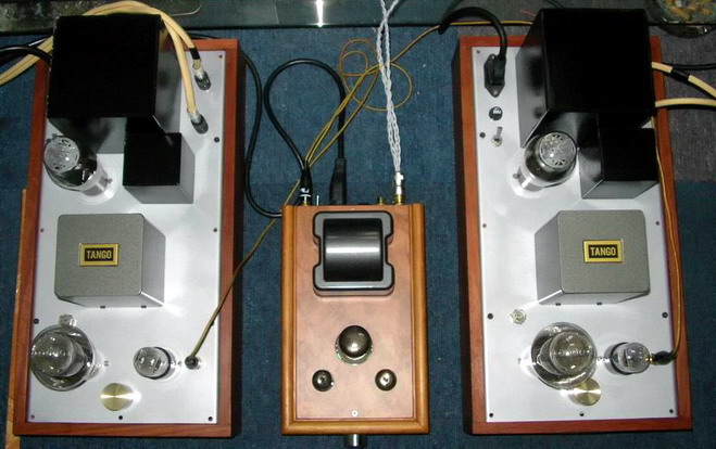

Hi all,
This is my most recent work: a trivial ultralinear amp, 60WRMS/channel.
Input tubes 6922 and power tubes 6550C (or KT88), continuously variable neg. feedback on front panel knob, overkill (almost...) output stage power suplly, independent input tubes power supply (cap/choke/cap), also separated for bias and for the input stage DC heaters.
3 steps manual power on sequence and HT standby switch.
Fixed bias and 0, 4 and 8 ohms speaker taps
All aluminum chassis and piano black hand buffed front panel.
Sounds very very natural and cristal clear.

Hi rca,
Thanks for your kind words.
No it is not that way: you can also reach the pots for bias adjustments from the top, they are (each one) just behind the bigger tubes but unfortunately the previous pics could not show them at all...
Ricardo
