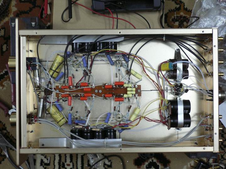

Rumbeng said:View of inside
Hi Rumbeng !
Its work good ?
no noise ?
I think you change system to fast hi hi ...!
Sound good? better you retun origin schema phono kit use out for RIAA with ECC82 , thats MU , gain its ok for schema , and you can buy pass with capacitor MKP 0,1 uF in katot, and sound better now, if you not do its, you can changes out put capacitor 0.22uF come to 0.47uF good morthan like you changes 12AU7 come to 12AX7.
Good luck !
See you soon .

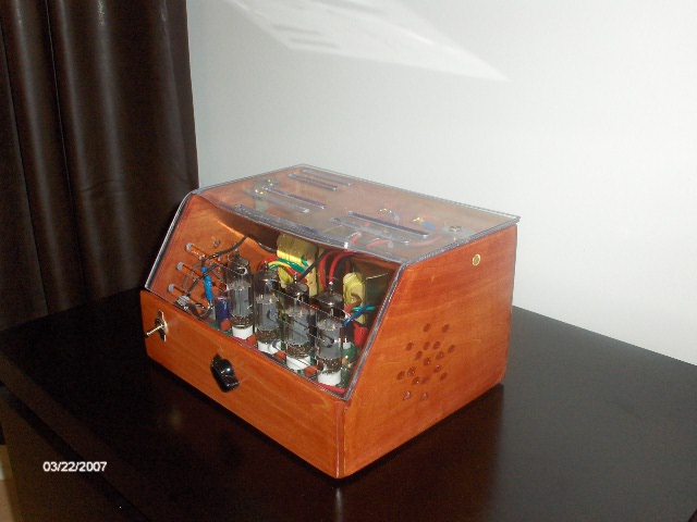

Hi man !okmrbh said:This is an aes k-502, some of you may have seen it on the delsol discussion. The case cover has ventilation now which helps keeping things cool. I'll do a few more minor cosmetic changes but it's pretty much the stock amp & board.
You have projecto same radio vintager !
Thats K-502 tube so longer ? same EL 34 and so like KT90 !
its trio and direct heater ?
Hi, Hdaudio. I'm not sure it could be.

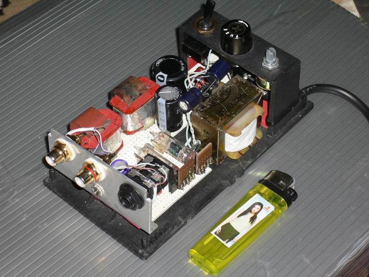

Hi Yagoolar, your products is look very nice, however I can't imagine how to put into pocket ?
Hereby is my headphone-amp to use small tube, if you know the price of these tubes in Vietnam # 6 cent !!! , the OPT is made from US military' core.
viagraless said:Hi Yagoolar, your products is look very nice, however I can't imagine how to put into pocket ?
Unless you are a kangaroo 😉

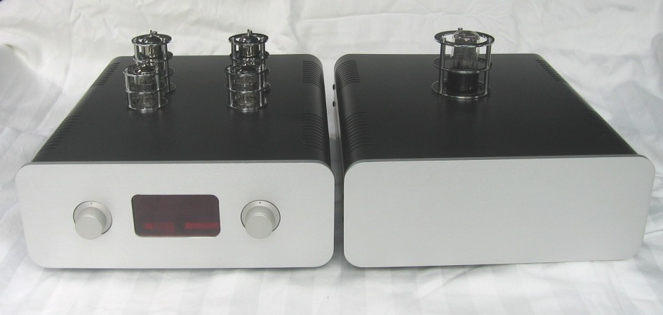

Aikido Preamp
Folks:

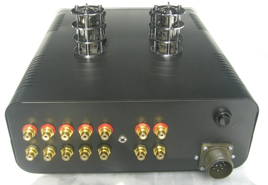

It took me over a year to plan, lay out and build this Aikido preamp, and along the way a lot of people helped. Special thanks go to Bas Horneman (http://home.zonnet.nl/horneman/) and Mikkel Simonsen (http://electronics.dantimax.dk/); Bas supplied the John Broskie-approved Aikido PCBs and Mikkel supplied the Dantimax remote control system. Both Bas and Mikkel provided a lot of support to this newbie. The preamp is built in two ATI Research enclosures; the power supply box sports 3 transformers -- two are dedicated to the preamp and power supply circuits and the other is dedicated to the remote control system. In the preamp box, the Dantimax Control2 PCB and the LCD display are shielded behind an aluminum bracket and copper sheeting assembly, while the preamp PCBs sit above a piece of stainless steel.
The preamp sounds great: open, detailed and airy. Wonderful soundstage and excellent resolution. There is no discernable hum. I used my Hagtech FryKleaner to burn the Aikido in and have been enjoying the results ever since.
I may add a few improvements -- the RCA connectors may be upgraded to Cardas plugs I have on hand, some T-pads may be installed to lower the gain slightly and an on/standby indicator LED (based on Jim Hagerman's circuit at http://www.hagtech.com/pdf/led.pdf) may be added to the power supply enclosure.
Otherwise, this preamp is done. Time to consider new projects!
Scott
