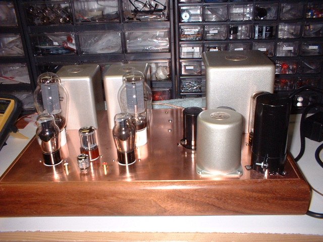

Art D. would have been proud very proud. Very nice. That ess....ess....escutcheon (sorry I have allergies to weird english words) begs a small O-scope display in there showing the audio signal or easier, two VU meters with the needle fulcrums at the outside centerline and the tips pointed inwards waving past each other..
audiomanics said:An externally hosted image should be here but it was not working when we last tested it.
Designed and made some nice woodwork around an ancient Howard dialplate (escutcheon) in Art-Deco style..
Love it or not...
Kees

how can a triode amp be "ultra linear"?
Triode/Ultralinear would indicate he can run it in either mode.

rpapps said:P.S. What's inside?
A little tube-stage, a huge supply and a lot of MOS-fets on a 10mm thick black-anodized aluminum frame (CNC-ed by myself) . Good for about 2x750WRMS/4Ohm (Yes 1500Watts RMS in total )
Kees
miklos said:Waveforms looking pretty good. One question, how can a triode amp be "ultra linear"?
6550 is a pentode (or beam tetrode) which I wired in (switchable) triode/UL. The custom made OPT has a 43% UL tap.

Dude!...brilliant! I need to see some gutts. Lay it on us.
Shawn.
audiomanics said:A little tube-stage, a huge supply and a lot of MOS-fets on a 10mm thick black-anodized aluminum frame (CNC-ed by myself) . Good for about 2x750WRMS/4Ohm (Yes 1500Watts RMS in total )
Kees
Shawn.
Like this?
Or would you prefer to turn it around? (Yes, i know the aspect is wrong and the alignment too)

Very Compact, very neat. You are a masterful builder.
Shawn.
