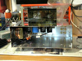

Hello,
I'm from Romania and I have to show you my latest work. This is my 6W Stereo Amplifier. ARITMA was written on the box. I thought it's a good name for a home-made amplifier.

Hello again,
Now I have some time to say something about the amplifier posted above (when I posted it I was at work):
The amplifier is build around 2 EL84 (so it is a SE) configured as pentodes (by default). Preamplifier is made with an ECC83.
For my amplifier, I have chosen Russian tubes (tastes... tastes... everyone with his tastes) so I used 6P14P (EL84) and 6N2P (ECC83). Filament power supply is regulated and well filtered (with 10.000uF capacitor) so no hum is induced. B+ is filtered by 4x220uF capacitors.
Rectification is done through silicium bridges.
Any questions, I'm happy to answer.

Hello Aleks,
is it really pentode mode without feedback?
It can sound good to you, but surely it won't measure good 😀

Hello,
The case is from an old power supply made in Czekoslovakia (hope I wrote it correctly) - that's before 1990 (these days it's Czech Republic). The name ARITMA was written on the case so I thought it's a perfect name for my amplifier. More pictures with the case (from it's entire construction process) could be found on my site, right at this address:
http://www.lumeatuburilor.go.ro/Aritma Stereo 6W/index.htm
Also the schematics is there. The schematics is my conception and the amplifier is not build from kits. All you see there is just my work. I spend about a year collecting parts and putting them back toghether. The entire work costed about $150 (although I had the tubes).
As for the speakers, a pair of Sony MF-450SS is what I use with the amplifier. It sounds sweet and bass response is quite good.

Hello Giaime,
It is true pentode, without global / local feedback.
Thanks for the kind words.
ALEKS
Output impedance is dictated by the transformer. These transformers have Z=4ohm in secondary (no. of sp.: 108). They were recovered from an old Russian TV-set called Rubin 102B. Primary impedance is cca. 5Kohm (no. of sp.: 2200).
