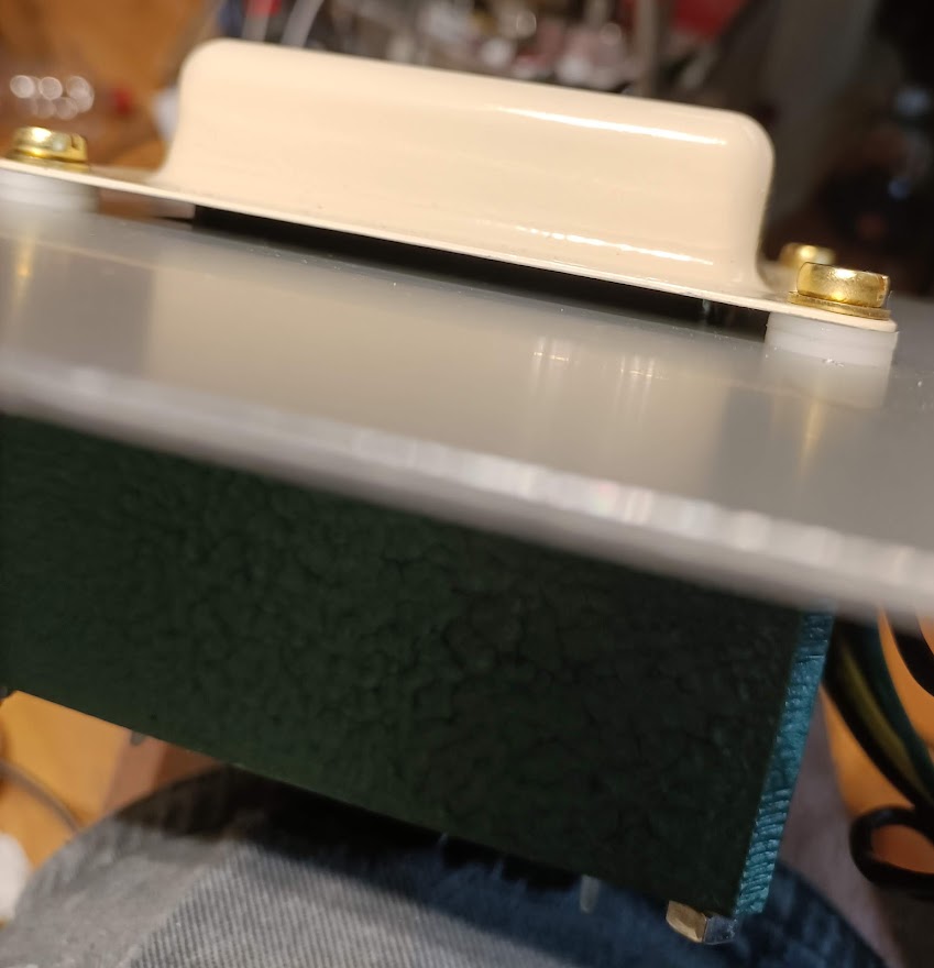

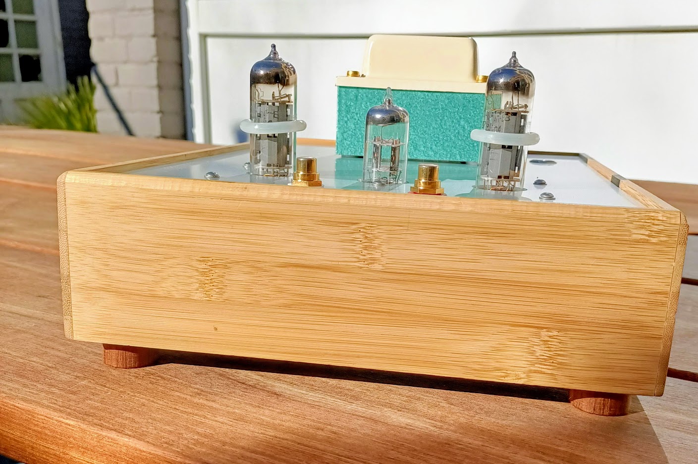

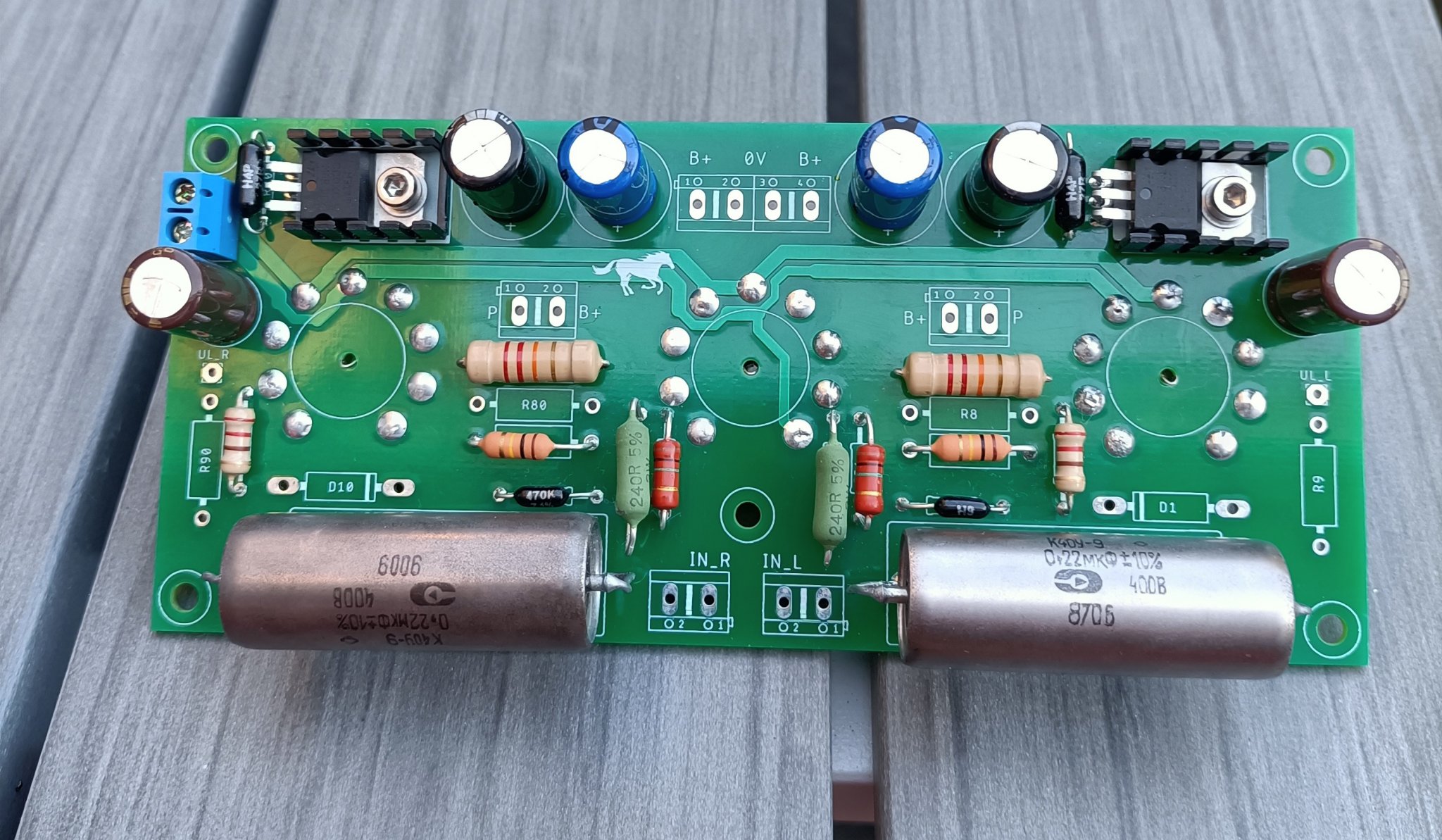

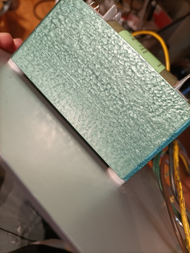

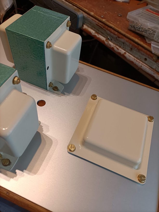

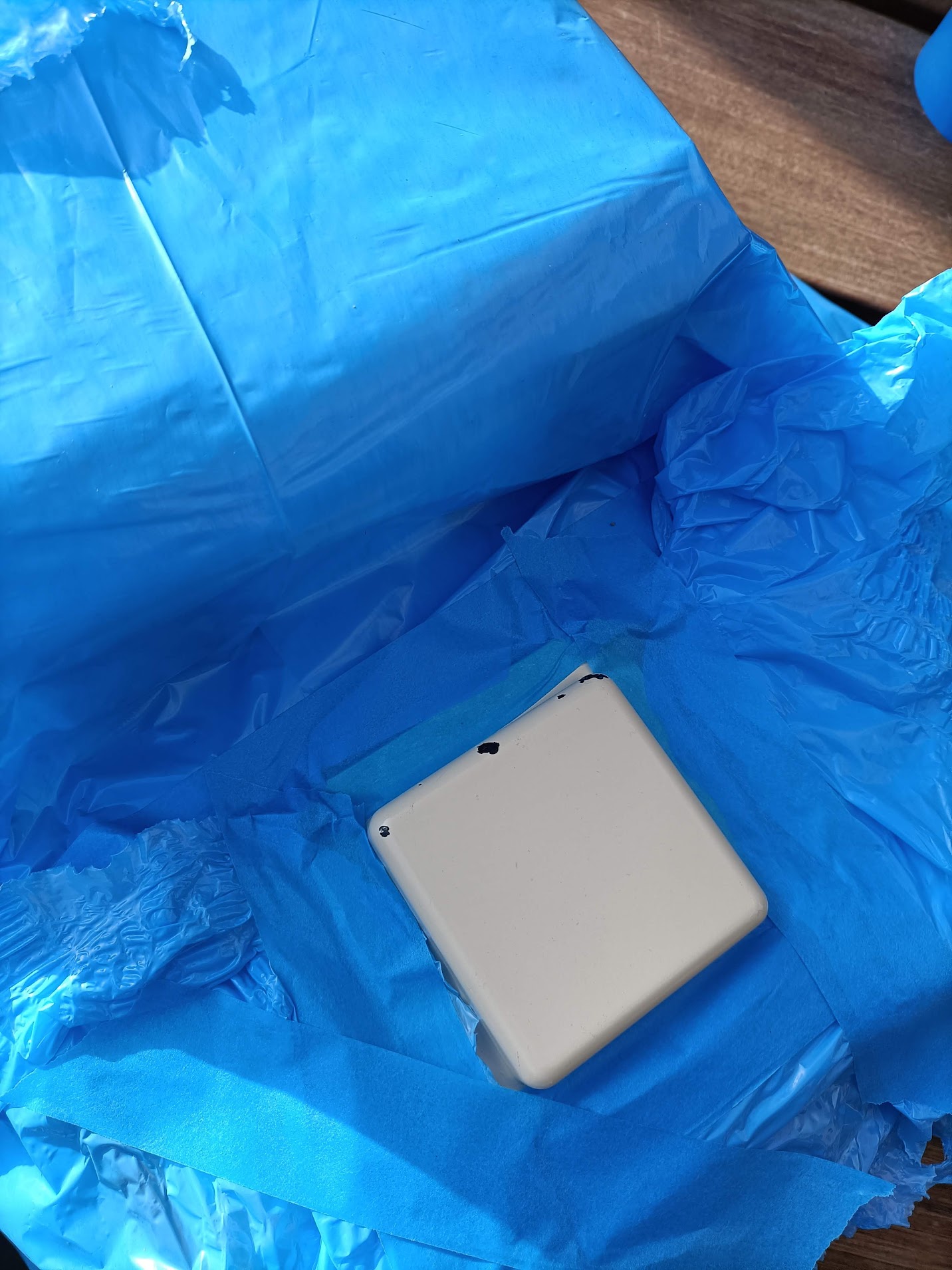

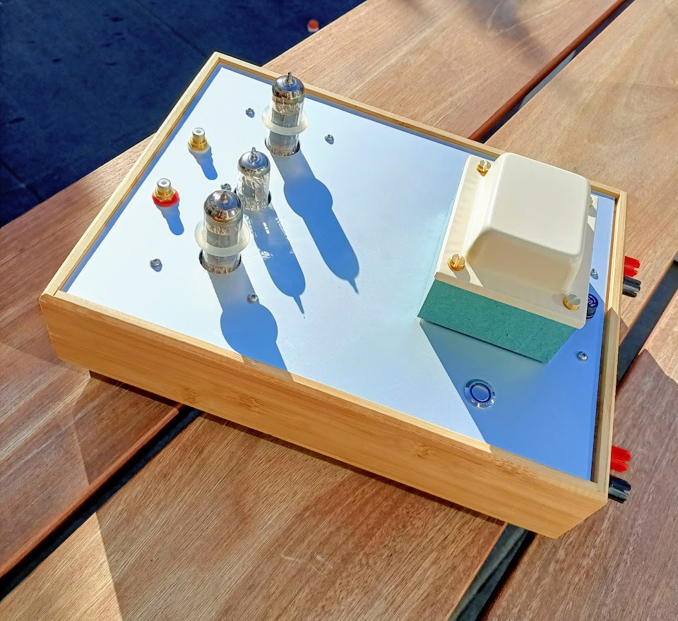

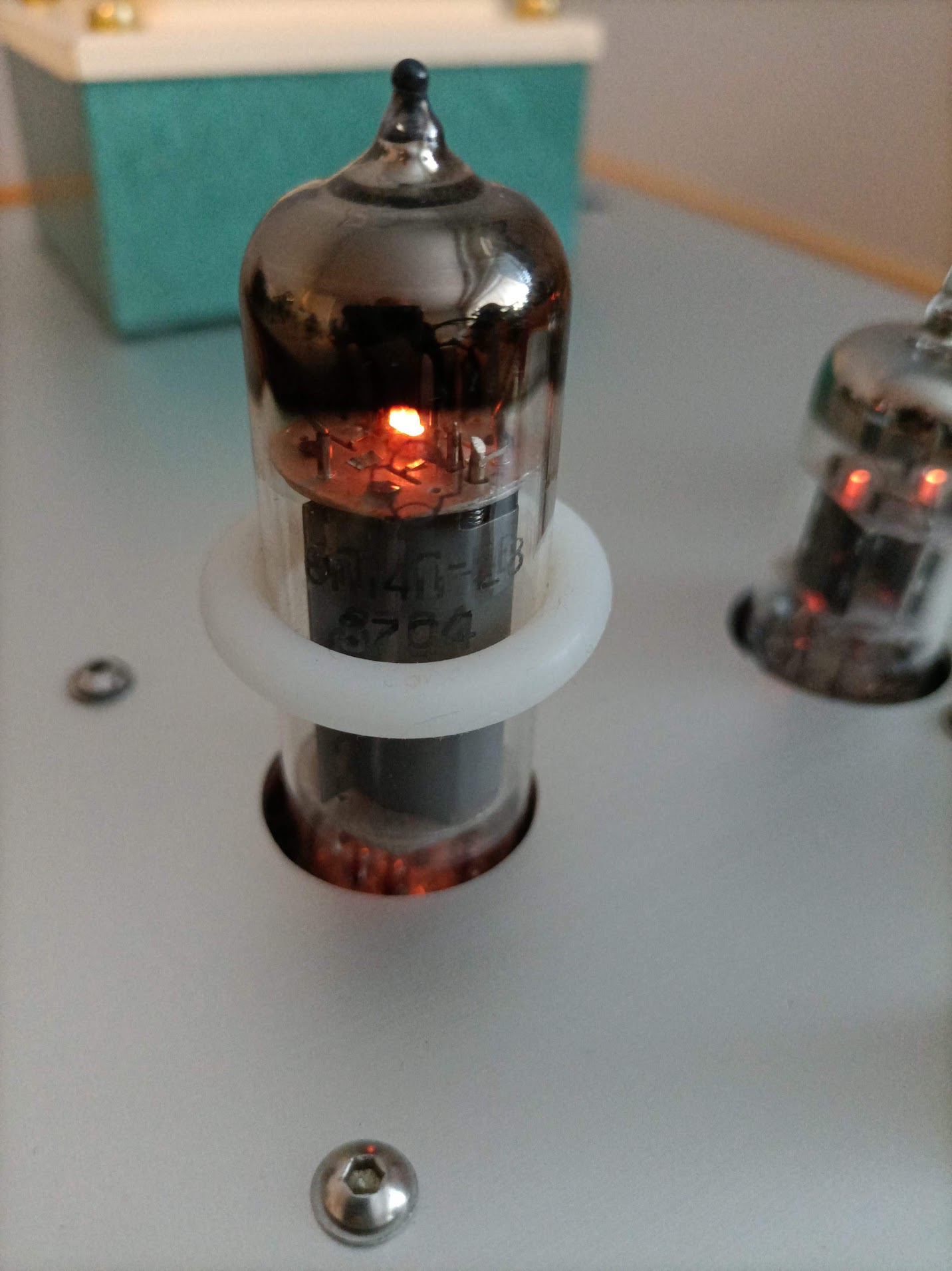

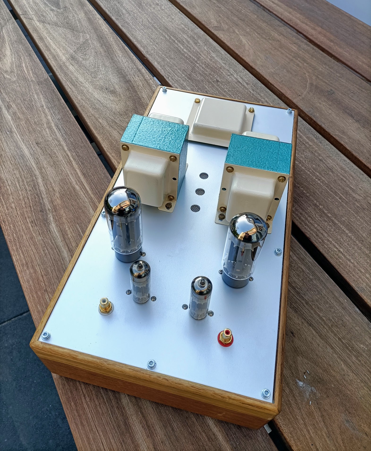

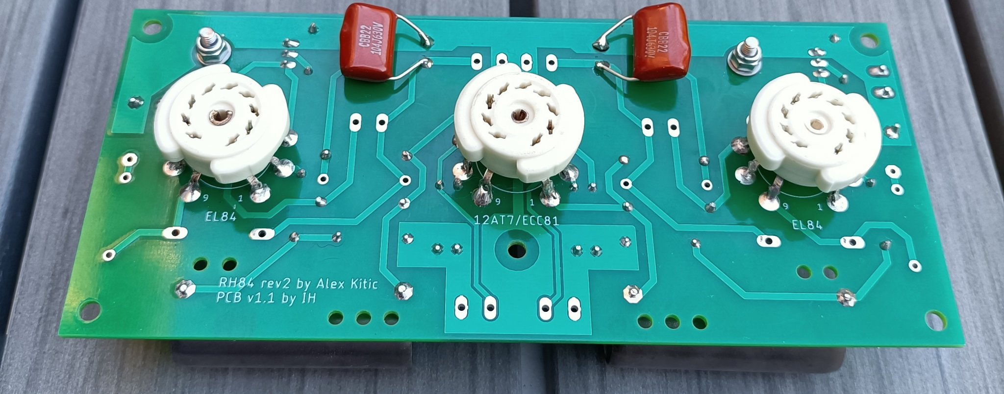

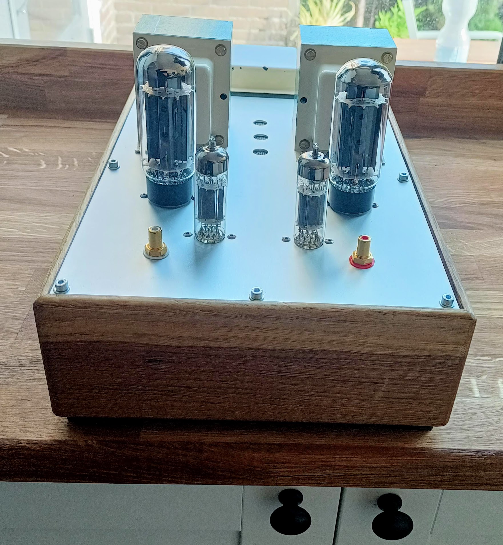

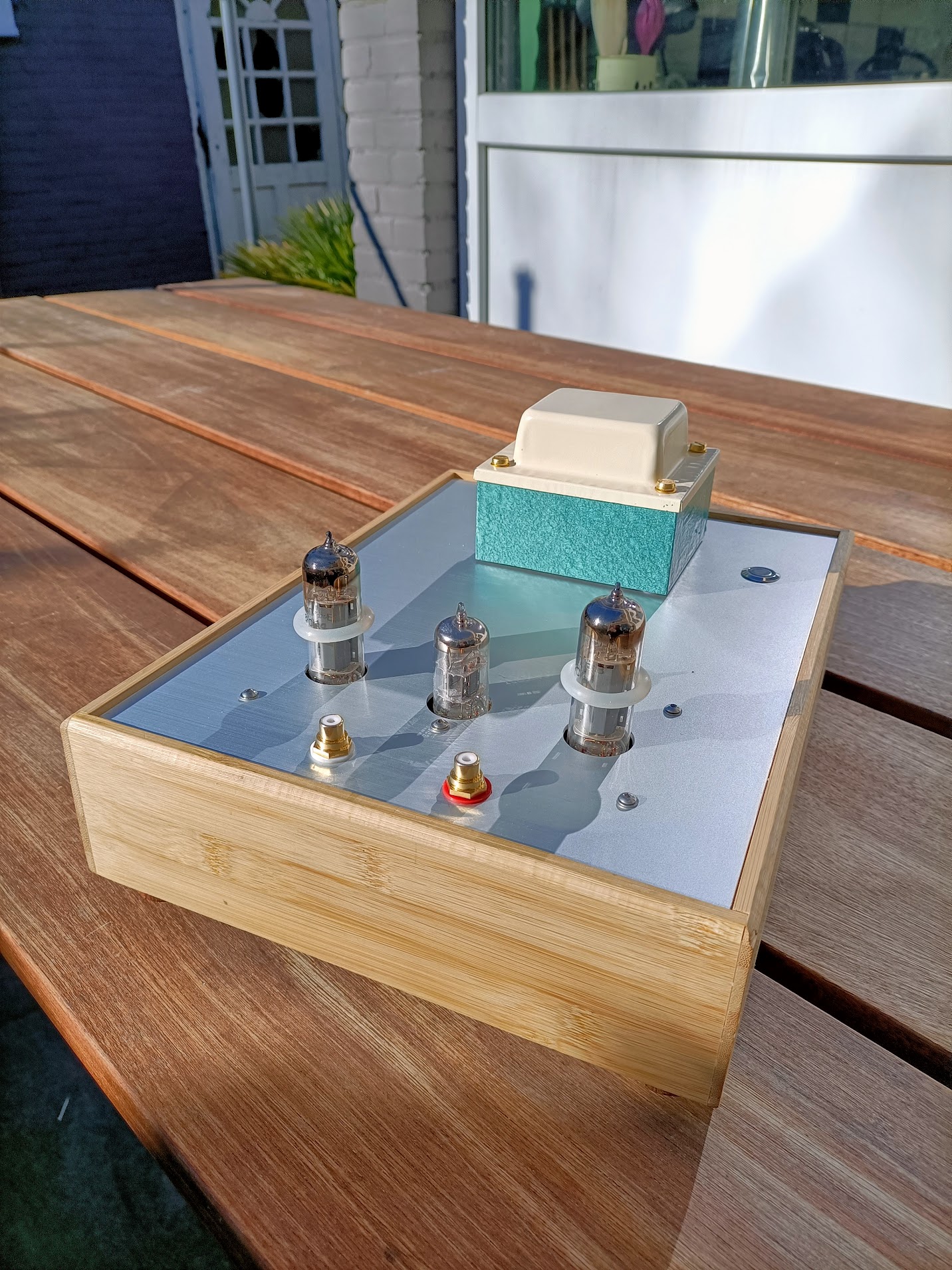

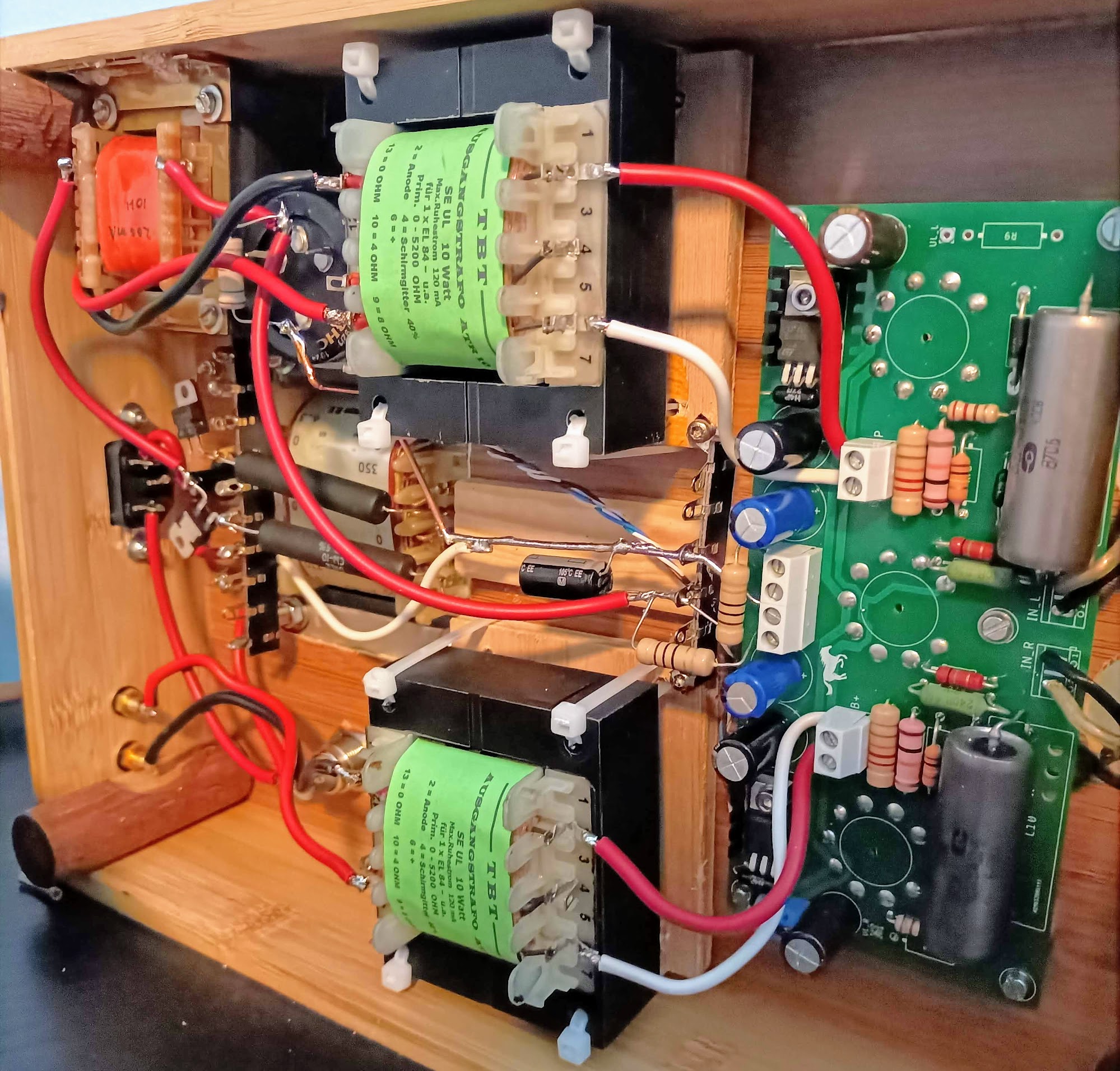

My latest RH84 build. Bamboo box bought from Action = General store with good prices. Feet=broomstick also bought from Action. Output transformers are by TBT Trafobau. Who for some reason don't have a website anymore.

Bass Horneman,
Very nice looking construction!
I am sure it sounds very nice.
You are probably using a capacitor input filter on the B+.
Choke input filtered B+ might have some hum coupling from the filter choke to the one output transformer, the coils are in equal orientation (zero degrees).

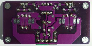

I use point to point wiring, but some people like you almost convince me to change to PCB construction.
I did point to point for years, but the cost of making a board and the fact it's harder to eff up makes it nice.
Also do p2p generally. But I like the neatness of the pcb. And some of my p2p work is a little dodgy ...but I'm getting better at it.
Thanks for all the compliments!
Indeed. There are a few small caps now after the rectifier...not that I had hum. But b+ was on the lowish side.You are probably using a capacitor input filter on the B+.

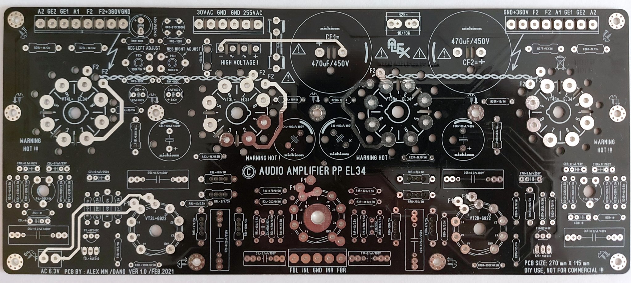

Very nice layout & execution!My last project, completed, PP with KT88 EH, with timing mode, anodic voltage, and bluetooth, Toroidy output transformers, Alps potentiometer, Kendeil electrolytic capacitors, Nipon chemikon. The laser-cut housing, painted in an electrostatic field, still has meters to connect. On and off, with smart socket mode with Tuya application and local push button.

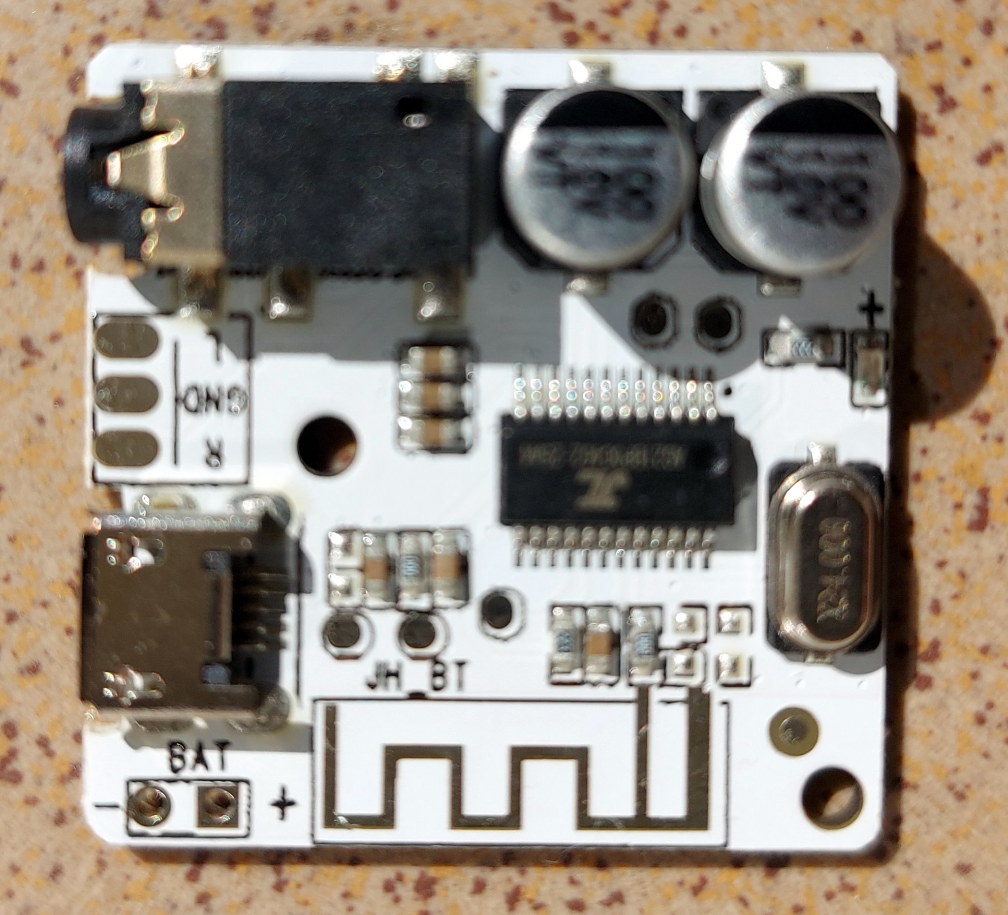

I noticed you're using MH-M18 bluetooth module. Do you have it configured so that incoming BT connection overrides the signal? Is that what the relay is for? If so, did you use the 'mute' output to control the relay? Also, does BT signal get through metal chassis OK?
Thanks,
Jim
Thanks, the anodic voltage delay relay is set to 40 seconds. The bluetooth module does not have enough attack voltage and I will replace it with a more efficient one. I also have to add the wumeter circuits. I will add a small antenna outside connected to the new bluetooth module from picture.

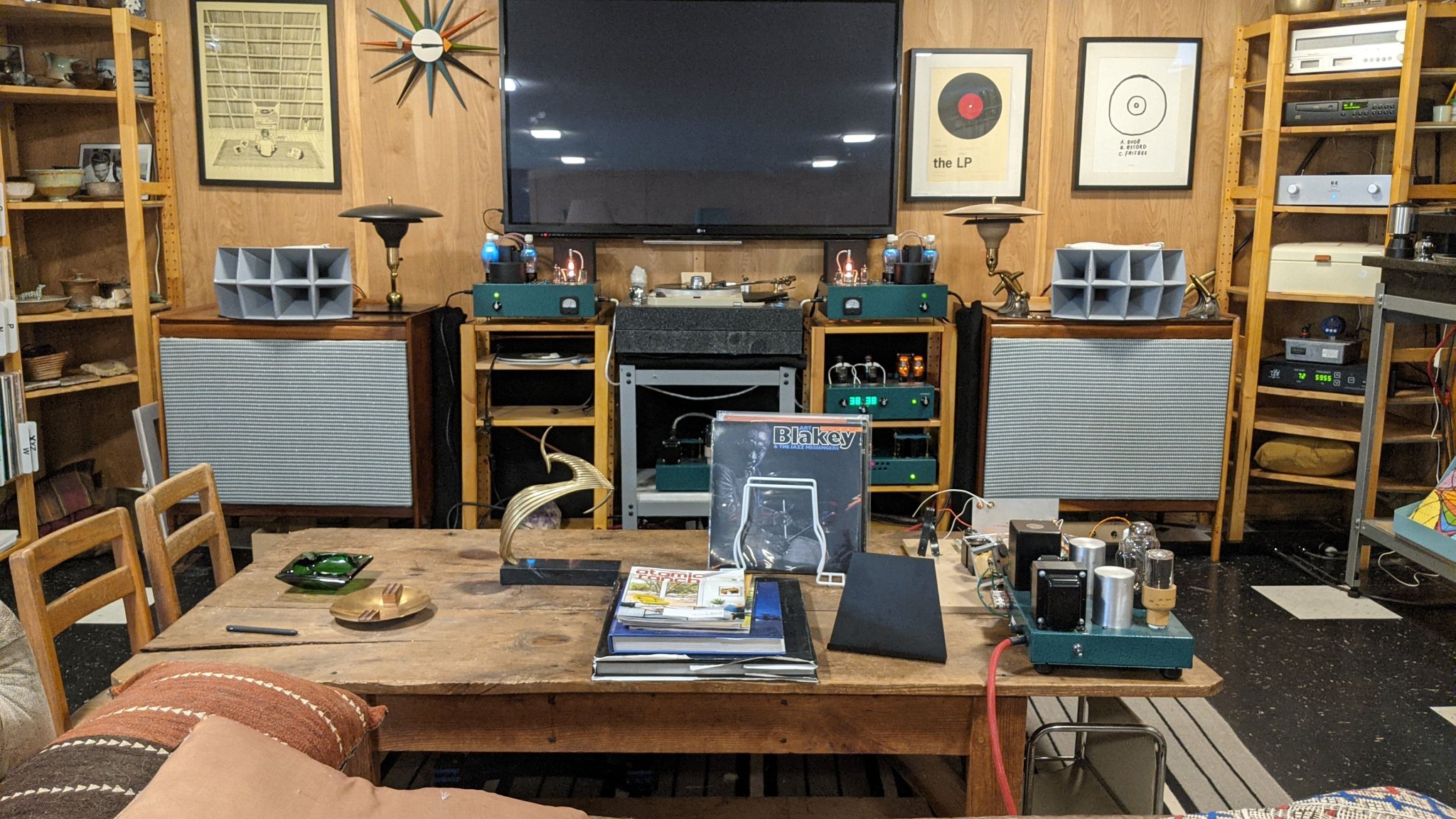

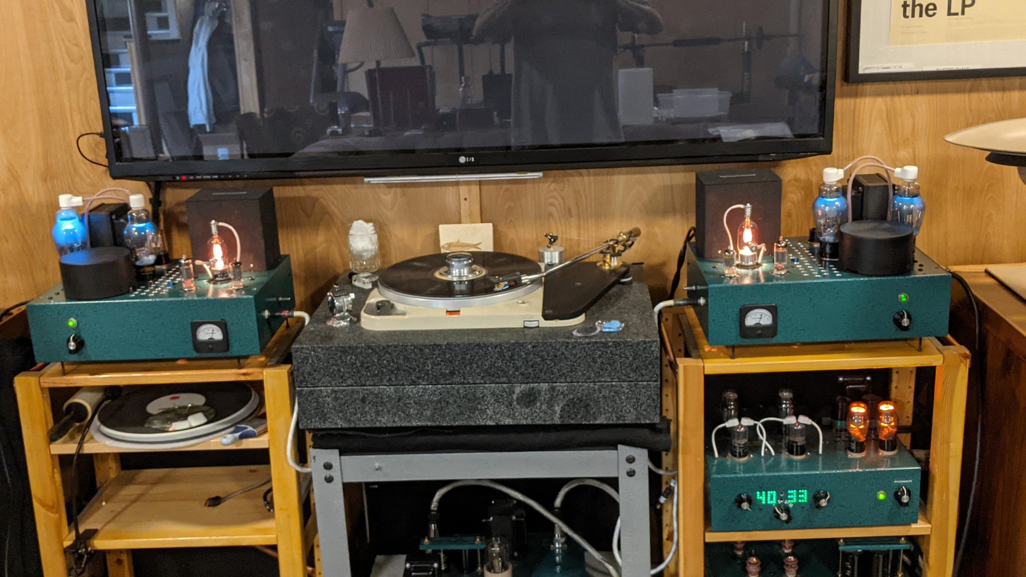

Excellent set up and mixing vintage with some modern, very beautiful functioning room, well done.
I love it.
Sent you a pm through the forum.lovely work Bas:
Where is the circuit board from. I would like to get one.

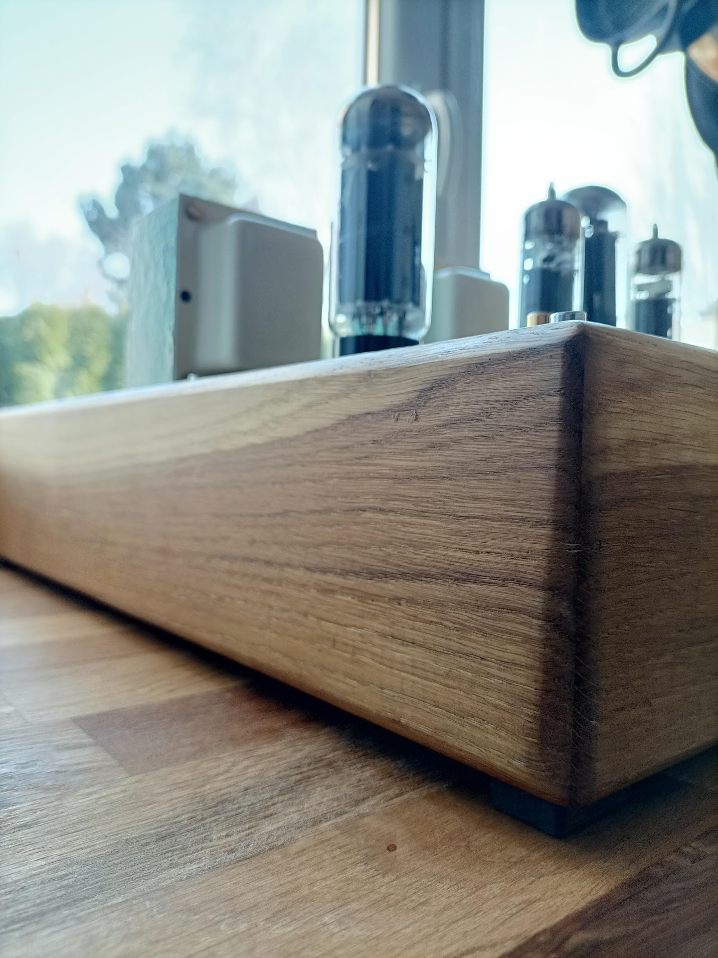

Good morning,

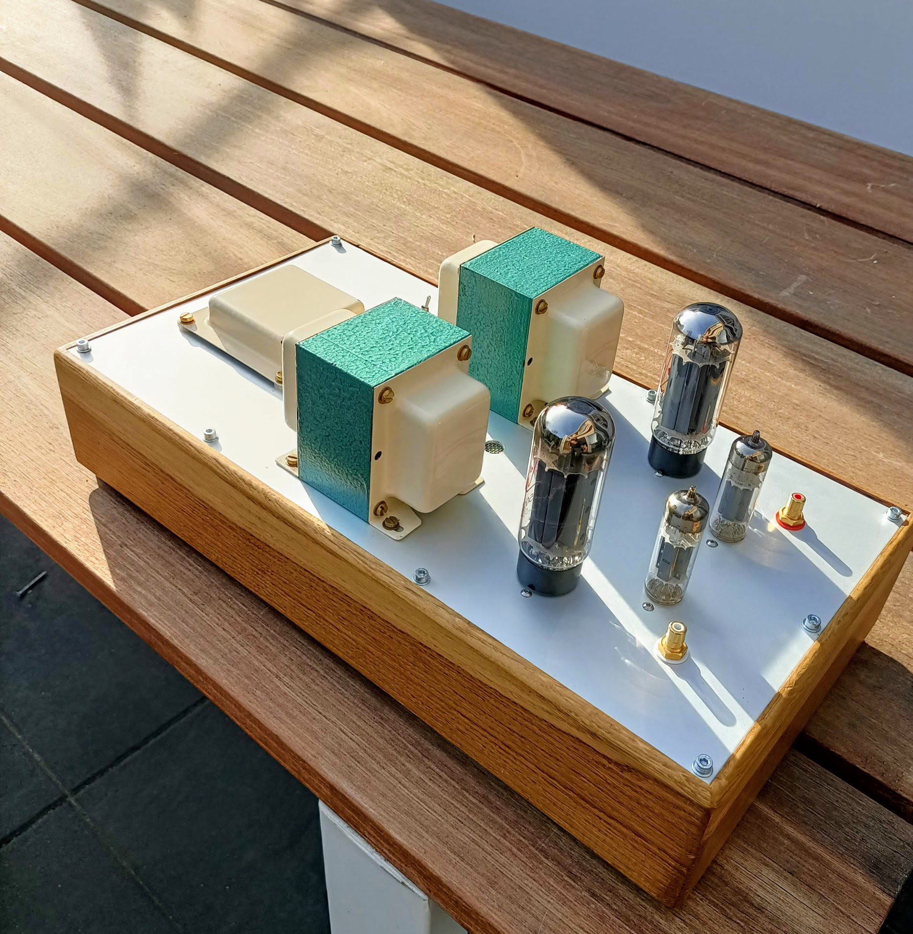

completed a few days ago the last project of a SE KT88 amplifier (based on Abdellah / Gendrano).
It is driven by a single 12AT7WC with anode CCS and the usual led + resistor cathode bias. I tried also ECC85 and 6N1P but I at the end I opted for the above mentioned. The power tubes are in a triode configuration, with a slight S.f. (500k) and an estimated output power of 5W per channel.

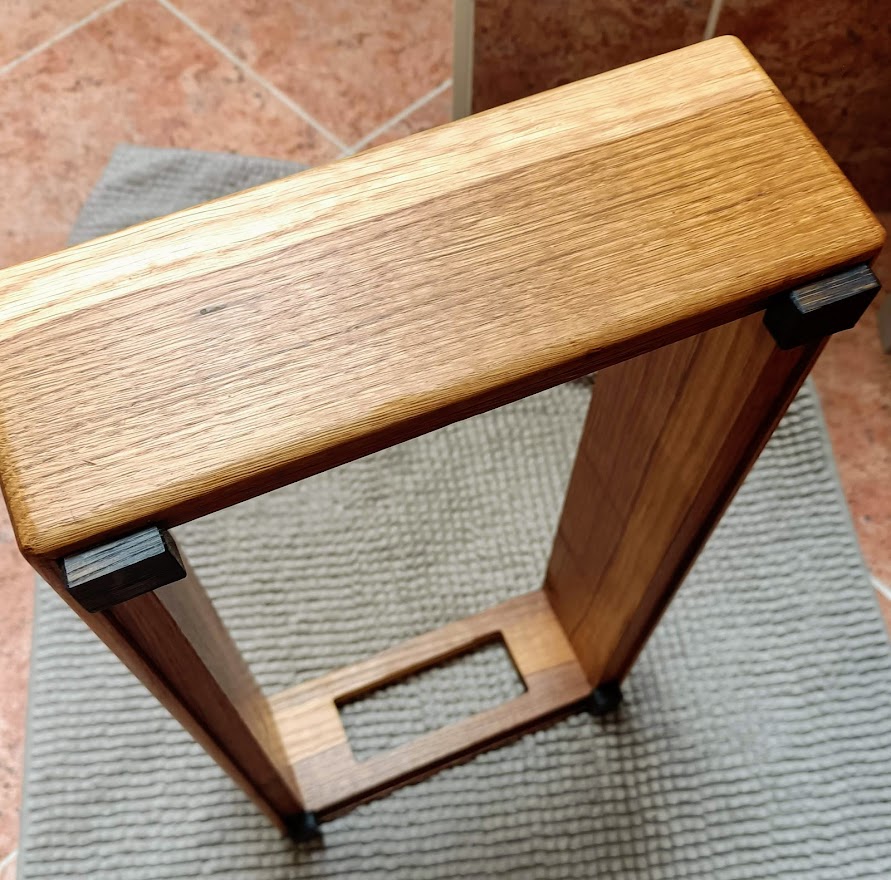

The amplifier chassis was made, as in the previous one, by a carpenter friend. This time, oak wood was used instead of chestnut. However color is quite similar.
Regarding how it plays, well in my opinion it's fine: compared to the EL34 it seems with a more full-body sound, tighter bass, but if it can be said so, perhaps less "elegant" than the younger sisters...

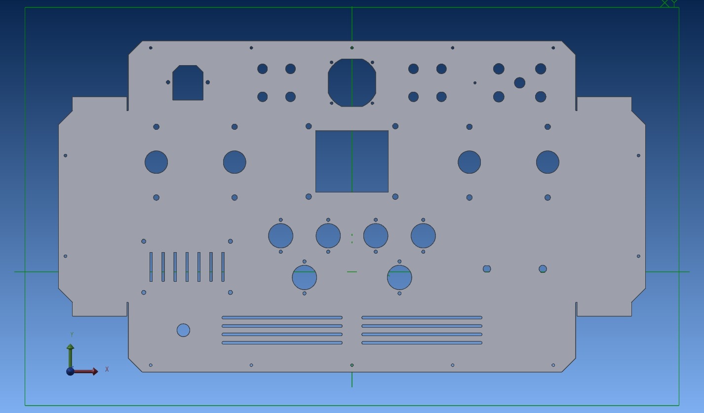

My local source is water jet- I've used them to cut everything from AL sheet up to 1/2" stainless steel. They quoted $68 for 20ga 304 stainless (non ferrous) of the file below. Water jets will exhibit some taper to the shape, which is more pronounced as the mat'l gets thicker. I'd think laser cutters would not have this phenomenon. Shop I use allows for the 'Q' of the cut (speed) to be specified (more $$) to minimize taper and maximize accuracy of shape.How about water jetting? Have costs come down for these services? I want some lettering cut through 1/4" thick stainless steel. It should look good. No other way to neatly cut the stuff that I know of.
Jim
Jim

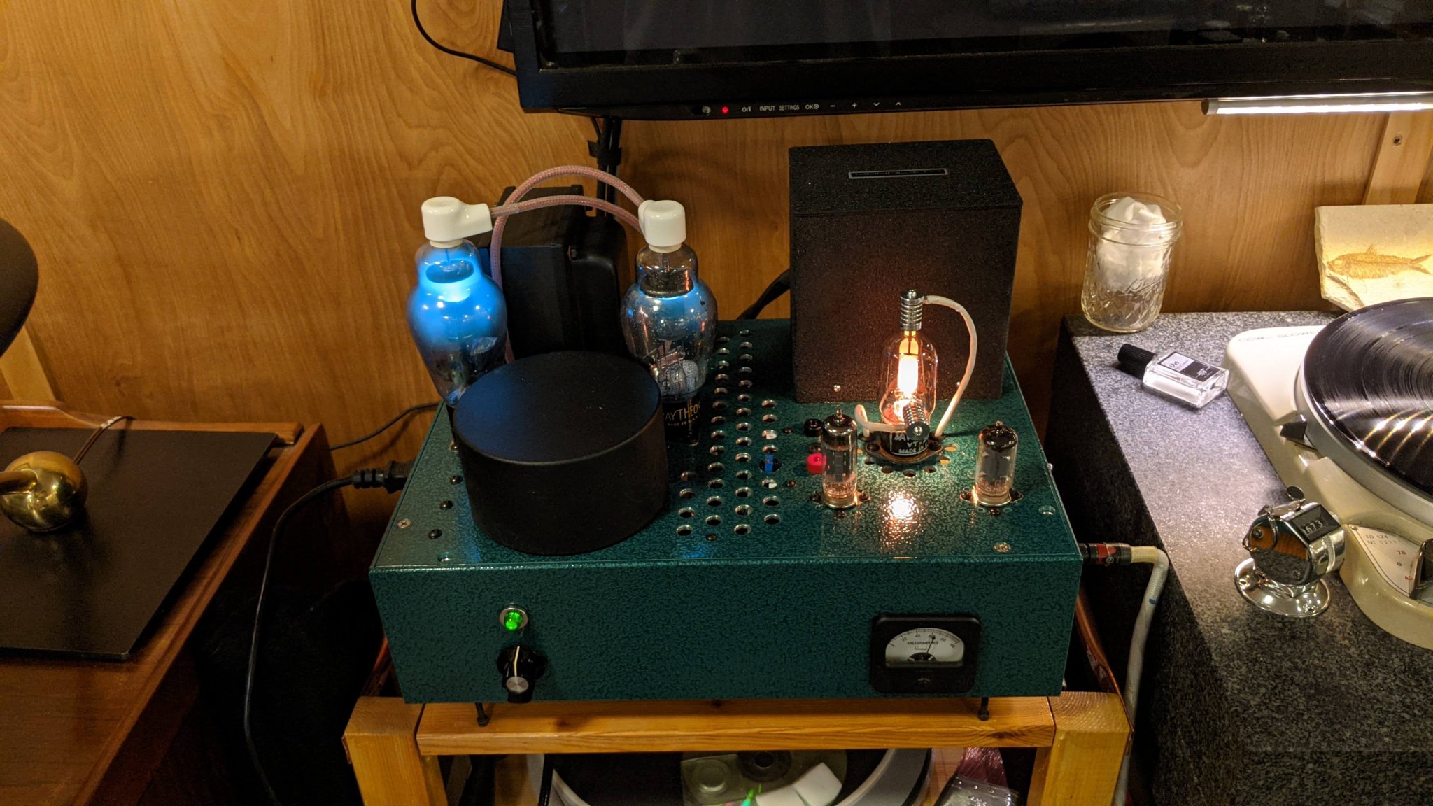

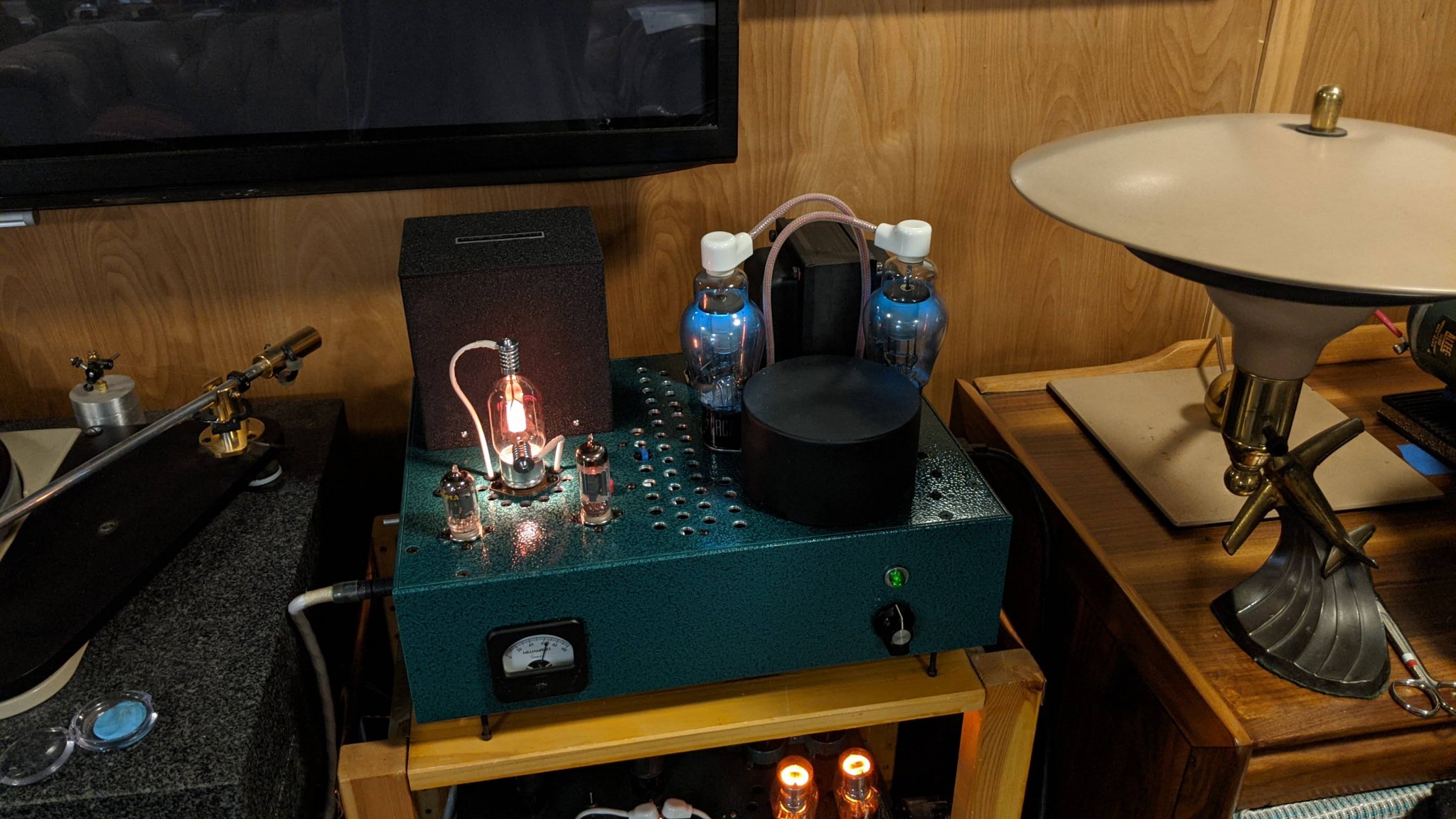

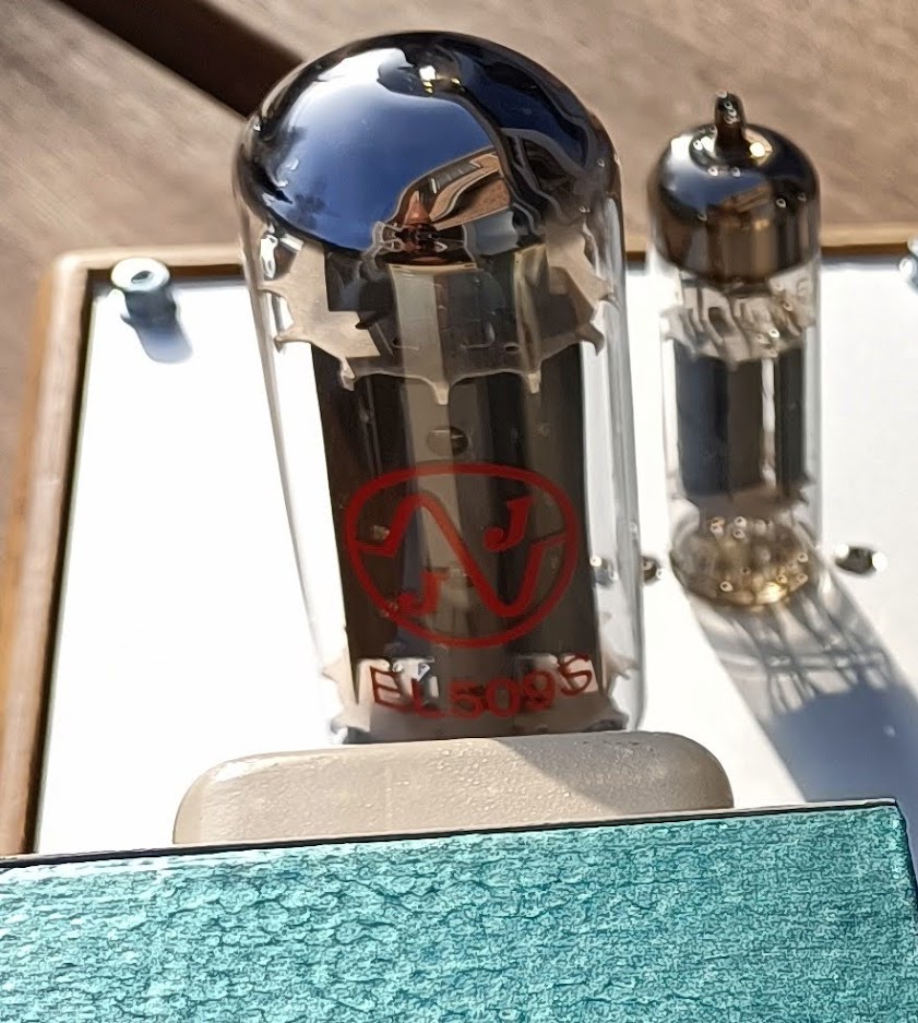

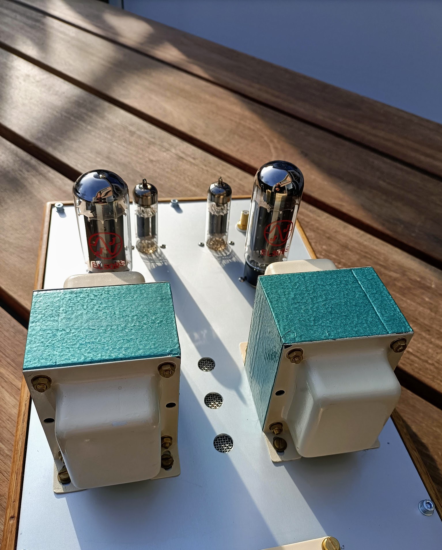

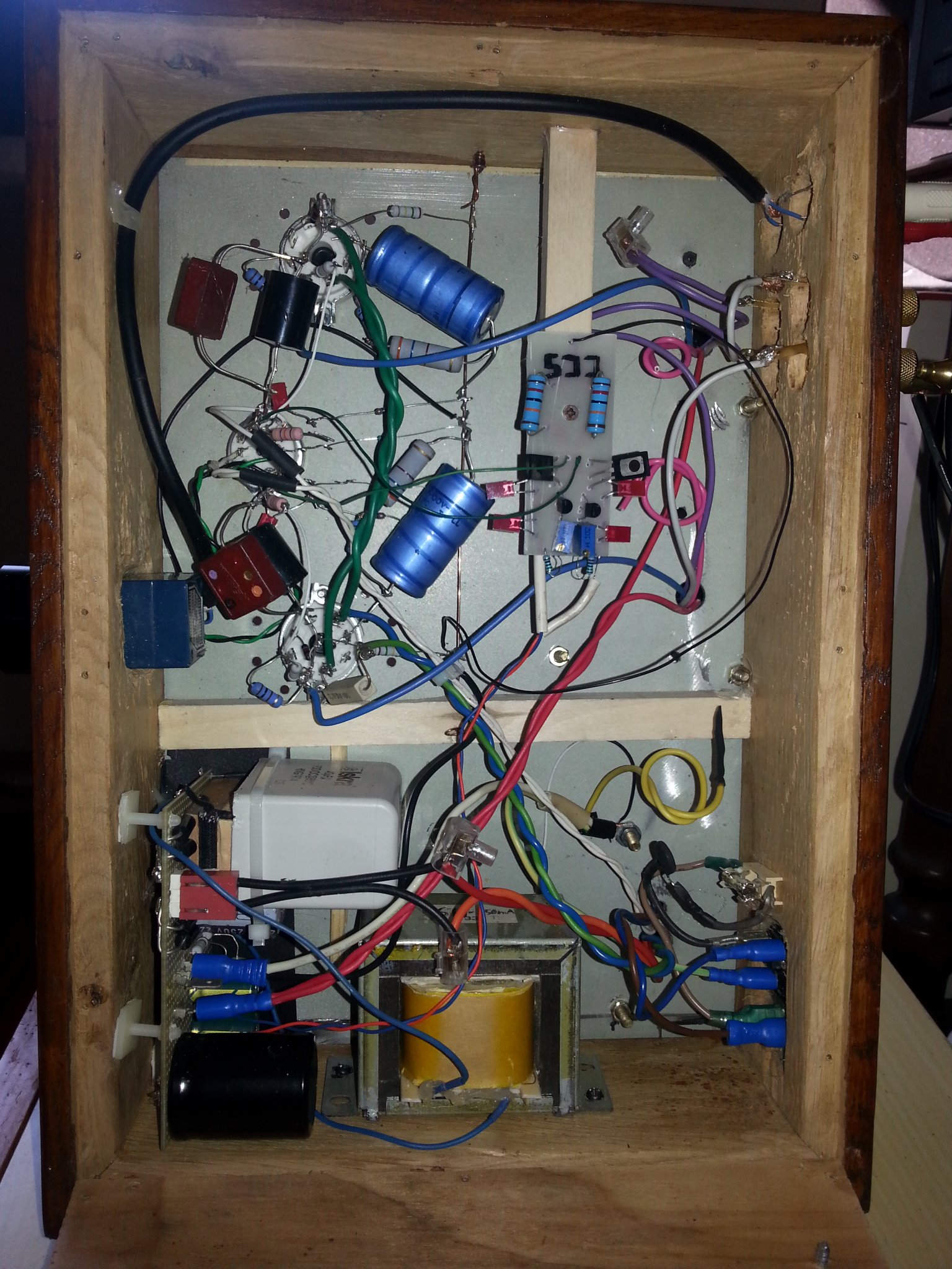

Bob Danielak EL509. With One-Electron UBT-1. My first DC coupled amp. As you can see the patient needed emergency surgery. Something fell on it. Also damaging the hammerite...but sorta patched that up.
A couple more pics
