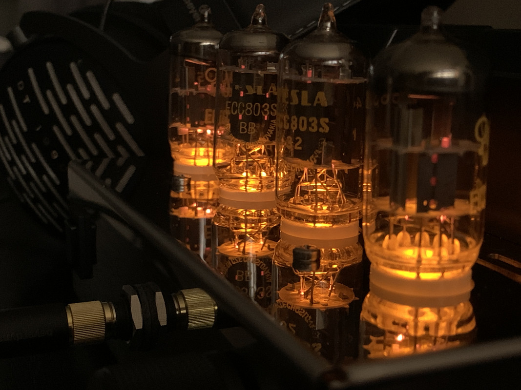

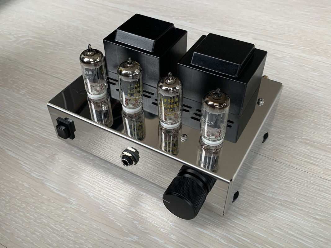

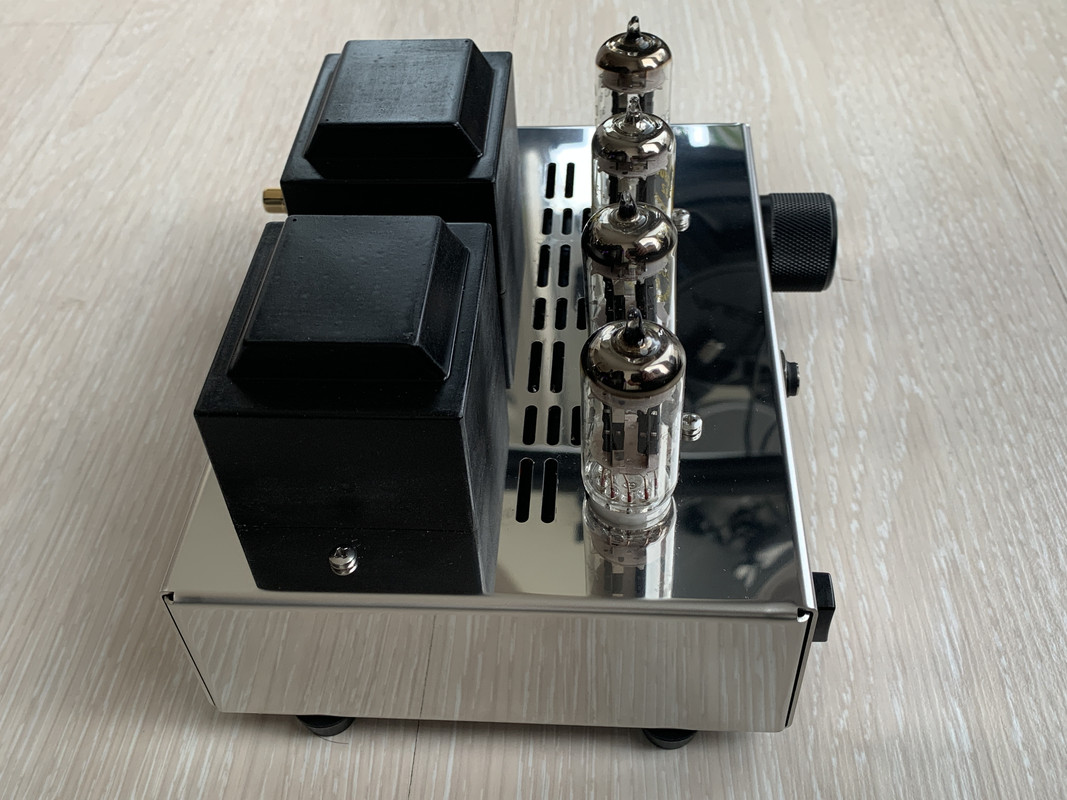

Soon I will finish my new tube headphone amp - my first headamp with output transformers! I call it CFPPHA
as "cathode feedback push pull headphone amp" 😎

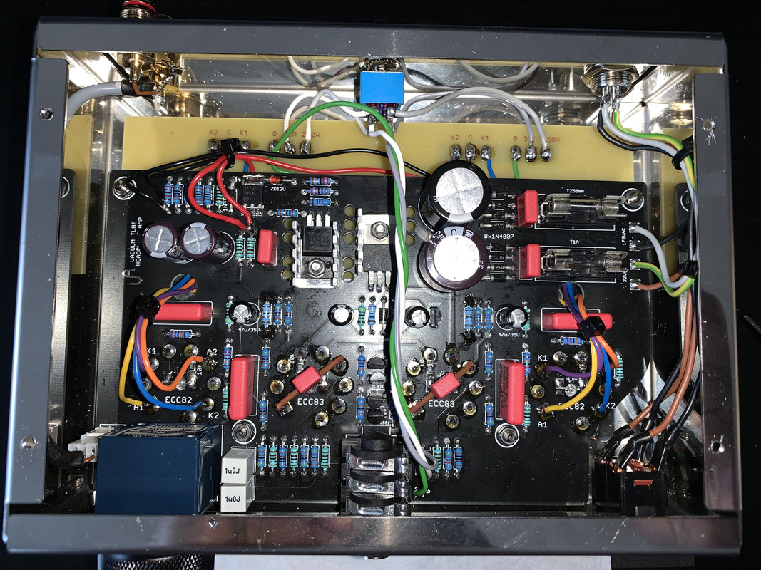

Its very small, just 18x13x4,5cm stainless steel laser-cut chassis, and very simple... ECC803S diff stage with TL431+2N5551 CCS as input and fixed biased ECC802S as PP class A output with 12% cathode winding. Apart local nfb, it has also 10dB of global negative feedback. It contains also MOS+LM317 regulated +220V and LM337 slow turn on -25,5V PSU all in one PCB! Internals:
Output power is ~0,1-0,5W RMS into 32R or 250R outputs. Output transformers are of my own design and winded on order. They consists of 4 series primaries sections, 2 parallel tapped secondaries and 3 paralel balanced cathode windings. Primaries+cathode windings together results as 21k "Raa-Rkk" load. Its relative "big" silicon grade oriented steel cores EI60/21, go as far as 3Hz -3dB!
I have not measured THD yet as I am still working on PSU for this and also tweaking amount of nfb. It will have remote transformer in separated adapter-like case, because of EM hum in opts for excellent S/N results. More images:

Nicely done!
I love the chrome finish but I know from experience I only love it for a couple of days before it becomes a dusting nightmare LOL
But anyway : a very nice piece of workmanship!!Nicely done!
Your headphone amp really looks fantastic Wiliks! Did you get the chassis made from a local shop, or some firm that is available online? I would love to try a similar chassis design for one of my projects.
