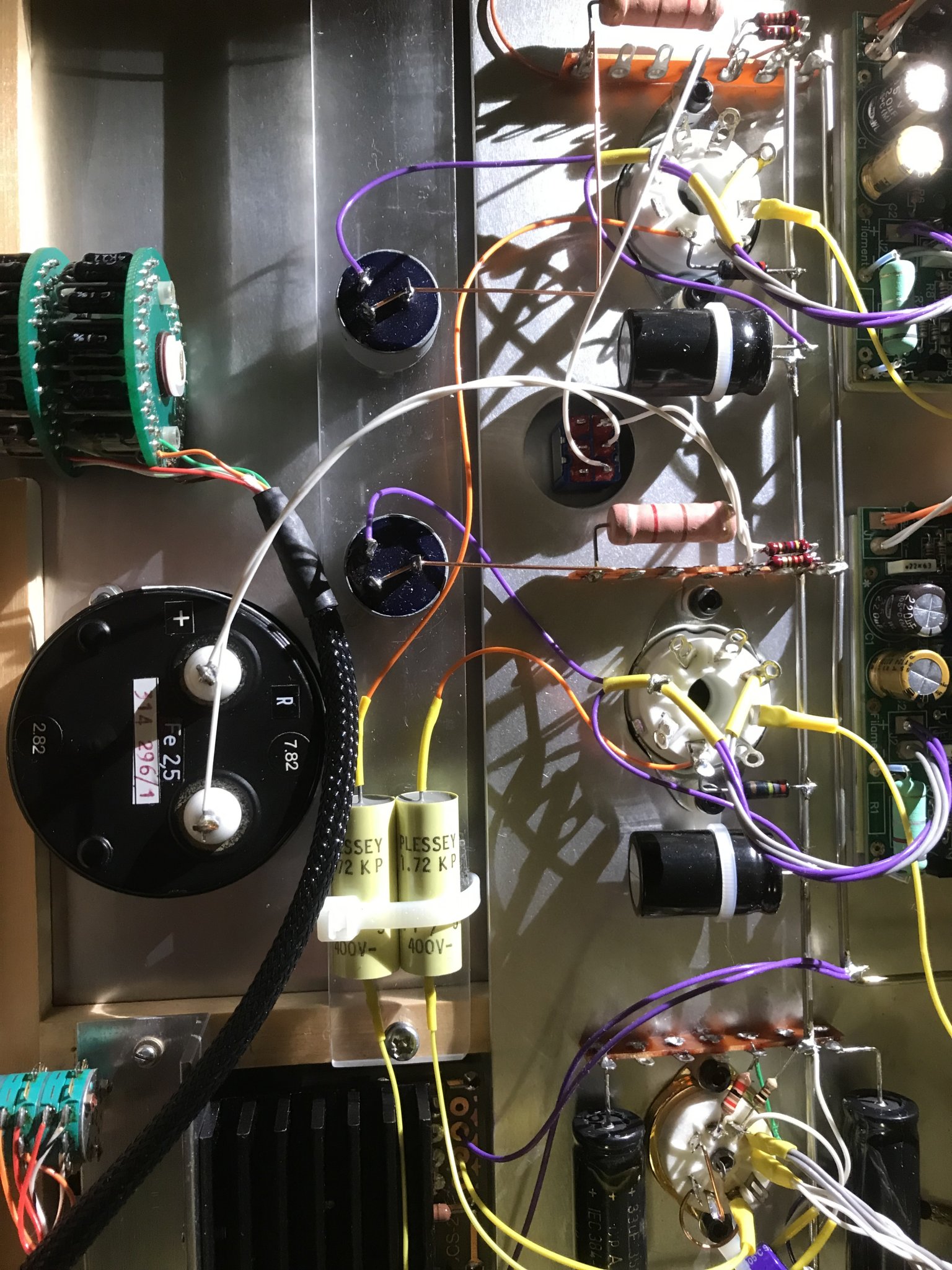

Actually, it's a power amp - there's no volume control as it's controlled by a preamp. The double RCA acts as a passthrough to daisychain multiple amplifiers.

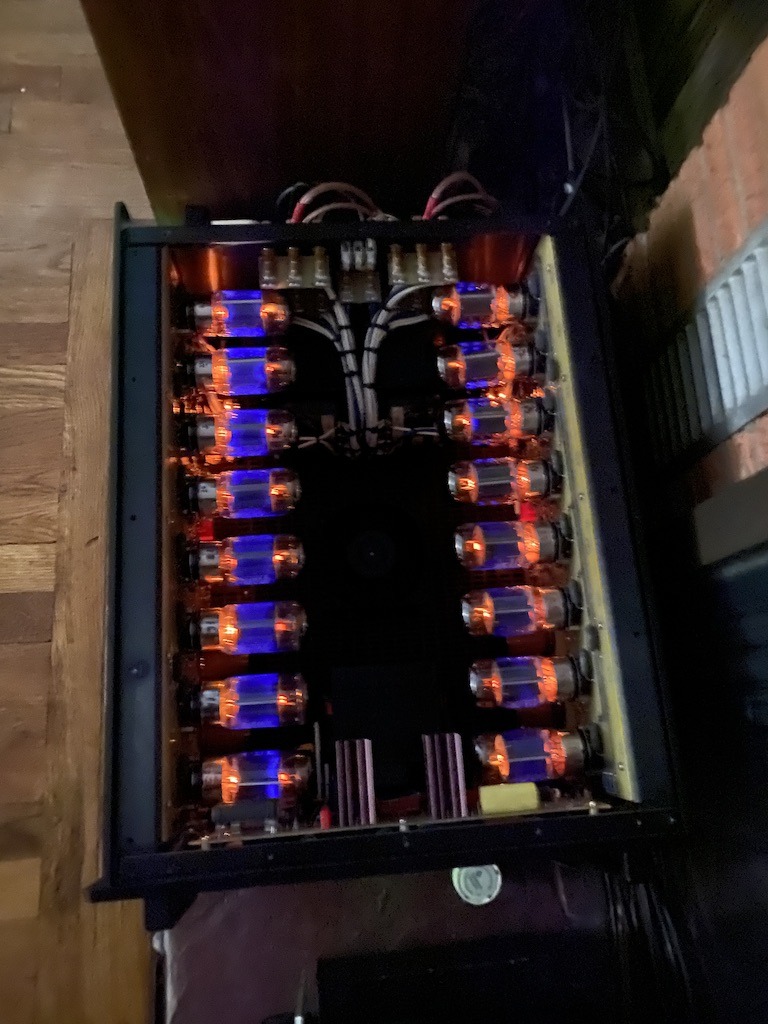

Fun fact - if I put my hand under the amp where the choke is, I can feel the case vibrate to the music from the magnetic field... That choke is insane but so it the amp. Idle current is 320mA+@560V - 180W of flow through it with music 🙂
Great looking build, very classic on top, very modern inside!
Is the module in the middle one of those 12/24V to 220...380 AC from China? I've been looking at those as high voltage source, are they reliable?
Yes, it's a 12V - 110-200-220-280V module configured as a voltage doubler for 560V for the front end.
The ones with black heatsinks have been reliable for years for me but I got some different ones with silver heatsinks and two failed quickly. I think the 3525 chips are bad or something.
These ones are the last ones I ordered that worked like I expect.

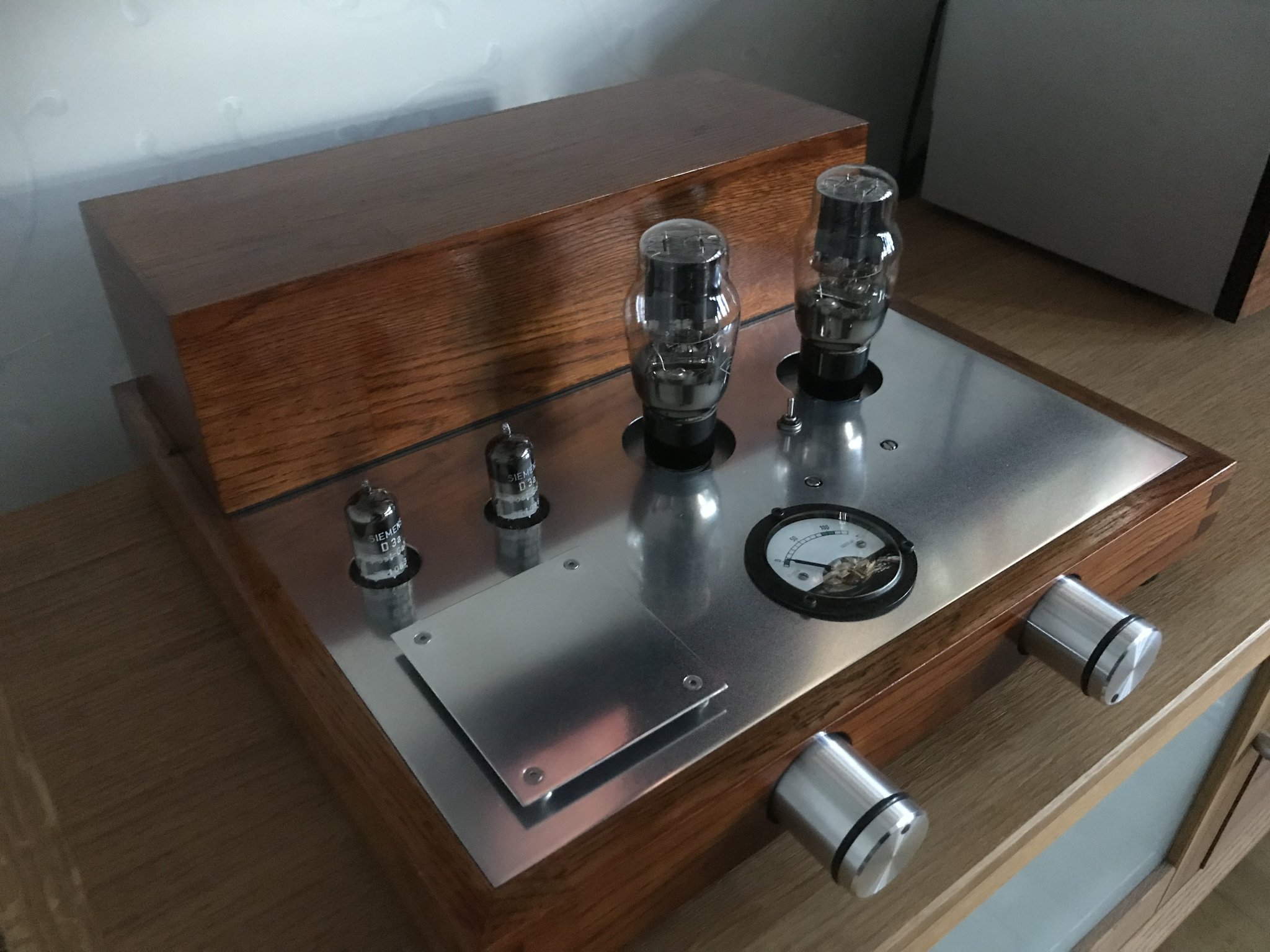

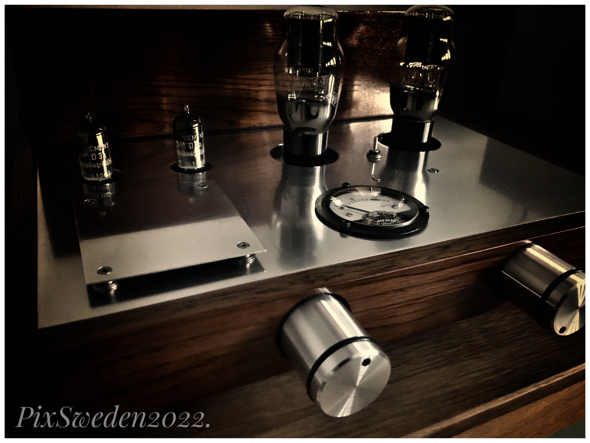

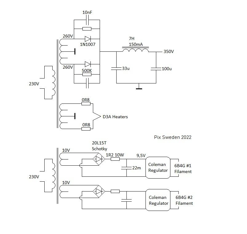

This is my latest project.

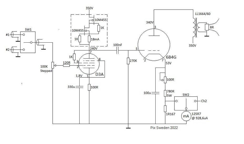

It's my own design using D3A / 6B4G SE-amplifier.
See my built in detail here
http://www.hififorum.nu/forum/topic.asp?TOPIC_ID=90020&whichpage=49
It's sounds just fantastic!

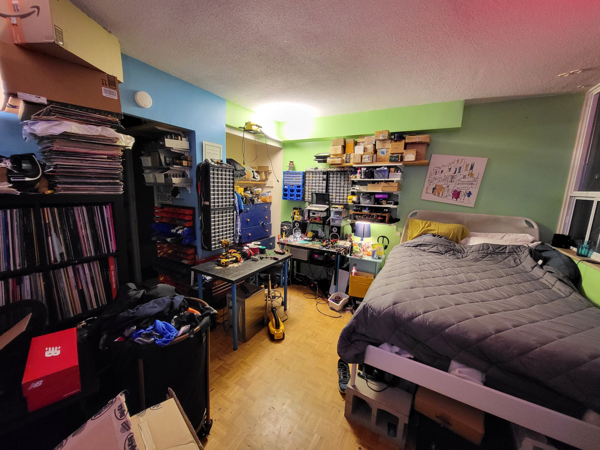

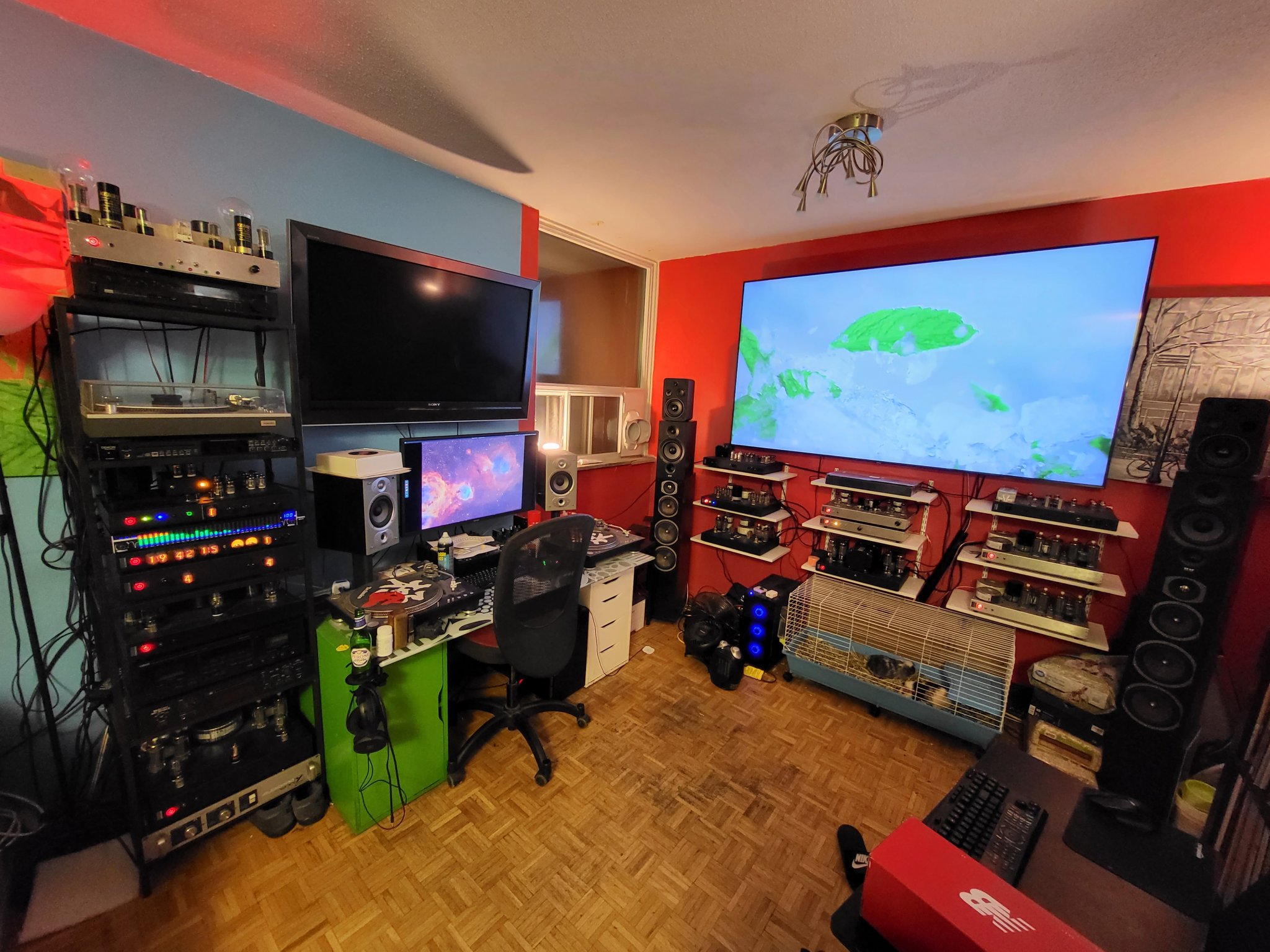

So I build another switch and now I can have 9 different amps switched between 4 sets of speakers... What a bastard... They both need to run from the same side of the fuse box... that means I needed to run an extension cord but it works and the hum is minimal.
Also, Nigel and Grey (the guinea pigs) say Hi!
And for poops and giggles, here's the opposising view of my little apartment.
They crooked artwork sums up my life at the moment...

That looks like a real man cave! I didn't notice the artwork?
I'm jealous because my wife would only let me have a setup like that in the garage, then complain about my choice of music and the volume.
Green with envy here...So I build another switch and now I can have 9 different amps switched between 4 sets of speakers... What a bastard... They both need to run from the same side of the fuse box... that means I needed to run an extension cord but it works and the hum is minimal.

I think you need another tube amp... I thought I had a lot of tubes around... This is giving me ideas... I have more spots on the table on my side. Do you sell the amps?So I build another switch and now I can have 9 different amps switched between 4 sets of speakers... What a bastard... They both need to run from the same side of the fuse box... that means I needed to run an extension cord but it works and the hum is minimal.

The one on the lower left is being rebuilt this week...
Yes, I'll sell them but I haven't really attempted to market them yet. Some of them we're prototypes, too. The ones in the aluminum chassis are point to point even.

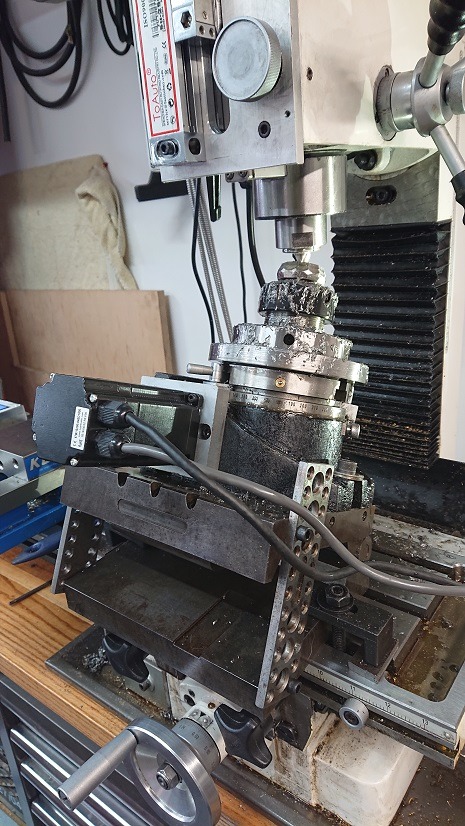

I'm particularly interested in the case ...Looks like mahogany?
And then the machining-
Either 3 axis CNC router or some large diameter ball nose bits?
Jim
It's all old school. A Precision Mathews mill with five axis capability. I don't really need CNC as these things are pretty much just "one off pairs". In the spirit of diy learning my son is teaching me auto cad so I can get a better idea of the cases before I drill holes.
The wood is padauk.
Cheers; Glenn
