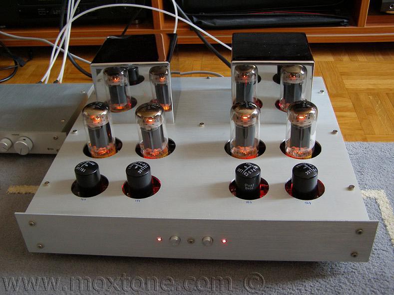

Hi:
Here's my newborn PP tubeamp. It uses the Siemens tetrode F2a connected in the triode mode. The driver tube is the Siemens pentode C3g (for more pics, go to my website- Siemox F2a project; I also intend to upload the shematic and measurements in the next couple of days).
Milan
Milan
I love your chassis, Milan. And since, after all, Venice is a couple of hours from Croatia, please tell me where did you find it 😀
Hi guys:
Thanks for such positive feedback. The best part is that the amp sounds even better than it looks. Pair it with a DIY AMT1/JBL123A speakers combo and you got yourself a match made in heaven.
The chassis is all DIY. I made it from eloxated aluminum plates and profiles, and it was a hell of a job. Recommended only to those with nerves of steel. Venetians are known for making even more beautiful stuff, though. 😉
Milan
Milan

I had a peek at your site, nice, it's all candy 🙂
What do the switches on the back do?
Shawn.
Hi Shawn:
Thanks for visiting my site. Glad you like it. 🙂
The switches next to the input connectors allow me to choose between the balanced and unbalanced input. The one next to the mains connector is for ground lifting.
Milan
Milan
moamps said:Hi Shawn:
When and why do you lift the ground?
What ground are you lifting from what kind of ground?
Perhaps a schematic would answer these silly questions?
Ja Bless,
Shawn.
The questions are not at all silly.
Ground lifting refers to separating the safety ground (to which the chassis is connected) from the power ground of the amp. The ground lifting switch comes in useful to minimize or avoid altogether any ground loop problems typically associated with audio systems.
I'll try to get the schematic up over the weekend. I suspect a few pics of the inside of the amp might be welcome as well. 😉
Milan
Milan

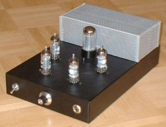

Hi Miklos,
Very nice! I also used ECL84 (actually PCL84) for a somewhat larger PP headphone amp. It is able to drive small bookshelf speakers, too.
Tom
miklos said:Headphone amp with Russian ECL84 video tube. The output pentode section is in a cathode follower configuration.
Miklos
Tom

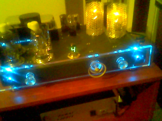

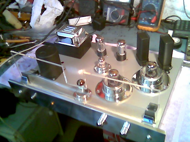

Re: 801 tube preampl.
You're all lit up like a Christmas Tree, brilliant! True art! Do you have more photos, like building it and putting it together. How do you like it? Shawn.
gianis said:and a pic from my latest preampl. with 801 tube [poor foto from my mobile cam] 😱
