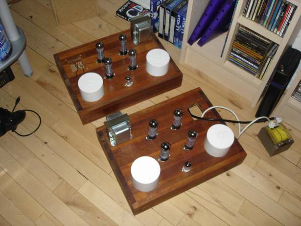

Kitchen bench production the last 6 months, from left to right:
Valhalla: Based on KT90 in ultra linear, class AB2. Mullard/leak input technology with following gain stage and DC coupled cathode follower for power stage feed. (External power supply not on the picture). The amp runs with 10dB partial feedback from the primary of the OPTs back to the driver stage and 14dB global NFB.
Powerful amp with clean sound.
More information: http://www.veiset.net/valhalla/ (Norwegian only)
Sweep AMP: 6LU8 in PP pentode mode with stabilized g2 voltage, class AB1.
Very good little amp build around vertical deflection tubes. Makes 2x15W on a good day with reasonable low distortion. Most people who have listen to this one have been surprised over how well it performs.
More information: http://www.veiset.net/6LU8/ (Norwegian only)

Re: EchoFish and other fishes.
Hi Jane
Beautiful work indeed!
But: I never saw a KT90 with a shape of the glass envelope like the ones you are showing in your pics...
Can you spread some light on this subject (brand, cost, etc) on those KT90?
Ricardo

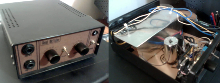

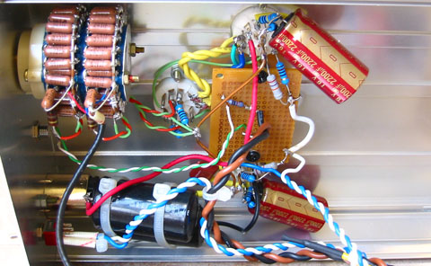

digi01 said:p2p inside.
digi01, I bet if you removed that pot and changed it to a alps. It would sound better. I have roof. When i was at Briangt's house 2 weeks ago he had that same pot in a chip amp. ICKK the firs thing we did was removed it and used a alps WOAH!!😱 SOUND improved so much.
Jase
Re: Re: EchoFish and other fishes.
The KT90s are Golden Dragon. I found them quite good sounding and reliable. The working conditions in this set up is Va=550V and Ia=60-65mA. It seems to me that it is possible to squeeze a little bit more power out of the KT90s than KT88s of the same (and other) brand.
I Norway KT90 is about 20-30% more expensive than KT88.
rwellerson said:I never saw a KT90 with a shape of the glass envelope like the ones you are showing in your pics...
If somebody is interested in the complete drawings for building this 50 watt amplifiers please let me know then I will post it.

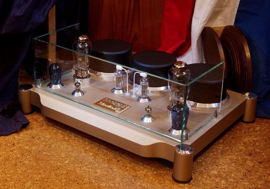

Totally amazing, please could You send me some photos in hi-res?Originally posted by jane ...
Hi Ahmad,
Great amp by audiomaniacs isn't it? I featured it in my magazine.
p.s. audiomaniacs is building some horns for me..
Compromised URL removed by Moderation
I take it the transformer and choke have not arrived yet?
