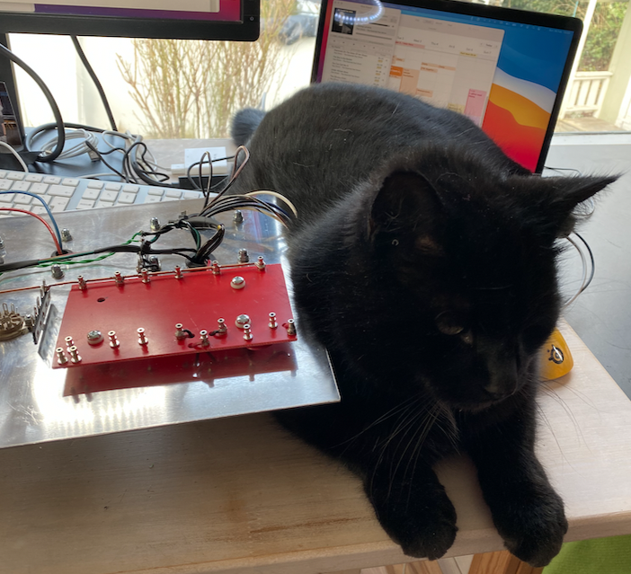

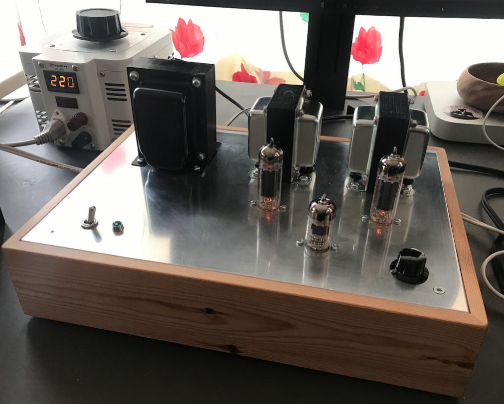

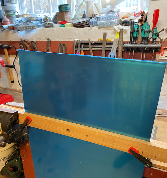

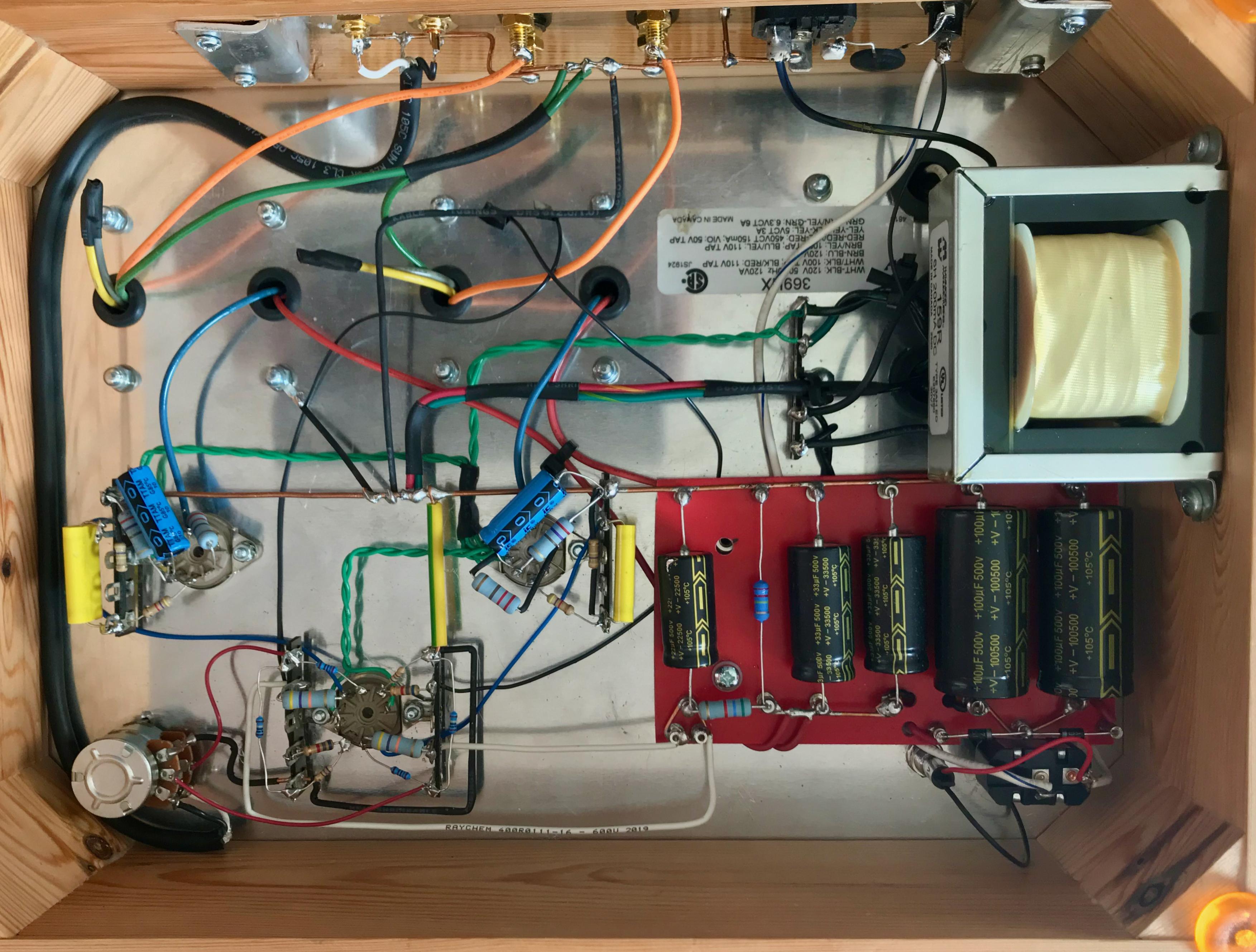

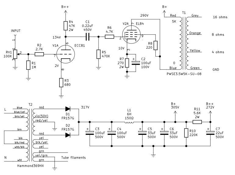

Hi, I have just completed my first P2P tube amp. It's a ECC81-EL84 SE amp. Currently it's running the EL84's in triode mode without NFB. I have attached a schematic with the measured voltages.

Your cat belongs in this thread: Show off your audiophile cat.
Shameless thread promotion!
:D
Thanks for the plug, I'd missed that thread completely.
A good catssistant is tantamount to a succesful project. They play a crucial role in inspecting the smell and comfort of things and gravitational properties of components. They also contribute to softer sounding amplifiers by coating everything with a softening fibrous dampening material.
"A good catssistant is tantamount to a succesful project. They play a crucial role in inspecting the smell and comfort of things and gravitational properties of components. They also contribute to softer sounding amplifiers by coating everything with a softening fibrous dampening material."
I 100% agree!! :)
Thelmer great job and I think the beautiful black cat help you so much...;) ....by the way what output do you get with that amp....thanks
I just measured the output with a scope and I get 2.5W before clipping. It's running a bit lean with only 37 ma current running through the EL84. I will adjust the cathode bias resistor to get it up around 45 ma. Then it should deliver around 3W. It's already loud enough for use in my office.

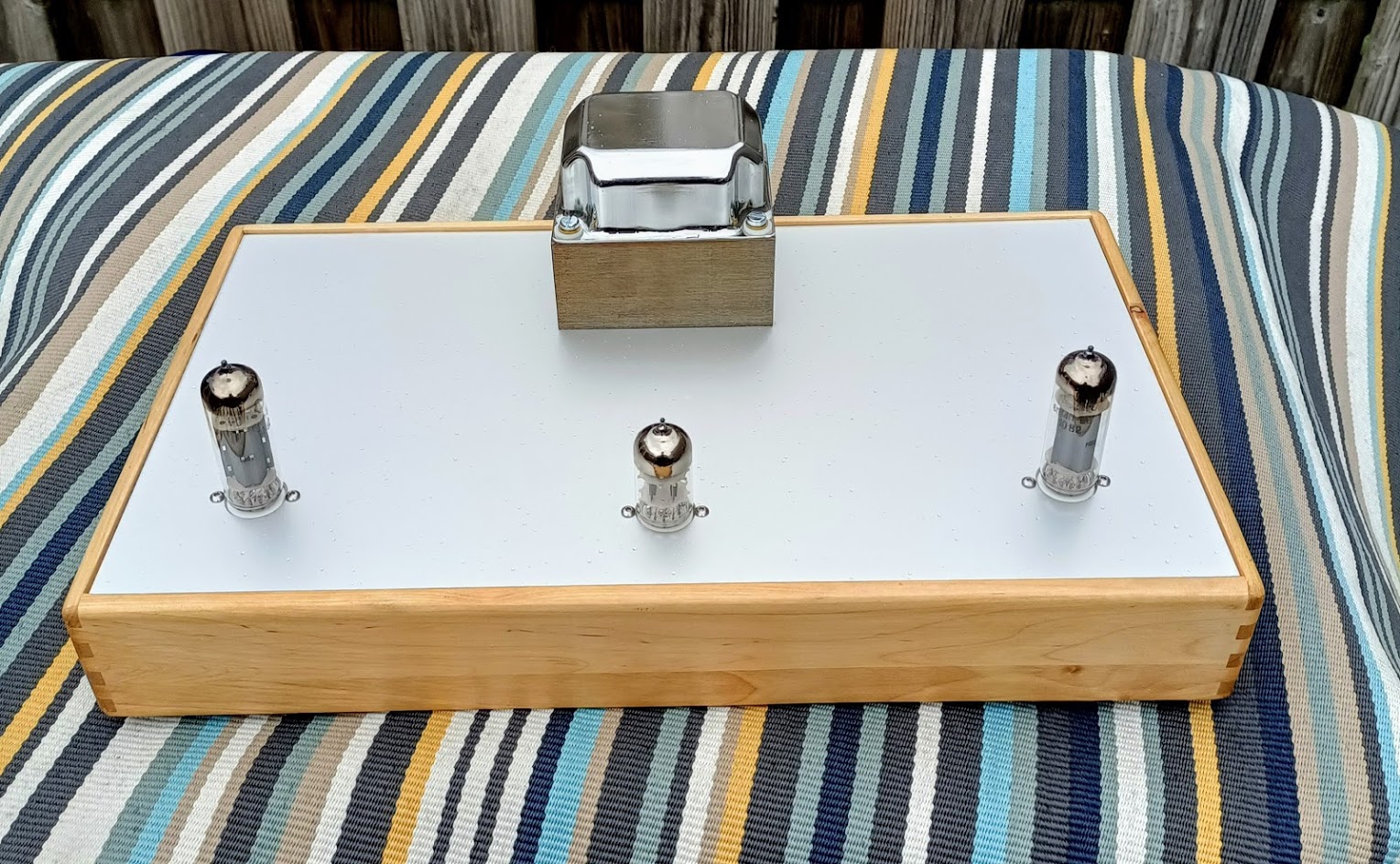

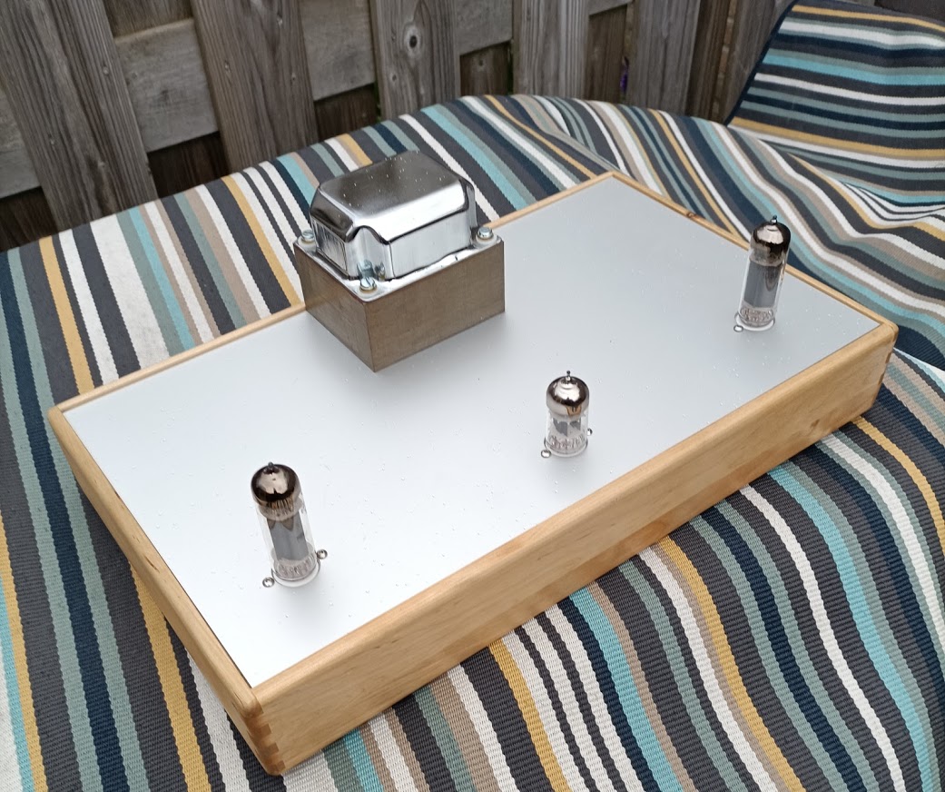

I see your tubes arw physically distancing BAS :^)

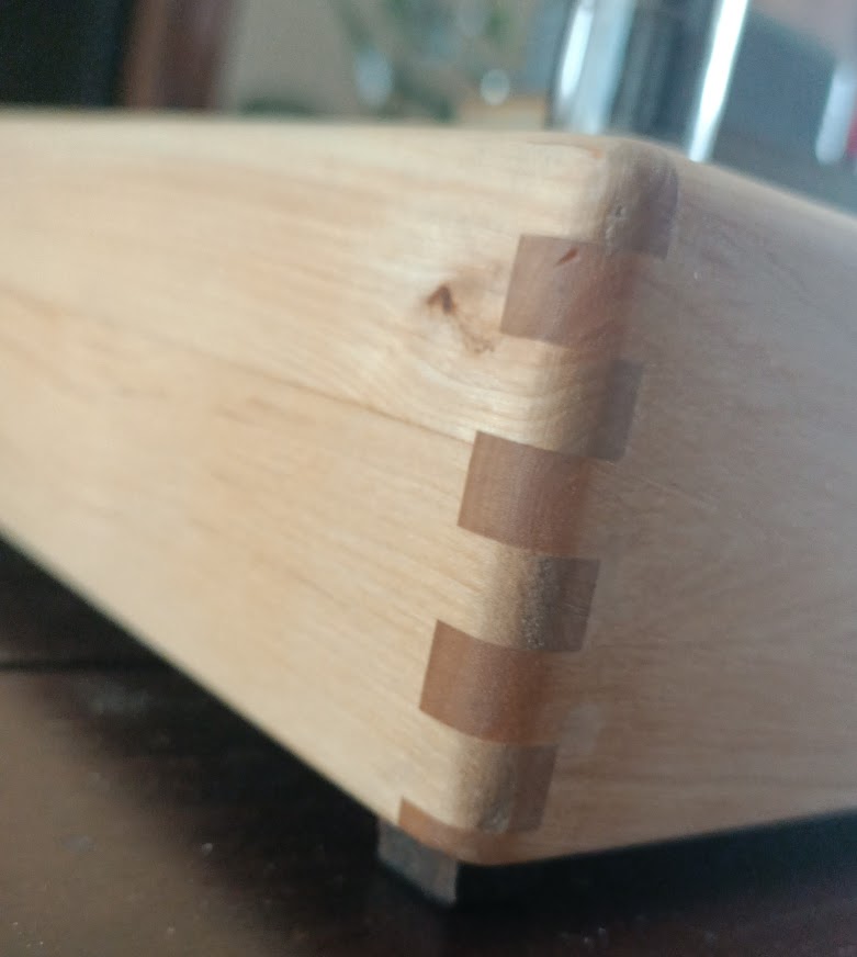

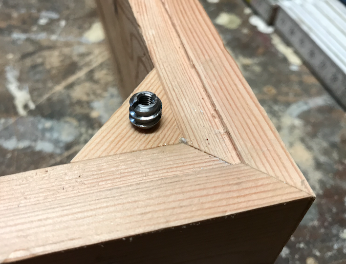

I really like the woodwork.
I like to keep wiring as short as possible, just leaving enuff room for accomodating tube coolers.
Without any prejudice or judging someone or someone's work, I must just say that I think it's easier to get a good layout with as little as spare space as possible.
Besides with the lack in free space at home, I prefer physical small amps (and speakers).

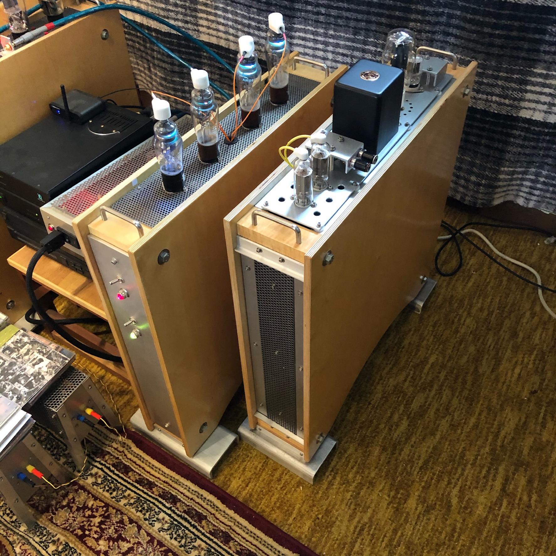

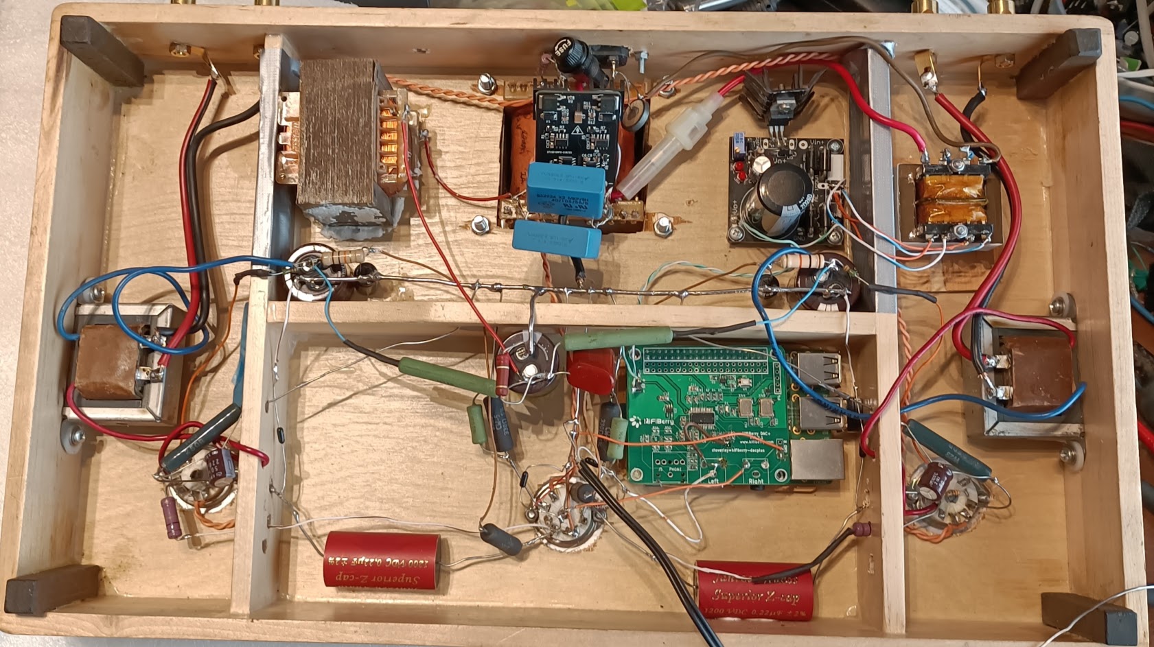

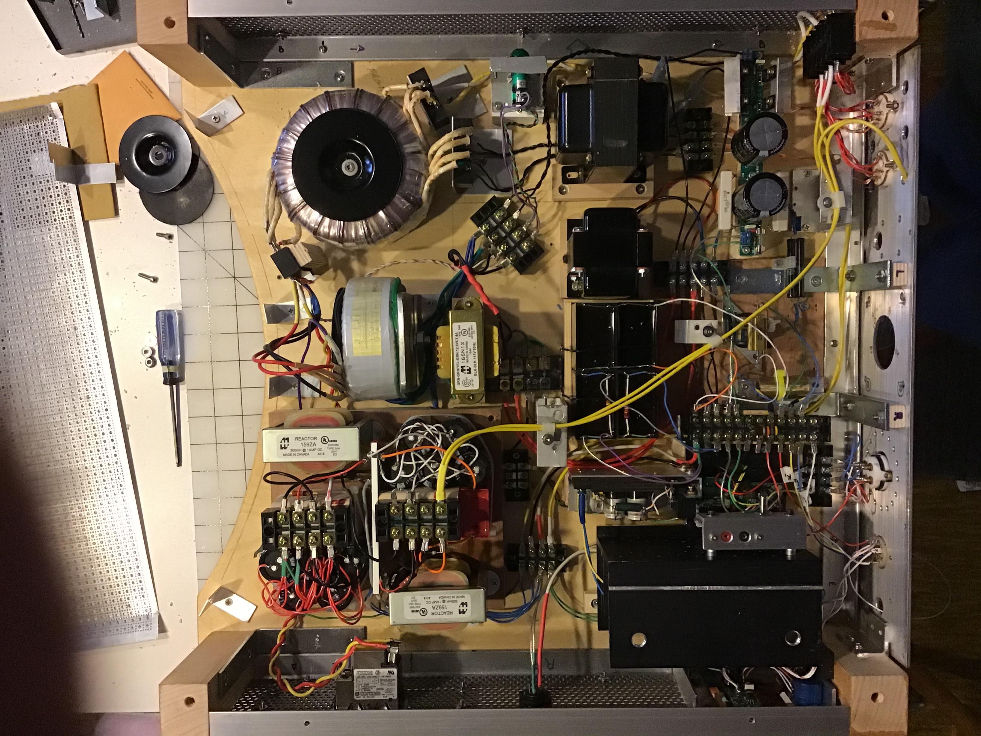

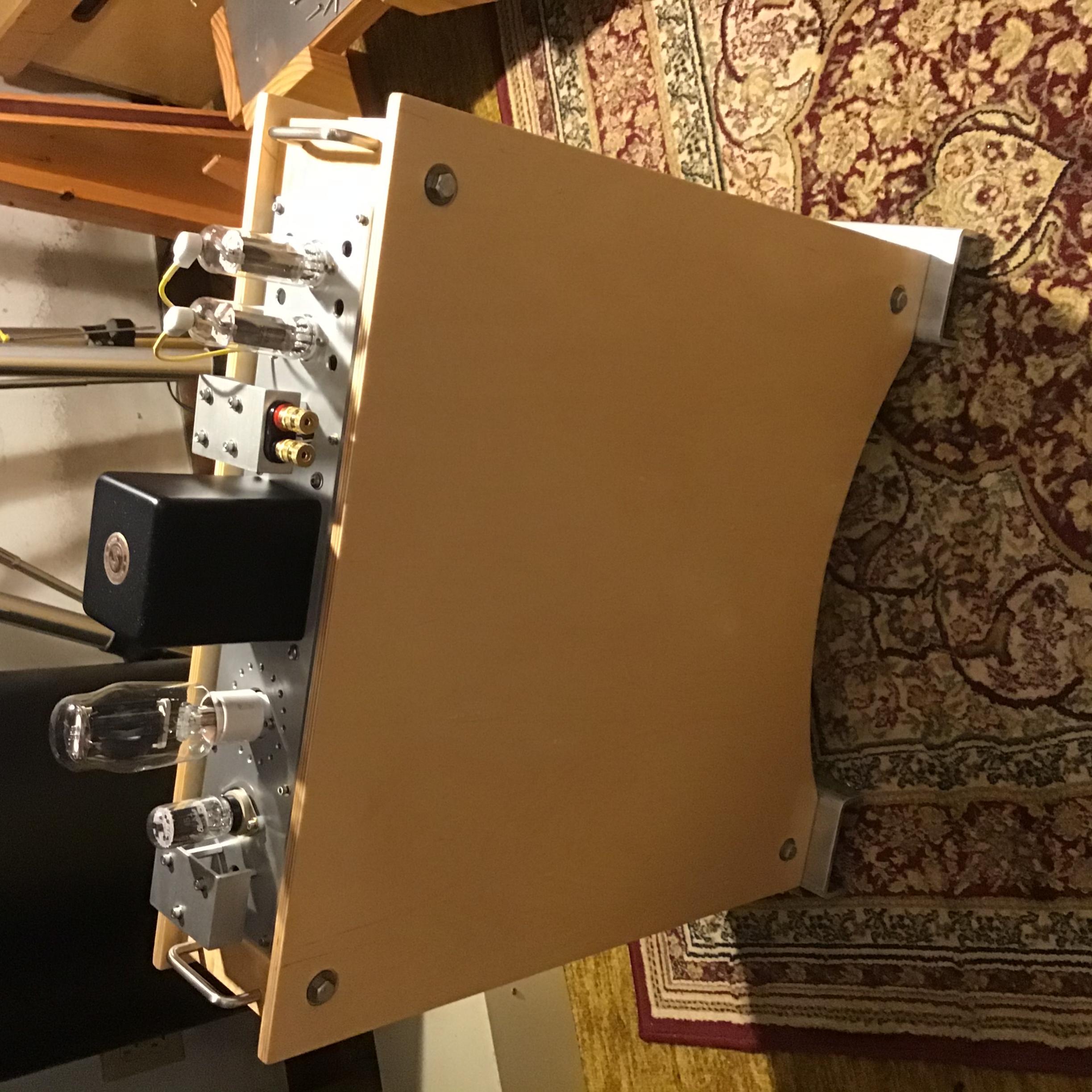

Space is an interesting topic. I’ve chosen to eliminate the space a table/rack takes up. The inside pair are umbilical joined, the outer pair are mono blocks. There’s room for more 🙂
These chassis’s present around 550 square inches by 4 or 5 inches deep and I use it all. Lots of iron in my favored designs :) Short signal path up top but the power supply is spread out some. I live away from the city so FM/ radio is no big deal. Amps are quiet.
