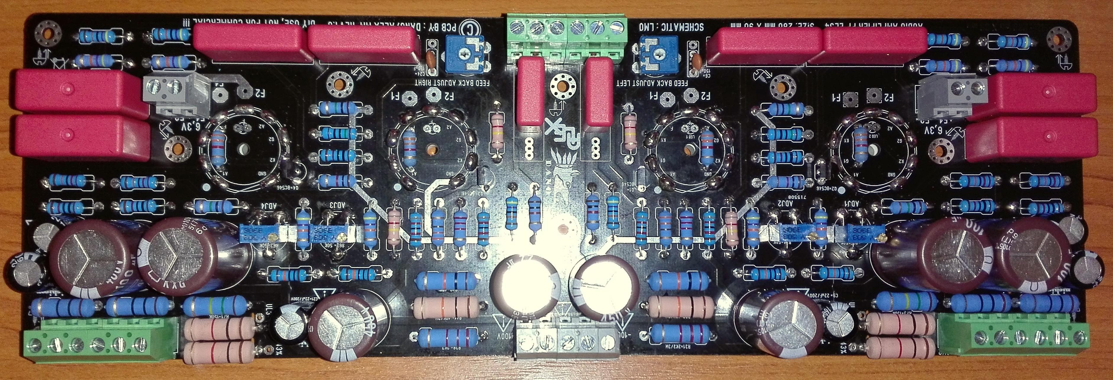

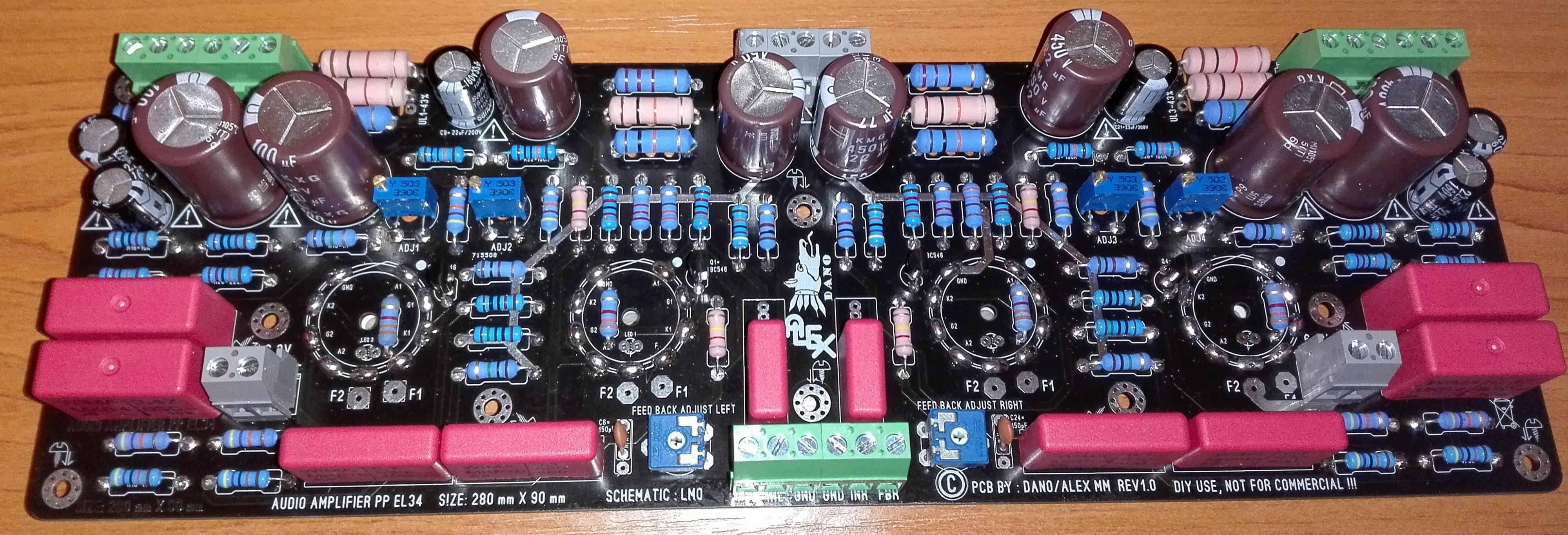

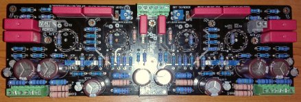

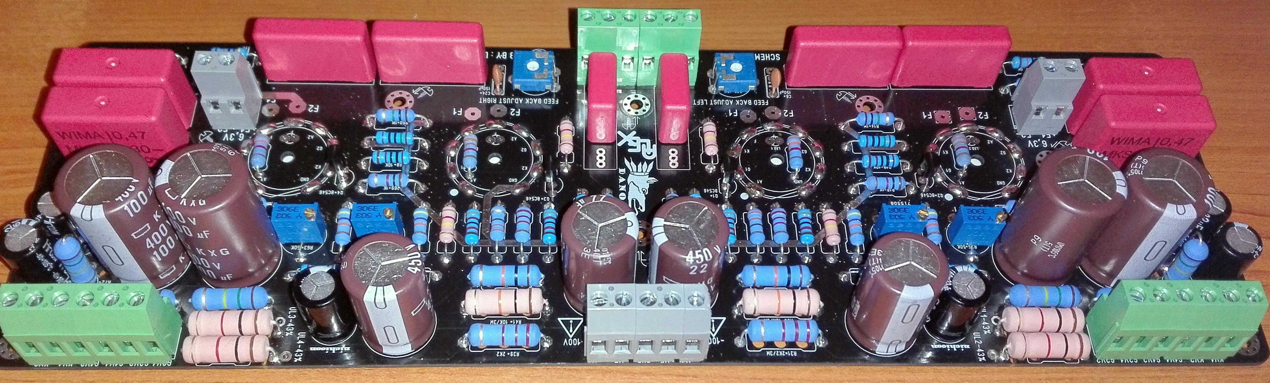

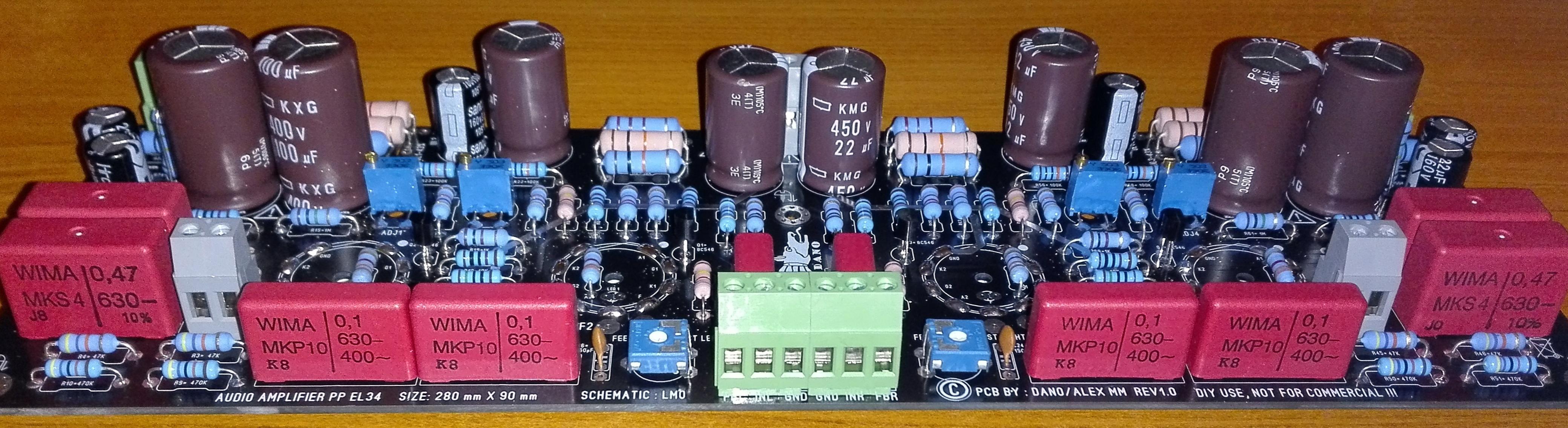

My present project, 845 PP.
At first some tests with output tubes only, driven by interstage transformer and audio generator.
Now with a Williamson style driver board. Not so easy to get +Ub (~720 V) for the tests.

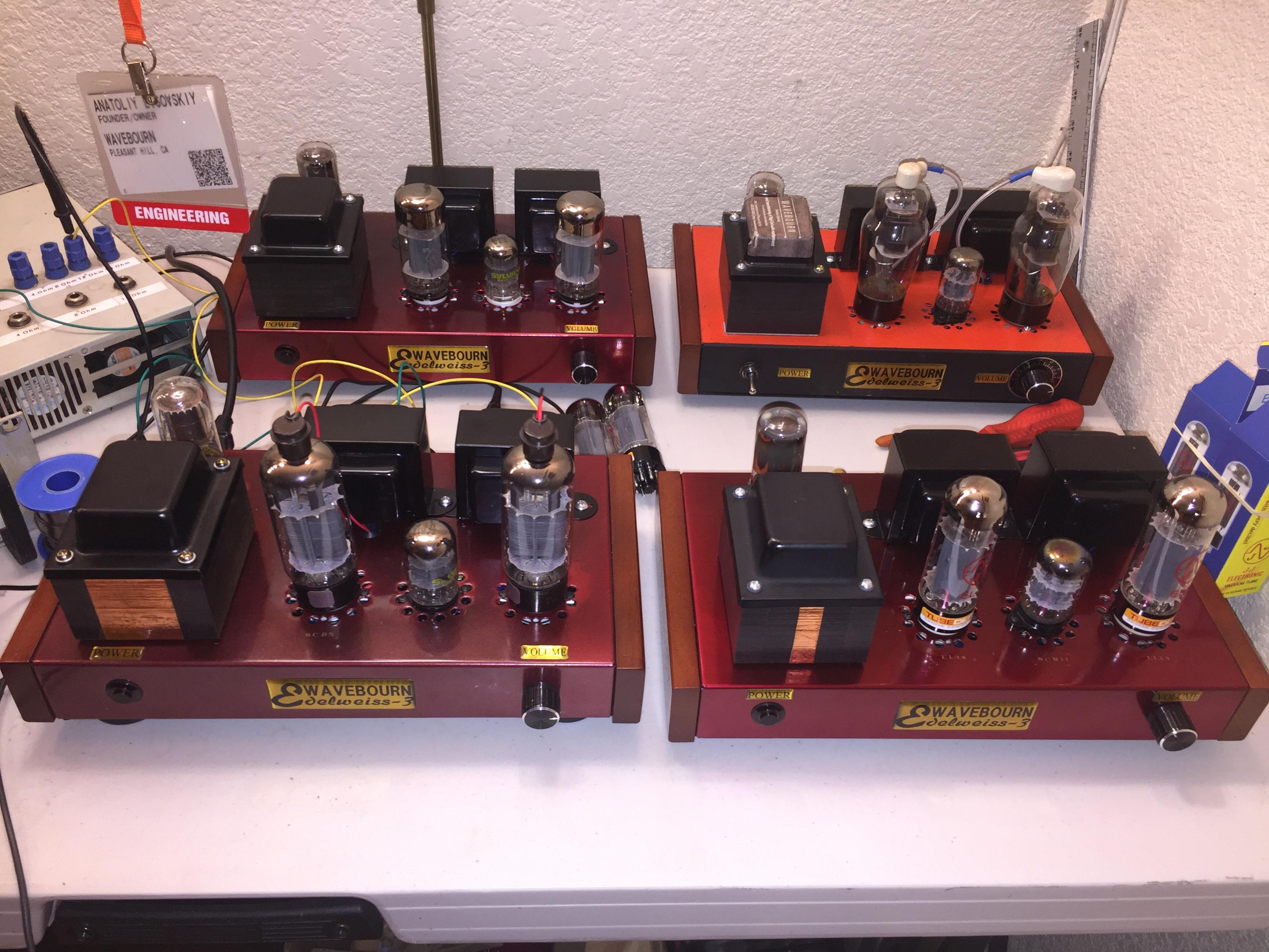

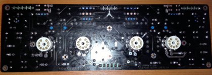

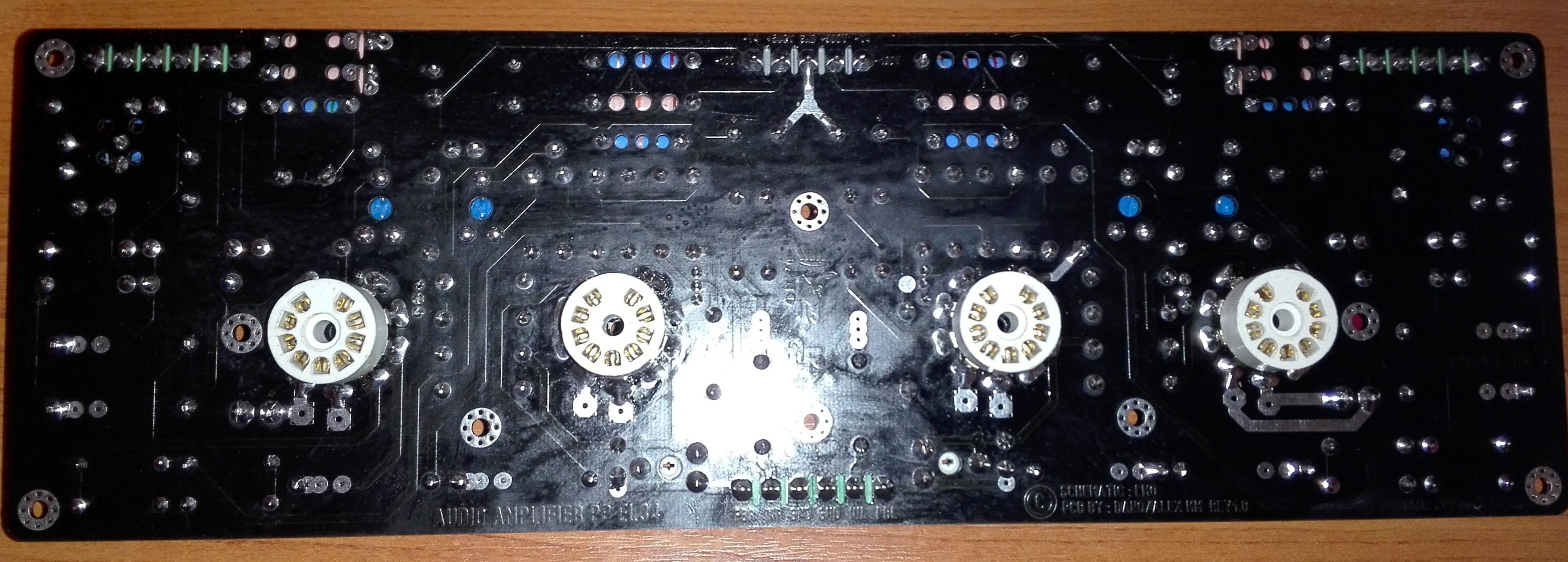

Finished prototyping, crossing fingers...
Input: 0 dB (0.775V) RCA, 50K stereo
Outputs: low ohm for 4-6 Ohm and high ohm, for 8-12 Ohm load.
Power: minimum 6W for <1% total harmonic distortions.
Soft asymmetric clipping, negative output resistance for damping of woofers.
Bandwidth: 10 Hz-90 KHz -3 dB, from 20 Hz full power.
Available versions with different output tubes:
EL34
5881/6П3С-Е
Raytheon VT127
4П10С
EL34
5881/6П3С-Е
Raytheon VT127
4П10С
