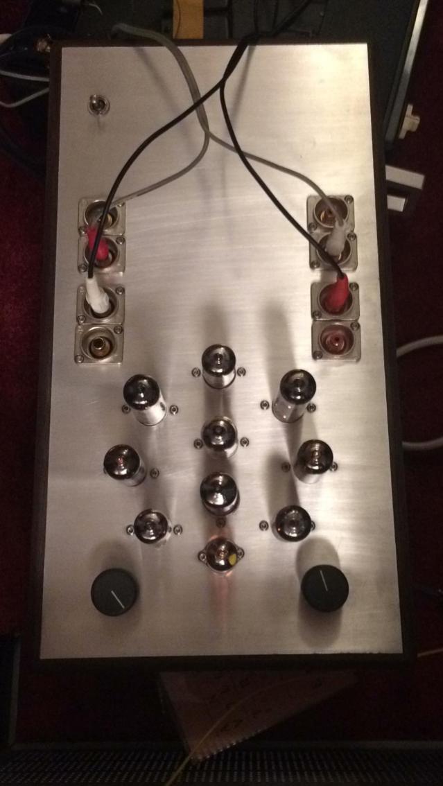

Broskie Aikido in DIY chassis. I plan to get larger silver knobs and have a proper front panel made eventually. This sounds much better than the 100K passive volume box I was using before. But I have too much gain so really only the first five positions of the stepped attenuator are useful right now.
I'm a little embarrassed by the off-center holes in the front panel. I used a Uni-bit and it wandered while drilling. Need a better solution.

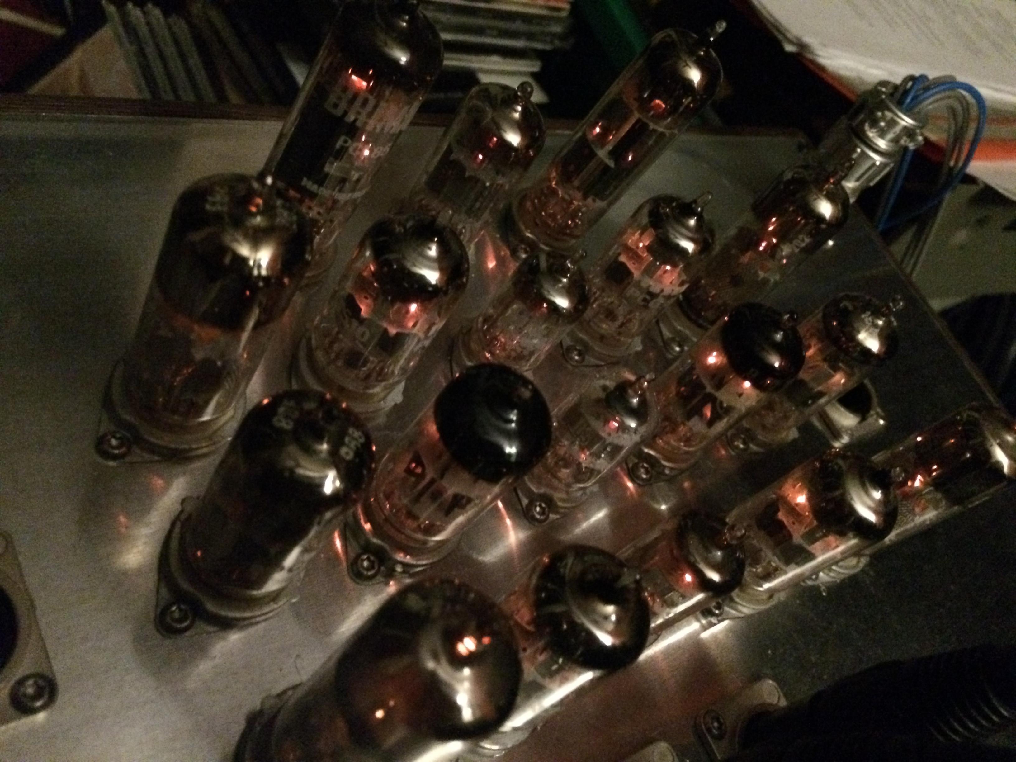

Congrats for the quality work ! I have the exact same project in my queue, albeit with the octal board, as I have loads of octal tubes. Three questions:
  • how did you attach the hex spacers of the LED board to the front panel ?
  • how do you assemble the edges of the case ?
  • with all dissipators and 4 tubes, is the heat evacuation ok ?

Thanks very much. Here are some more pictures.
As you can see there is a front sub-panel where most of the fastener action happens. The decorative front panel is just attached by the four flat-head socket screws.
Everything but the center divider is held together by flat-head screws tapped into the 3/8" square stock. I also tapped threads (x8) in the ends of the bars attached to the front and rear panels. There are screws going through the side panels into those holes to secure the sides to the front/rear.
The whole thing runs pretty cool. I would prefer to put slots in the bottom panel but I have no good technology for making them. Same issue for the top panel so right now I'm just running it open. The circuit is pretty we'll protected in my rack so the only real downside is dust buildup.
Nice lead dress, nice and clean assembly!
I feel you on those unibits- I like them for getting a hole close and then opening it up with a dremel, files, or similar. I find that miniature holesaws work well but they are a pain in the **** to use. I think the hole punches are the best but expensive investment... I do build enough amplifiers and gear to justify the expense, but that doesn't make them any cheaper 🙂
Thanks.
I tried a test with a 1.5" hole saw. It needed persuasion to go deeper than the depth of the teeth. The saw stayed centered but the hole didn't turn out very clean, and that's after some hand sanding.
I don't think a Greenlee punch would go through 1/4" metal. Not without a hydraulic press, anyway.
I'll think of a solution eventually. No rush.
