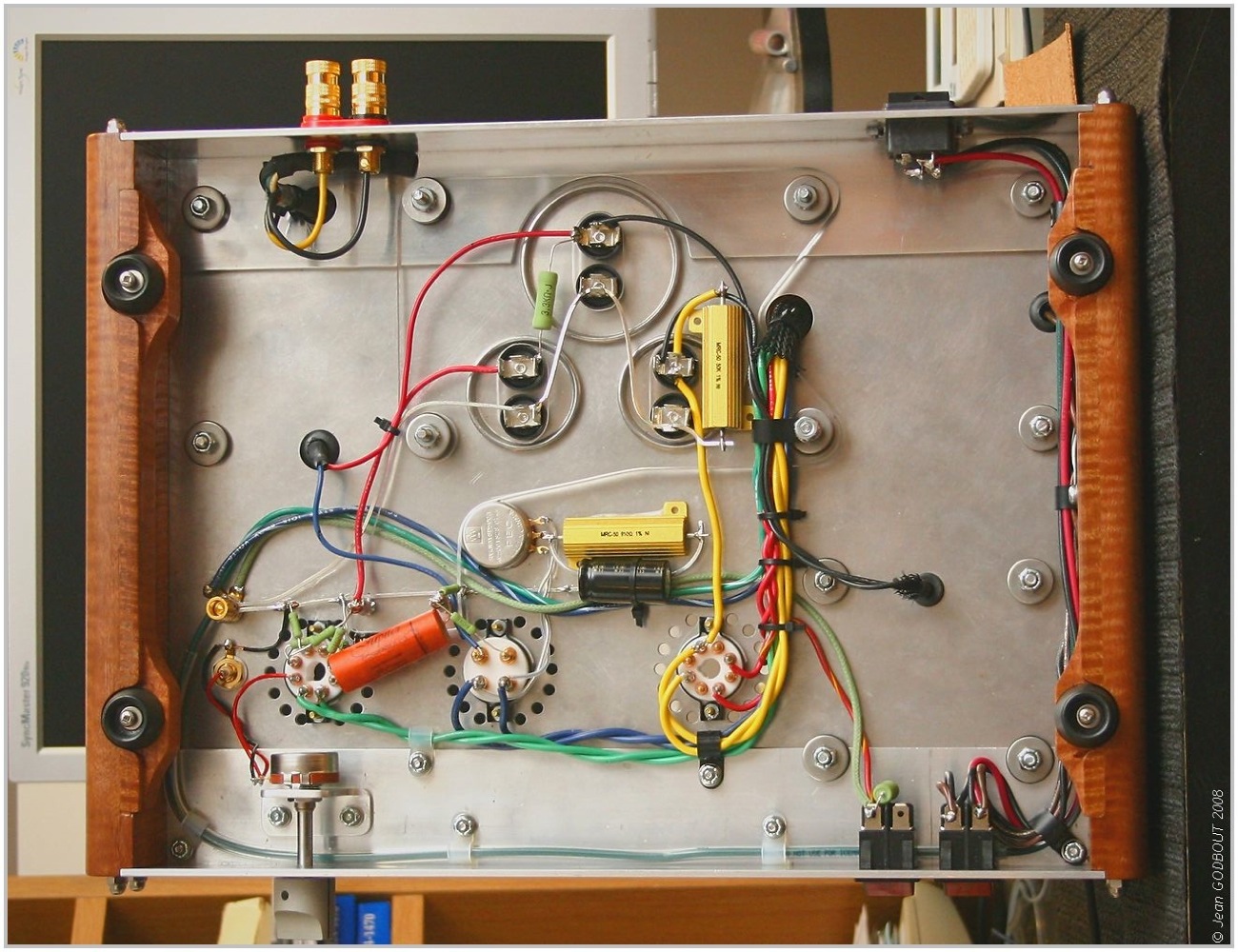

Yes, it's mine ! Since I build them few years ago I had some little unwanted ''hum/noise'' coming from the amps, then two weeks ago I decided to cure the problem thinking that the wood covers that replace the original metal covers where responsible for a lack of shield but it's not the case. As we can see, the transformers sit on rubber feet isolating the transformers from the ground, so I just cure the problem by adding a ground on each transformer and now the amps are completely ''silent'' from unwanted ''hum/noise'' !
