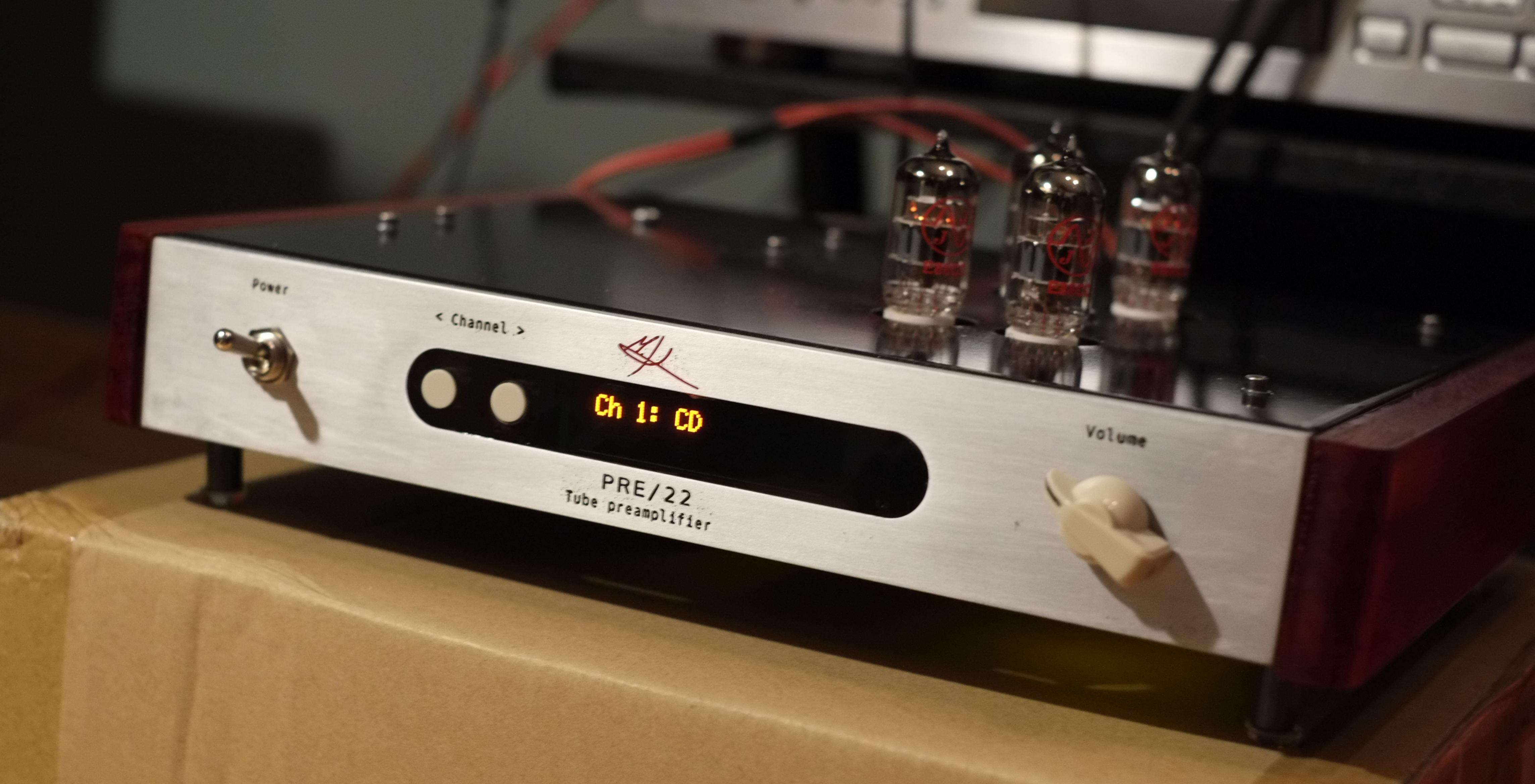

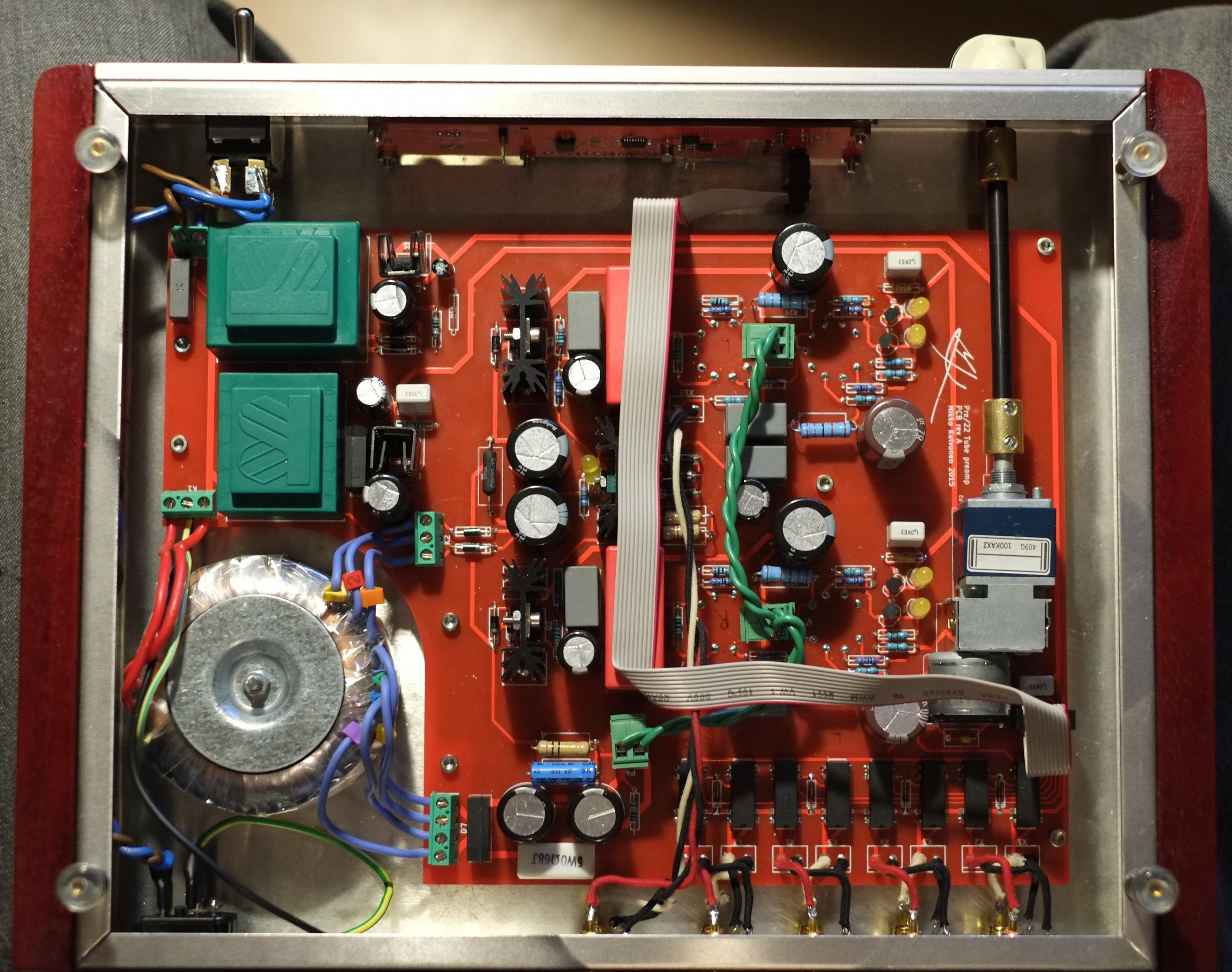

Preamp with tube regulated power supply, baxandall tone controls and 40Hz 18db/oct tube subwoofer crossover.

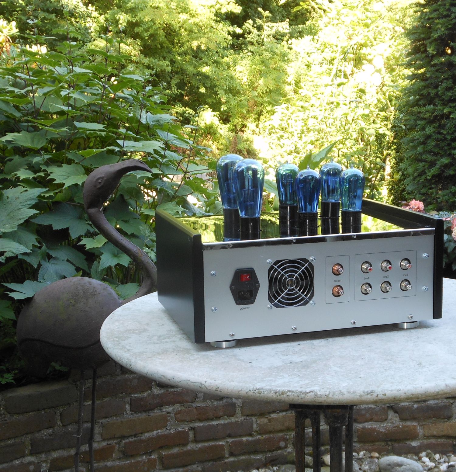

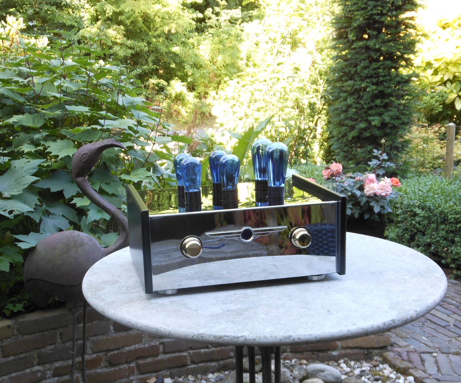

2ch pushpull power amp.
ub+ 500V ~80W/ch
Monoblock plays subwoofers.
Parallel push pull, 6x KT88 ub+ 520Vdc
ub+ 500V ~80W/ch
Very nice!
Thanks. Here are a couple more pictures of the preamp. The markings on the fascia are etched with the saline sulfate method. This etch didn't turn out quite perfect, I slightly overetched it, but it's good enough. The etchings on the poweramp turned out better. Still some practice needed to really master the method.
Adolf,
I would like teh volume knob to be more modern and minimalistic. The vintage one spoils the excellent design.
Adolf,
Can't do that. Chicken heads are my personal signature. For better or for worse. And I like their feel. But rest assured, you're not alone with your criticism.
It looks good. I advise you to turn off the fan. my opinion it gives vibration. it can adversely affect the sound. I do not think that without it will overheat
The end justifies the means. I do not think that there is a strong heat. tube modulator is not a radio station. the picture of retro lamps with low power consumption. and fan and lamp things are not compatible
Everybody's a critic ;-) I get their criticisms. I don't think though you are trying to fool anyone. It's a modern-day piece using vintage glass; it's your take.
I hope it sounds wonderful!
If You don't hear a difference with fans on or off, use them to make things cooler and last longer.
Cheers!
Cheers!
Who can say anything?
Who can establish styles?
These are our things. I like very much blue valves with fan behind.
You can ask something of your curiosity but not criticized any.
I do not know English. I use a translator .A he roughly translated. I do not critique suggests. . I just expressed my opinion ..u I had a negative experience with the fans.It was heard in acoustics. in this forum, you can express your opinion ?. and to take it or not is a personal matter. because you have democracy?I liked the design. I wrote about this in the message №6708. good luck
What tubes are you using? 27's and/or 56's? Nice looking preamp!
I didn't know they made a blue glass rectifier.
Arcturus 27's and 80's as rectifiers. All in all pretty standard.

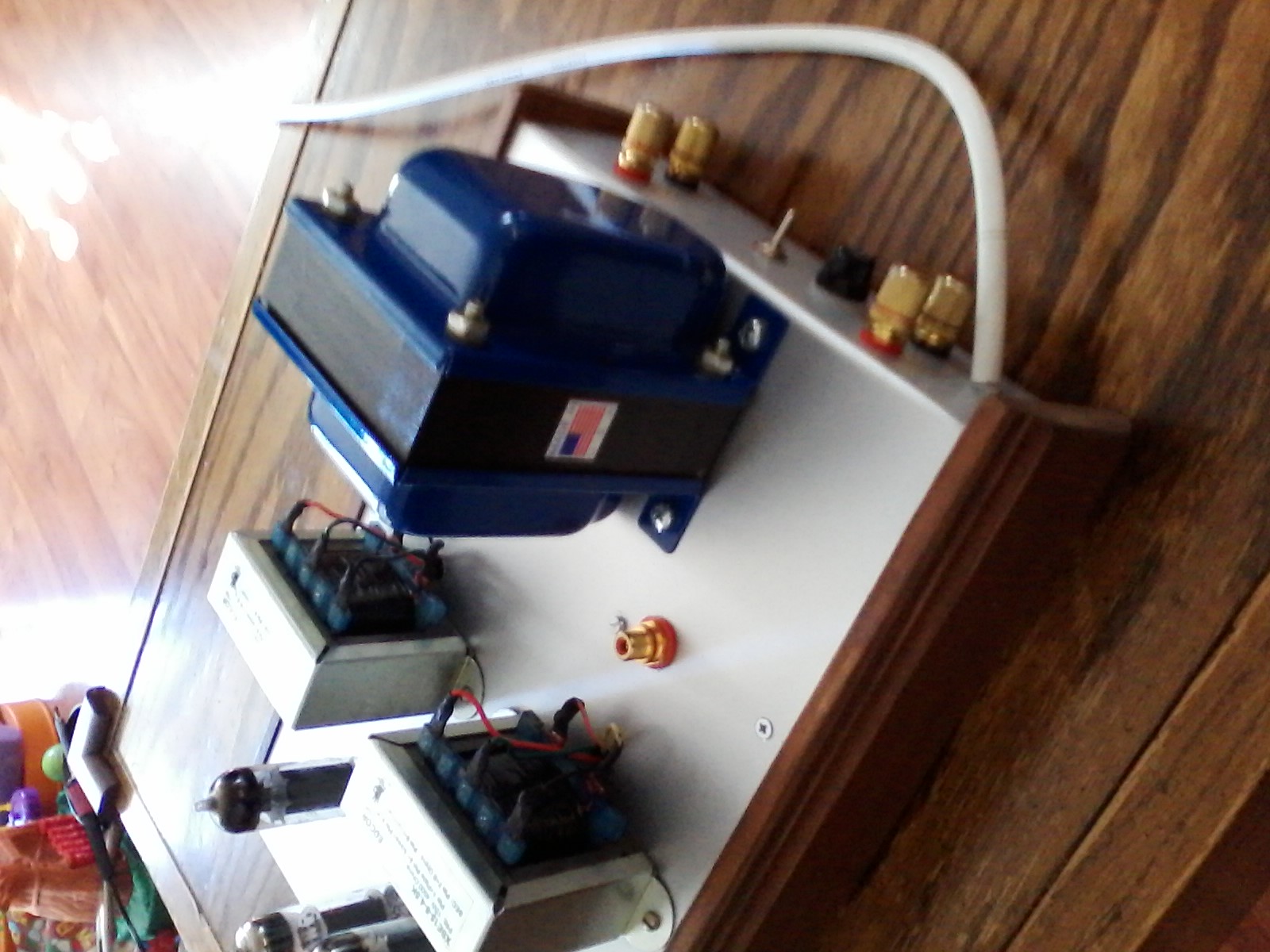

My UL SE EL84 FUNKWERK Germany and pre E80CC TUNGSRAM, built in San Diego. OTs and PT are from EDCOR USA. Outpower is about 2 x 4 W for 8 ohm. /Sorry for turned and bad photos from my cellphone.....I can't manage with it and my tablet/. Amp can be for sale...for about part's price...if someone interest.
