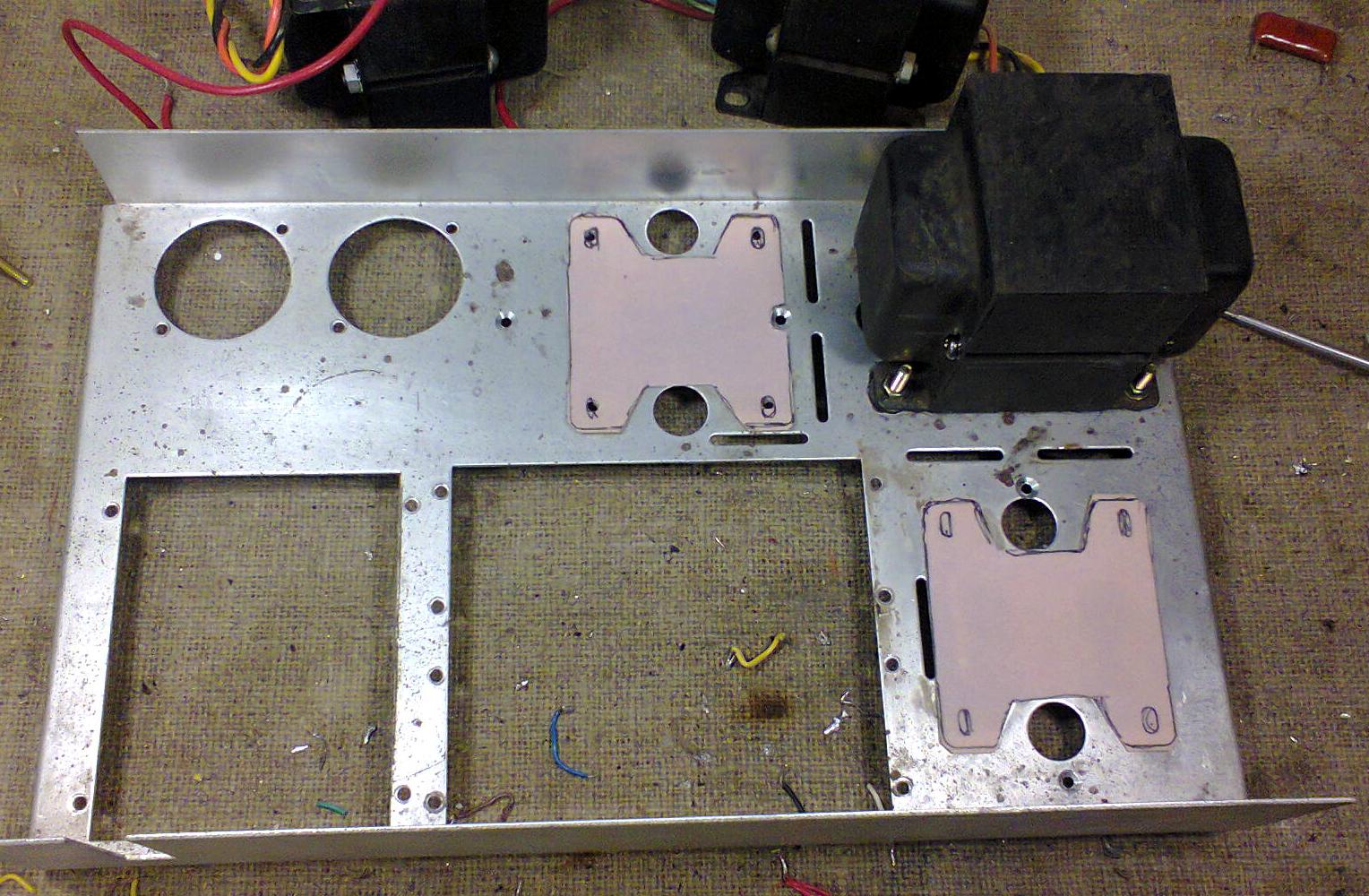

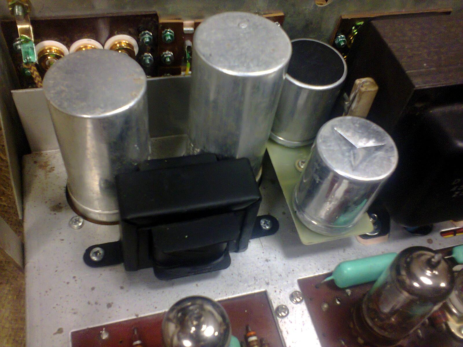

Repair and restoration of the old amplifier Dynaco SCA-35.
Here's what happened.
The amplifier sounds great, completely missing the background.
Power got a new life.

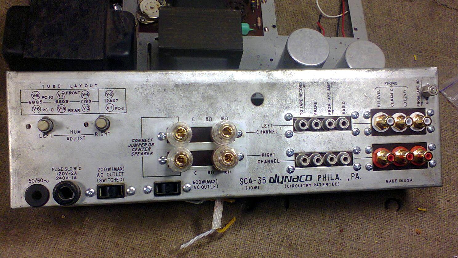

Not too surprised, the SCA-35 was highly regarded. If fact, some Audiophiles actually thought the "35" was perhaps the the best sounding Dynaco Amplifier, at least within it's design limitations!

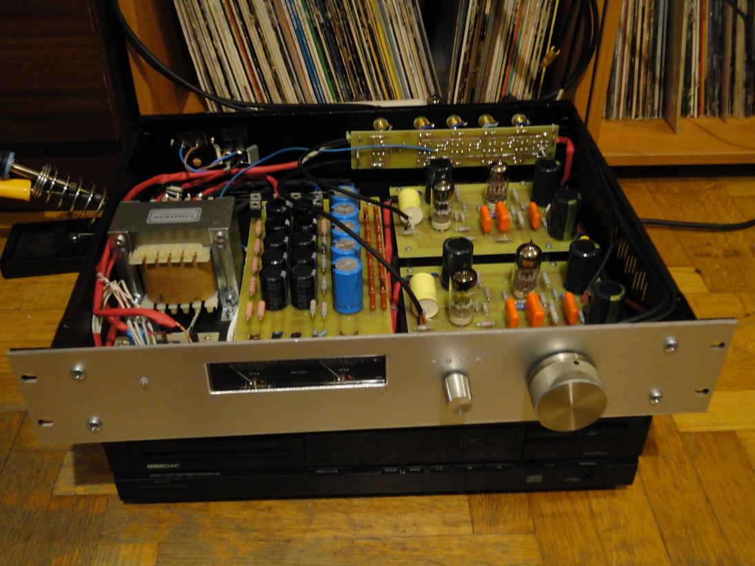

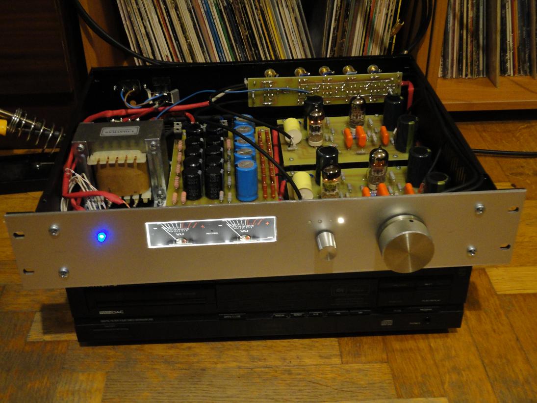

Hi to all ! this is my new tube line preamp , one ECC83 and one PCC85 in each channel , the circuit is not complicated , ECC83 LTP input stage followed by the PCC85 in SRPP configuration , I use about 20dB of negative feedback , the result is a wide and clear sounding preamp ! , -3dB @ 380KHz , Zout =700ohm .

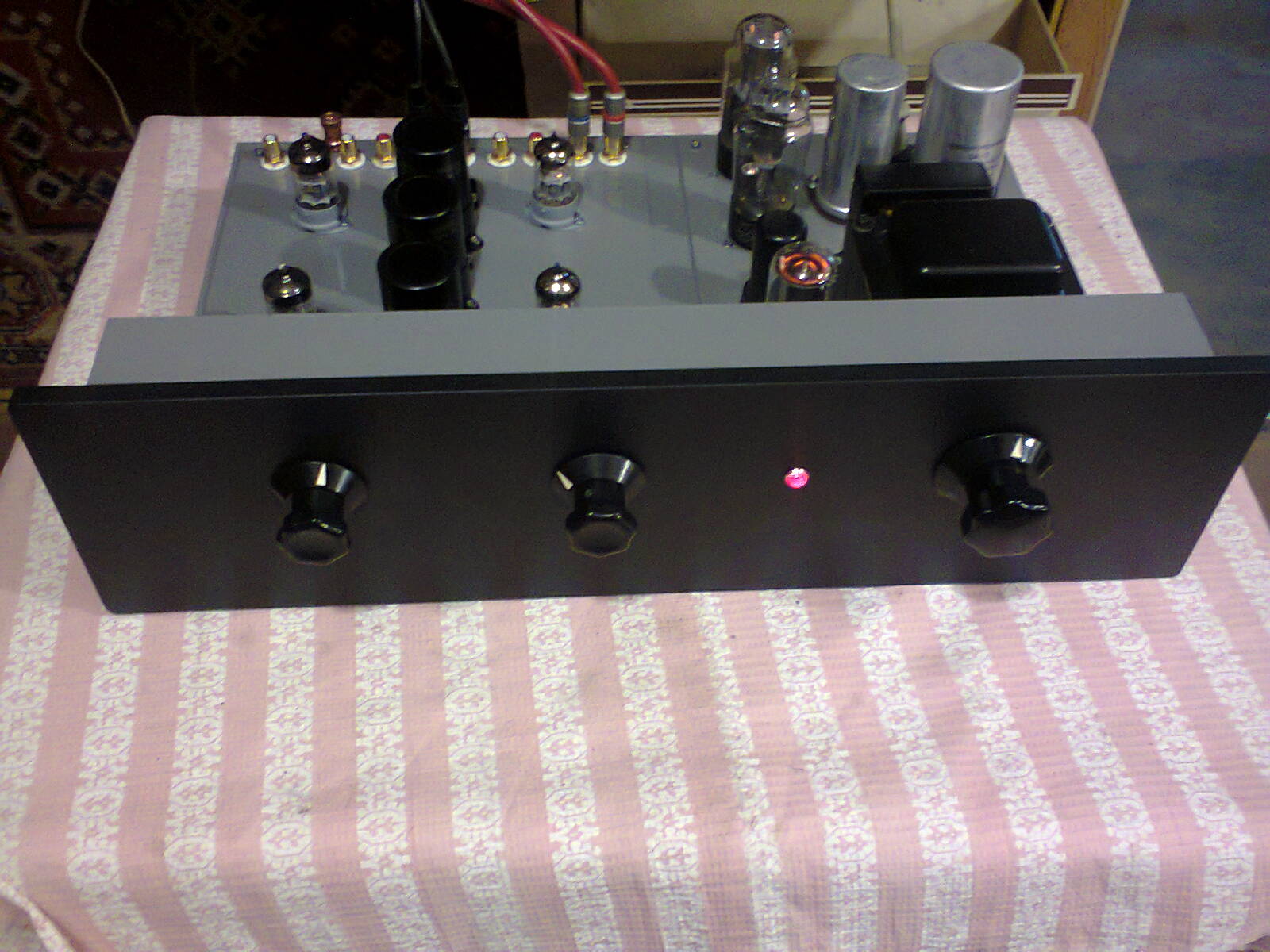

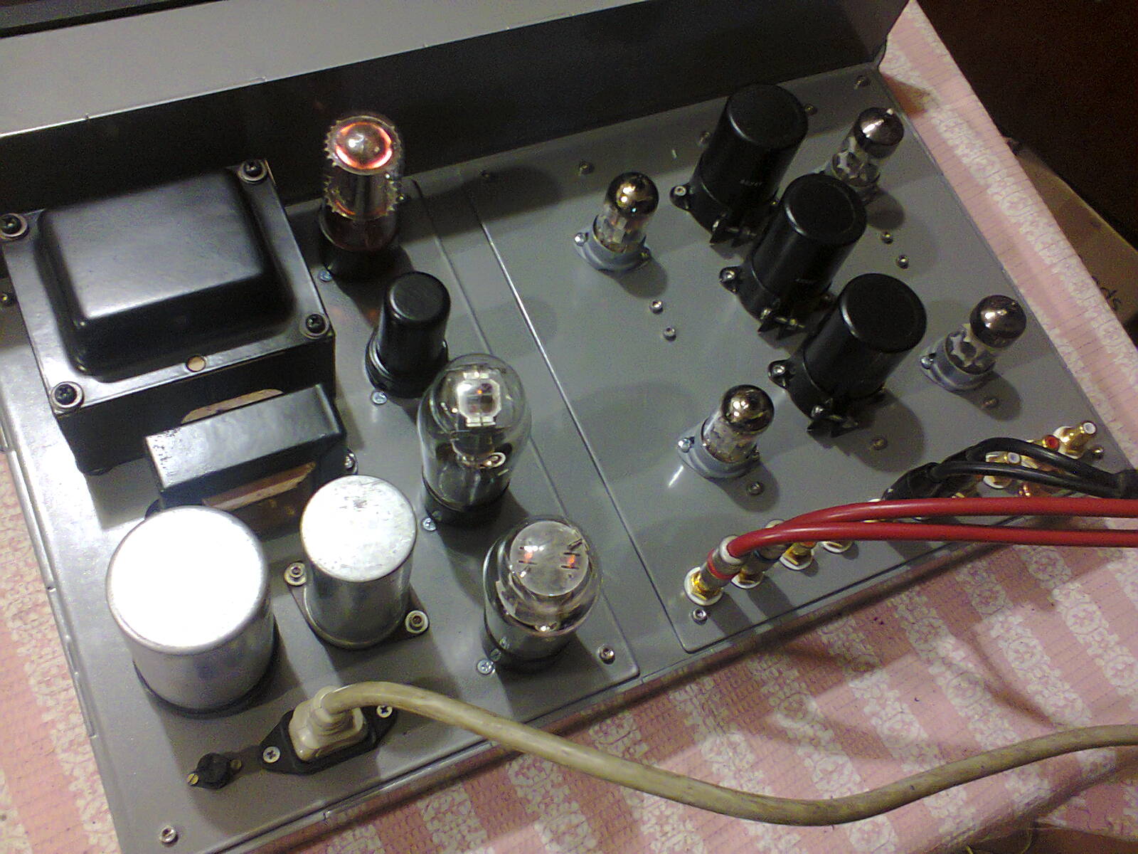

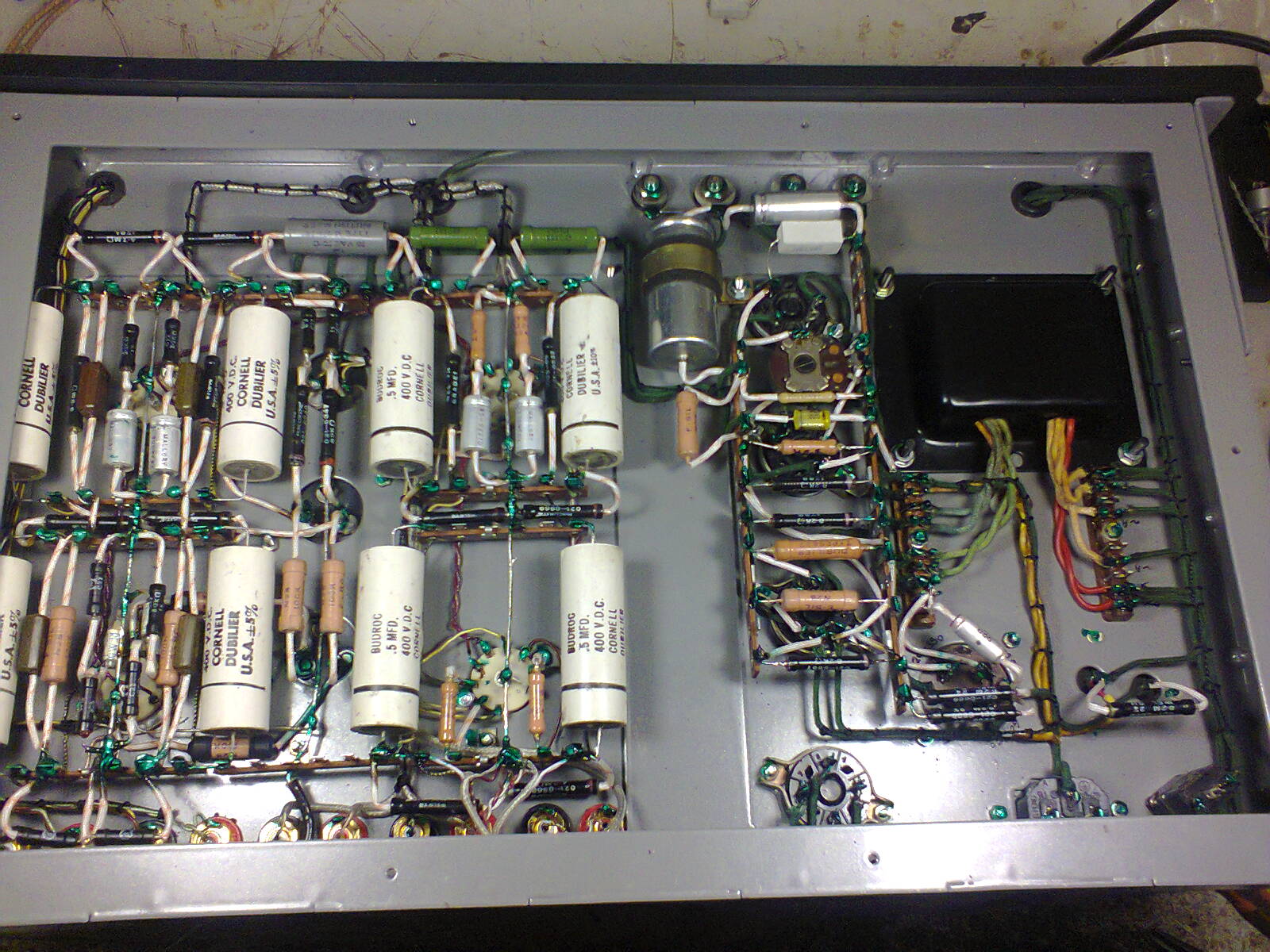

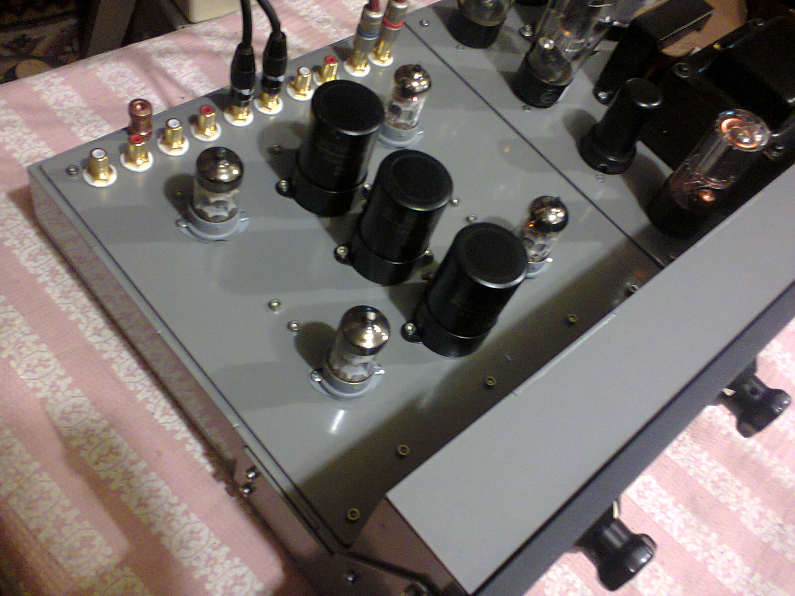

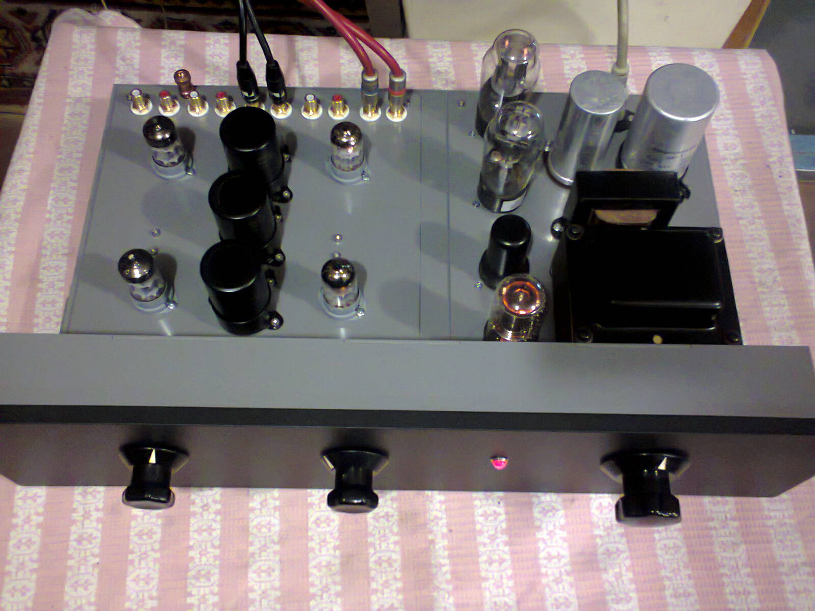

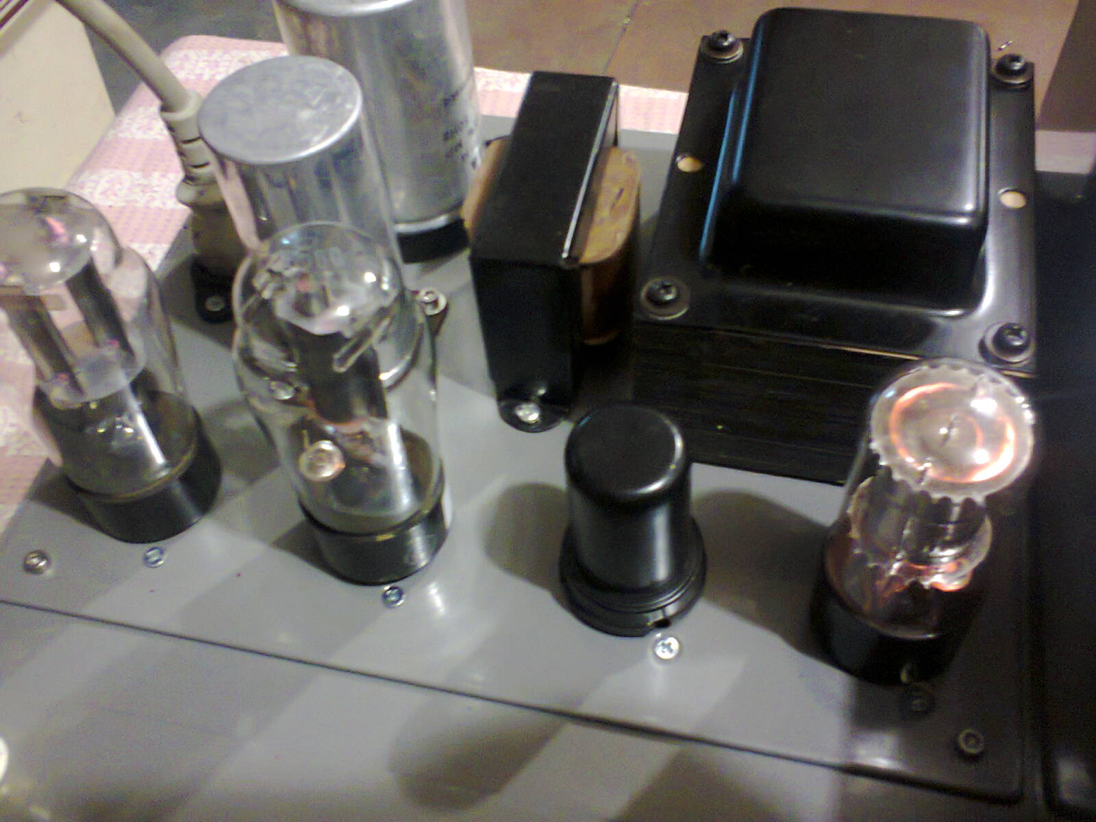

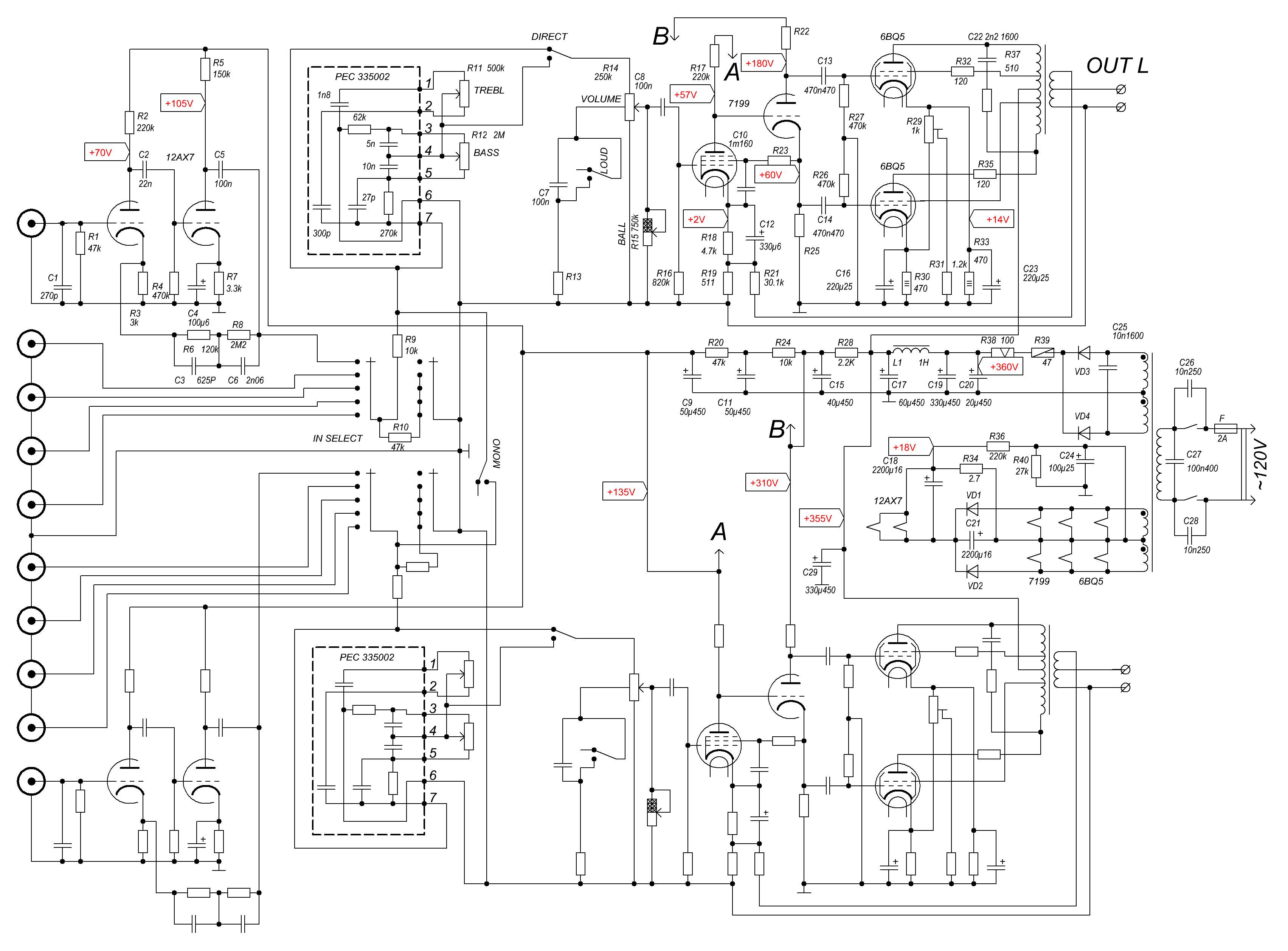

This is my last work.
This is the initial amplifier.
MM has two entrances and two universal inputs.
Exit 1B.
Power anodes - a vacuum regulator.
Retention rate + - 1%, the level of -70 dB background.
Heating tubes strengthen -germanievye semiconductors and current stabilizer.
Driving classic MM equalizer 12AX7 tube (6N2P)
Tubes linear part ECC88 (6N23P)
Tubes powerful part 5Ц4С 6Ф6С СГ3С 6Г2
Resistors: Welwin, capacitors CDE Budrok.
The high-power capacitors Tesla oil, and Black Gate Rubycon.
Overload level Linear + 20dB, the background level of -70 dB line.
The background level equalizer - 50dB.
The same wire used Siemens and the old RCA. Tranformator old Dinako.
Drossel Telefunken.
Chassis laser cutting, aluminum, argon welding.

Very very nice ..pre amplifier, I suppose. This front plate is thick aluminium? You say you 've used germaniun semiconductors, but where? heater rectifiers? What is for this lone bronze binding post, leftside behind the RCA sockets?
Dimitris, another style, but also elegant. Superb craftmanship. Envy.
Looks like WWII production. Very good work. The point to point under connection looks a Sherman tank construction. The chassis system is a good finding,
Congratulations
Congratulations
Yes, 12mm aluminum front panel.
Rectifier diode heating very old Soviet Д303 germanium.
Very well done . Mil-spec it is . Now some label on the chassis for the tube and the control knob would make it look like a factory production unit , Bravo well done.
Nice done Dimitris, I'm interesting in how you connect VU meter circuit? I want to do with my VU too.
