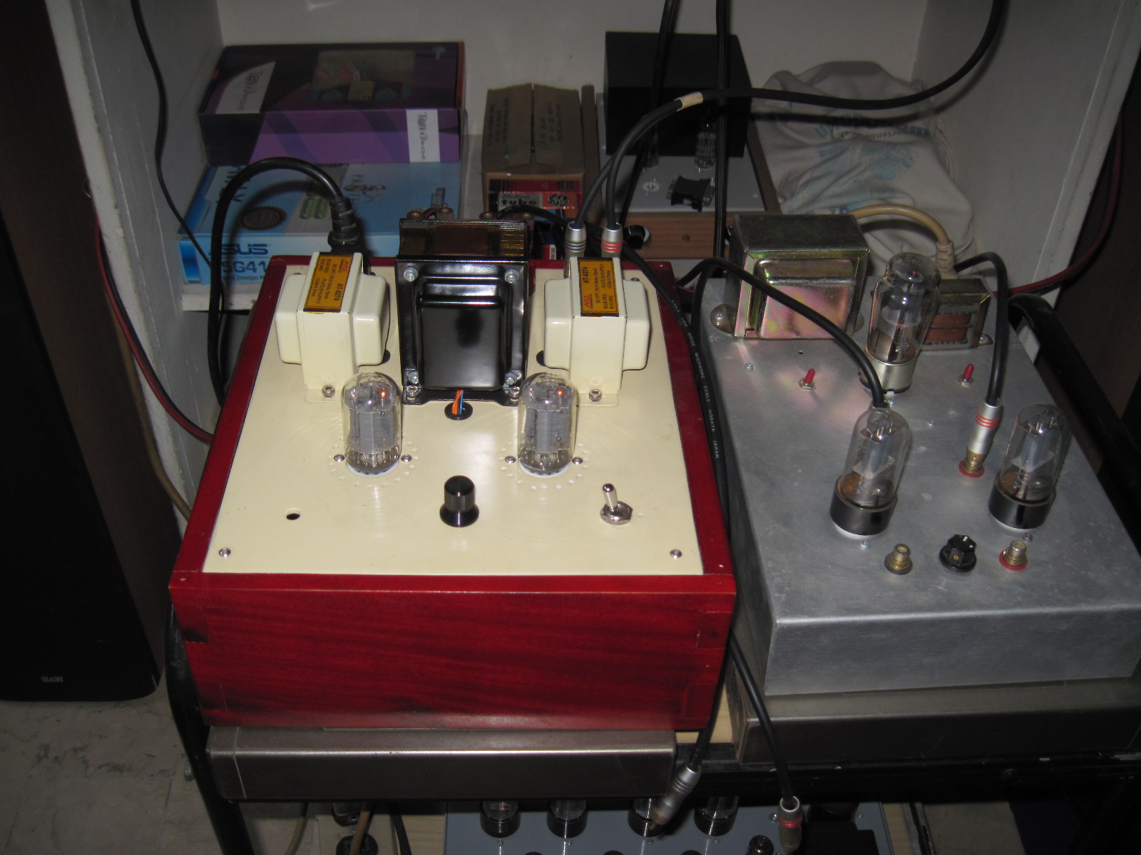

Hi Phil,
Thank you,
this amp is Single Ended, I made this power by looking at the pages of Jim De kort. "VT52".
Driver VT25 (replace 71A) and final RS241.
Tube Rectifier : RGN 4004.
regards

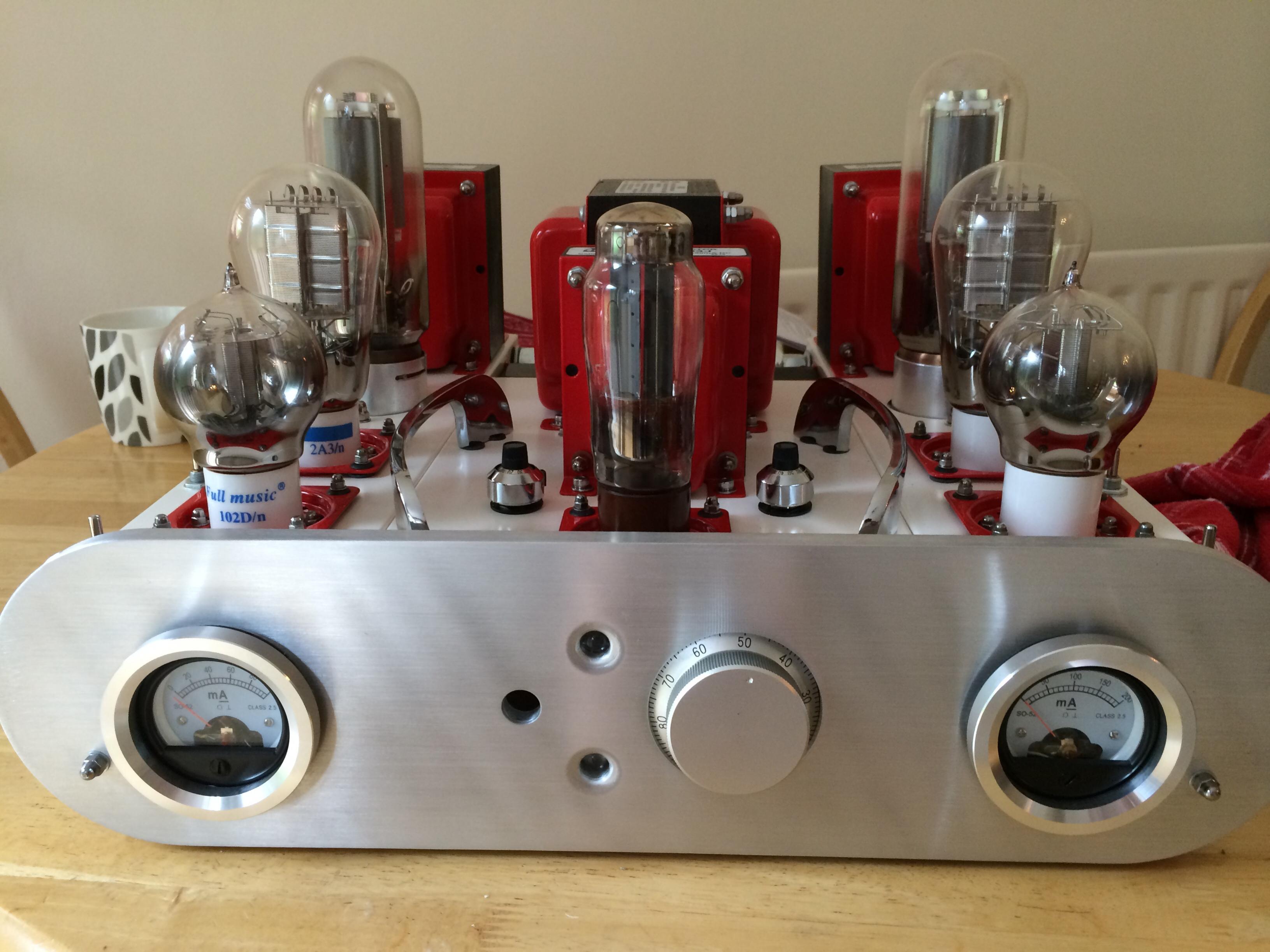

All DHT 845 SE
An experimental all DHT SE amplifier. It uses the 102d (modern) as input, the 2a3 as interstage coupled driver for the low powered 845 on fixed bias. Still working on it and will be tweaking the OP of the 102d. Still needs a mains switch to be fitted! The two LEDs at the front of the panel are for bias failure just in case...
Special thanks to Kevinkr whose help and input got this project going. Also to Andy Evans whose work and ideas got me on the path to this experiment. Thanks again guys. Now for debugging and tuning...
Looks good. I have a bunch of 6T9s. I may just have to make another amp.single ended pentode...
Gorgeous.
Wow! That's wonderful! Brilliant!
Do you need a pallet lift to move it? 😀
Ditto that! Very nice, very unique, very, very ...
No, just my wife😀. It's heavy for sure!
Thanks guys for the kind comments. Here it is on first testing:
http://m.youtube.com/watch?v=E663-r5D1Fo&feature=em-upload_owner
Still need to work on it to get it dialled in... Sorry for the quality of the vid. It was a quick shot from the IPad just to show my uncle I got it working. 😱
