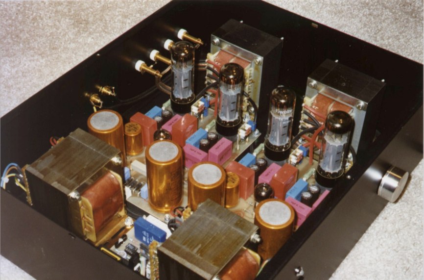

Originally posted by GG
Attached are a couple shots of my latest amp. It is a single ended 50EH5 pentode. You can visit my website for more info.
I do have to get at my Mark II version with the bigger OPTs.

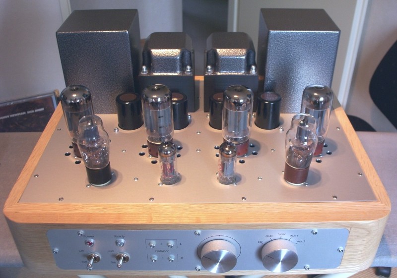

Well, here's a few pictures of my latest project.
It's a 6L6GC ULPP amp now, but will replace those with KT88's when they are worn-out. I use a single 6J5G triode at the input coupled to a longtail ECC99 as phase-splitter. The PP stage is UL and kathode biased. My dad was so kind to make me the nice oak-wood chassis 🙂

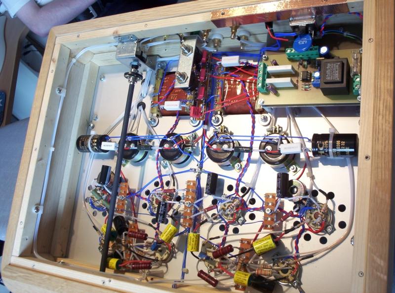

Very good looking job Ray! What is the pcb thingy you've got in there...a power on relay circuit?

Looks like on your new amp you have the output transformers oriented differently with respect to each other?

Hi Bas,
Indeed, it's a delay for the +B voltage, since i'm using SS recitifiers.

Bas Horneman said:Looks like on your new amp you have the output transformers oriented differently with respect to each other?
Yep, the PSU tranny's were projecting their field right through the tubes and OPT at first :-o Gave a bit of a hum at the output obviously.
I fixed it in the old amp too, i never made a new picture though.
I thought it would be a problem for the tranny's to be so close on my new amp, but it's quiet as a mouse.
