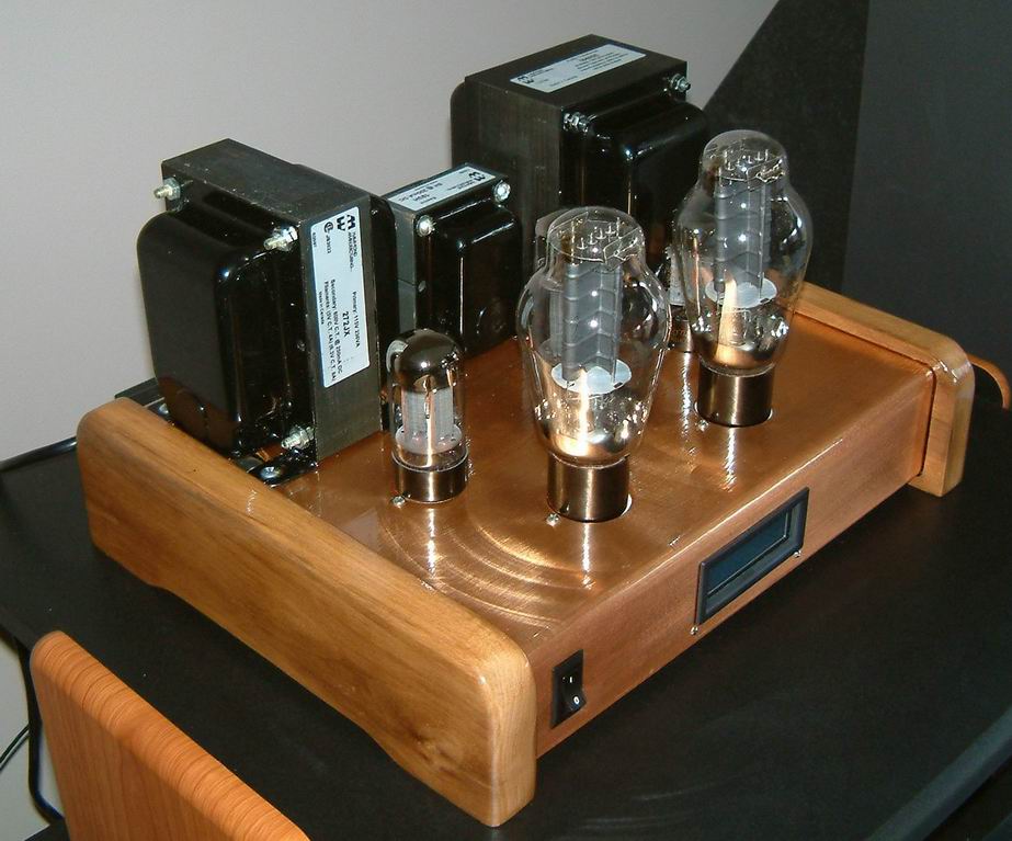

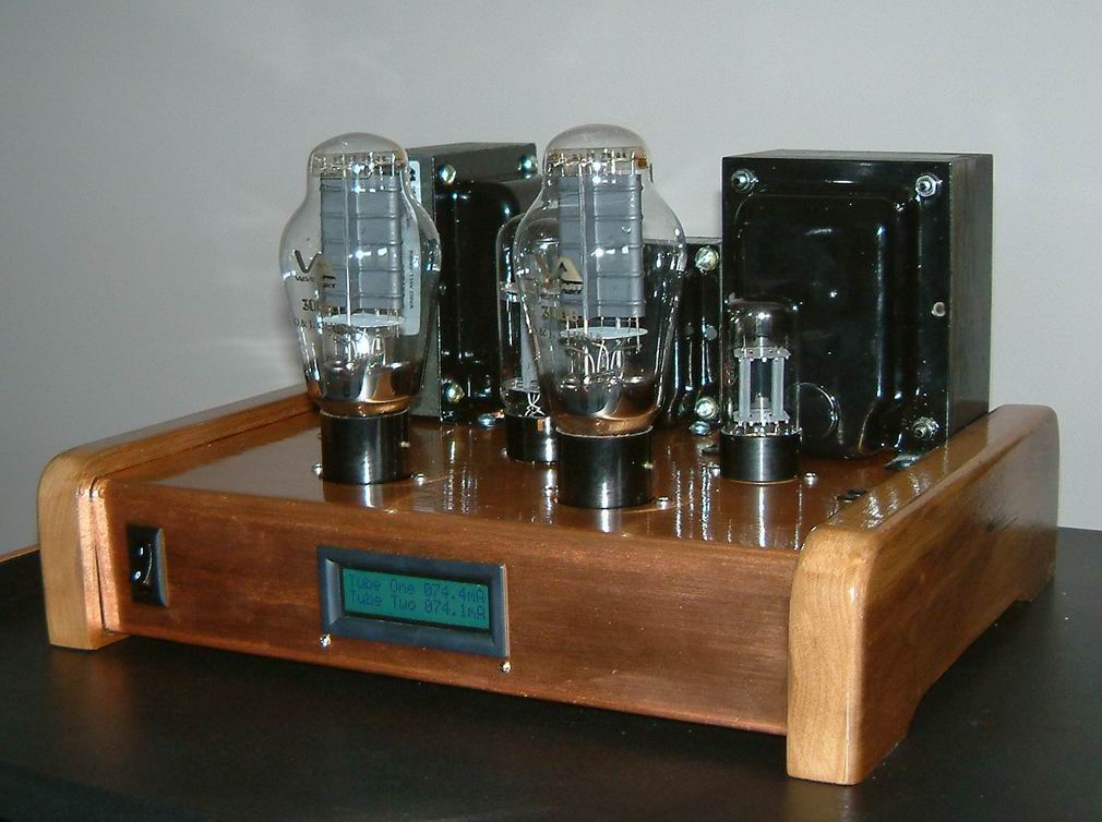

PSE 300B
My latest project. Done at last! Build a little ammeter with a pic 16c773 using the a/d converter and a couple of instrumentation op-amps. The little screen has a very cool blue backlight....hard to take a picture of! 6SN7(parallel connected)=>7027A=> 2x300B's
MelB said:Another pic.
Looks Good Mel. Is that a Hammnond 1600 series output transformer, a 274BX power, and a choke? Or is the Filament and Heater transformers seperated?
Regards
Anthony
Coulomb:
I used a Hammond 272JX for power and filiment. I use the 6.3v winding and run it through a LT1084 linear regulator to get the 5v for the 300B's and also pull the 6.3v as DC before the regulator for the other 2 tubes just using a dropping resistor. Silent as a mouse! You also see a Hammond 5H 200mA choke and a Hammond 1640 OPT. MelB

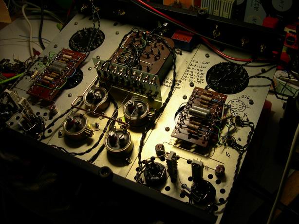

Very nice upskirt 845! It caused me a moment of disorientation, at first I thought I was looking into one of the grand old RCA transmitters from the classic era I had the pleasure of maintaining. (Yes, that's a compliment. They were amazing machines.)

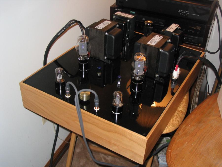

tenderland said:Here is my frist amp
Lovely.
Reagrds
Anthony
She's a looker. What design is it? What are the output tubes? They look familiar, but I can't ID them...they look Russian..and the driver tubes as well...what are they rusky varian of the 6SL7/6SN7?

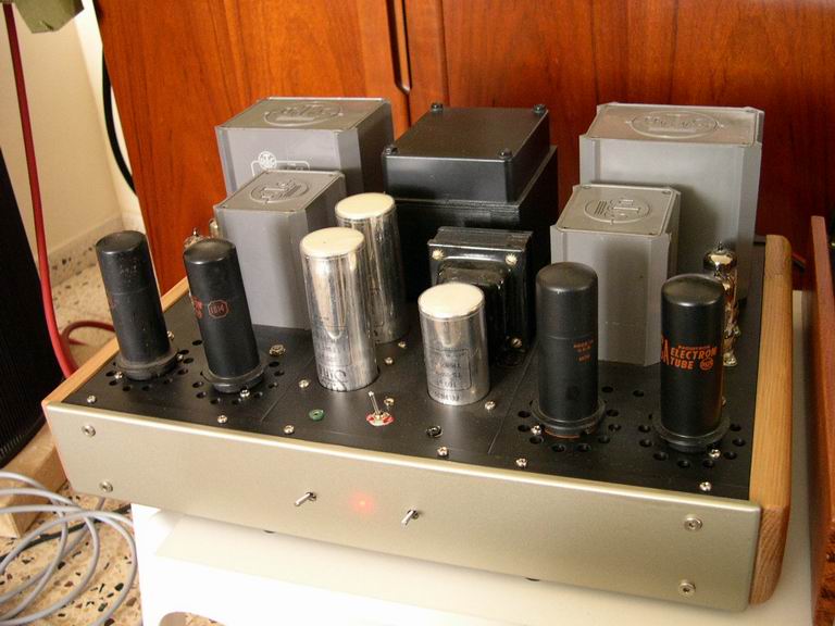

2A3 Amp finished!
i just finished my 2A3 SE Amp:
Greetings Barossi
Greetings Barossi
i bought the trannies from a guy called "sandy85272002" from Taiwan. Here's another pic:
Greetings Barossi
Greetings Barossi
Design
The design is the JE LABS 2A3 . the driver tubes are Sovtek 6sl7 and the output tubes are Sovtek 2A3.
very nice work Barossi
Jeff
Jeff
yes the design is the JE Labs 2A3 i use Sovtek 2A3 tubes, but i use different NOS (Sylvania, etc..) 6SL7 tubes...
Greetings Barossi
Greetings Barossi
