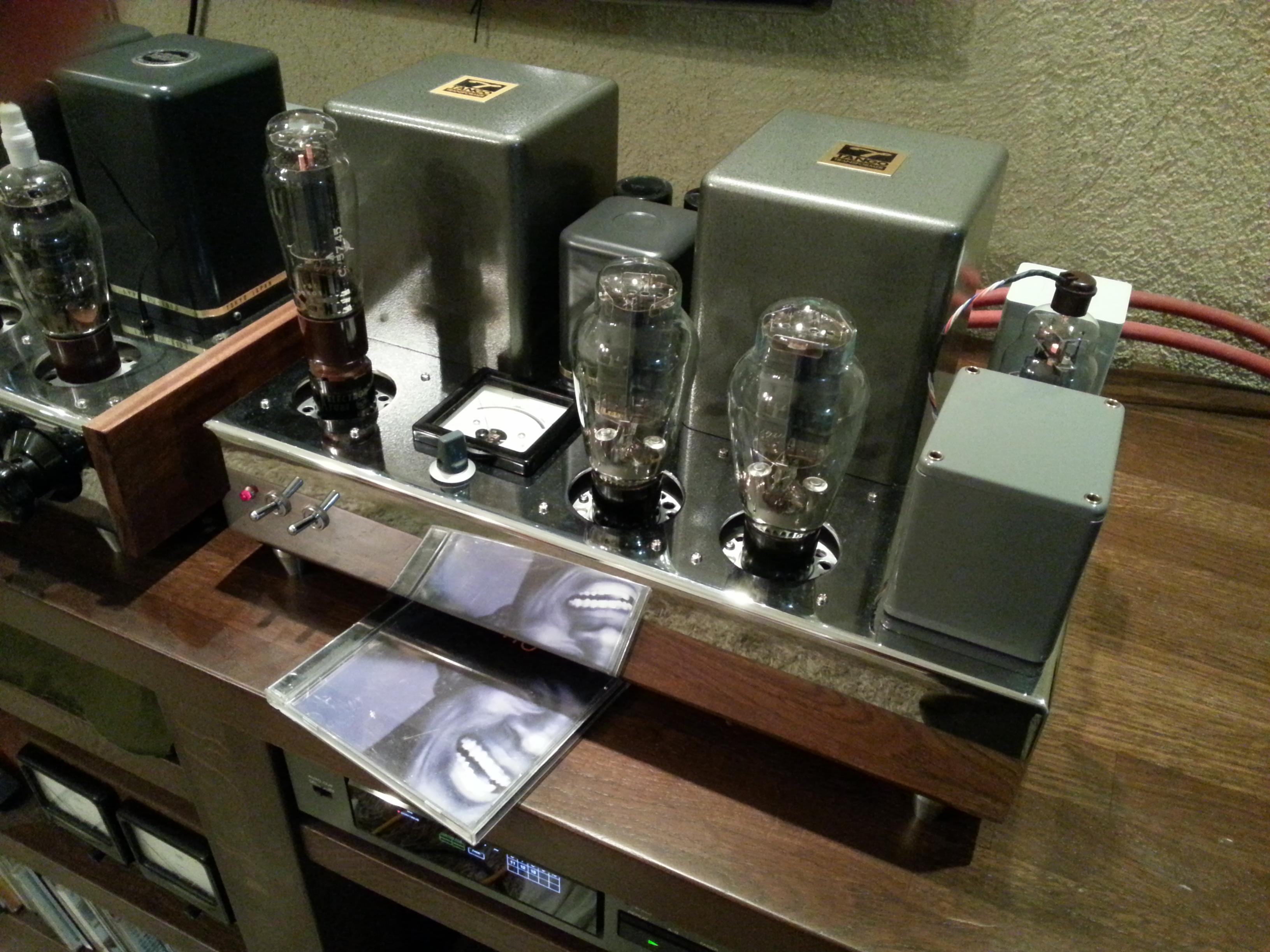

and the latest 6EM7 SE amp...
I like the coin based RCA best for their sound.
plain steel box.
rectifier is a 5U4GB.
and an oak volume knob.

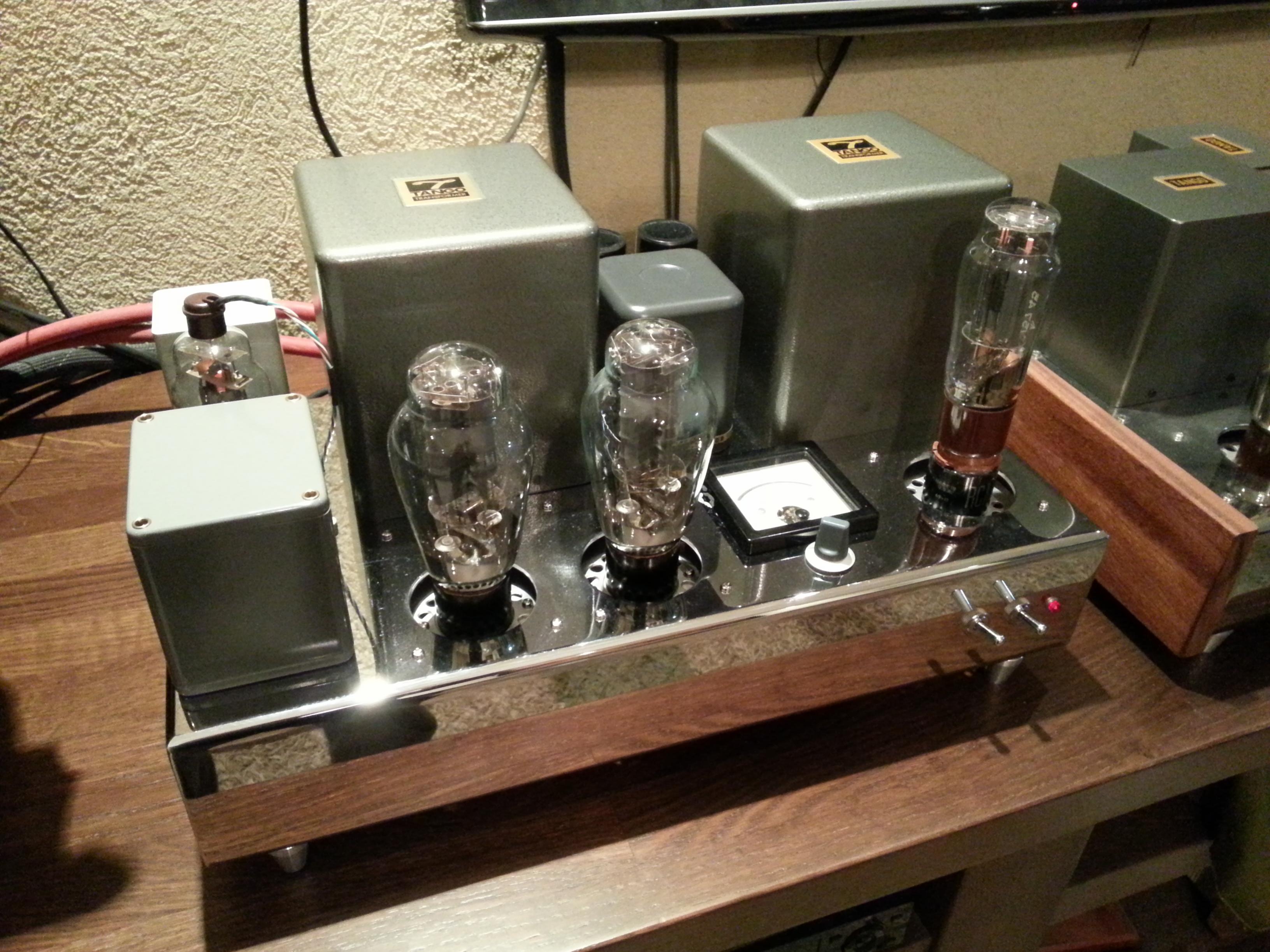

This is my latest project-300B Parallel SE amp
There are people who have elevated this diyaudio building to new heights of construction, design, aesthetics, and sonics. Some of the builds of amplifiers almost make me think that this subforum ought be renamed as, "tube amplifier porn".
845, your build is awesome looking -- just wish you could invite us all over for a listen though. It is also awesome on how to all matches well.

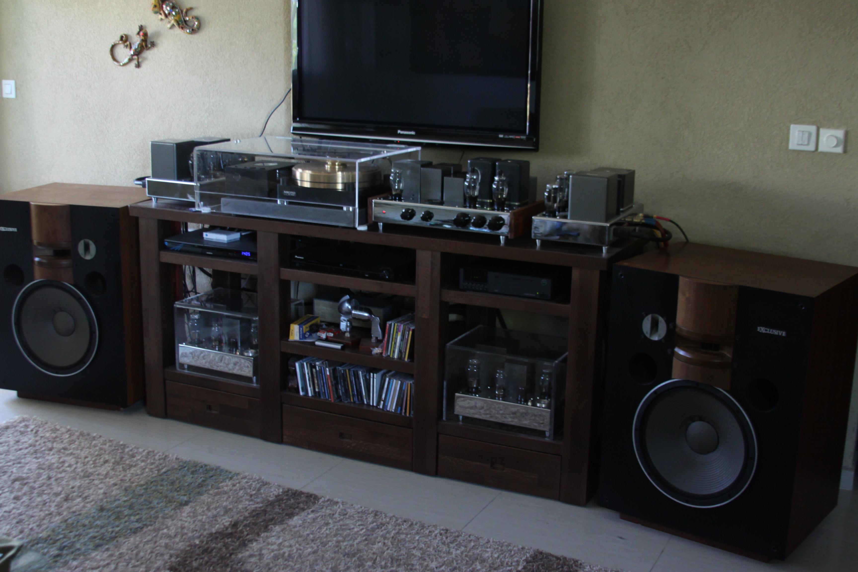

What is the list of the other tube based equipment in your set up picture?

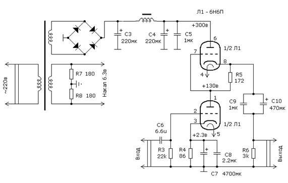

Party of spring on March 8. Assembled headphone amplifier for wife. As a gift. Amplifier in cake. Power supply in the stand
