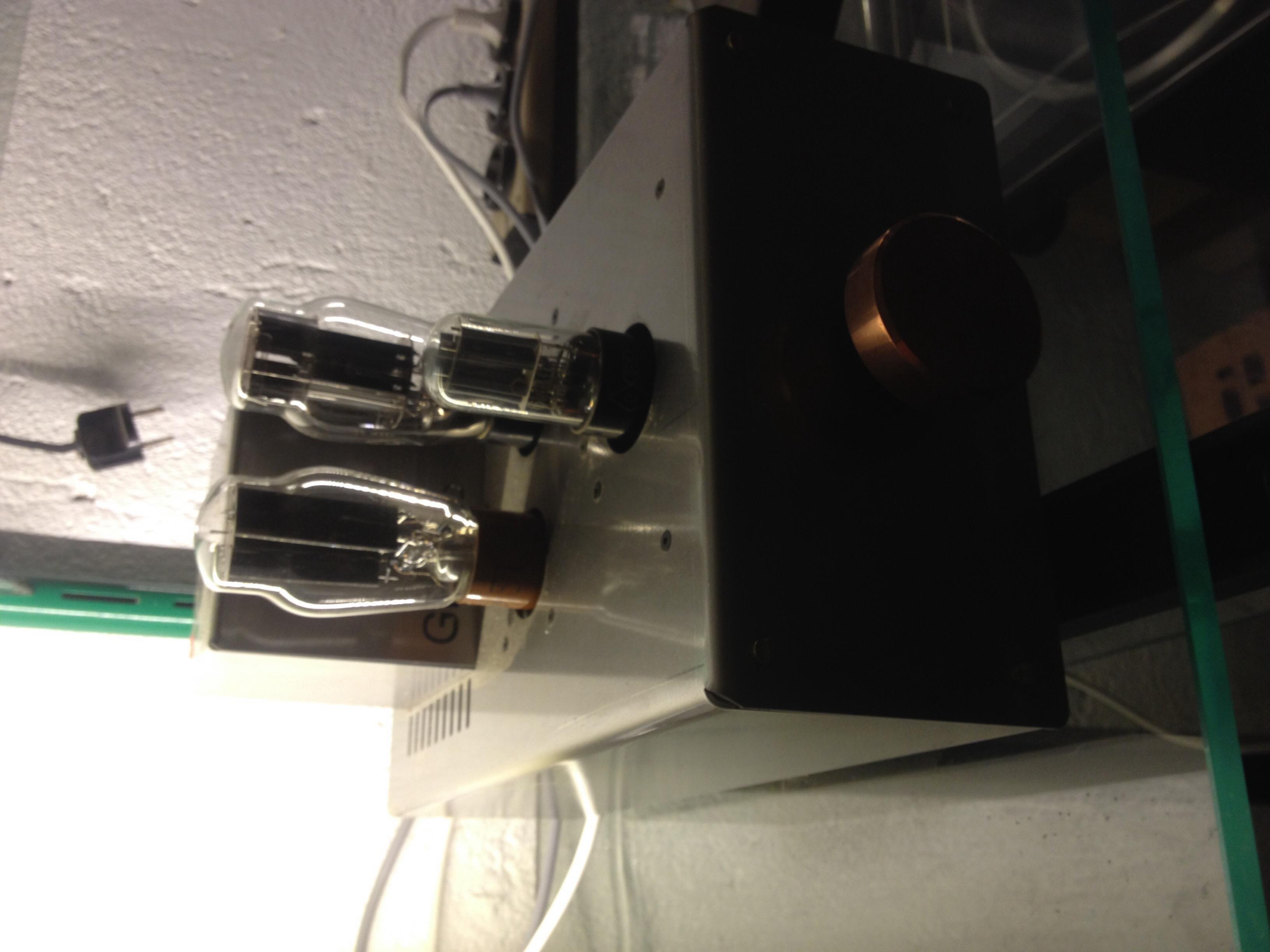

As a not that future project will involve a slightly bigger tube, it would be nice to show both tubes so viewers (and listeners) can compare them.
(The smaller tube is propably an ECC82)
That's a pretty handy tetrod which is easy to drive and that can hand out some 20-25W of power in Single end.
However it has a huge anode connector (hat) on top and I will use about 700V B+ ...

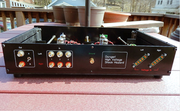

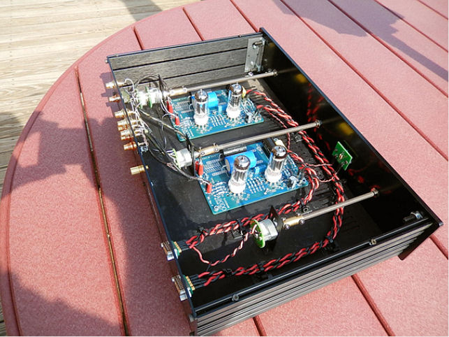

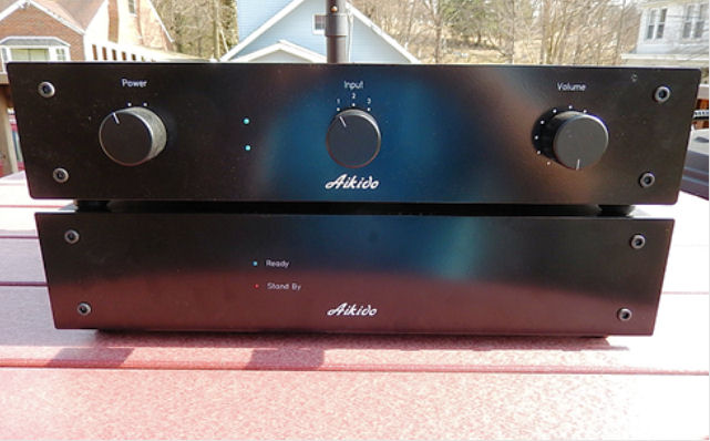

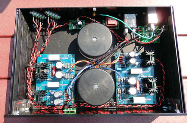

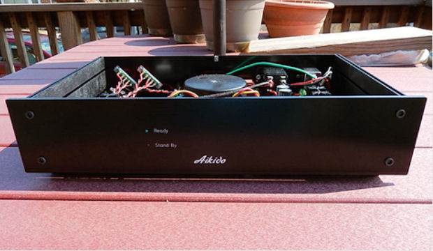

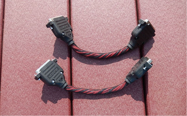

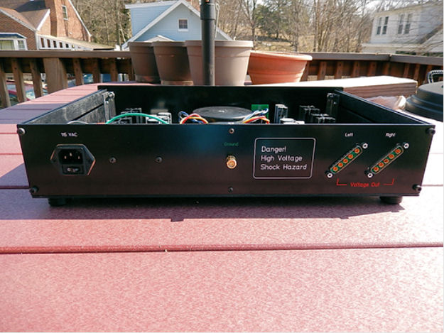

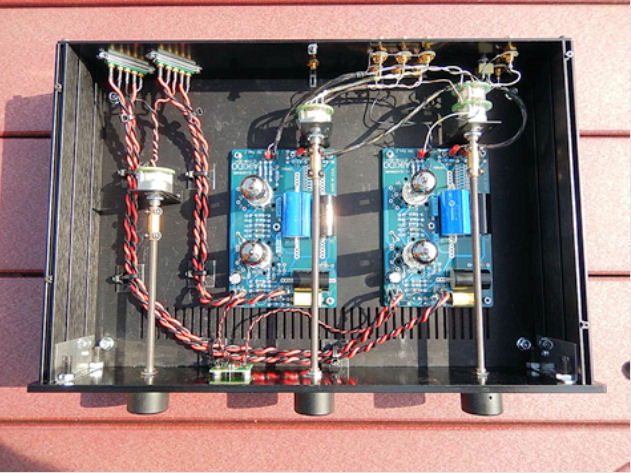

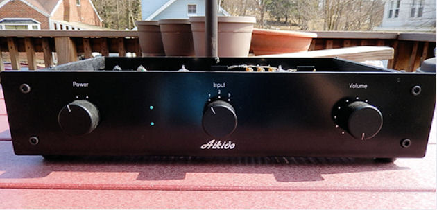

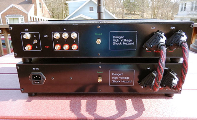

Here are a few pictures of my Aikido Pre Amp. This project took about a year from start to finish. I built this as dual-mono and dual chassis. The basic configuration are 9-pin Dual-Mono PCBs using 6CG7’s that are powered by a pair of PS-1 power supply boards using SumR transformers. Some of the parts upgrades include Takman resistors, Clarity and Mundorf caps, Goldpoint switching and volume pot and Vampire RCA’s. I used Front Panel Express for the front and rear panels. This project exceeded all of my expectations (which were high to begin with). First and foremost, there is absolutely no background noise, its dead quiet and with only about 5 hours play time on it, the sound quality is excellent and improves with each hour of use.

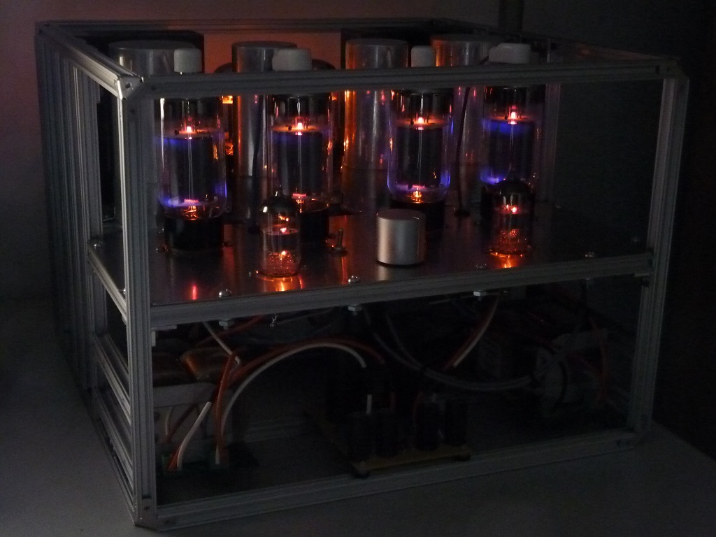

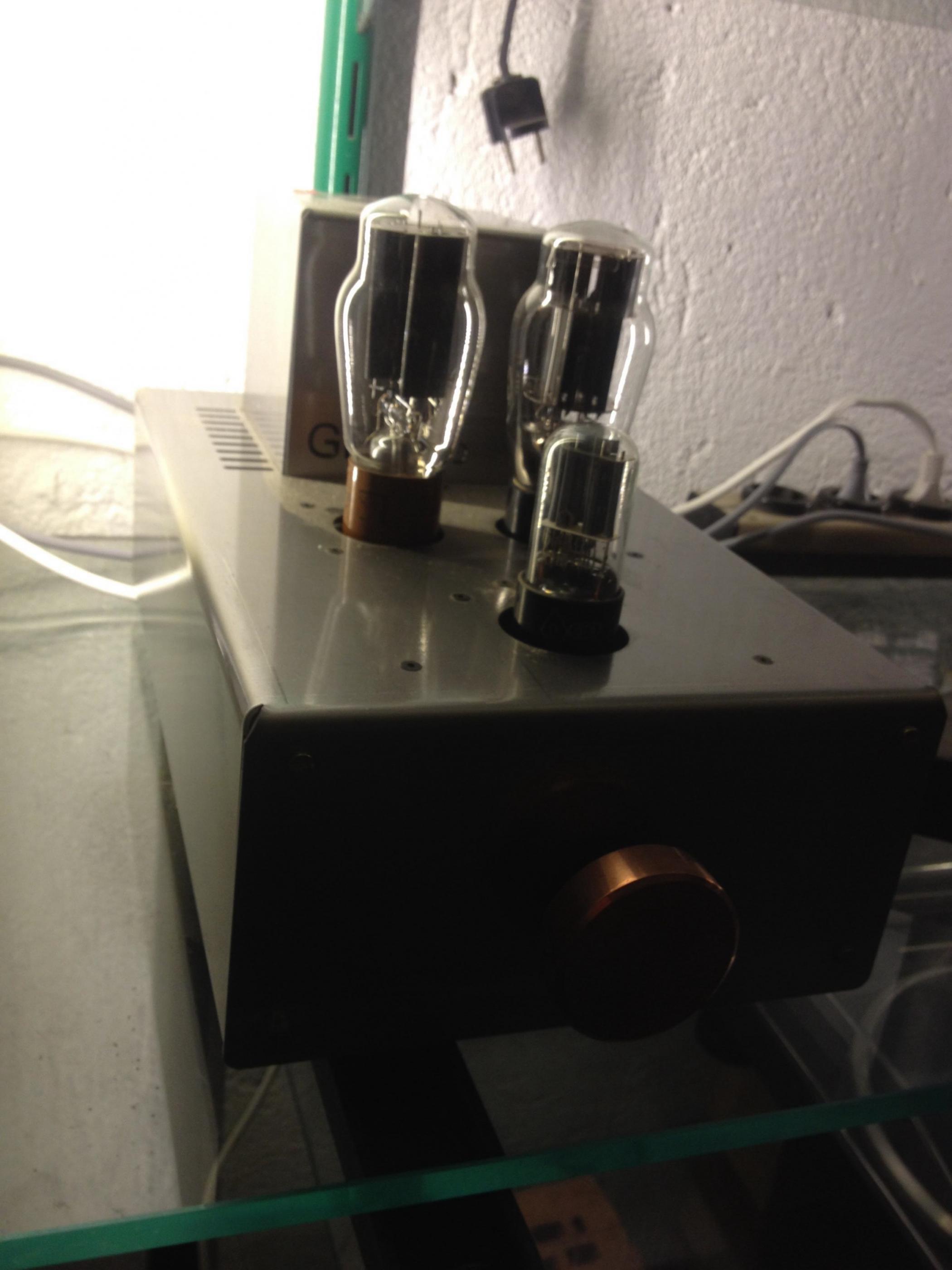

My last parallel SE mono blocks. All Russian, made an all American version too.
Tubes. Schematic?
