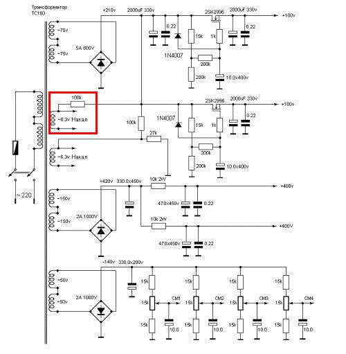

My pp 6N13S finished today. More photos 6N13S - mymegahobby Jimdo-Page!
Well done!
The question under the scheme: not too high raised one of the heats?
