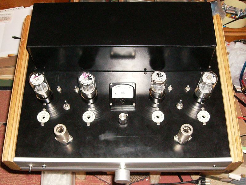

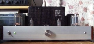

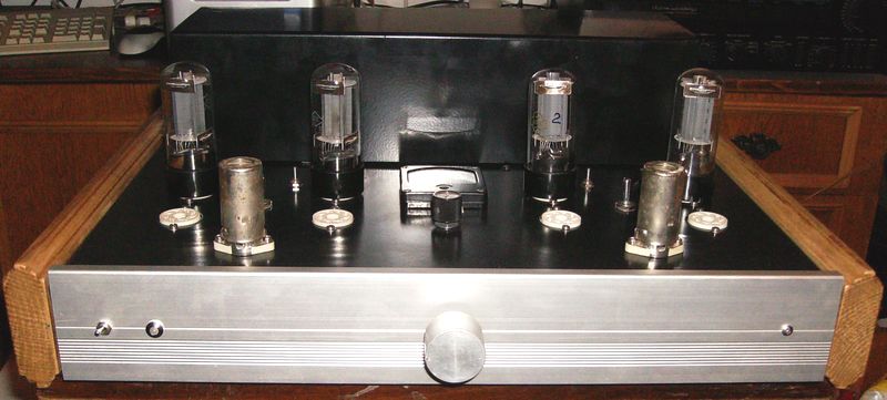

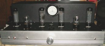

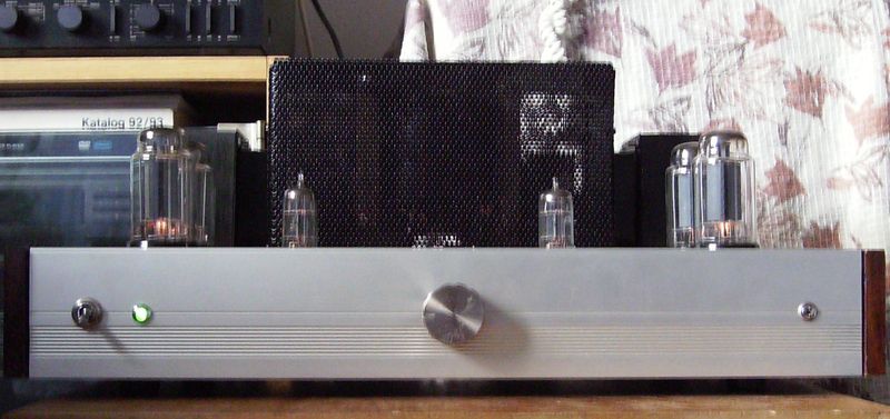

Mt third project, def my best so far. Aluminumm chassis with thin carbon fiber covering. Maple wood trim. Sounds very nice...
Gorgeous!! nice work

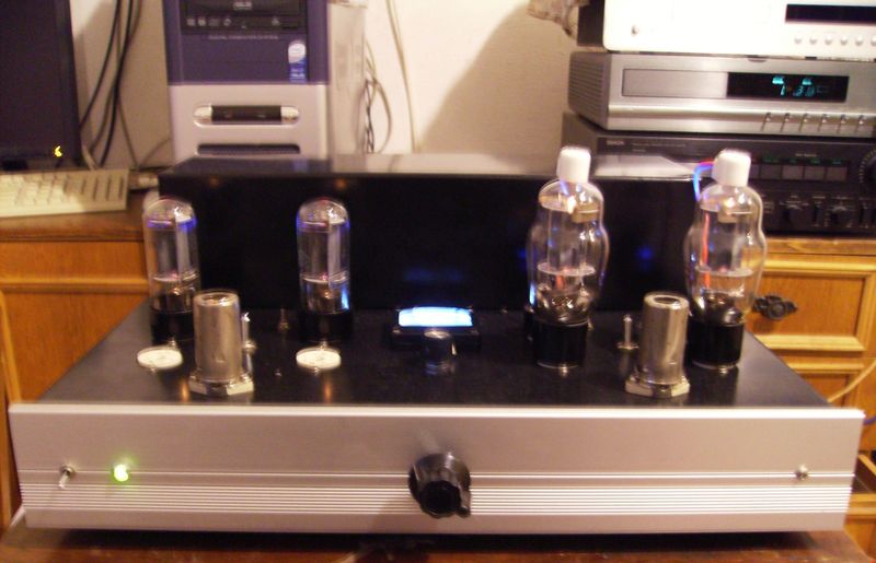

Wow!
Very simple and classey looking I like it allot!

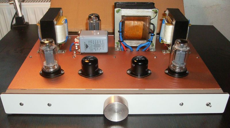

How about a vintage pair of monoblocks?
There have not been many in this thread.

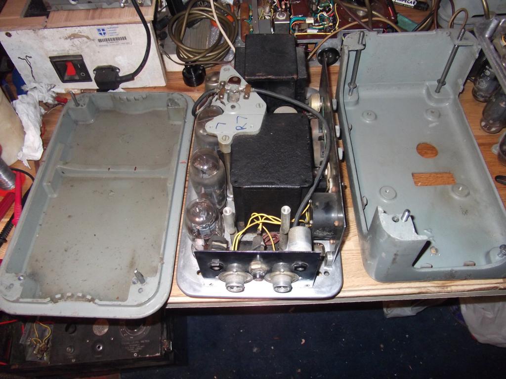

So lets have a go.

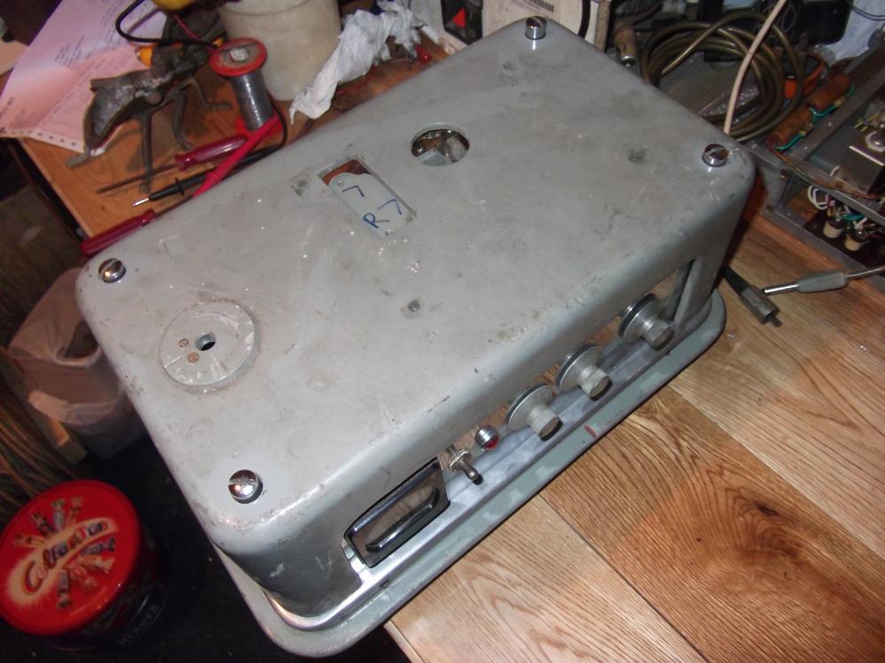

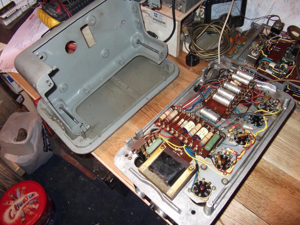

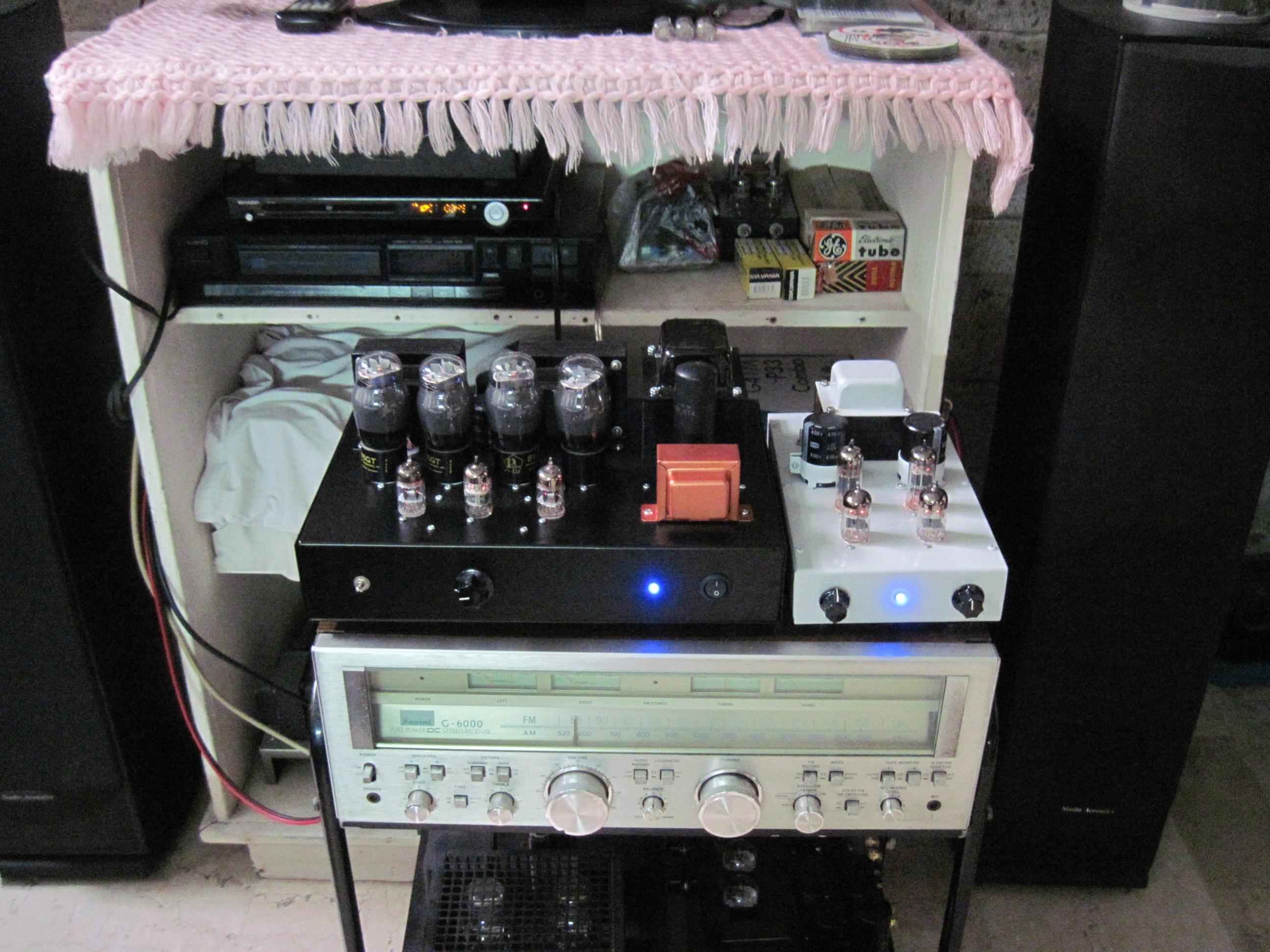

They are Cinetechnic Debrie industrial cinema amplifiers from the early 1950s.
They are just so well built and easy to service.
All cast chassis and cabinet parts and the only faults that were present from new as they came from a workshop clean out and were a skip dive recovery and were the dodgy ones that got put to one side.
I have no idea what they sound like with the output stages driven into distortion as they make my ears heart before I can get that far with the volume😀
The lineup is EF37A ECC33 EL37 EL37 EZ32.

They were found in the early 1980s and have been stored since then until now.
There is a mod that I will need to do as all the small capacitors are 0.1uf and there is one that I would like to see go up to 1uf or even 10uf as it is in the cathode of the ECC33 and it has no negative feedback going to it.
They will then be the winter HiFi for the lounge. We do not have air con.

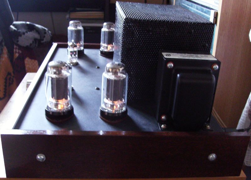

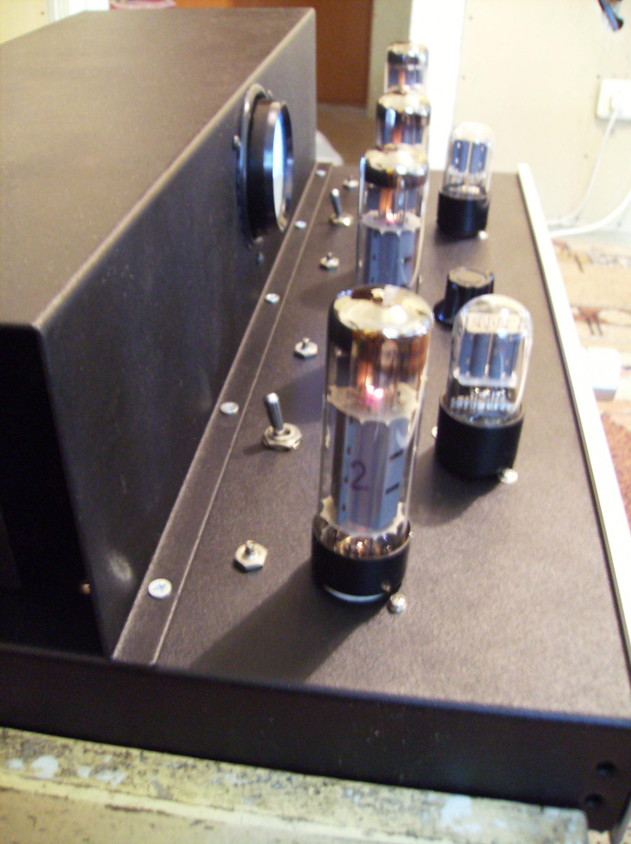

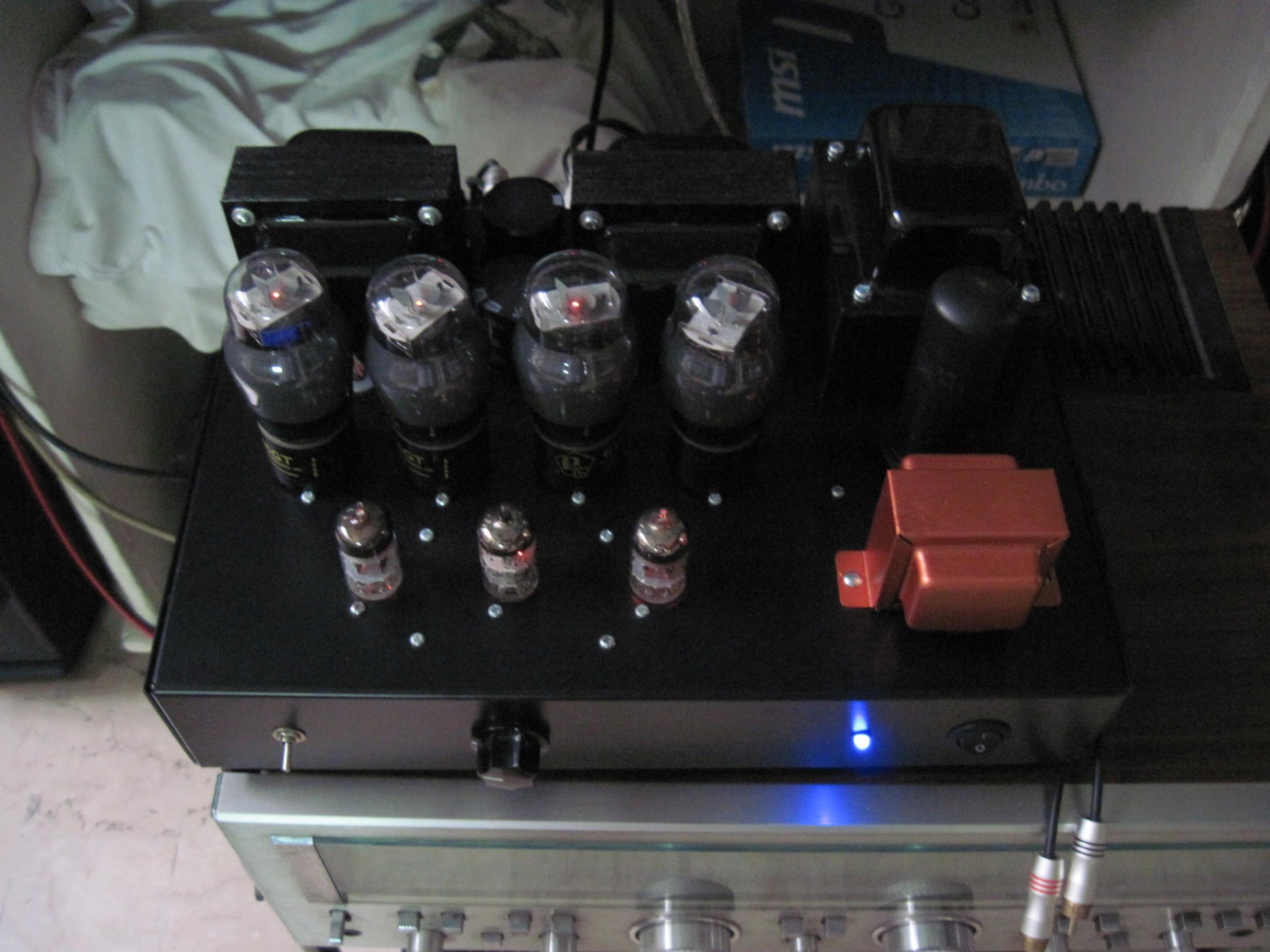

cbassss: nice, smart looking amp and with one of my fav. tubes. Should sound absolutely stunning and lots of power. I have only just completed two EL34 SE UL amps and friends bought them after a few minutes of listening. I love the EL34 and you have done the tube and yourself proud here. Good work.

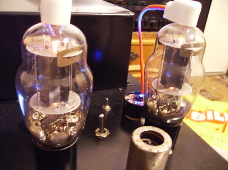

They did not need a great deal of work to get them going.
The worst one had half of the output transformer shorted out.
It was because at the time of manufacture the start of the half of the primary wound over the secondary had come loose.
The operative had just stuffed it down the side of the link that looped over the secondary to the second half of the winding causing an intermittant short and loads of distortion.
It took no time to fix it once I had found it. I then told the guy that was going to rewind it that I had managed to fix it.
The last thing to do is to change the 0.1uf in the cathode of the triode driving the phase splitter. The other half of the ECC33 is wired with the capacitors on anode and cathode so only one triode for the phase splitter.

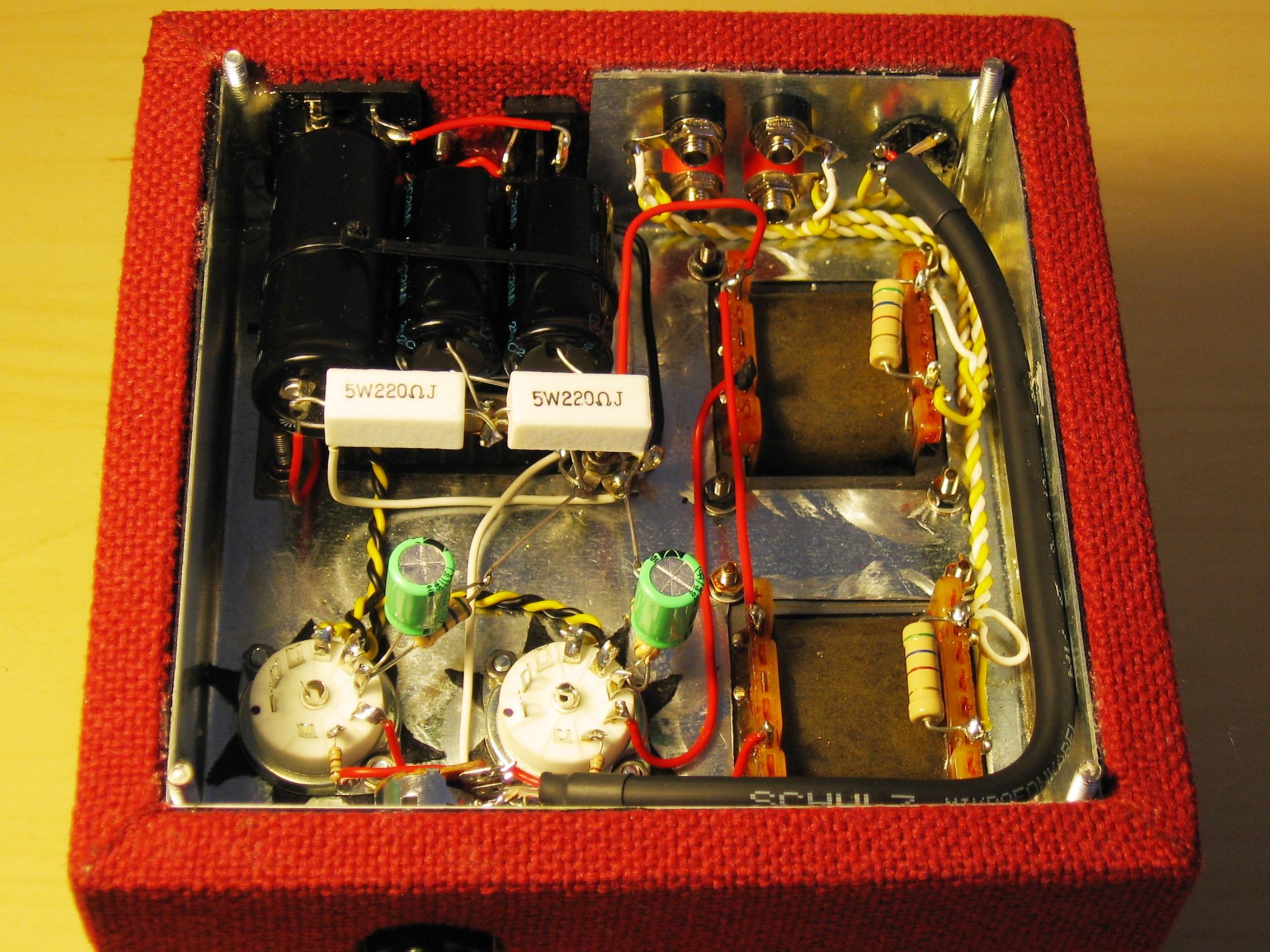

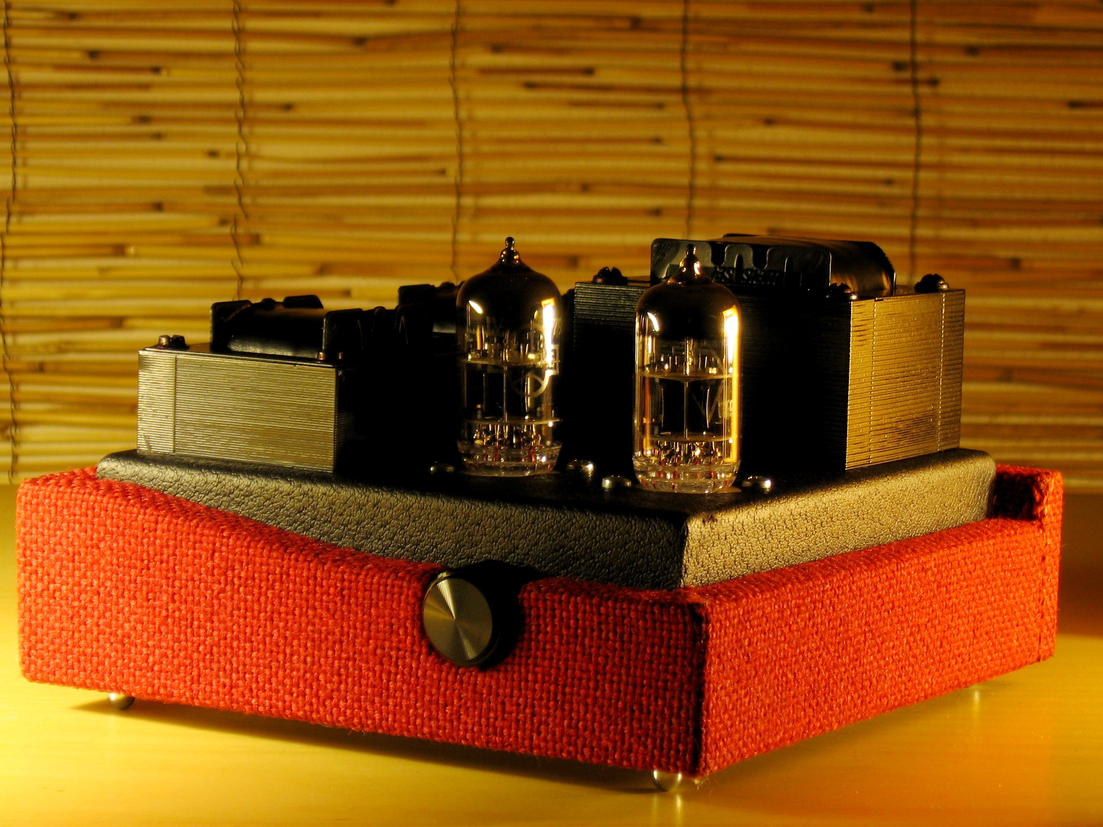

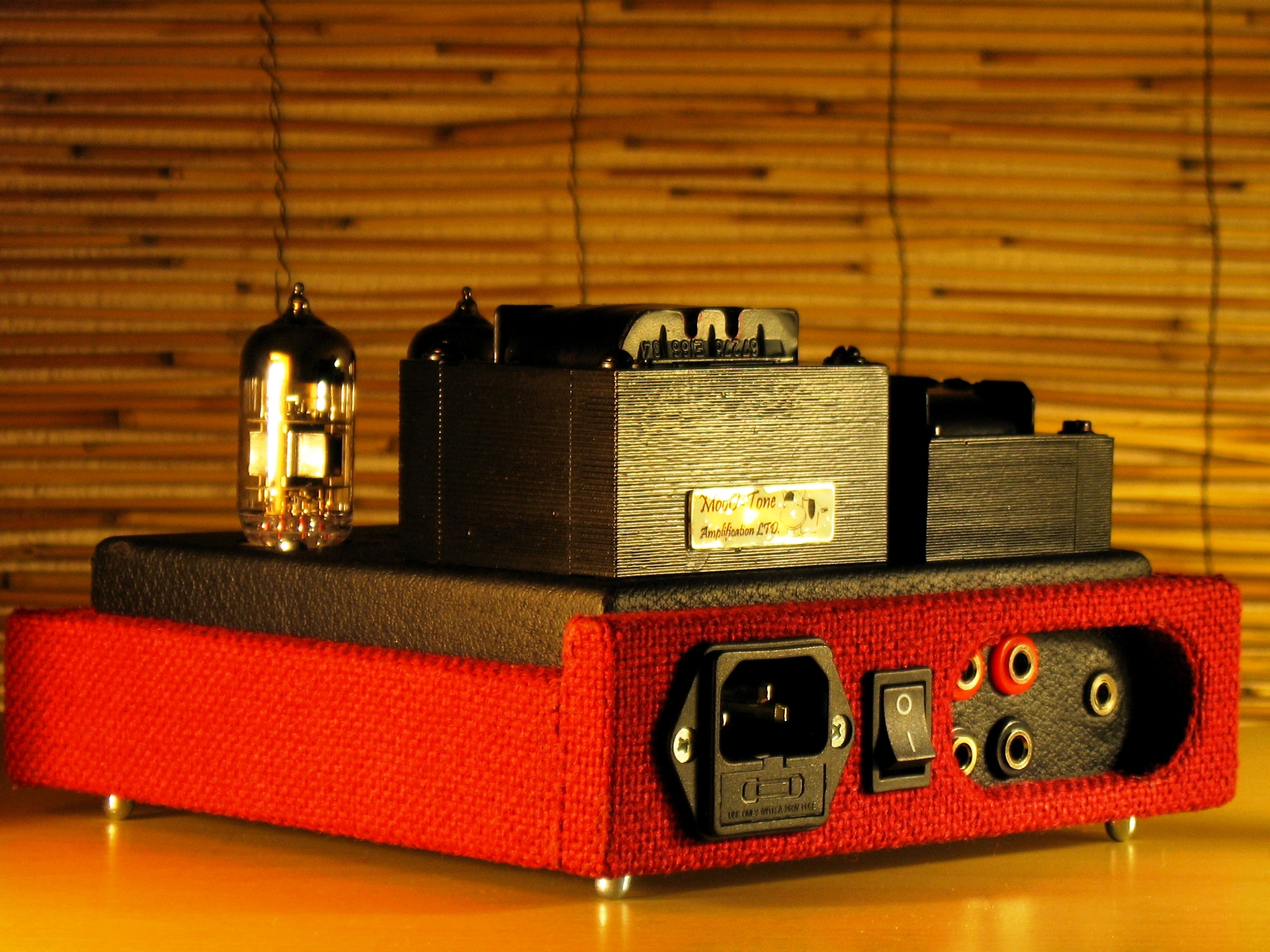

Obsessed with tiny winy projects, and all in covering inspired by the instrument amps. Here is my extra simple, just one triode (6C45) per channel spud and has a great sound!
That is such a nice clean build. Congratulations!
Thank you!Very nice...

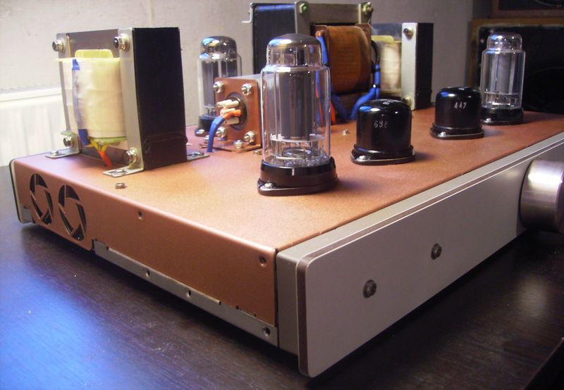

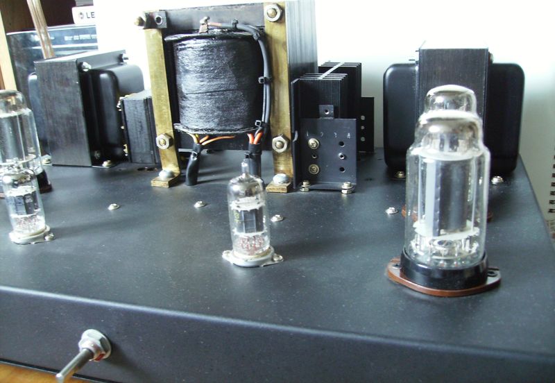

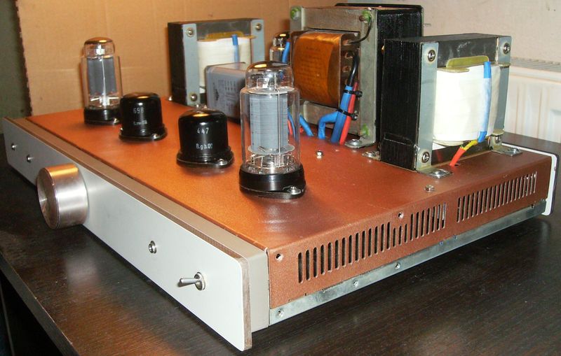

The second amplifier is again a PP with 6N9S + EL34 in pentode or UL mode.
Chris73: fabulous looking amp. I'm a sucker for small cute projects to. The one I'm working on at the moment is a 6EM7 on a heavy Acacia chopping board.
