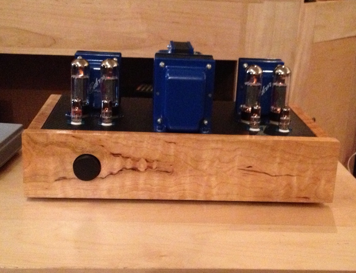

One when stationary and one when traveling

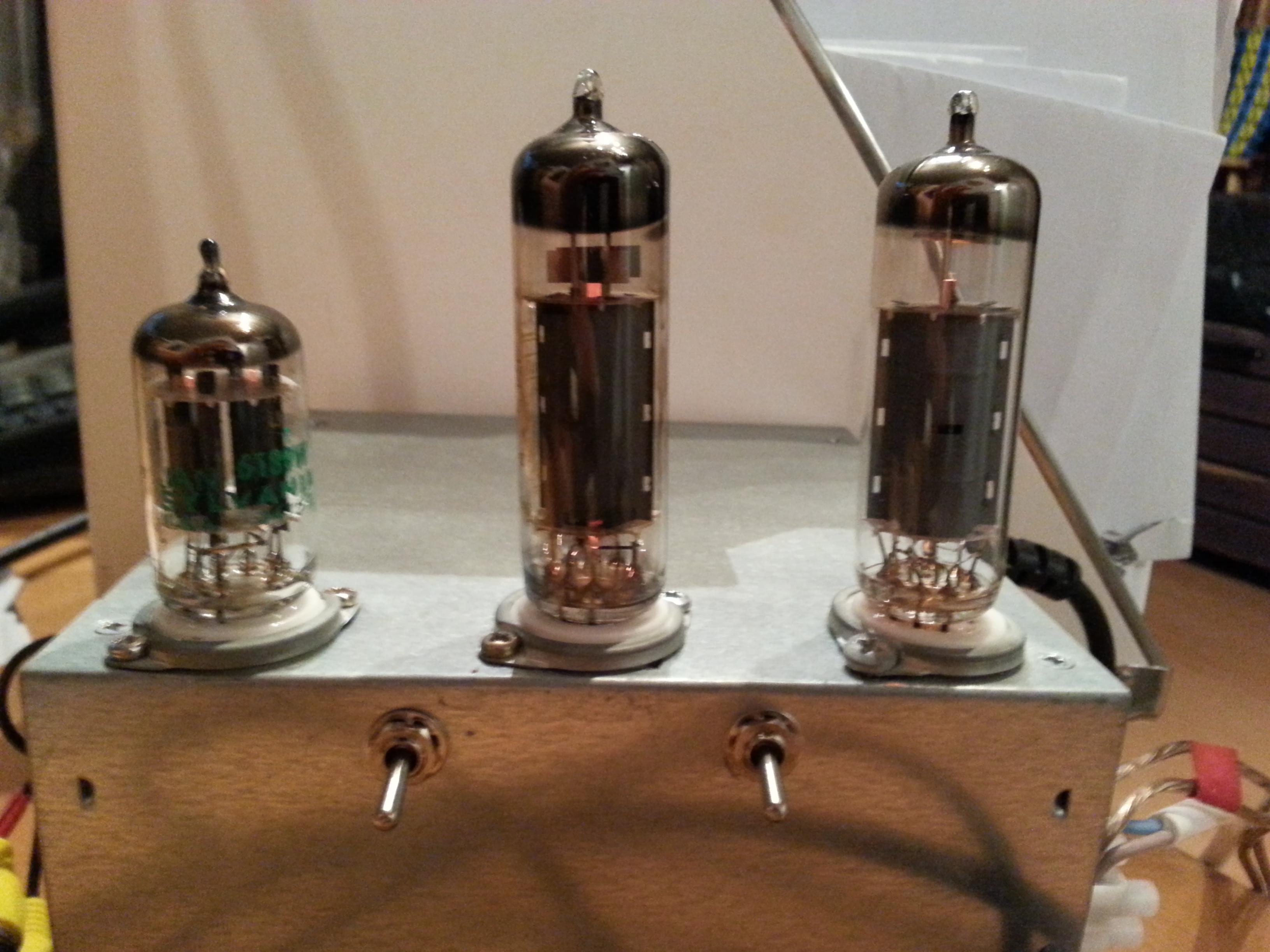

For desk use (4-5 hours/day) EL84 SE that is usually operated single-stage (input from USB soundcard straight to trioded EL84 with 98db OB speakers 1 meter away) but can be switched to 2-stage if required.

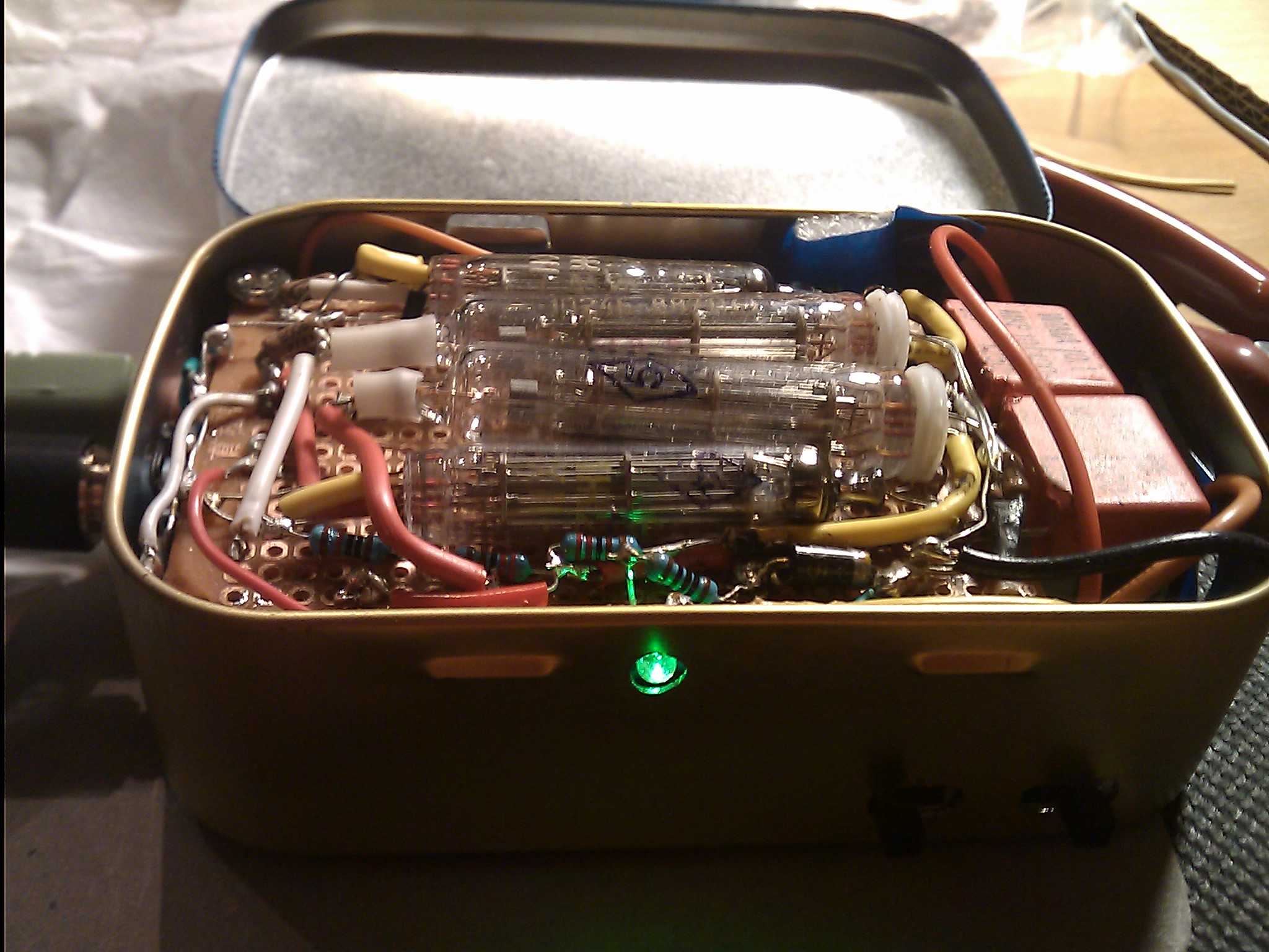

For travel, all direct-heated headphone amp that plays for some 9 hours hours on one battery charge.
If not obvious from the pictures, both were made mostly of junk parts (but the labeling on the headamp 'housing' fits quite well ...)
