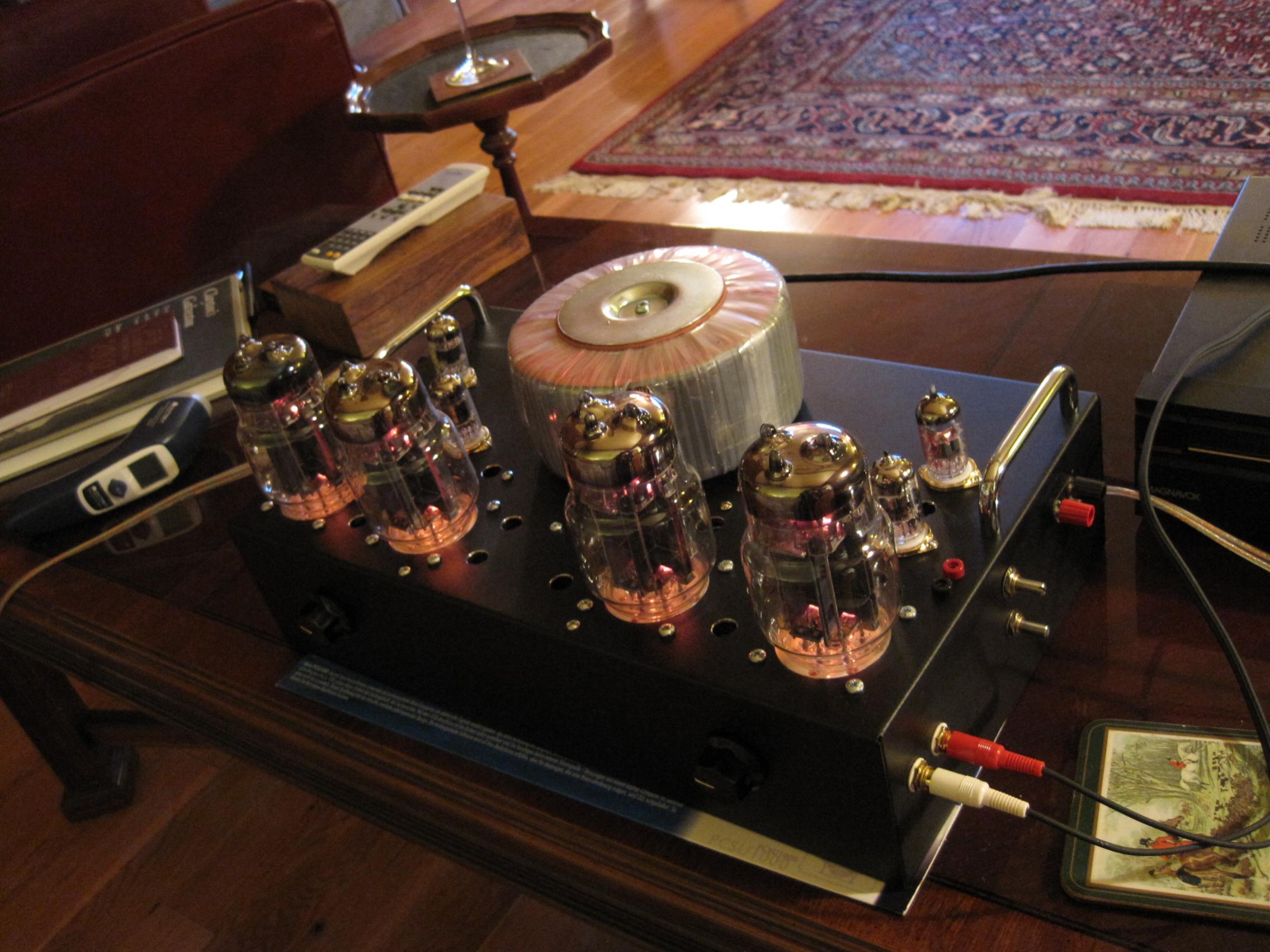

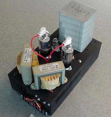

My living room amp changes from time to time, but the one that's been in place for the past few months is "Miz Piggy", the second vacuum tube amp I ever built, and still a pretty satisfying performer. This is an SE design using screen driven (w/source follower) 6CD6GA with 6JC6A pentodes doing the front end duty. Output iron is Hammond 125ESE. It's ugly, but quite functional. Right now, the amp is sporting CBS/Hytron 6CD6Gs in the stylish ST bottle rather than the straight-sided GE 6CD6GAs shown in the picture.

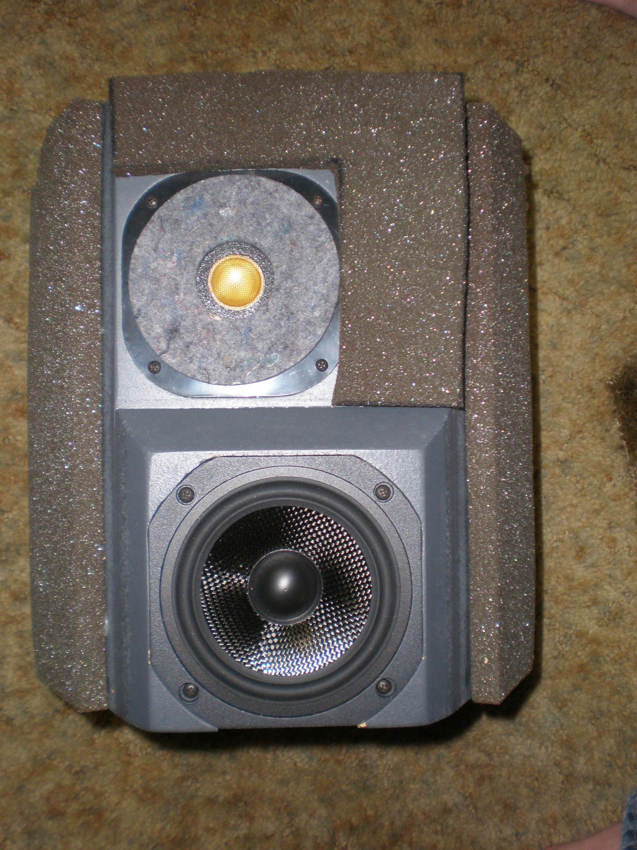

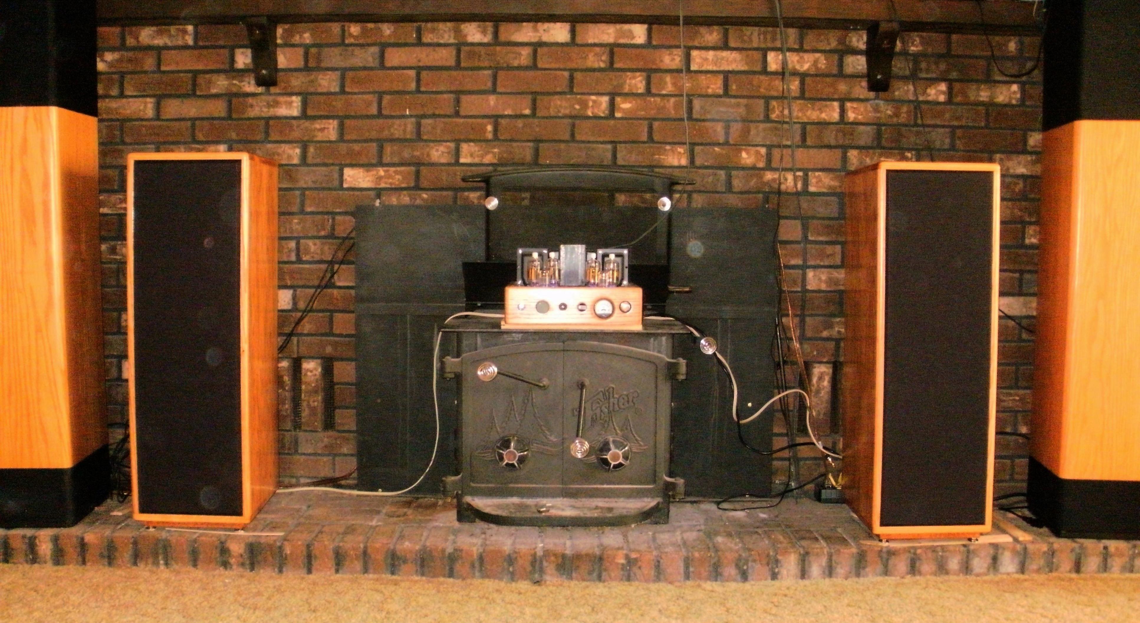

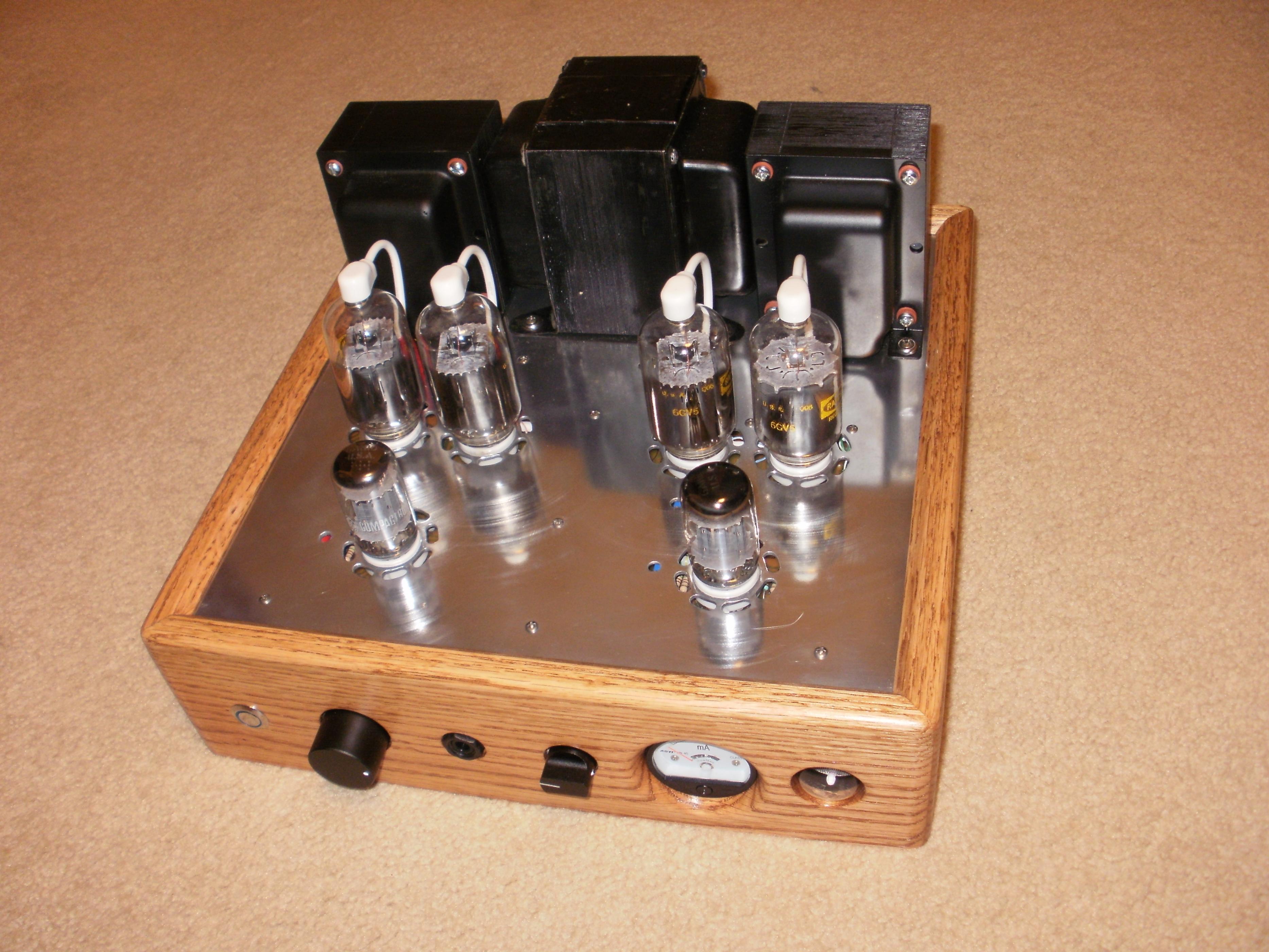

PP sweep tube amp 30w/channel. Main speakers are the tall ones. I replaced the Focal 5.25" with an Audax carbon fiber cone a couple years ago. So it is basically a speaker sitting on top of a subwoofer. The shorter transmission line speakers were stocking stuffers last Christmas for our son to go along with his tube based stereo system.
