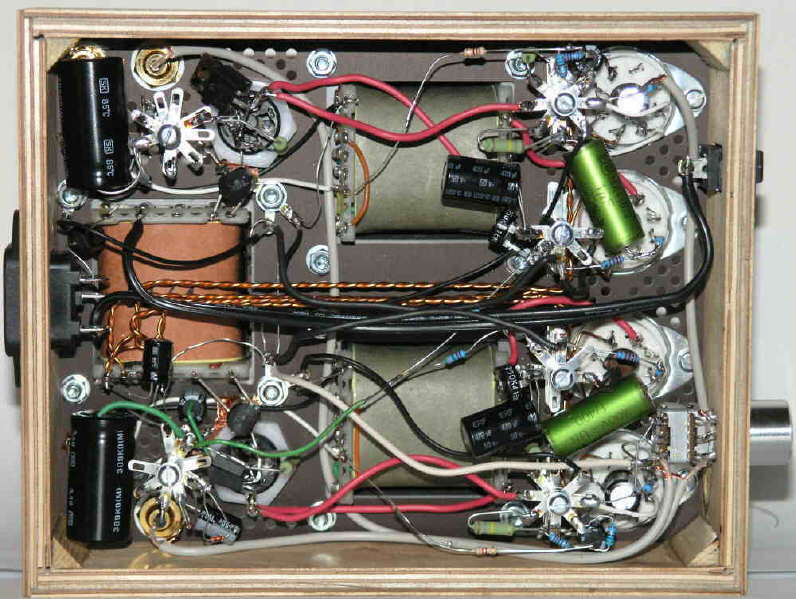

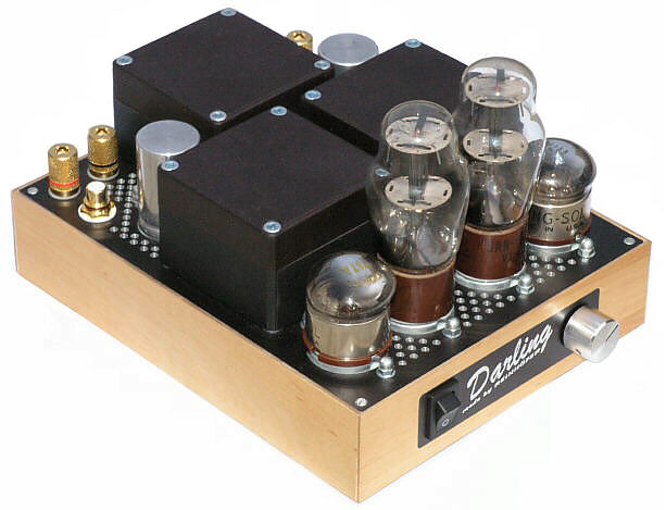

This is my last project, the chassis was made from a piece of a old wooden box:
Tubes are the 717A and 1626, the chassis is 20 x 16 x 4 cm, this power amp makes 2 x 0,8 Watts 😀

BTW, what tubes you used for the darling project? ken-rad, RCA, or any other types? I tried to search but never found out which types are more popular
Hello,
that I have got, no special brand. Currently they are from National Union Radio Corp.
I think, all brands are not made for AF-amplifiers, and so all are not perfect devices.
I am not searching for the tubes, I use that I have and build the amp around this....
Gerd
Bas Horneman said:Marvellous!!! She's a beauty allright! How does she sound? Do you have a schematic?
Hello,
it sounds very nice, but around 5% THD at 0,5Watts..
schematic comes later, I have to draw this.
Frequency response is 13Hz..26KHz -1dB

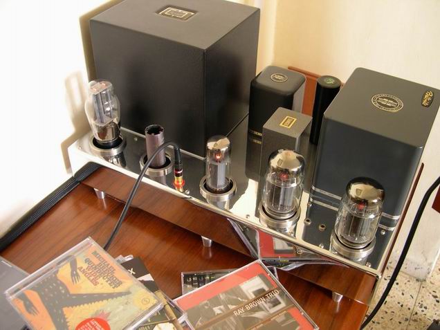

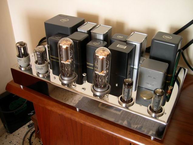

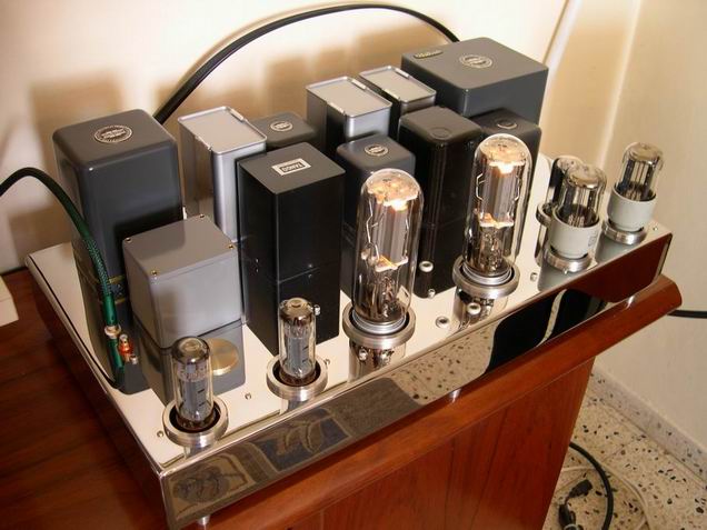

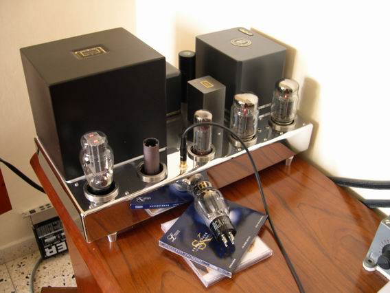

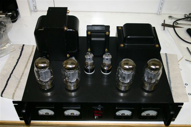

My 845.
For each monoblock:
Input transformer-Tamura STU-001 300,150 Ohm to 100 kOhm
with CT are connected to Class A Push-Pull driver (two El34 in triode mode). The driver stage are connected to NC-22 Tango
P-P interstage transformer which pushes the 845 P-P Class A
fix bias output stage. Output transformer is Tamura F-2021.
Power supply:
Power trans 1-Tamura STU-3012 (230V primary)
Power trans 2-Old Chikago transformers.
Tube rectifieeng- 2*5AR4 and 5U4(for driver stage)
Filtering-2* Tamura A-4004 chokes and oil capacitors for HT section and one A-4004 choke with oil caps for driver section.
The amplifier is developed by me without feedback.
The project proceeded one and a half year .
I am sorry for my English.
