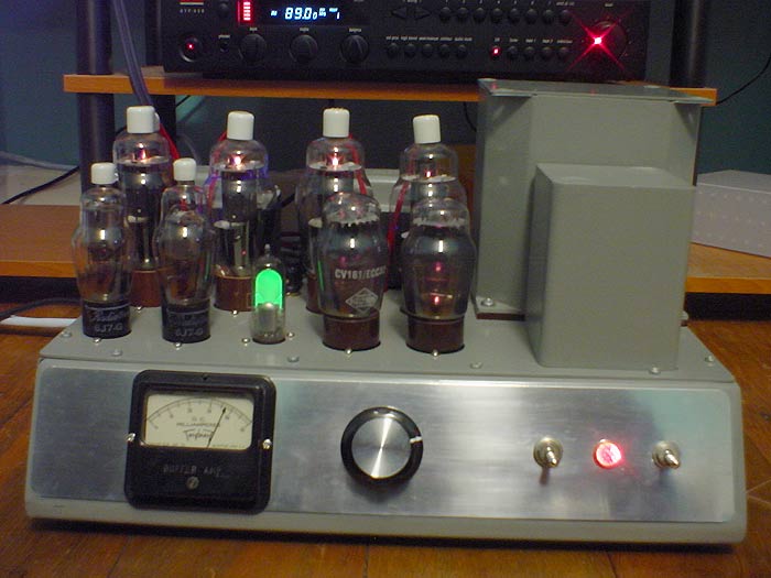

Sounds pretty good, lots of power and authority, definitely more grunt than my SET amp. However its still being fine tuned, a few issues to work out yet. Might have to bias it more in class A I think.

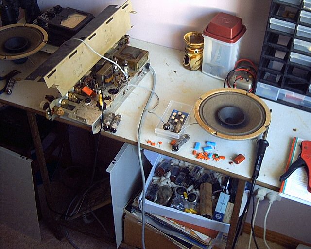

It's a stereo SE 6GW8 from ye-olde H.M.V cabinet radiogram.
It suffices with 3.5 watts to drive my 3-way cheap-chinese speakers into TURN IT DOWN! loudness.
On a pair of Magnavox 10" whizzer cone baffles though it really shines =P
I've been kicking dirt around on this amp for the past 12 months learning bit by bit how tubes operate..

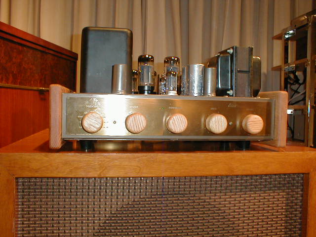

Dressed up Eico HF-20's
I am fortunate to have found a pair of Eico HF-20 P-P 6L6 UL mono amps and in the process of rebuilding them and some modifications to make them better I also dressed them on the outside with some hard maple knobs and side panels and new feet. I am currently using these on my newest speaker project seen in my avatar. Sweet tube sound. I've added adjustable NFB controls on these amps and am using them with far less than the original amount. This and the addition of a plate choke on the line amp stage preceding the phase inverter, correcting the cathode bias R value on the (Williamson circuit) drivers and changing the two 12AU7's to 6CG7's really opened them up.
