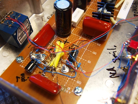

I usualy wire component-2-component. This means no hook-up wire used in the amp section at all. And definitely no cct. brds. Each component connects to the next with only the connecting leads which come with that component. This is better than point-2-point wiring.

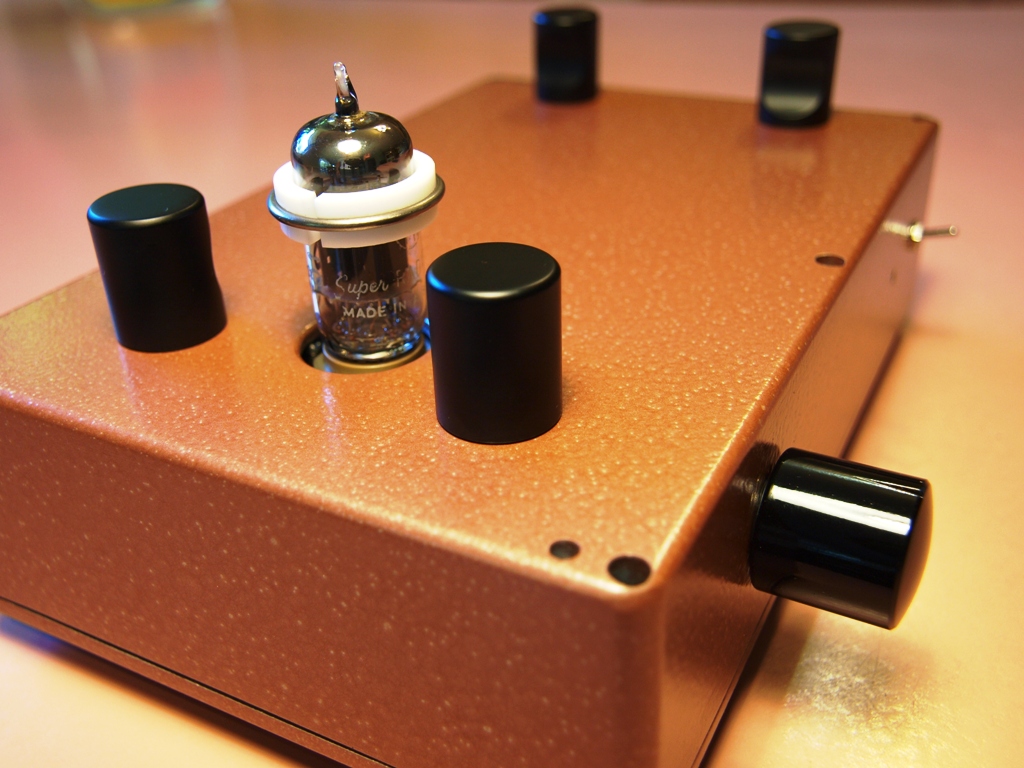

Currently building Super Simple Single Stage (4S) tube preamps. I've built three in as many weeks and about to start a "Universal" 4th. They all run from a 24VAC wall wart and cost about $150 to $250 to build. The first three builds around the 12AU7 the Universal will take all 12Axx tubes. True plug and play.

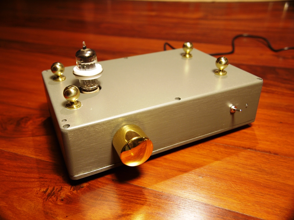

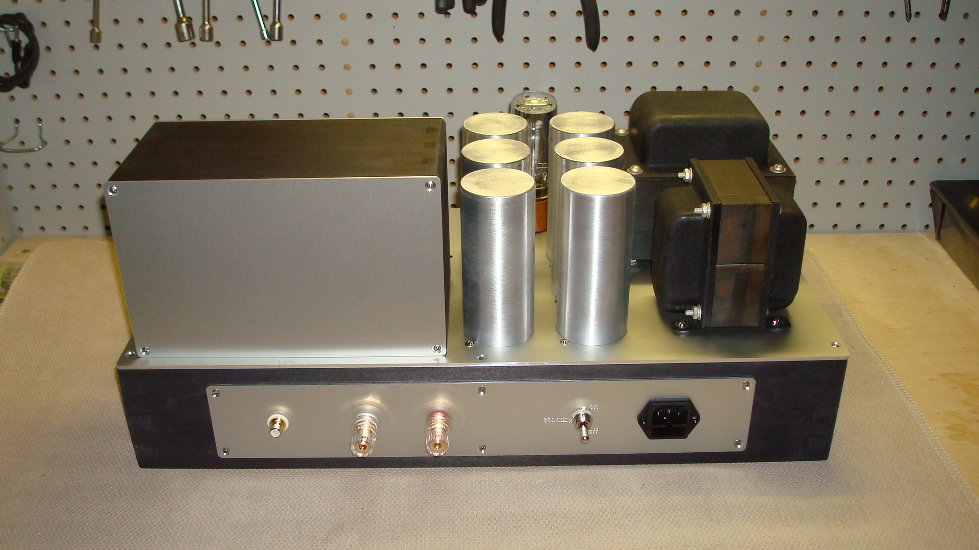

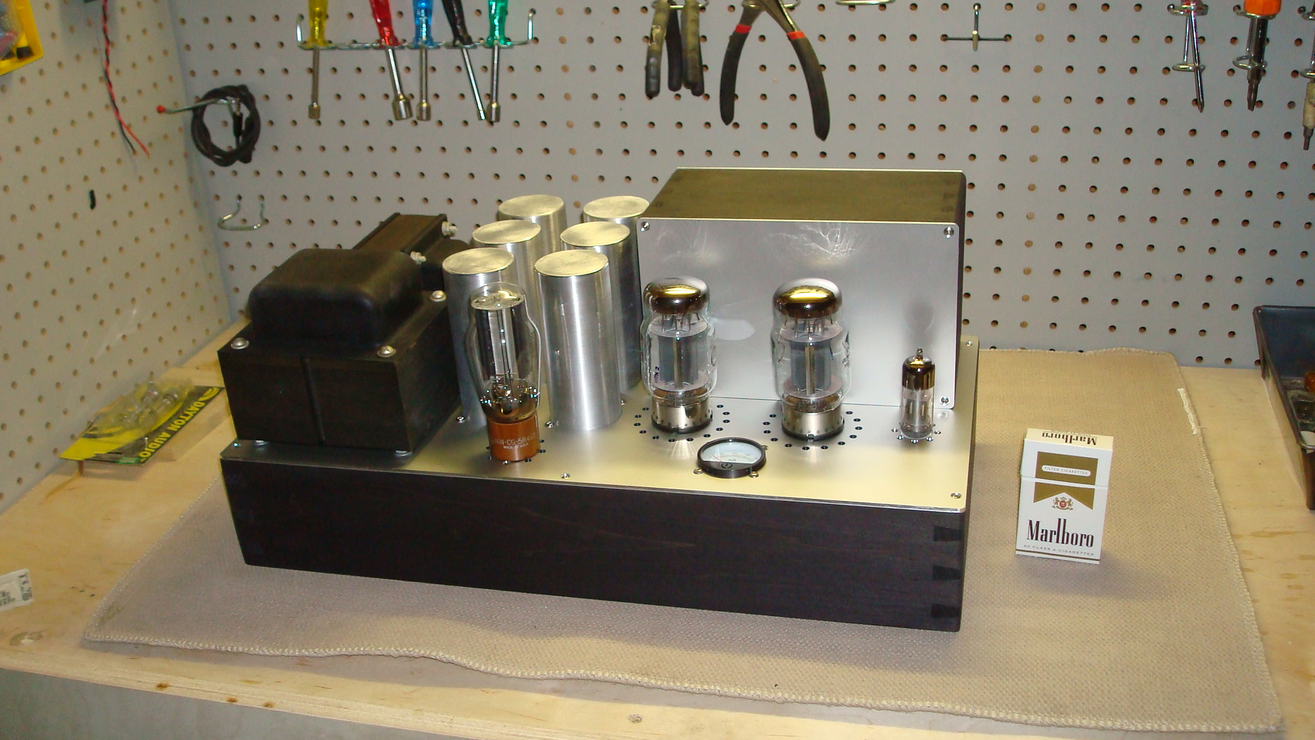

i don't keep track but it around $1200 for both. i've breadboard this amp and i really like the sound very powerful compare to my se kt88, this is only my 3rd build and my first PP the first two were se.
this is one of two i've been working on, not yet complete. total $ parts way under $3G for both.

For that investment very nice, clean , professional looking amp.
It look like built by someone who built hundreds of amp!
You built KT88 SE & PP com pare the mid range which one is better? I know PP in bass region much powerful.

im an SE guy. this amp is just to see if i can built something different not something better than my first two, we all know the debate between SE vs PP. im not a pro just a hobbiest so i avoid the debate of whats better, i know enough to know what i like and i enjoy building stuff, im still learning as i go.

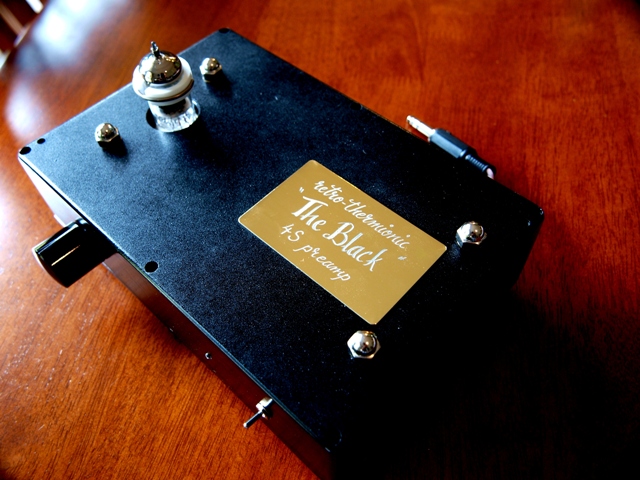

Here is my third build of the Super Simple Single Stage tube preamp: 4S The Black. This is based on a 12AU7 Silver Dragon. Much modified values and slightly modified schematic. 24VAC wall wart runs a tranni backwards inside to produce 280VDC. Solen output caps. All component-2-component wiring and DC heaters. No hook-up wire in amp section. Silver solder and Alps blue velvet pot on the output.
The best sounding so far. One more differeent one to make which will support with no modification all 12Axx tubes - true plug and play.
