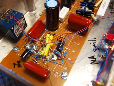

Here is the Super Simple Single Satge Tube preamp. The PS and amp exist on one small peice of brd with no cct. All component-2-component connections, silver soldered, plus Alps pot on the output, 4oz solid brass knob and brass arty bits. A 24V wall wart connects to the grid and this 4Ss preamp sounds better than it looks. YES REALLY!

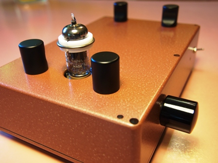

Here is my second Super Simple Single Stage preamp (The 4S MKII), slightly better values this time which has brought the distortion down to 0.2%. Much better and neater layout and construction. All component-2-component wiring, silver solder and Alps blue velvet and solid brass knob.
Colour is Epoxy Beaten Copper. Two switchable inputs on the back. Golden Dragon 12AU7 installed. The sound is natural to flat. Over 8db of gain and frequency range is 10hz to 152kHz. Again is runs from a 24V AC wall wart. PS and amp on the one cct. brd. See this thread for schematic etc.

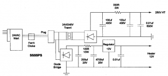

Do you want me to read the WHOLE thread? Schematic on page one is SLIGHTLY different (B+ 300 volts). Hold on, on top of that I'll have to login to see it in case I ever find it. Wouldn't be easier to post it here?

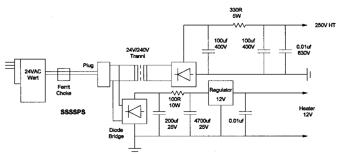

Here is the orginal cct. I used. In this build (MKII) the Rp was increased to 27K and the Rc dropped to 800 ohms. Originally the Rc was not bypassed.
I have one other to build where there is no Rfb and no Routput. Rc is un-bypassed and no Rfb.
An even earlier cct.to this one has Rfb set at 660K. Twice what is in this cct.

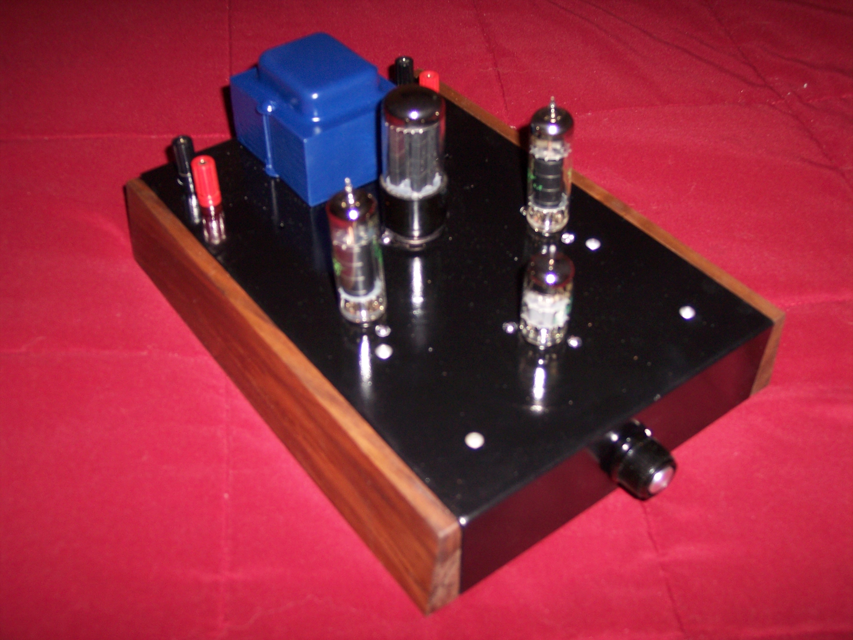

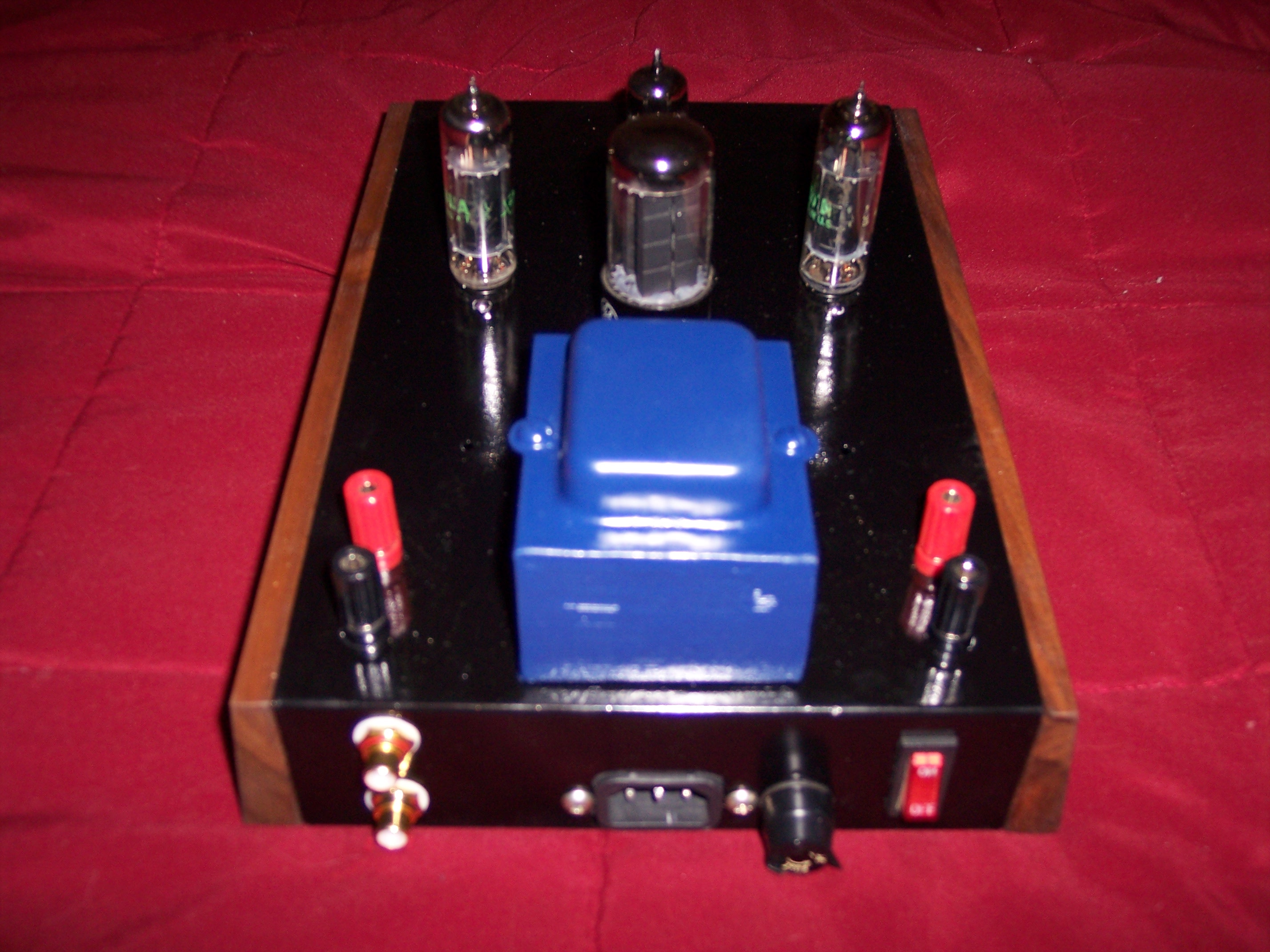

Here is an EL84 SET that I have just finished for my father.
Basically a junkbox amp, a little of everything that I had laying around.
Note: haven't gone through final cleaning and dust specks showed up with the flash, and the transformer is a dark international blue. The flash made the transformer look out of place, but it is a really dark blue.
The sides are Black Walnut
Oh, the layout of the deck is like the one Decware makes, but the circuit is different.
I think this one has a very clean sound with open-baffle fullrange 12" Heppners, and no hum can be detected with your ear to the speaker cone.
