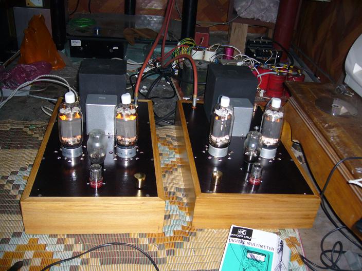

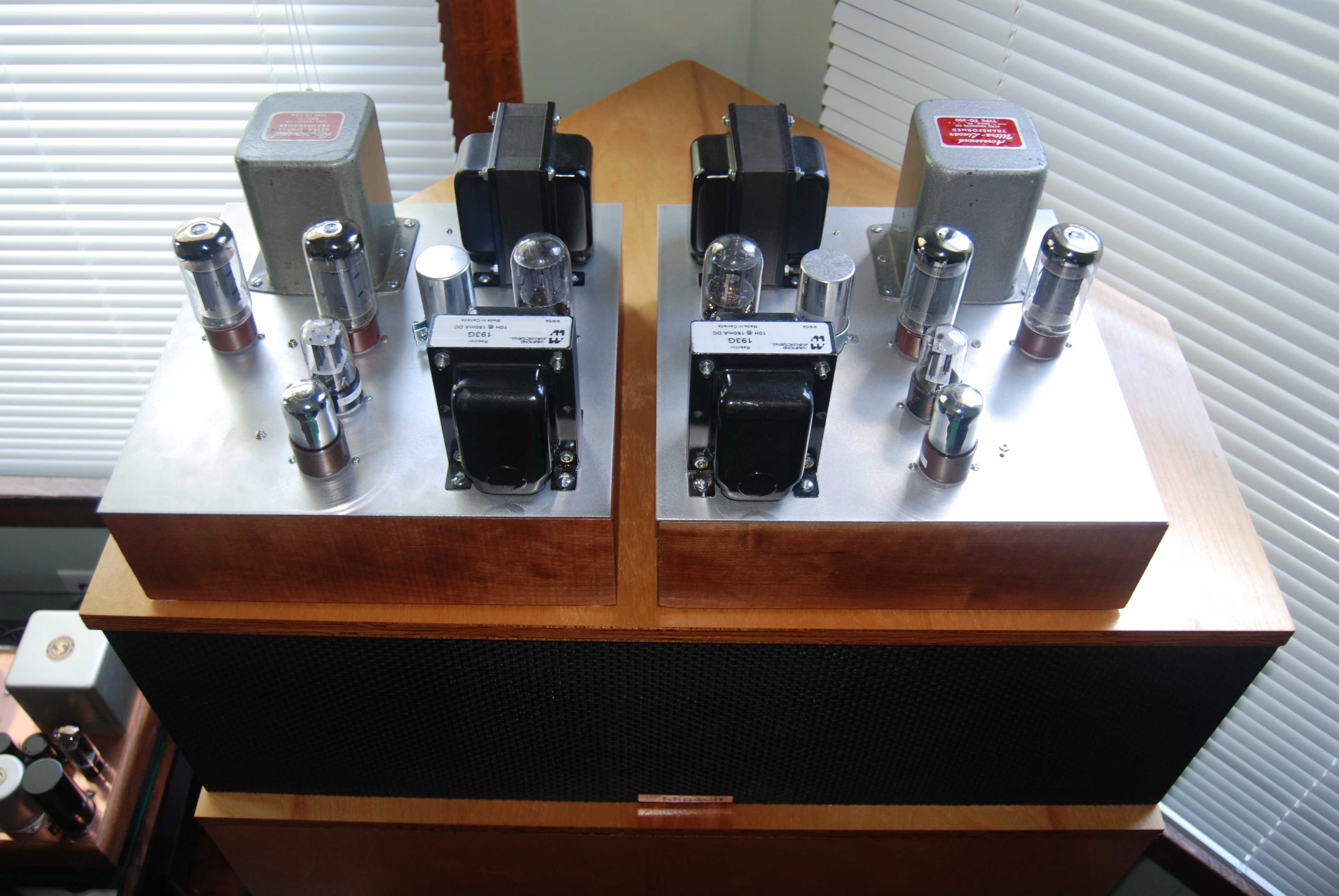

I just completed a 10JA5 compactron tube SE amplifier for a friend
nice work good looking amp!
what kind are those OPTX?
Thanks! Those OPTX are custom wound 3.5K /5K 20W. My friend hand carrying back from Japan.

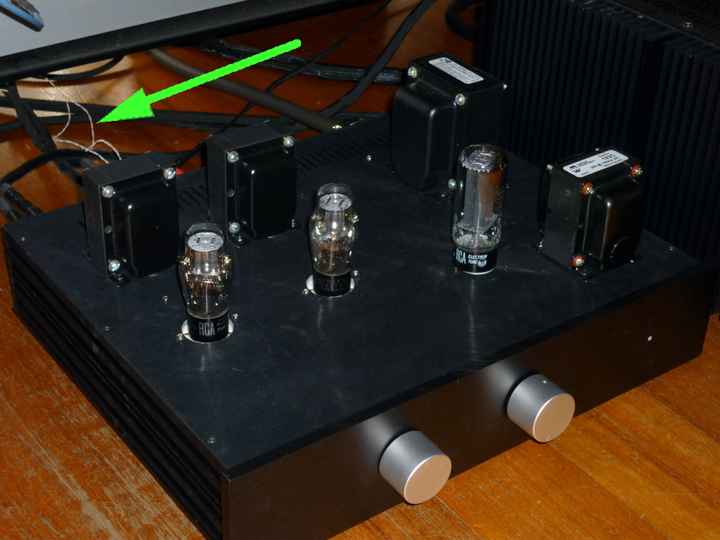

Here is my 6T9 made on an old telephone box

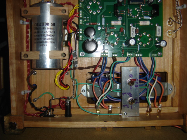

Very thin wires inside. What gauge do you use for filament, signal (RCA sockets to input switch for example) etc.?Some sexy photos of my 76 pre 😀
I hope those large Solen caps are secured by more than hot glue, that's a recipe for disaster.
The caps are being held in place with silicone glue, so it's a tad flexible, but quite sturdy.
Input wires are 24ga, filament wires are 18ga solid core (teflon insulated).
I suppose that as long as you never intend on shipping or transporting the amp anywhere that's fine but otherwise I wouldn't trust any glue that was trying to adhere to a anodized surface or smooth metal surface. It's really not difficult to secure them better, just a couple of zip ties with anchor ends. They can be found at most hardware stores.

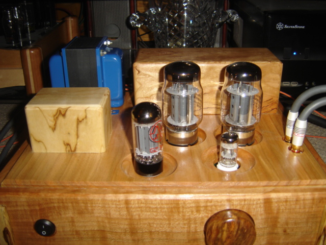

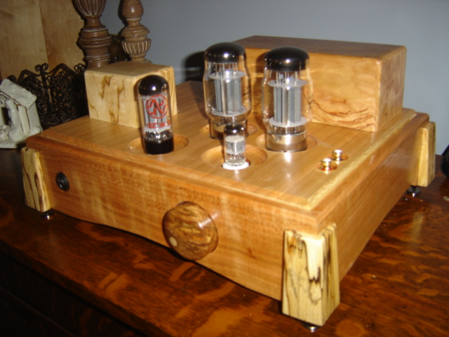

Just completed this: TubeLab Simple SE with kt88 and Edcor iron. My first venture into tube power amps so I built a kit. I am extremely impressed so far with the sound and it hasn't even had a chance to let the tubes break in yet.
Chassis is from scrap cherry I had in the work shop. Knob is a Maple Burl and corner pieces are spalted Maple.

Wow, it seems you can do whatever you want to with wood. I wonder how you did those transformers covers.
Transformer covers are cherry. The Choke cover is the cherry sapwood. The OPT covers are figured cherry heart wood. My house was originally built in 1855 (not old by EU standards but ancient in US). I have been redoing it the last five years using the local supply of wood. In this part of the country there isn't much of anything except trees so it is quite easy and cheap. In fact some of it is from my firewood pile. I buy almost all of the rest direct off of the local wood kiln, you end up with "wild" wood that isn't suited for cabinets or furniture. I use these pieces for amp chassis and knicknacks. The covers are just planed to 0.25" and mitered together. I round the corners with a roundover bit.
I should of fit the covers into the top plate better, maybe I will just make some trim for it. It will have to wait until I get through my album collection again ;-).
Next Up is a Tubelab SE with 300B's and then onto my own desing IT coupled 300B later this winter. I am still working on what I want to do with the chassis for these. Open to ideas.
